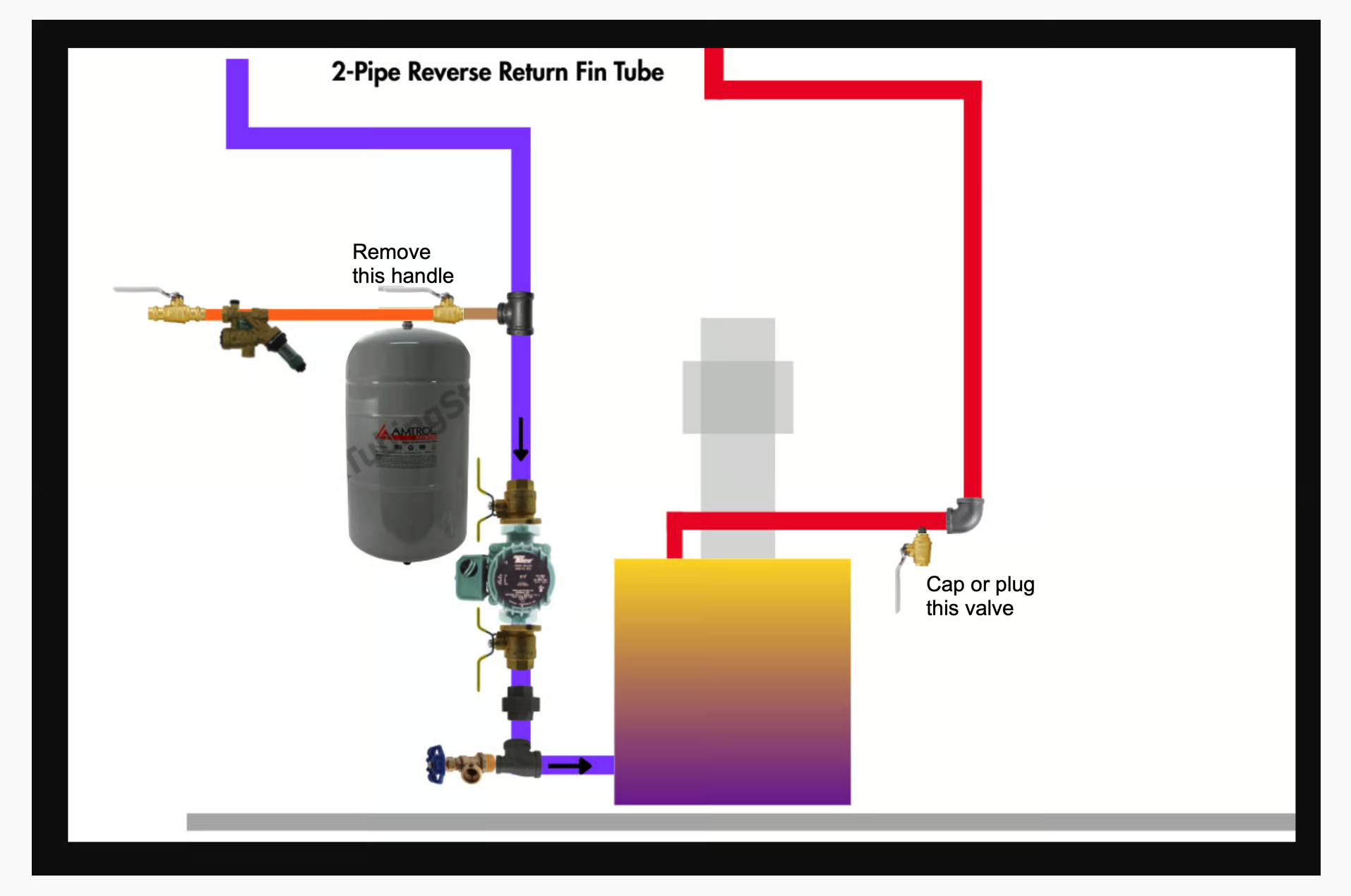

    EdTheHeaterMan Member Posts: 11,579
    How easy would it be to do this?
    This new expansion tank location would solve your problem.
    edited 3:48PM
    If you can get the expansion tank removed without draining the system and you can isolate the place where you install the expansion tank without draining the system then there is no need to drain the system.  I only caution you to remove the handle to the valve between the system and the expansion tank after you are finished with the work and open that valve.   That way someone won't be tempted to do you a favor and close that valve for some reason.  Just hang the handle on a wire near the valve for future service.  That was one of my signals to homeowners that the valve was not for their use.  There is no reason to close this valve.  (or open this valve if left closed)
