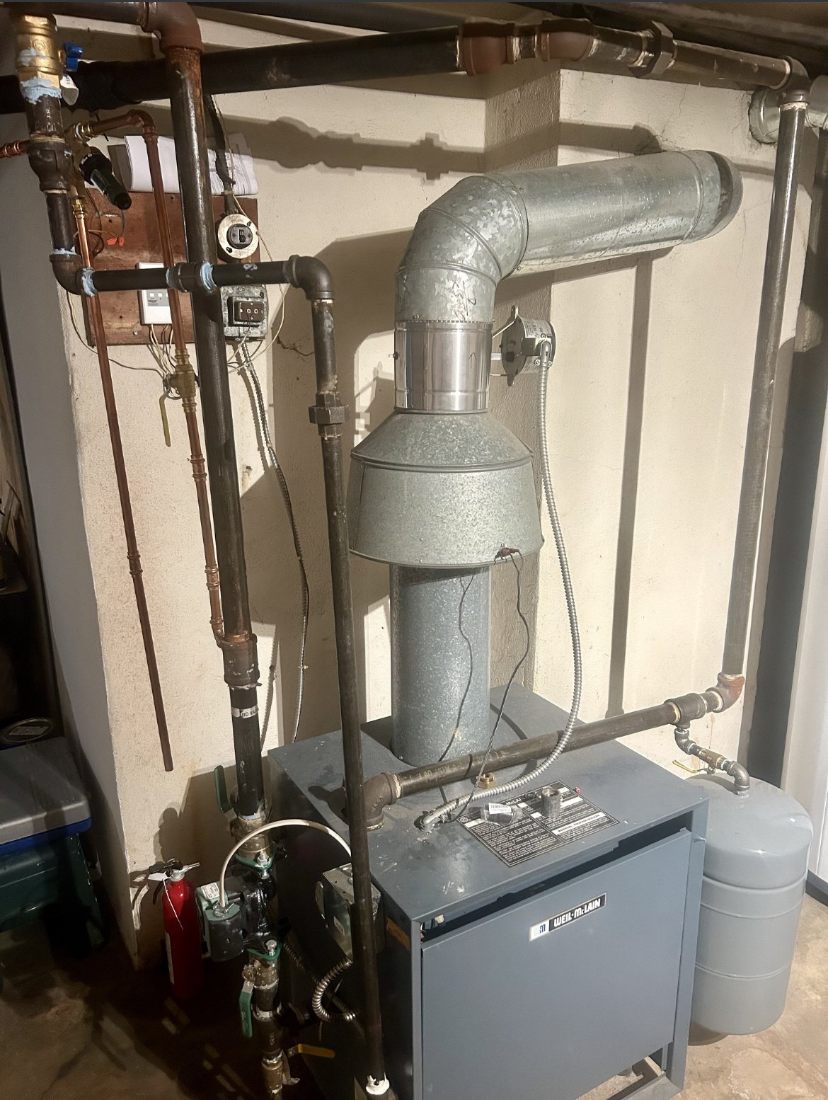

A new taco 0010 was installed on my hydronic heating system. I’m noticing a strange noise only when the circular is circulating hot water (not when the boiler is off on mild days and just circuiting cooler water).
Not sure how I can share the nose here in the forum. It’s a random knocking sound the is coming from the circulator. Not loud but noticeable.

    what type if system? Boiler? Heat emitters?
    What is the pressure on the boiler gauge? 12- 15 psi cold is a range
    A pic if the piping could help.
    With low pressure and high temperature you could be getting some cavitation noise

    @hot_rod thank you.
    CG8 (202,000 output)
    2 pipe reverse return.
    circulator on the return.
    expansion tank on supply.
    Cold is 15psi
    Hot is 19psi or so
    Fin tube
    Delivering heat well.
    mattmia2 Member Posts: 17,904
    if the circulator is too big for the piping or a valve is mostly closed or a strainer or something is clogged, it could still be cavitation.

    Cavitation is a basically a function of temperature and pressure. The hotter the water the easier it is to cavitate because it's already closer to the boiling point. Likewise insufficient NPSH for the pump at its operating point on the curve also makes it possible to cavitate in the eye of the impeller because that's where the pressure drops as the pump pulls the water in. When the pressure drops low enough for the water at that temperature to vaporize, then you have cavitation.
    What does the noise actually sound like? does it sound like rocks in your pump? that's the lovely classic cavitation sound.
    Off the top of my head I think the 0010 curve is pretty similar to a series 100, but I also don't usually deal with small pumps like those

    hot_rod Member Posts: 28,078
    "circulator on return, expansion on supply" "noise only when hot"
    Equals cavitation. There are other potential problems — but the overall bottom line is that most of your pressure loss in the system is between the expansion tank and the inlet to the pump — so the pressure at the inlet to the pump is a lot less than the "system" pressure, and when the water is hot, it boils — cavitates — at that low pressure.
    All the above suggestions are good — but move the expansion tank to the inlet of the pump and live happily ever after.

    AlwaysLearning2024 Member Posts: 119
    Thanks @hot_rod and @Jamie Hall .
    The circ is on the return, as well as the makeup.
    The expansion tank is unfortunately on the supply.
    I start hearing the sound around 130 degrees.
    System pressure (according to the boiler guage, static pressure is around 15psi, when around 140 degrees, roughly 18-20psi). Unable to check the pressure at the inlet of the circ. The expansion tank has a service valve.
    With the numbers you posted, I’m not thinking cavitation, 130f, 15 or higher psi and a fairly low head circ.
    If somehow you established a high pressure drop through the system, maybe a partially opened ball valve after the pump swap, a plugged strainer??
    Could the noise be coming from the boiler?
    Percolation is a condition where water boils under a layer of scale on the boiler sections. It too would be noticed as boiler temperature rises. It could sound like a circulator noise.
    You hear this sound in older tank type water heaters that have a sediment layer in them

    The sounds is definitely coming from the circ. This morning I tried slowly closing the ball valve on the outlet of the circ and when nearly closed, the sound decreased quite a bit.
    Yes, I could move the expansion tank to the MU location before the circ to be pumping away, yet have some questions:
    I have a service valve on the expansion tank, as well as a valve after the fill valve before the connection to the return. If I close both, and re-pipe at that location, can I leave the water in the system and not need to drain down the system?
    edited December 2025
    If you can get the expansion tank removed without draining the system and you can isolate the place where you install the expansion tank without draining the system then there is no need to drain the system.  I only caution you to remove the handle to the valve between the system and the expansion tank after you are finished with the work and open that valve.   That way someone won't be tempted to do you a favor and close that valve for some reason.  Just hang the handle on a wire near the valve for future service.  That was one of my signals to homeowners that the valve was not for their use.  There is no reason to close this valve.  (or open this valve if left closed)

    Attach a pic of the boiler and piping, it may be fairly easy to move the exp tank to the circ inlet. That may solve a few issues for you.
    AlwaysLearning2024
  • AlwaysLearning2024
    this was before the circ swap to the 0010.
    Much less purging issues and no-heat calls since I replaced the 0015 ecm circ.
    If the green pump is flowing down into the boiler? Your expansion tank re-position is super simple. This 1/2 copper fill valve line is where you tee in. A quick easy job for someone with a press tool.
    Add a tank service valve while you are at it.
    Screenshot 2025-12-29 at 3.31.07 PM.png Screenshot 2025-12-29 at 3.32.15 PM.png
