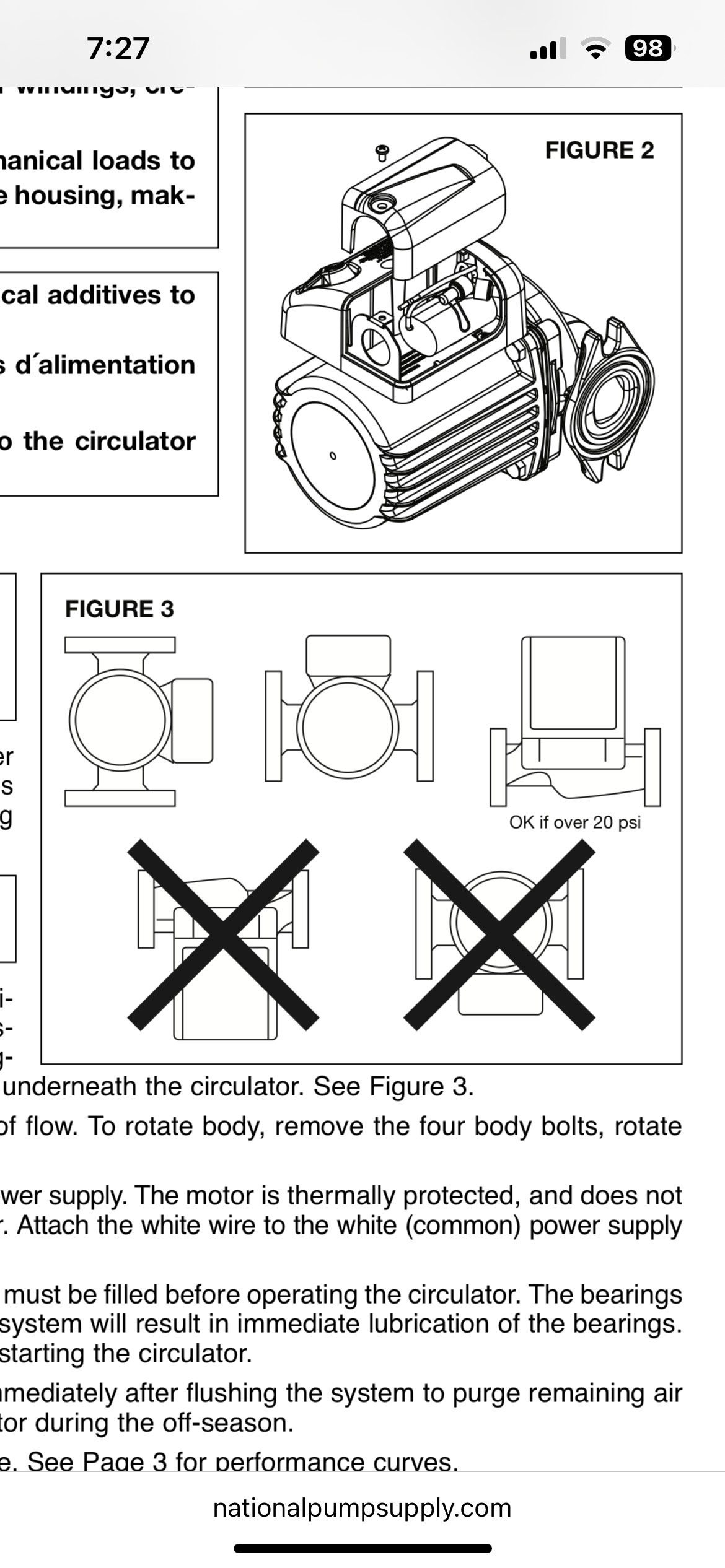

    I did notice that that motor body (logo) is upside down yet the flow arrow on the body is facing the correct direction.
    Does the motor body direction matter with these wet rotor type circulators?

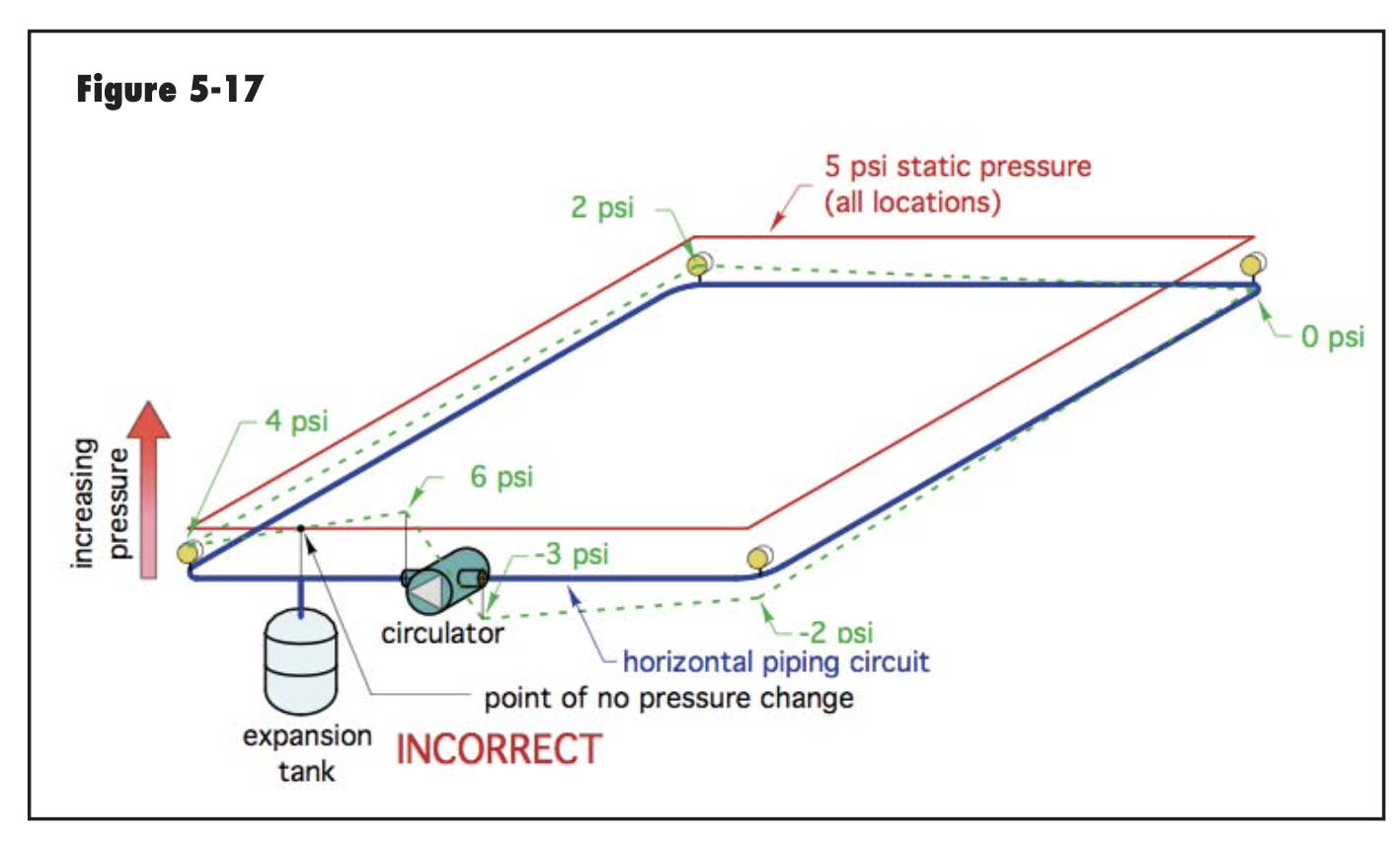

    "circulator on return, expansion on supply" "noise only when hot"
    Equals cavitation. There are other potential problems — but the overall bottom line is that most of your pressure loss in the system is between the expansion tank and the inlet to the pump — so the pressure at the inlet to the pump is a lot less than the "system" pressure, and when the water is hot, it boils — cavitates — at that low pressure.
    All the above suggestions are good — but move the expansion tank to the inlet of the pump and live happily ever after.
    Intplm.EdTheHeaterManbjohnhy
    hot_rod Posts: 28,705

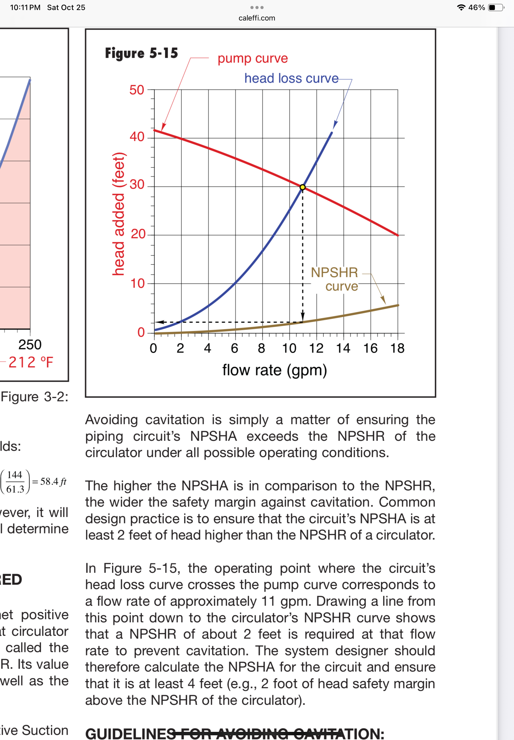

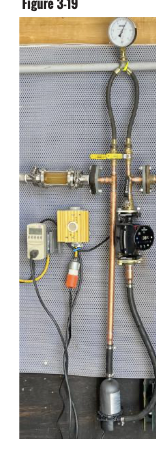

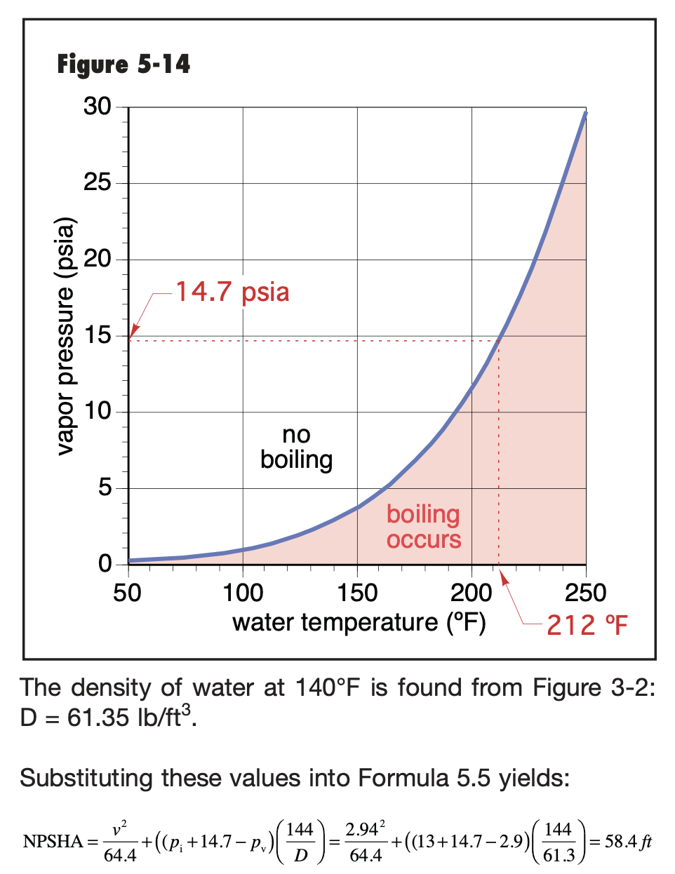

    vapor pressure is what is at work with some cavitation. It is the pressure required to prevent water from flashing to steam. There is a pressure drop at the inlet "eye" of the impeller, if it drops below the vapor pressure of the water at the temperature it sees, then vapor pockets form.
    The piping schematic belows shows what can happen when you pump at the expansion tank, the PONPC. If the circuit allows the pressure to drop below the vapor pressure, that is where cavitation starts. Notice the negative pressure at the circ inlet.
    The graph shows the pressure temperature relationship. Yes water can boil at 100°F. That is how evac tube solar collectors work. The vacuum on the fluid allows it to boil around 100°
    At sea level pressure is 14.7 PSIA, water boils at 212°F.
    Water boils at around 202°F in Denver at 5,000'

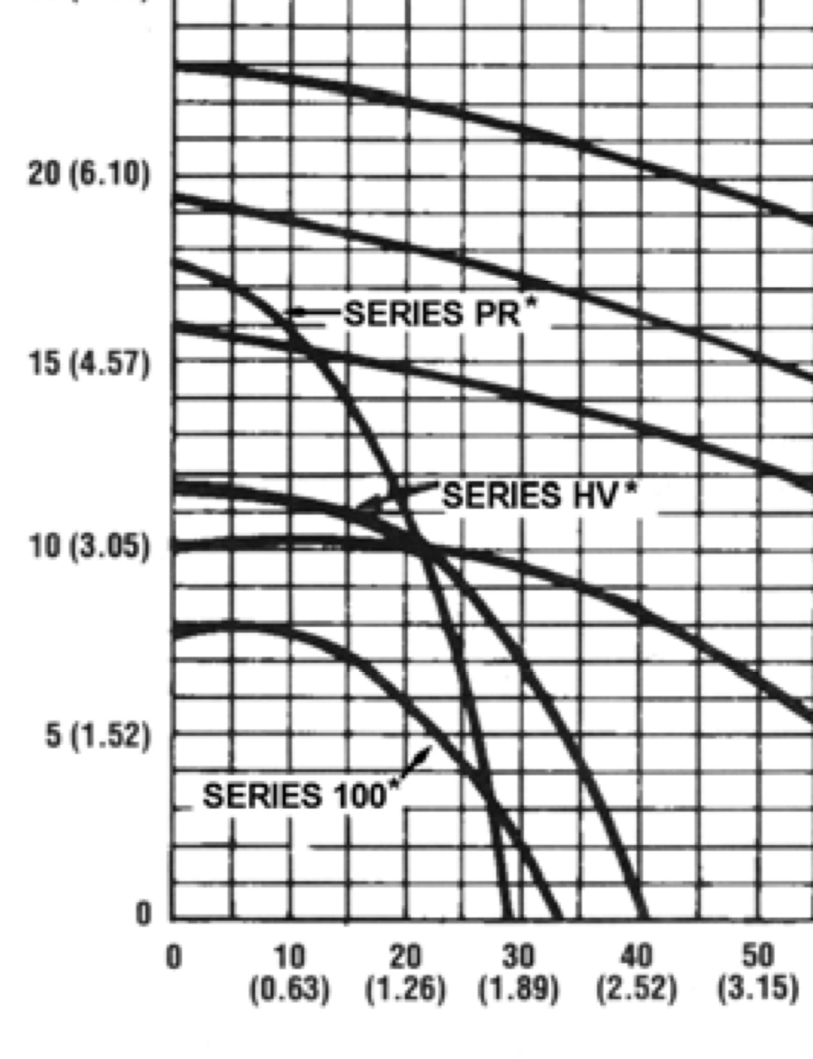

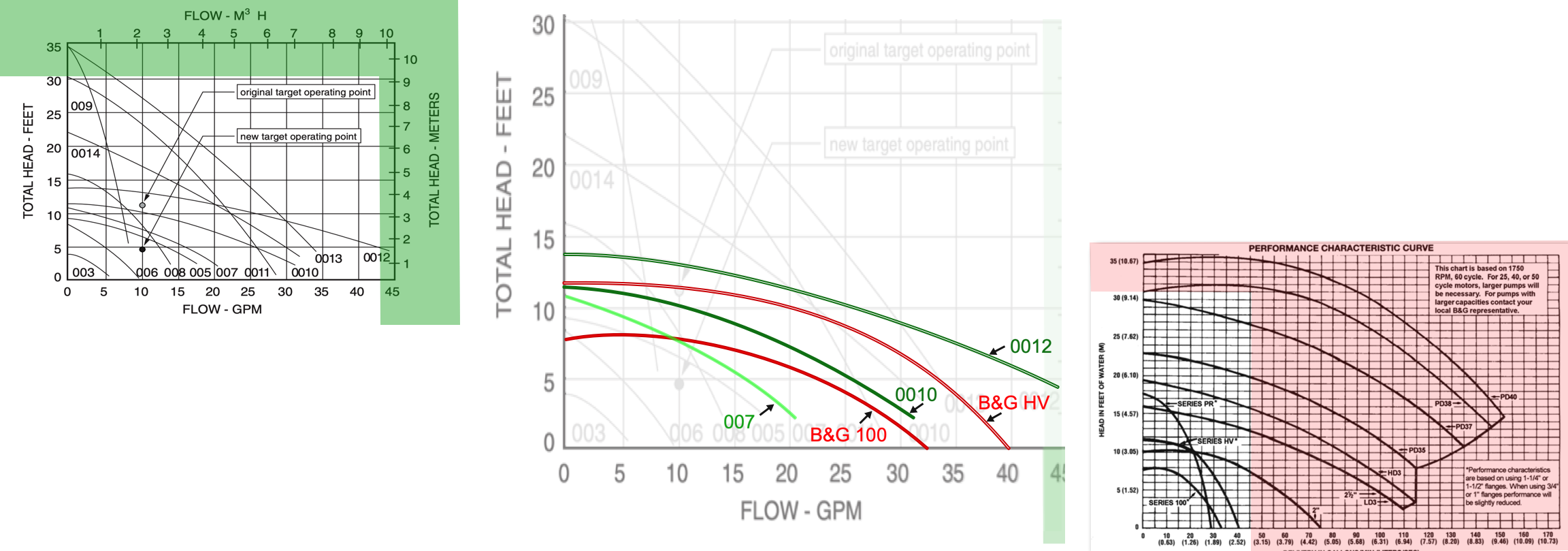

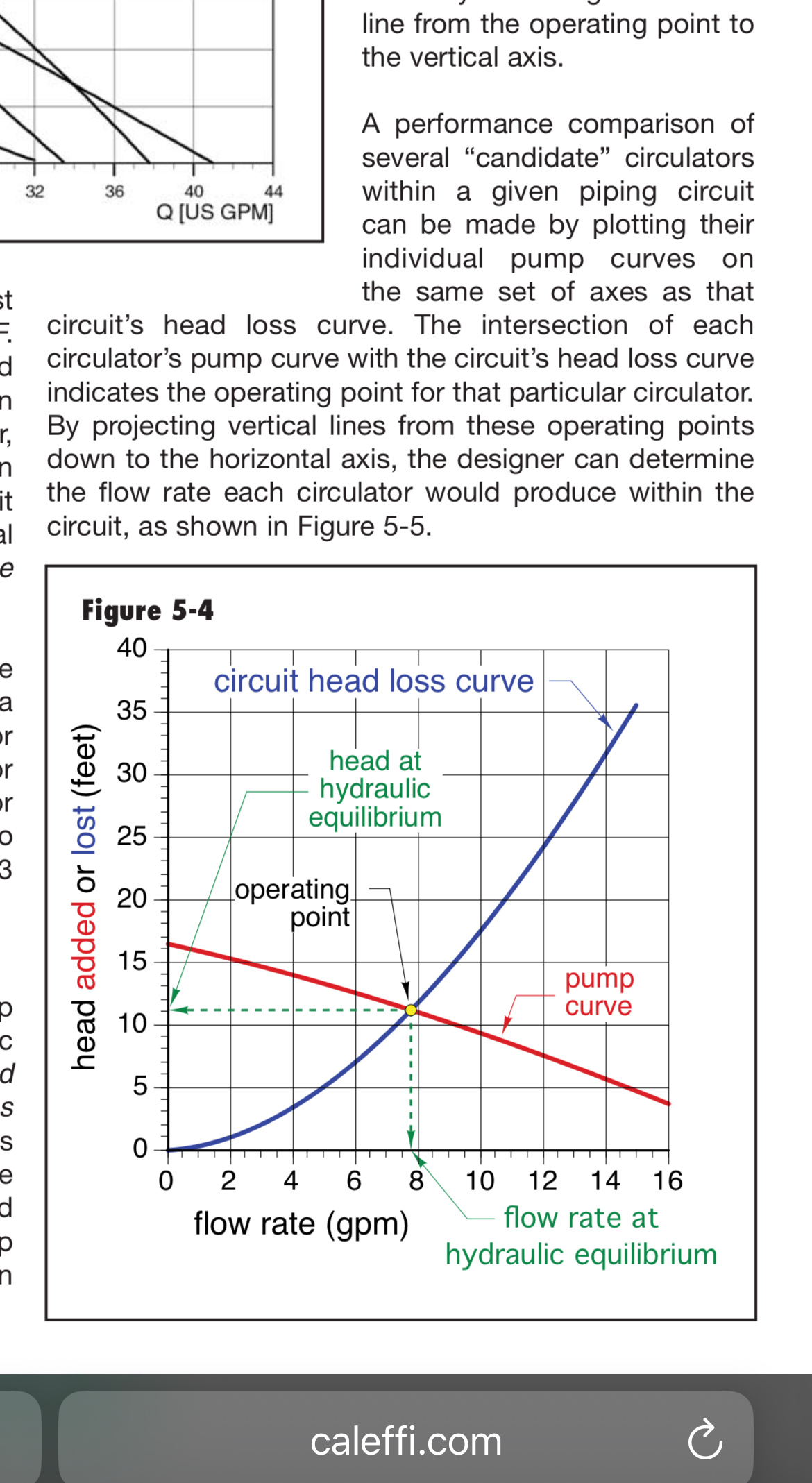

    yes the 0010’is a bit higher head circ, here are the two curves

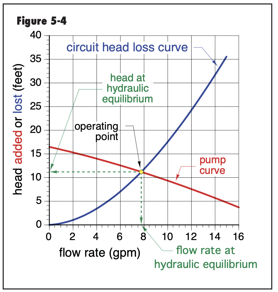

    The left vertical axis is shut down head. The head the circ would develop if it were moving 0 gpm, the lower horizontal axis
    The series 100 is around 8’, the 0010 around 12’
    You would need to define the circuit it is connected into to develop a system curve, example below.
    The system curve lies over the pump curve to determine the OP, actual operating point. Could be the 0010 is just a bit higher head and causing the issue
    If it is cavitation two things could correct it, raise the static pressure as @Jamie Hall mentioned, or lower the water temperature

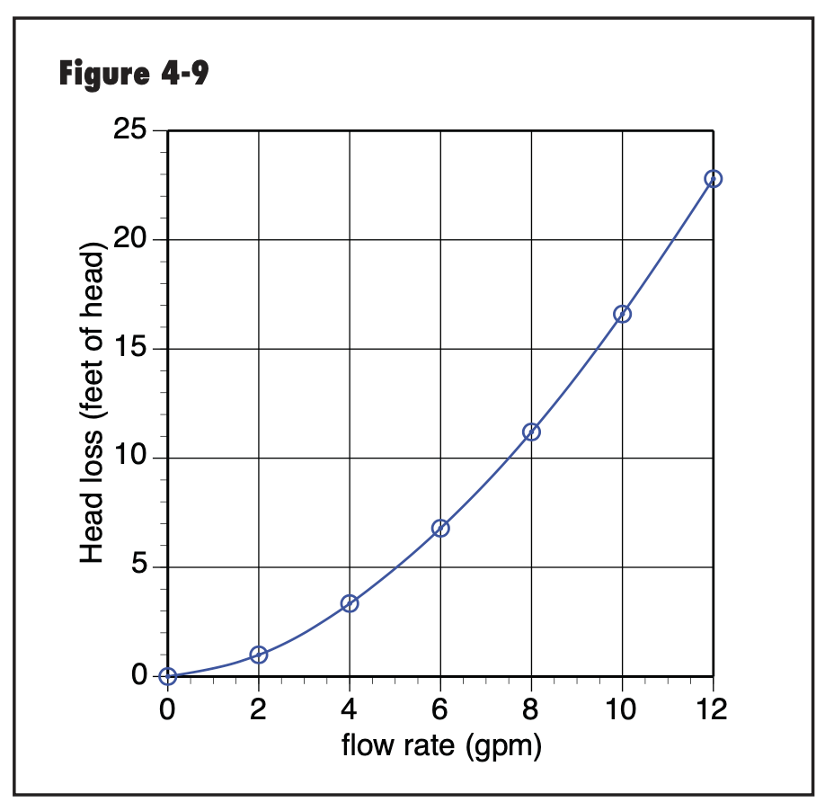

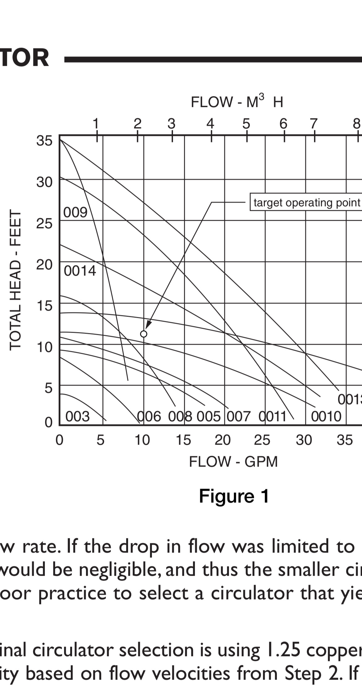

    @EdTheHeaterMan generously helped me work out the head and flow in the following post. I had to go with a 0010 and not the 0012/Series HV as Ed suggested.
    This CG8 replaced a larger boiler in 1994 before I owned the building. The building is definitely plenty warm. Controlled by a TekMar 256.
  • thanks @Intplm. I thought the 0010 was a match but I must have been mistaken. Still learning so much here.

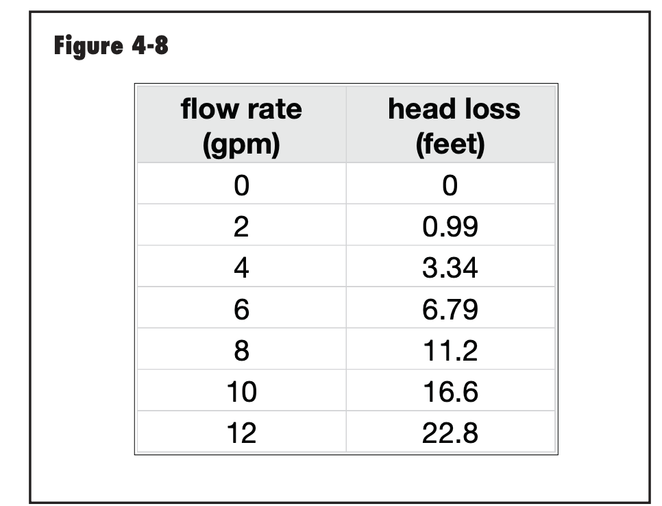

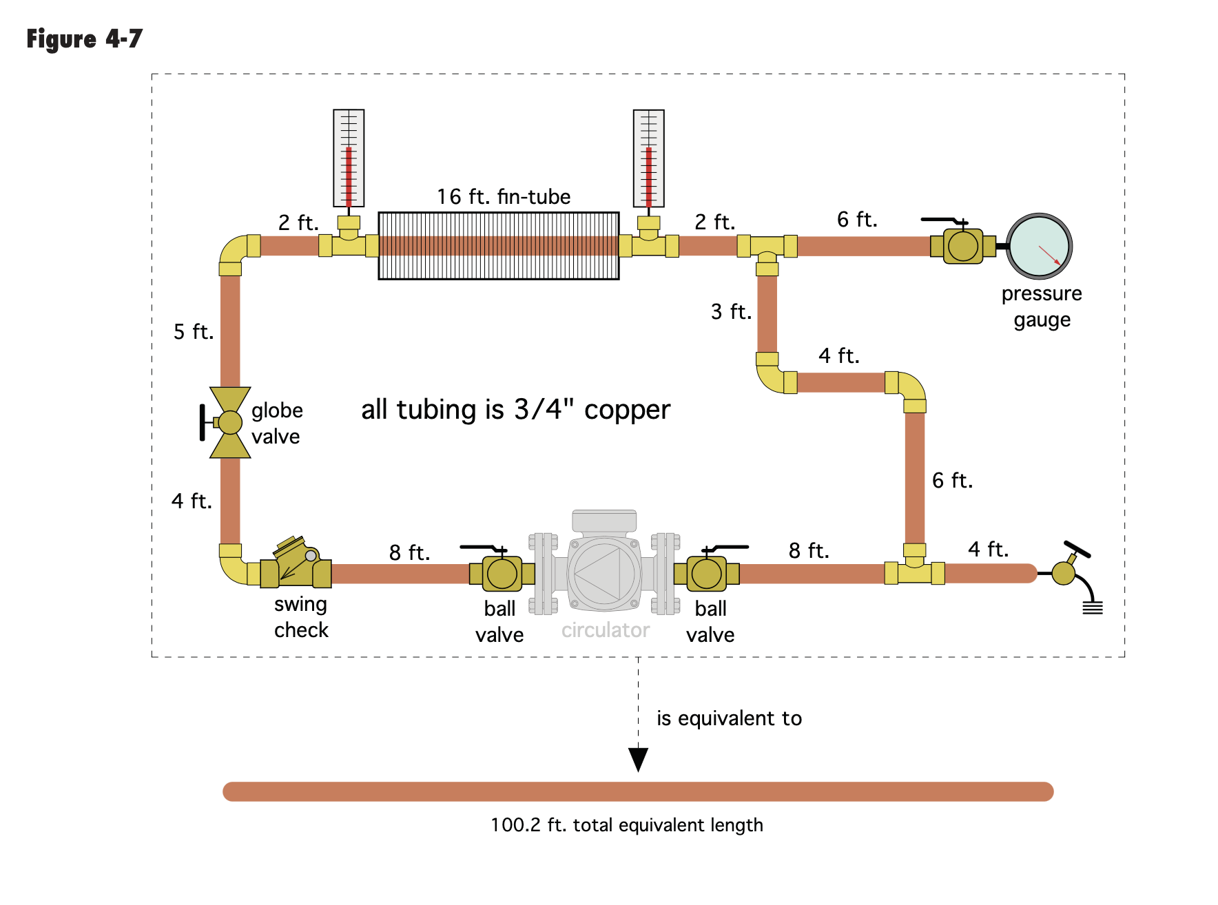

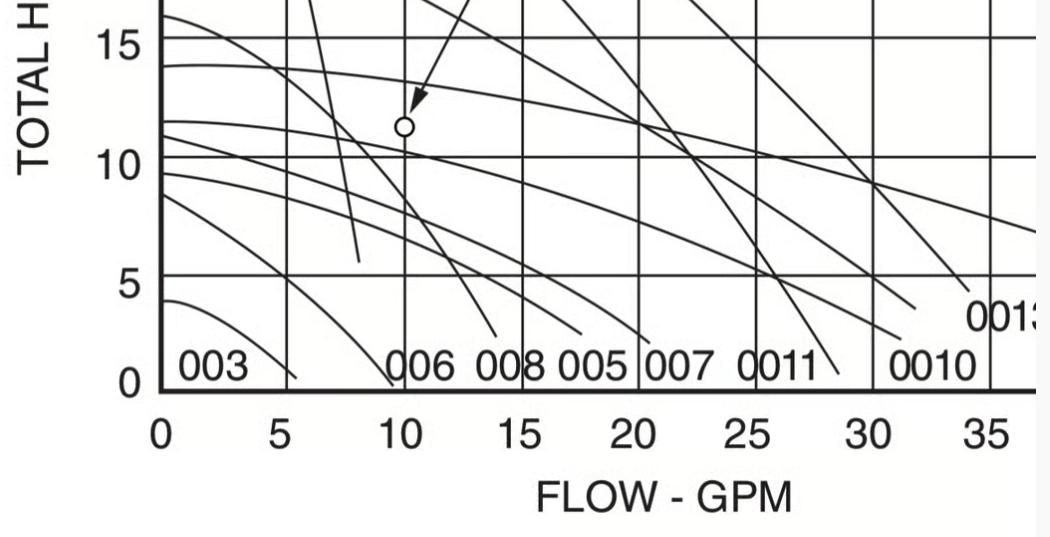

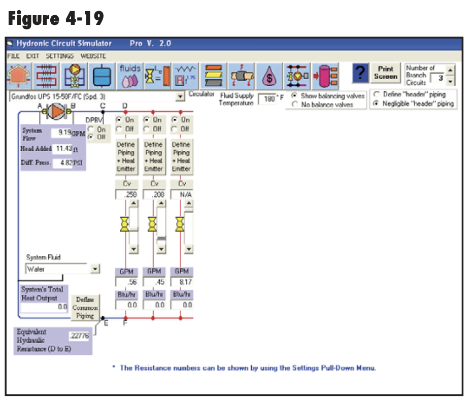

  • Sometimes plotting your system on a pump curve can be difficult when there are several different curves for many pumps.  The fact that one brand uses a narrow pump chart and the other brand uses a flatter pump chart only confuses things.  Only when you put all the pump curves that you are considering on the same chart, can you see the actual difference in each pump, and how that small change can affect your system.   Here is that chart:
    The left is the TACO and the right is the B&G published performance curves for several of their pumps.
    In the center, I have flattened the B&G and made the TACO a little taller so all the HEAD and the GPM lines match up.  Then I only selected the 5 pumps mentioned in this discussion.  TACO 007, B&G 100, TACO 0010, B&G series HV, and the TACO 0012.   When all the performance curves are lined up on the same chart, you can clearly see that the TACO 0010 has more pumping ability than the B&G 100.  This may not be by much but perhaps just enough to cause your noise cavitation at the higher temperatures.
    When throttling a ball valve on the discharge side of the TACO 0010 pump to reduce the flow rate in order to better match the B&G 100 a 10 or 15% closure may have no effect on the flow rate.  You may need to get closer to 70% closure of a ball valve in order to cause a real reduction of the flow rate.  Then the smallest adjustments after that may cause a large reduction in flow rate.  Ball valves are not the best devices for that purpose however that is what you have to work with, so you need to use them.
    Important NOT to throttle the inlet side of the pump.  That will make things worse.  Only throttle the discharge side of a pump to meter the flow in the system
    Hope this info helps

    some pump manufacturers also add the NPSH curve into the graphs, generally on larger sized pumps.
    Once you define the OP, the point of hydraulic equilibrium, which is the point where the head added matches the head loss of the circuit.
    From that point drop down to the NPSH curve.
    NPSH is the amount of head required to avoid cavitation. NPSHA is the head available

    Since you are pumping at the expansion tank, no easy option to change that??, the pressure at the circ's inlet is dropping and you get closer to the boiling point based on both pressure and temperature.
    The graph attached a few posts up shows this.
    Lets assume you run 170 fluid temperature, at that temperature you need about 8 psi at the circulator to avoid boiling or cavitating.
    A gauge at the inlet of the circ would answer the question. If you have a static, no fluid moving pressure of 12 psi. The pressure drop around the circuit being circulated is WAG 6 psi. So the circulator inlet pressure would be 12-6=6 psi
    Use that number on the left side of the graph below
    Run across the graph to the right to see the fluid temperature intersection.
    So the slightly higher head circ that you added, the fact you are pumping at the PONPC and your static pressure and highest operating temperature all factor to answer the question what could be causing the noise at higher temperatures.
    You need to fill in some blanks, at what temperature do you start to hear the noise?
    Also the pressure at the circulator inlet.That could be measured, or calculated with a few steps of number crunching.
    Simpler yet, increase fill pressure and or reduce operating temperature. Does the noise disappear, then you have a cross check to what may be going on.

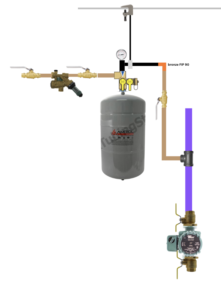

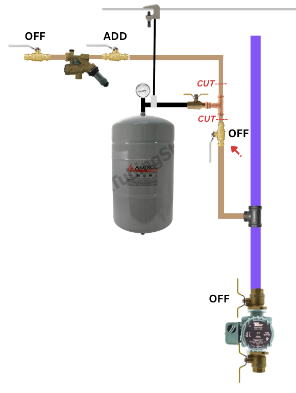

  • How easy would it be to do this?
    This new expansion tank location would solve your problem.

    Yes, I could move the expansion tank to the MU location before the circ to be pumping away, yet have some questions:
    I have a service valve on the expansion tank, as well as a valve after the fill valve before the connection to the return. If I close both, and re-pipe at that location, can I leave the water in the system and not need to drain down the system?
    EdTheHeaterMan Posts: 12,948
    edited December 2025
    If you can get the expansion tank removed without draining the system and you can isolate the place where you install the expansion tank without draining the system then there is no need to drain the system.  I only caution you to remove the handle to the valve between the system and the expansion tank after you are finished with the work and open that valve.   That way someone won't be tempted to do you a favor and close that valve for some reason.  Just hang the handle on a wire near the valve for future service.  That was one of my signals to homeowners that the valve was not for their use.  There is no reason to close this valve.  (or open this valve if left closed)
