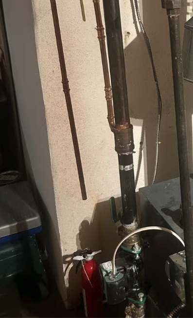

    The circ is on the return, as well as the makeup.
    The expansion tank is unfortunately on the supply.
    I start hearing the sound around 130 degrees.
    System pressure (according to the boiler guage, static pressure is around 15psi, when around 140 degrees, roughly 18-20psi). Unable to check the pressure at the inlet of the circ. The expansion tank has a service valve.

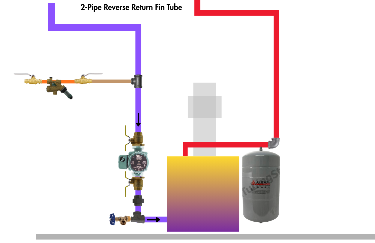

    How easy would it be to do this?
    This new expansion tank location would solve your problem.

    The sounds is definitely coming from the circ. This morning I tried slowly closing the ball valve on the outlet of the circ and when nearly closed, the sound decreased quite a bit.
    Yes, I could move the expansion tank to the MU location before the circ to be pumping away, yet have some questions:
    I have a service valve on the expansion tank, as well as a valve after the fill valve before the connection to the return. If I close both, and re-pipe at that location, can I leave the water in the system and not need to drain down the system?
    edited December 2025
    If you can get the expansion tank removed without draining the system and you can isolate the place where you install the expansion tank without draining the system then there is no need to drain the system.  I only caution you to remove the handle to the valve between the system and the expansion tank after you are finished with the work and open that valve.   That way someone won't be tempted to do you a favor and close that valve for some reason.  Just hang the handle on a wire near the valve for future service.  That was one of my signals to homeowners that the valve was not for their use.  There is no reason to close this valve.  (or open this valve if left closed)

    Attach a pic of the boiler and piping, it may be fairly easy to move the exp tank to the circ inlet. That may solve a few issues for you.
    AlwaysLearning2024
  • AlwaysLearning2024
    AlwaysLearning2024 Member Posts: 119
    this was before the circ swap to the 0010.
    Much less purging issues and no-heat calls since I replaced the 0015 ecm circ.
    hot_rod Member Posts: 28,010
    If the green pump is flowing down into the boiler? Your expansion tank re-position is super simple. This 1/2 copper fill valve line is where you tee in. A quick easy job for someone with a press tool.
    Add a tank service valve while you are at it.
