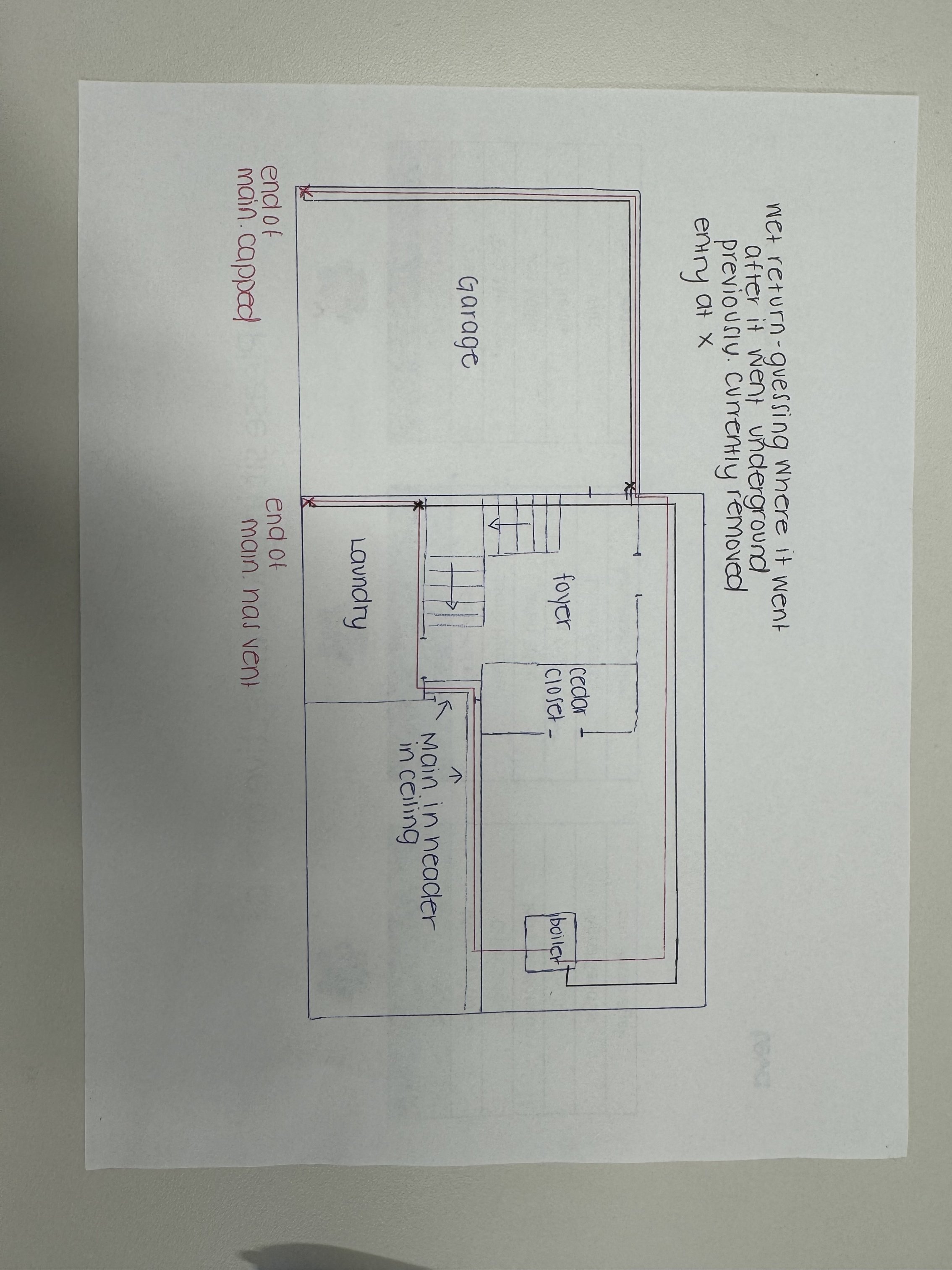

We have a steam system. Boiler was new in 2017. We purchased the home a year ago and had 1 season of heat with no issues.
Our underground dry return started slowly leaking where it exited the concrete. The original plan was to replace the return above ground. We were away while the work was done, so upon arrival, decision was made based on some of the existing set up, to vent the mains and not repipe a return. Was told this would work without issue.
Turned on the system 2 weeks ago. System shuts off due to low water. Cooled and refilled and system shuts off off again due to low water. No water ever returned to boiler.
Plumber comes out. Vacuums out standing water. Caps mains. Says fire system and let him know what happens. Same issue - system shuts off due to low water. Nothing returns.
We go a few cycles of vacuuming and restarting. Continues to empty the boiler with zero water returning.
We’ve now skimmed the system twice. No improvement. Plumber still believes that something in the system is causing the water to leave the boiler.
System has 2 mains and 9 radiators. All radiators are above the mains. 5 radiators are not heating - 3 on first floor and 2 on second floor. Unable to adjust pitch on one of the mains due to enclosure in ceiling and how arteries are piped.
Minor surging at boiler when firing.
Plan for tomorrow (7th visit to our home) is to add something to the boiler to address potential contaminants.
Options discussed to resolve include adding a pump. Set up of system creates challenges to add returns due to walls/ceiling/floor plan etc

    if there were wet returns returning from the far end of the mains it is a parallel flow system. the mains are sloped away from the boiler and the wet returns bring the condensate back to the boiler. you have to replace the wet returns.
    In theory you could slope everything toward the boiler and add drips before the boiler header to return the condensate but that wouldn't be practical because it would throw all of the pitch to the runouts to the radiators off, the mains are sized for parallel flow, not counter flow, you would essentially end up repiping the entire system.

    It may be possible to pipe the returns up high and drop them down at the boiler. they don't have to follow the supply mains, they just need to get back to the boiler.
    the steam condenses in to water in the radiators and gives off its heat and that water has to flow back to the boiler. in your system the piping is pitched to collect it at the ends of the mains bring it back from the end of the mains (and possibly some other low spots as it works around obstructions) through the wet returns under the floor.
    It is possible oil in the boiler from whatever the plumber changed is also causing the water to surge and get thrown out of the boiler, but that is a secondary problem to the missing returns.

    IMG_3588.jpeg IMG_3590.jpeg IMG_3591.jpeg IMG_3597.jpeg IMG_3599.jpeg IMG_3601.jpeg IMG_3596.jpeg
    $3200 paid. I haven’t incurred any additional costs thus far.
    Photos below.

    The original plan was to repipe the returns. Why wasn't that done? It seems replacing underground would have been the assumption in the original quote. Seems like the contractor may have underestimated the work and was trying to get out of it. There are other ways to setup the return as well above ground. Just loop the mains around after the last takeoff and continue to pitch down toward the boiler and then drop down to the floor back at the boiler. Join the two returns only after they have dropped below water line. In pictures 4 and 6 the main extension (your new return) would go through the wall by the door just below the existing main. Shorter main return could be done in a similar manner.
    mattmia2New England SteamWorks
    Jamie Hall Member Posts: 26,808
    Agreed, @dabrakeman . I don't think this will be all that hard to get running well. But… it does have to done right!

    I have no doubt that there are some challenges to re piping in a finished basement but this can be fixed.
    But looking at it and speculating does no good. You need to get one of those experienced contractors to get his eyes on the job.
    This can't be fixed by looking at pictures. A small condensate pump may be the fix if repiping low is not an option.
    Your plumber already charged you $3200. He will probably only come back for more $$$.
    As @Jamie Hall said your in a hole now stop digging.
    mattmia2 Member Posts: 15,504
    you could also run each drip as a separate dry return just under the main until you get to a place where you can run along the floor to the boiler or run the wet return in a completely different path from the current one. remember it doesn't need slope, it just needs to stay a certain distance below the water line.
    i think it is very likely it can be done without a condensate tank.

    I see several options that would avoid the stairs.
    109A_5 Member Posts: 3,396
    edited October 23
    If the foyer is above the basement the return for the long main may be able to enter the basement just above the step but below the actual house floor. So a steam main extension dropping into a drip next to the doorway. Once in the basement it should not be a big deal.

    The most creative solution I see is bringing the end of the main in the garage over the garage door as a dry return then either dropping it and the other main in to a wet return and bringing that around the perimeter to the boiler together or brining them separately around as dry returns and at some point dropping them down in to a wet return that goes to the boiler.

    Looking at at the pictures some more this probably would have been an easy repair for someone experienced with steam heating.
    The return pipe in the garage from the far corner of the garage to the step under the door, was it mostly up high or down low or under the garage floor ?
    Where is your old return pipe that should be re-installed or maybe now replaced ?
    you could even bring the return from the laundry room end of the main in to the garage and run it as a dry return back to the unfinished space if you didn't want that return in the finished space. Would have to turn it in to a wet return at the door to run it under the threshold of the door.

    On the long main it is already exposed in finished space so just having the return right below it seems the easiest solution vs digging up the floor in a finished room, just drop it down back at the boiler.
