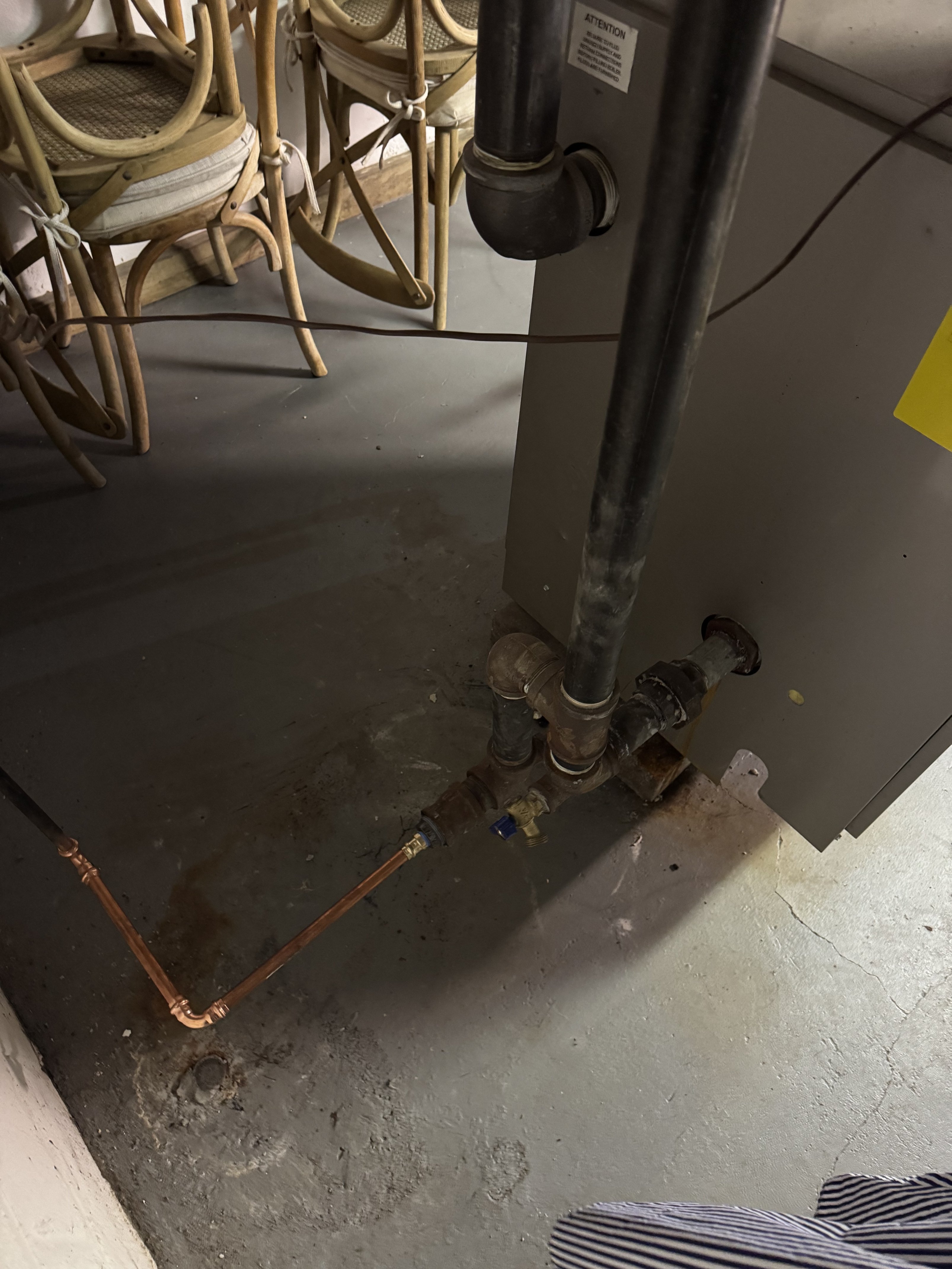

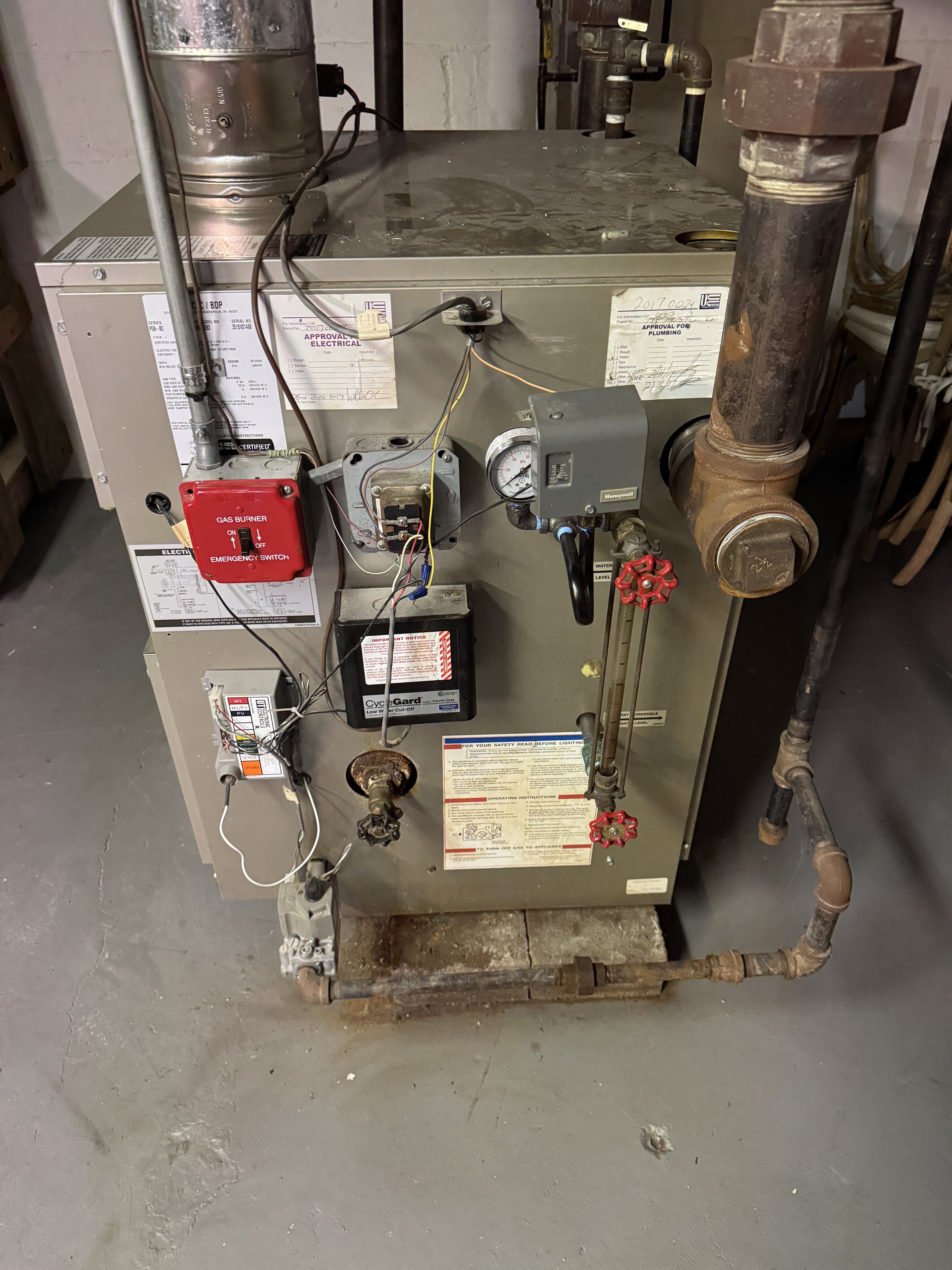

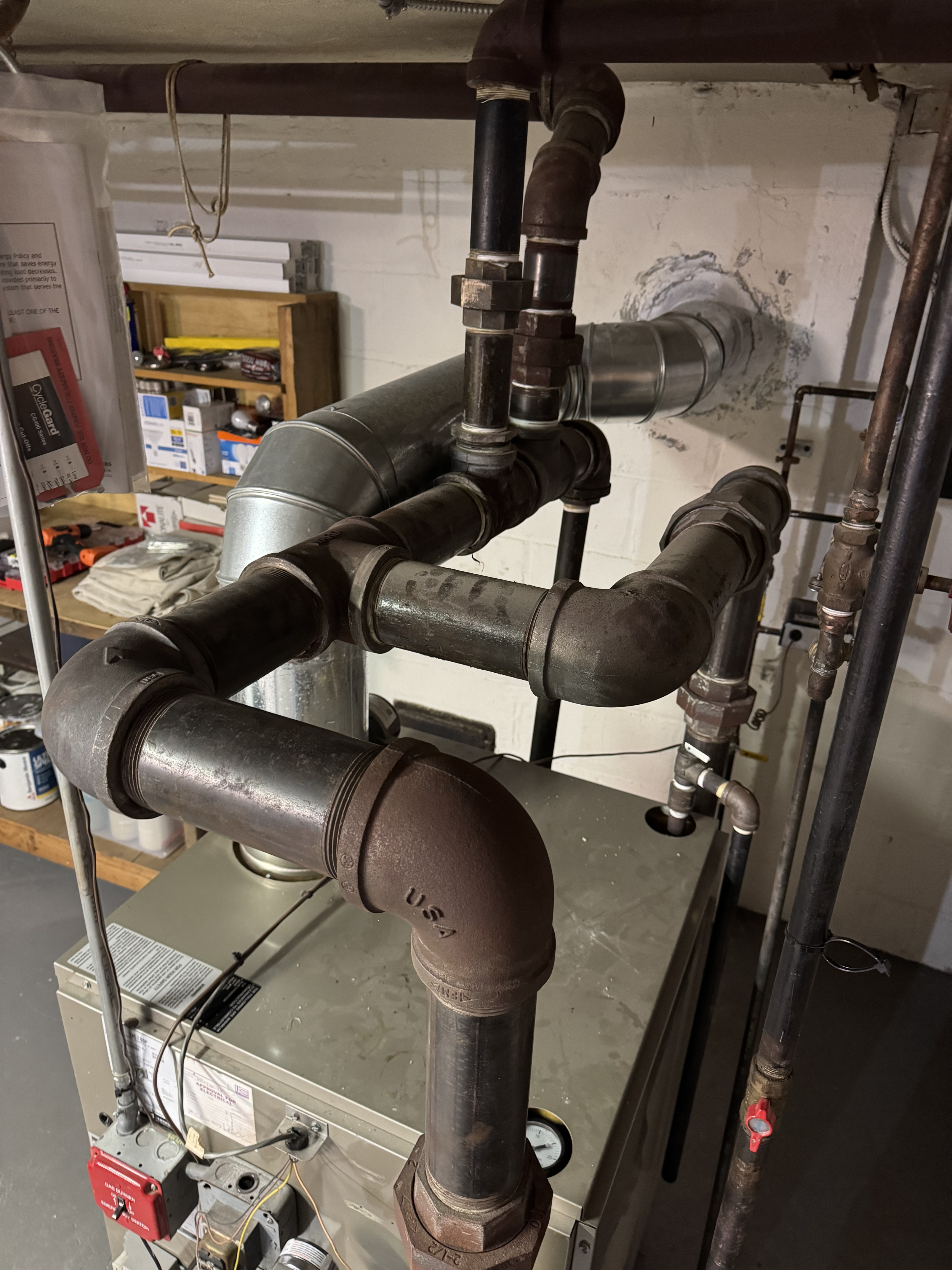

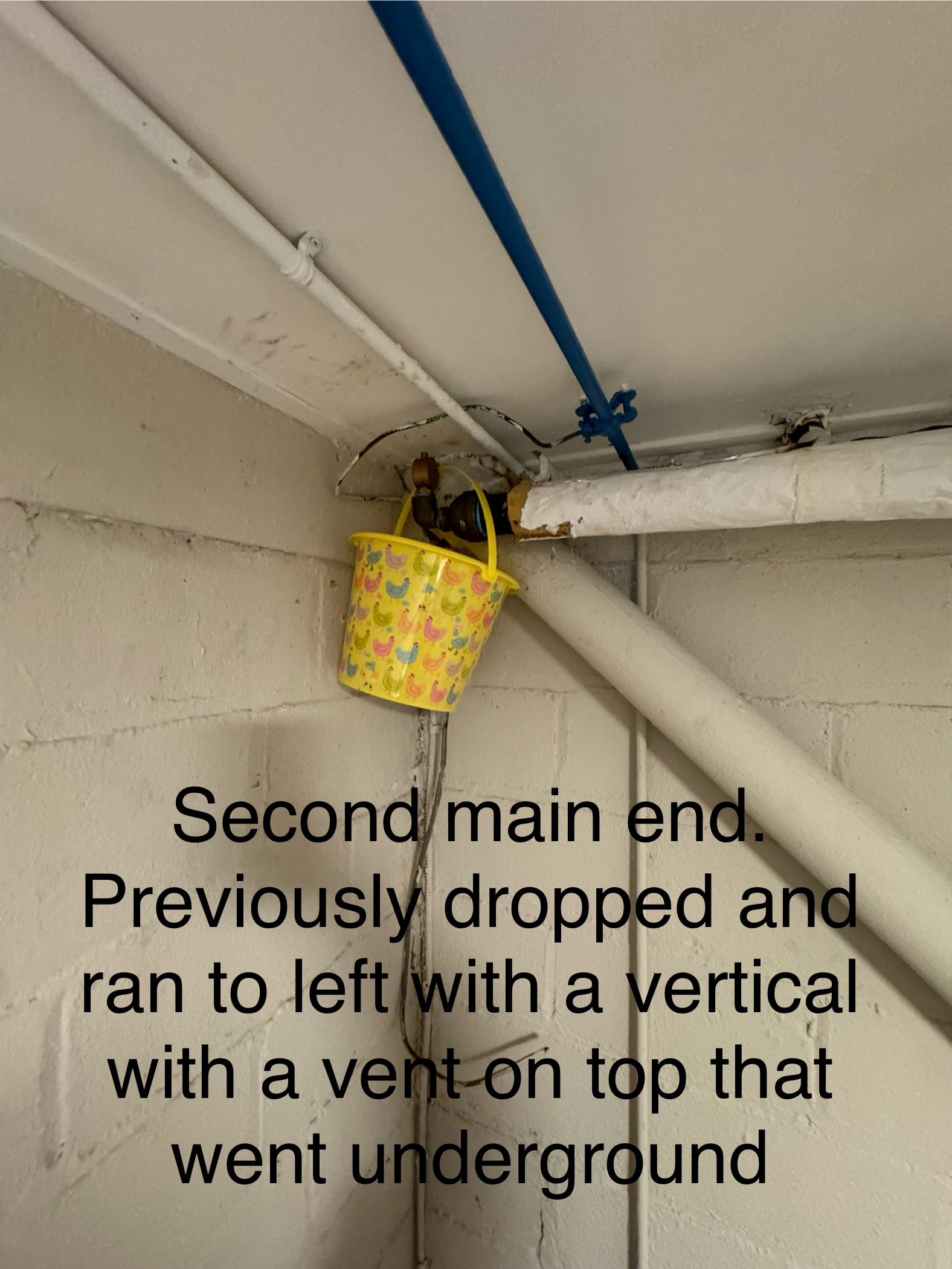

Can you post some pictures of your boiler piping and more importantly, the steam main?

$3200 paid. I haven’t incurred any additional costs thus far.

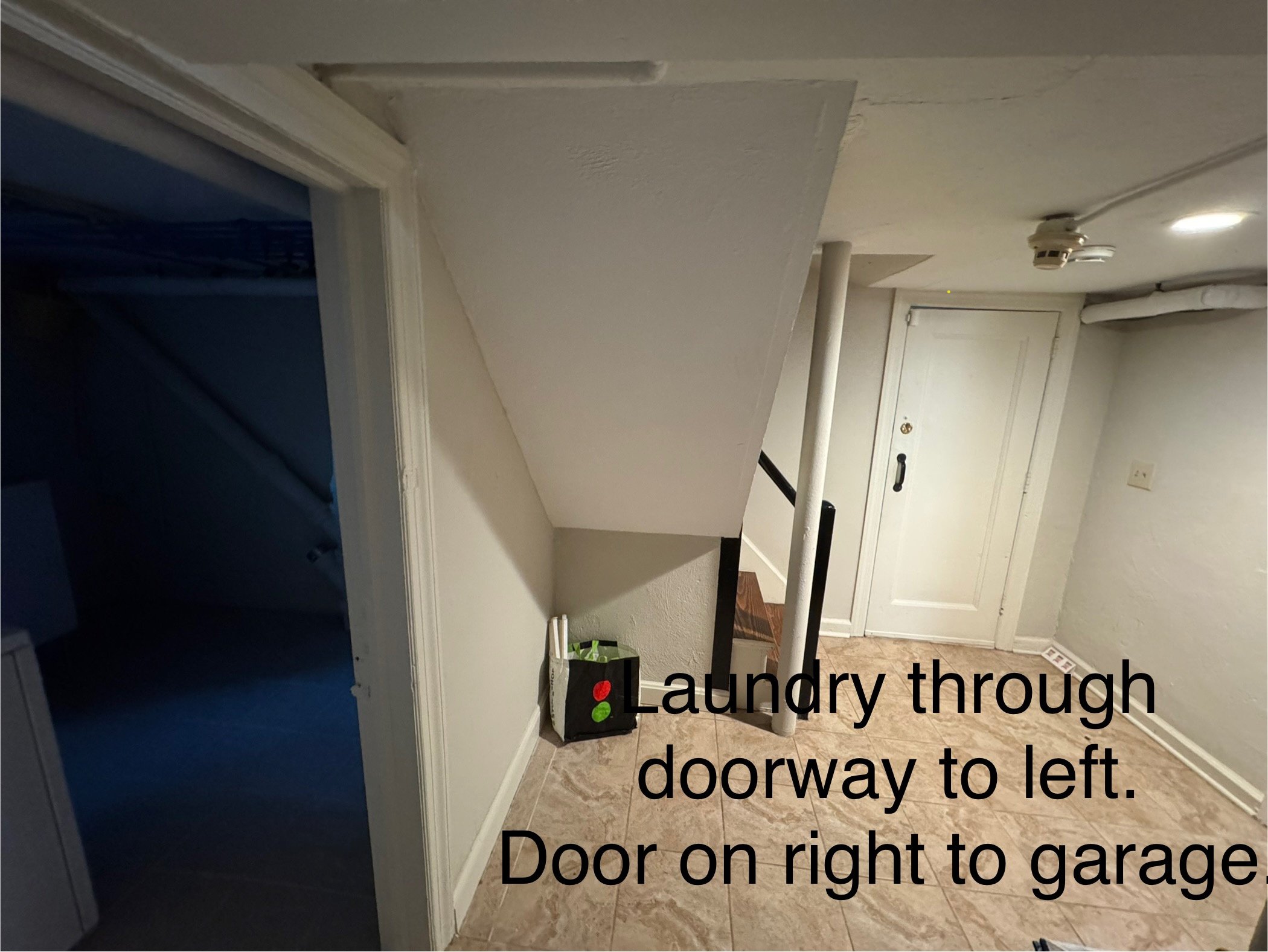

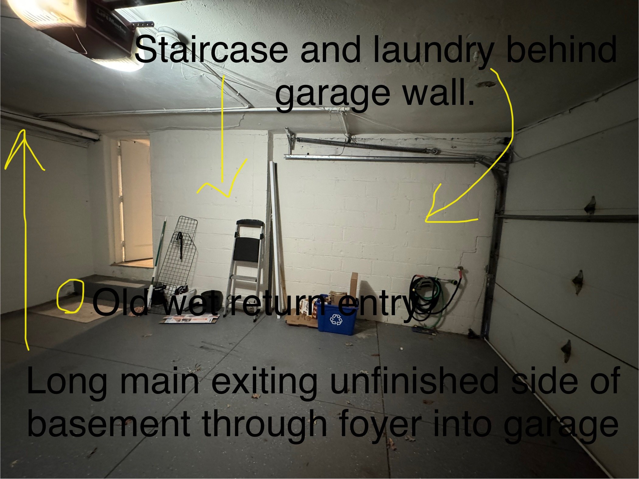

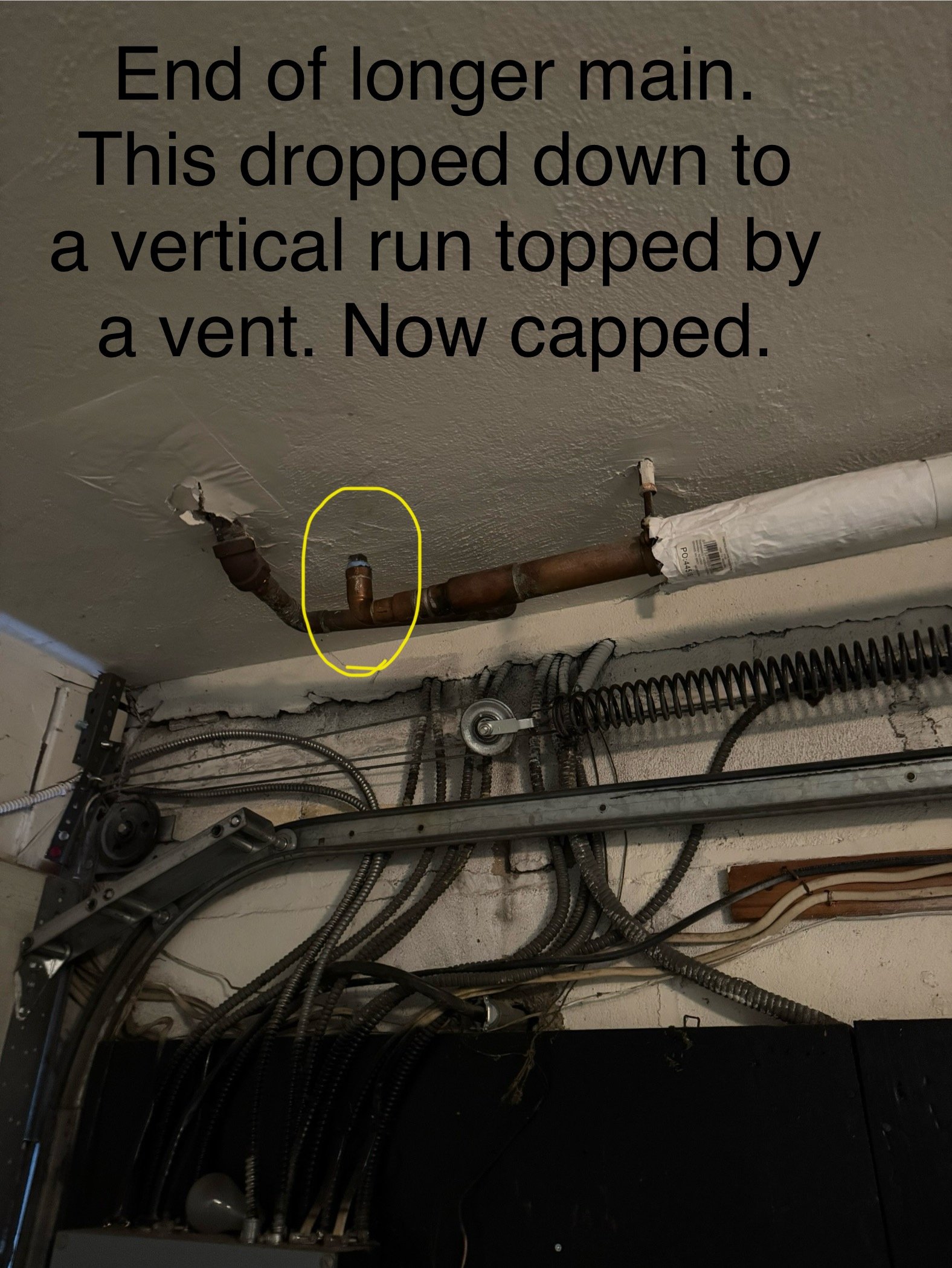

Photos below.
"decision was made based on some of the existing set up, to vent the mains and not repipe a return. "
That's pretty spectacular.
I'm sure everyone has already said it, but the venting has absolutely nothing to do with the return. The water isn't coming back after it leaves as steam because it has no return.

This can't be fixed by looking at pictures. A small condensate pump may be the fix if repiping low is not an option.

you could also run each drip as a separate dry return just under the main until you get to a place where you can run along the floor to the boiler or run the wet return in a completely different path from the current one. remember it doesn't need slope, it just needs to stay a certain distance below the water line.
i think it is very likely it can be done without a condensate tank.

I see several options that would avoid the stairs.
If the foyer is above the basement the return for the long main may be able to enter the basement just above the step but below the actual house floor. So a steam main extension dropping into a drip next to the doorway. Once in the basement it should not be a big deal.

The most creative solution I see is bringing the end of the main in the garage over the garage door as a dry return then either dropping it and the other main in to a wet return and bringing that around the perimeter to the boiler together or brining them separately around as dry returns and at some point dropping them down in to a wet return that goes to the boiler.

Looking at at the pictures some more this probably would have been an easy repair for someone experienced with steam heating.
The return pipe in the garage from the far corner of the garage to the step under the door, was it mostly up high or down low or under the garage floor ?

Where is your old return pipe that should be re-installed or maybe now replaced ?
One Pipe System0 -
you could even bring the return from the laundry room end of the main in to the garage and run it as a dry return back to the unfinished space if you didn't want that return in the finished space. Would have to turn it in to a wet return at the door to run it under the threshold of the door.

On the long main it is already exposed in finished space so just having the return right below it seems the easiest solution vs digging up the floor in a finished room, just drop it down back at the boiler.
