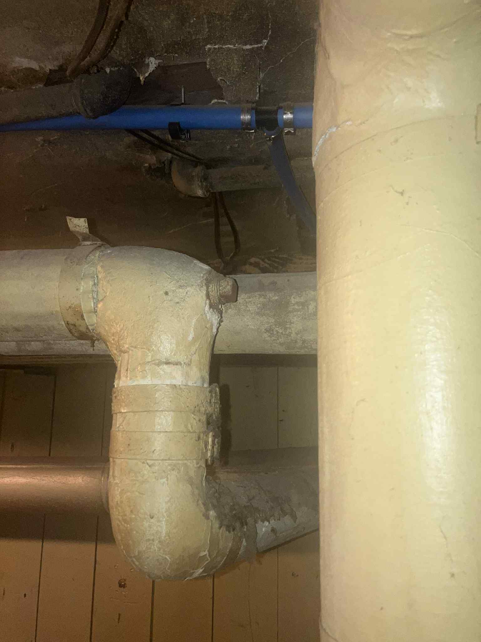

Hi,
I'm by no stretch a master at steam heat, but it's been pointed out to me on several occasions that the "main vents" in my steam system(s) have been plugged (I say systems because I have a duplex with separate boilers).
Long story short, I am wondering if A) it's a good idea to replace the plugs with new main vents (something like this) and B) what are the proper fittings and vents that I need in order to properly install main vents again. In one of my units it appears that there is only one plug, in the other it appears that there are two spots that have been plugged. Should any and all plugs receive a new vent?
Please see the images below:
Unit A:
Unit B:

    If there are no other main vents in your system, you would most likely benefit from installing main vents. Have you inspected the actual far end of the mains for vents. At the pipe transition from steam main to steam main extension, often called a dry return (typically the farthest point away from the boiler).
    If those (pictured) pipe plugs are removed and those tappings are used the main vent should be offset vertically then horizontally so to minimize any damage from water hammer. Main vents usually have 1/2 or 3/4 inch pipe threads.
    If there is more than one main from a single boiler, each main should be vented to best balance the venting of the steam mains.
    Gorton #1 and Gorton #2 and Barnes & Jones Big Mouth BJ-2BM / BJ-3BM are popular main vents.

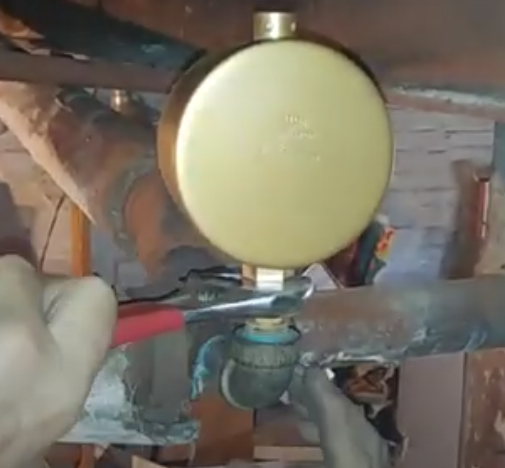

    Does this installation look correct (just found this on youtube)? It has a small horizontal fitting, a 90 degree fitting, and then the vent itself is installed.
    mattmia2 Member Posts: 15,653
    It should have a taller riser, ideally around 8"-10"

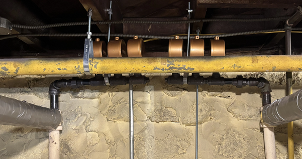

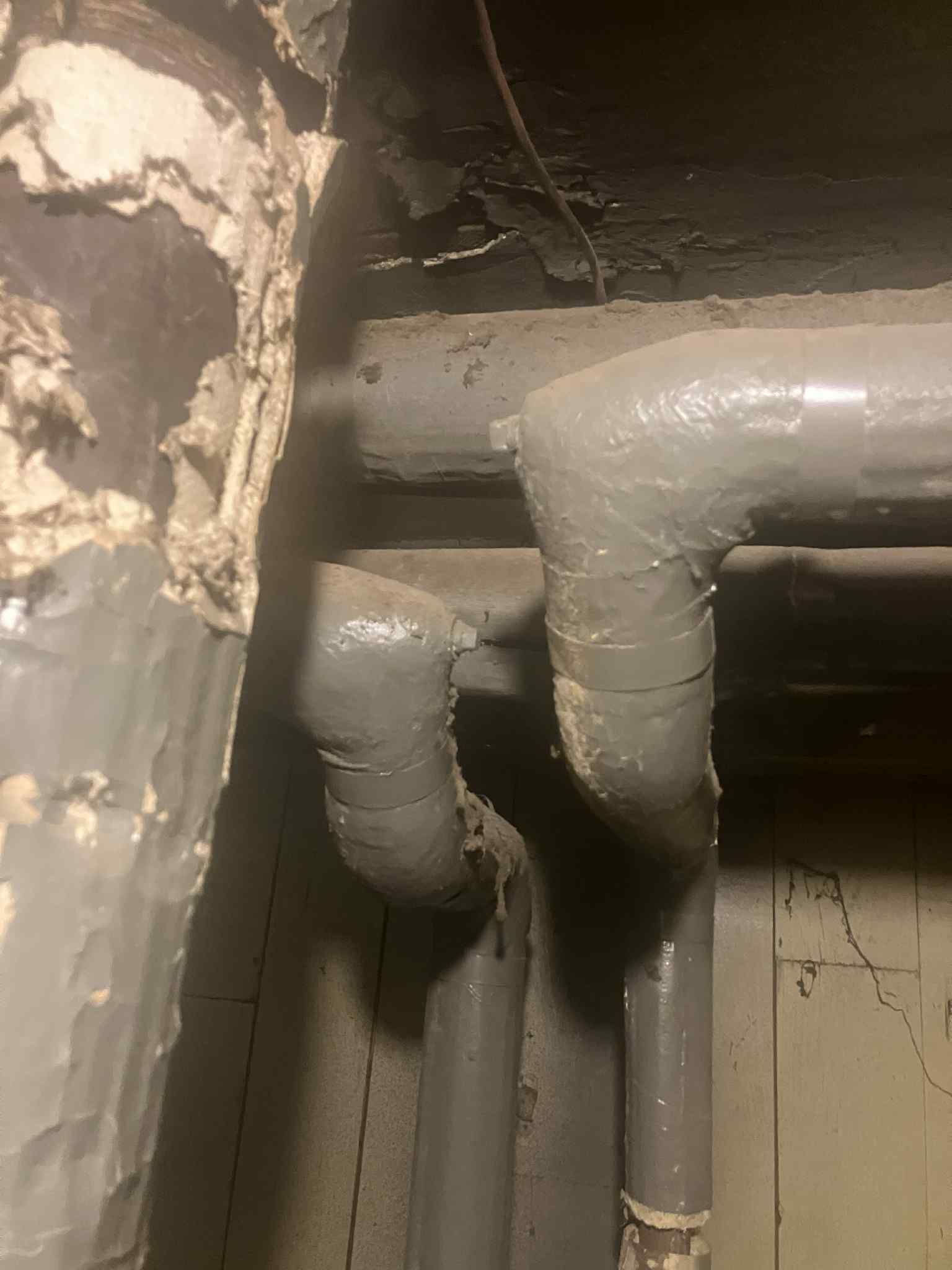

    Ignore the beautiful electrical work going on connecting my thermostat and boiler. Could you help me understand which is my "main"? Thanks.
    Jamie Hall Member Posts: 26,855
    The "main". Start with the pipe coming straight up from the T on the side of the boiler in the first picture. That's the beginning of your main, and it remains a main all around the basement until you get to the very last radiator takeoff. It may split, in which case you now have two mains…
    And it needs to be vented, which can be done anywhere after the last radiator takeoff and before it drops to the boiler.
    Now it looks as though you have at least two drops — they're also in that first picture — and it looks as though one of them may have a pipe from a near floor level pipe, which probably picks up a drop somewhere else in the basement. Problem. Those to drops join above the water line, and that may give some problems. Have to see more to know.
    Problem number two: the insulation on those pipes has asbestos…

    This would have been ok on the original boiler with a water line that was above this point, it is not ok with this boiler where it is now above the water line as @Jamie Hall said.

    If it means anything, as @mattmia2 noted, there are two boilers (house is a duplex), and the boiler in subject supplies heat to the 2nd floor of the house and nothing on the first floor, just for what it is worth.
    Also, it sounds like you are saying that neither of these plugs are part of the line that would be considered the main.
    The issue that you are both signaling, I presume has been there for a long, long time. I had to have a thermopile replaced on this boiler last winter, and the HVAC co. laughed when they realized how old my boiler(s) are (1970 - 1975 or so). I guess the point is… not knowing how much time I have left on these boilers, is it even worth doing anything at this stage on either the drop issue you are talking about, or adding vents to my main?
    I plan to just wrap the insulation where there is asbestos, I don't see a reason to do anything else.

    Those are probably dry returns/main extensions and those plugs are probably where the main vents were. Without main vents you will have the problem that having the returns connect above the water line causes all the time, namely that the air can't get out of one (or in this case both) of the mains.
    That asbestos looks like it would come loose if you tried to wrap it in something.

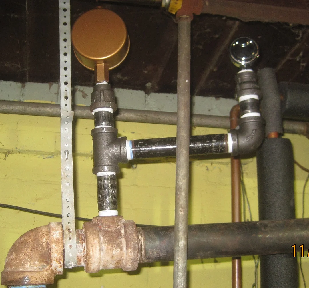

    I successfully removed the plugs. They happened to be 3/8" diameter squares, so what I ended up doing was taking a 3/8" socket drive bit adapter, placing the female socket side on the plug, and then using a crescent wrench on the male side (with a small piece of 1.25" cast iron pipe for leverage) to remove the plugs and it worked really well. I did add some heat which I think made a difference.
    Here's my installs - I think they turned out well, and they were actually pretty fun to do (not as messy / involved as other house projects). I probably could have used a few less pieces but the store I went to didn't have every single side reducer / bushing / etc. I didn't remove any ceiling for smaller vent (I could have to add a taller riser), but I did for the larger Gorton. I needed to move that one out of the way of the main above it, hence the direction - I'm not sure why I used a 45 degree fitting for the first turn, other than that I was thinking it would vent more easily with 45 degree fittings vs. 90 degree fittings (could be wrong and it doesn't matter). I am little concerned that the small street 90's that I had to use for the initial fitting will wear down over time but I could always add some support with like a string to the joists to vent trees / etc.
    I'm not sure how to assess how well they work, although I will say I have not heard any whistling from my radiator vents anymore (something that was pretty common before).
    vent #1:
    vent #2:
    let me know how they look - I need to do this exercise again for my other unit, so any feedback will help me with that install.
