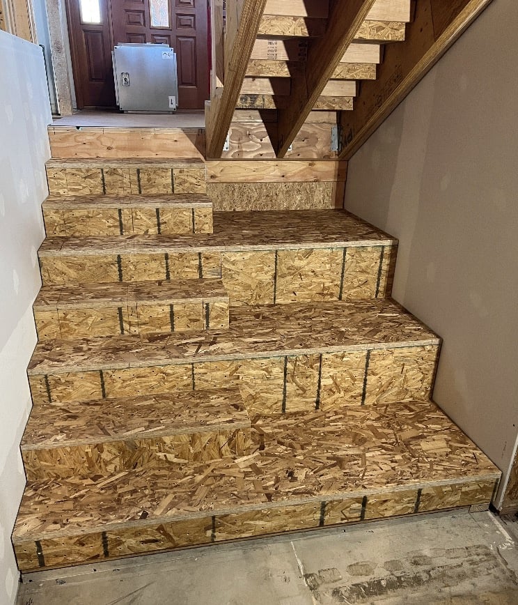

I came to the conclusion over night that I likely won't know if I have groundwater here, without some tests, which can be expensive. On Jamie and DCContrarian's point, I don't know how significantly ground water or moist soil affects the overall heat loss, other than it's notable. My calcs, which are old and in Uponor's old ADS program jump up about 25% when I check the 'groundwater within 6' checkbox. I also saw postings here about natural gas consumption doubling or tripling. Is one of these closer to the truth than the other? I will ask my radiant guy to also re-run his numbers with groundwater considered.
I spent an hour on the phone with my architect friend today. Since the company doing the soil studies for septic and construction near by is no longer in business, he gave me the name of the guy who had worked for them and took over. I will check with him.
@Jamie Hall and @DCContrarian - The original plan I had built the stairs to was for a slim assembly. 1" EPS or XPS insulation, 1/2" loops, and 1-1/4" concrete over the insulation - so 2-1/4" assembly. My radiant guy said more insulation was better, but that I could get by with an inch. He mentioned 1-1/4 to 1-1/2" on the pour, with the right mixture. In my case, I am basing the 1-1/4" at the high point of the slab, as it has settled 1/4 to 3/4" lower across much of it, and of course we'd pour level. Note: no major cracking of the slab.
Headroom is tight. With the planned 2-1/4" makeup, I will have finished ceiling height AFF of 7' 8-3/4" for most of the basement, and 7' 7" in one bedroom, with one bathroom at 7' 6-1/2". Equally notable is that several of the door headers are structural beams. So, with any increase in height, I'm cutting down 80" doors. Not the end of the world, but would like to minimize.
After talking with my architect friend, we decide it should be OK to go up to 1-1/2" and possibly 2" thick insulation, with some sacrifices.
I know Jaime mentioned 2-4" insulation. Do you all think that getting to 2" insulation beneath the pour, such that regardless of any ground water, my losses should be reasonable?

One of the killers with the radiators is I would have to rebuild the stairs, which was a long, slow process for me, though very much crafted, true, and robust to last a lifetime. I think just the framing materials to rebuild those is probably over $1000 today. I'd rather invest that in making the place comfortable.

Usually the biggest issue with raising the floor is stairs, you want all the risers to be the same height and all of a sudden the bottom step is a couple inches less than the others. You then need to either cut new stringers or split the extra height over the stairs and pad each one a variable amount.

@DCContrarian - yes, agreed - if I add an inch of insulation, I just need to add to each riser and glue it down, given no flooring is installed yet - I won't pass inspection if the steps don't meet IRC's 3/8" differential requirement. Going the other direction is definitely a bigger problem :) If I was going to shift plans to just using radiators, I'd have to consider rebuilding the stairs :(
