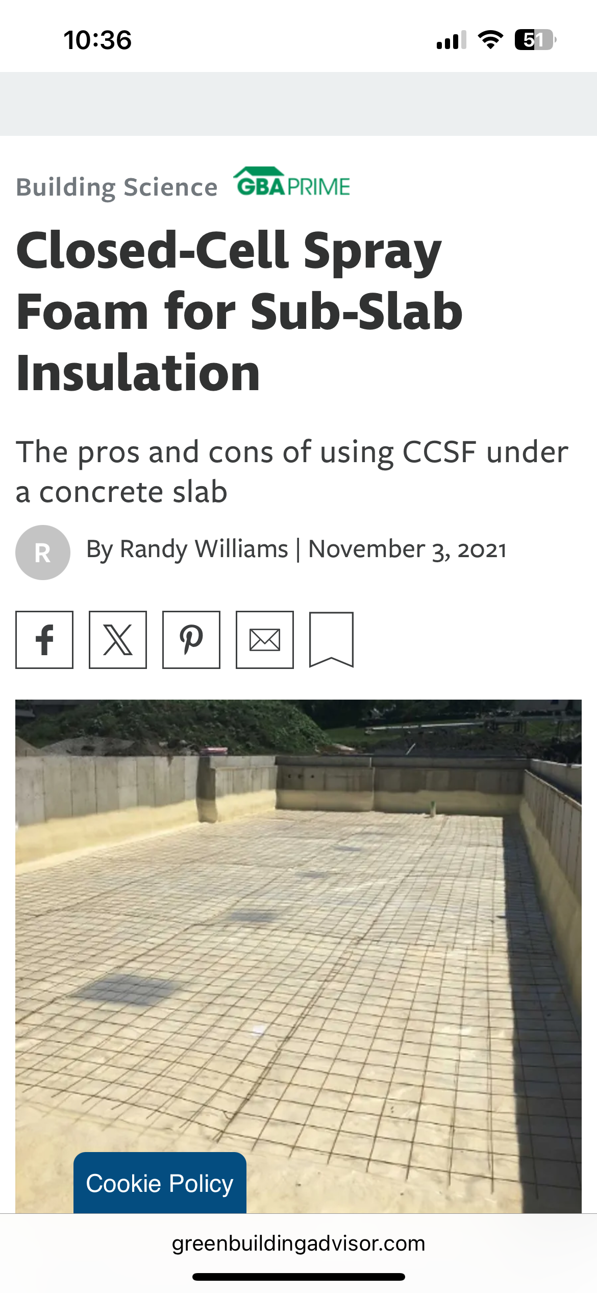

I'm planning to add insulation, radiant loops, thin concrete layer over 1960s slab, 4' below grade in an area that heats Mid-Oct to mid-May.
Then it happened Friday. I read a comment on this forum about ground water within 6'. I spent the weekend shooting elevations and reviewing neighbor soil tests. There is also a good sized farm irrigation ditch that crosses the property, running mid-May to July. My conclusion is #1) likely high groundwater while the ditch runs and a little after and… #2) possibly within the 6' zone at other times, but hard to know for sure. Could be a foot or two above or below.
Local average groundwater temps are 51F. Slab relative humidity (when it's been checked) ranges from 70%-99% RH.
I don't mind the situation #1. It seems #2 could be an issue.
a) how bad is this, practically?
b) are there any 'not quite full' soil tests that allow you to gauge water table level without spending big bucks?
c) open to any other information. Also have a diagram summarizing what is known that I can share… but it's complex.
Thanks, guys.

    Based on commentary here by @hot_rod and @Kaos I did look closely at just insulating the slab and using panel radiators. And with the uncertainty of conditions below the slab and my wife wanting to put out more area rugs than the at-the-edge radiant design would have probably allowed, it's looking desirable.
    Initial budget says it will actually cost us $2-5k more, much of which relates to the slab condition and prep. One thing that prevents us from just laying foam and OSB is a sunken end of the house (slopes down up to 7/8" over 6') and a former garage floor that slopes to a drain.
    This has me thinking about 1-1/2" of closed cell spray foam + min 1-3/8" concrete (no heat). This would be without tubing in the floor, but would be a water tolerant assembly, should any flooding occur (and I've had basements with water, before). Hot Rod - you had mentioned the spray foam in another thread. You also seem to have good knowledge on the concrete side. Do you think this could be a reasonable over-slab insulation+subfloor system? I notice the ccsf also absorbs more water than xps or eps. Do you have any insight as to if that could lead to curing issues on the thin slab?
    hot_rod Member Posts: 27,904
    plenty if opinions on closed cell foam under ir on concrete
    The source explains pros and cons
    A fellow on you tube named Spray Jones seems knowledgeable
    https://www.greenbuildingadvisor.com/article/insulating-below-a-slab-with-closed-cell-spray-foam
  • rossn
    rossn Member Posts: 136
    edited November 2025
    Thanks for sharing those resources, Bob. I will check them out. I had not seen Spray Jones, and did find one concrete guy on YouTube that has done 500-1000 thin pours for radiant, so I did reach out to see if he's done any over spray foam.
