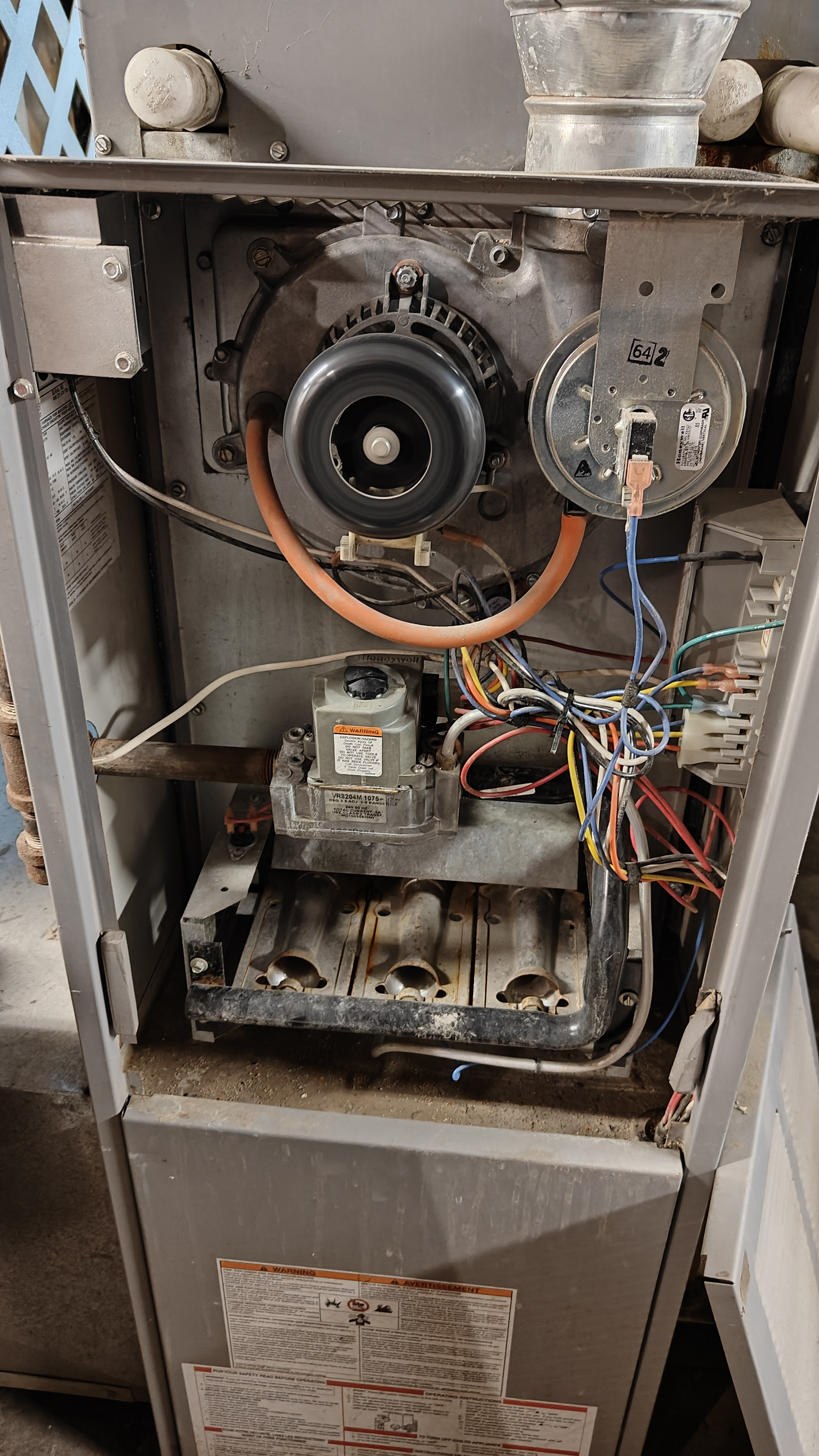

We have a temp star NG furnace in one of our small storefront units and it was installed over 20 years ago and has worked flawlessly since.
Yesterday we tried to turn on the heat and the furnace comes on and I hear the ignitor sparking but we get no flame.
Any easy checks before we have to call the pro?
Thanks in advance.

Make sure the gas is turned on.
I would then check for 24 volts at the PV (pilot valve) terminals on the gas valve and also the PV terminals on the ignition control module on the right hand wall in your picture.

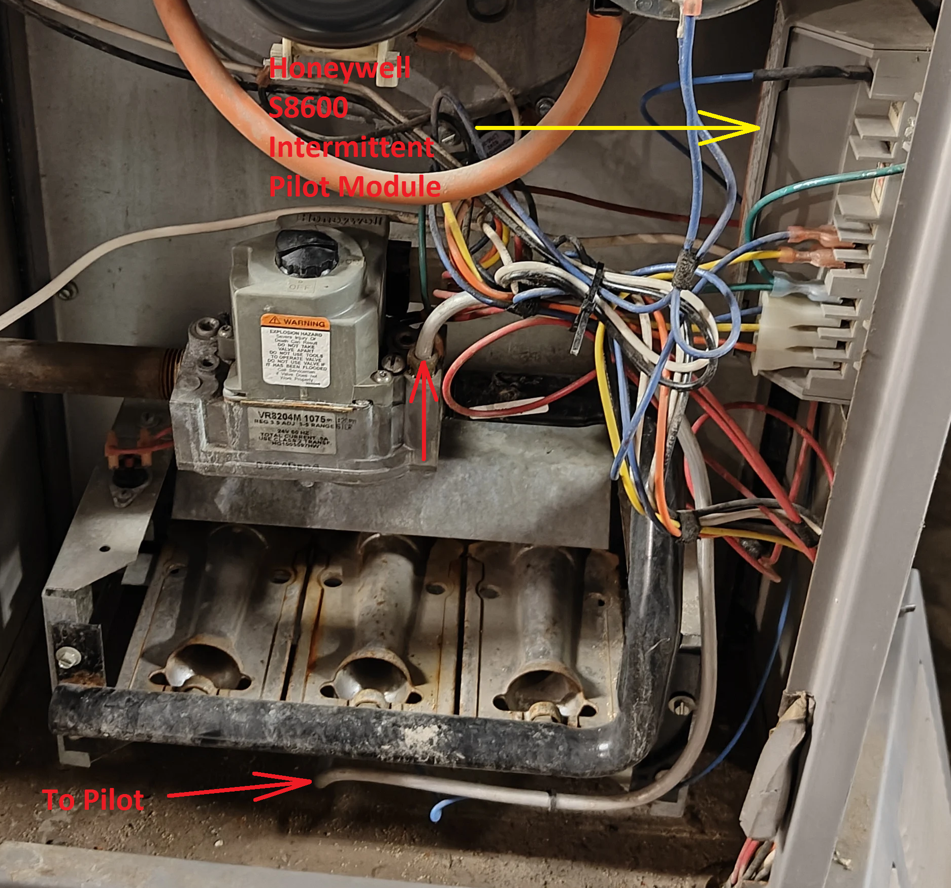

This wiring diagram may help if you have a multi-meter.
Some troubleshooting information here, Honeywell S8600 Intermittent Pilot Module .
https://customer.resideo.com/resources/Techlit/TechLitDocuments/69-0000s/69-0463.pdf
The spark only lights the pilot. Check for the presence of the pilot, if it lights and goes out the igniter / sensor rod may need cleaning, pilot quality, pilot orifice restricted, loose ground wires. No pilot at all, plugged pilot orifice, electrical issue, S8600 issue, gas valve issue .

I don't think it has a pilot....🤷🏽

The tube (Red arrows) goes from the Gas valve to the pilot assembly. If the pilot does not light and prove for a period of time the burner will never light. The Blue wire to the Right of the pilot assembly in the picture goes to the igniter / sensor rod at the pilot assembly.

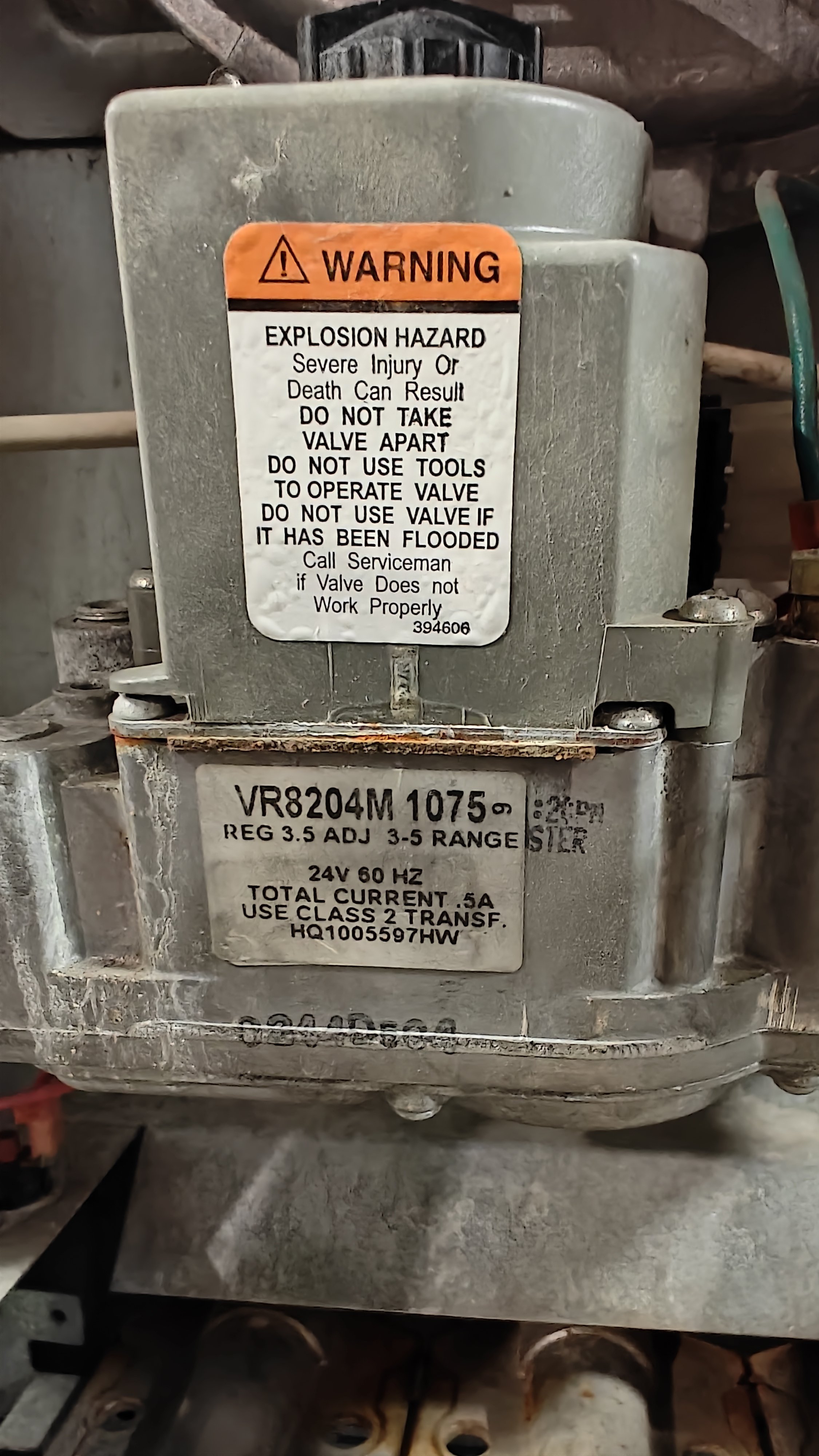

I'm getting 39-40 volts between pv. And mv/pv at the gas valve.

Don't know if this is bad but it looks old enough to replace. Lol

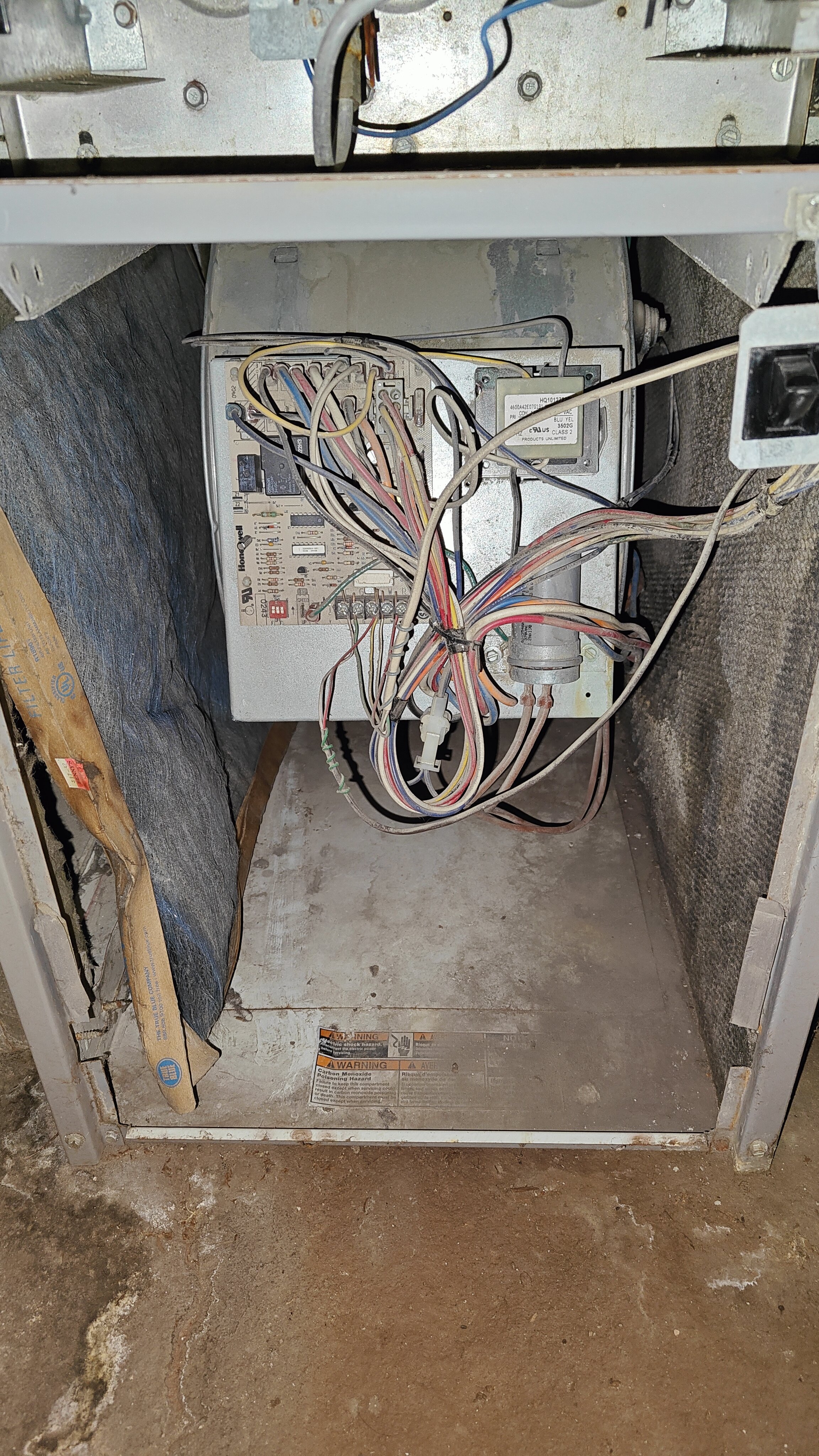

That is not the reading you want. At the circuit board with a call for heat , measure across C and W. It should be 24-28 volts. Also measure across R and W. It should be 0 volts. Anything other than 0 is a problem.
39-40 volts seems oddly high. Does your meter work correctly ?
During a thermostat call for heat there there should be a nominal 24 VAC across C and W and C to R (Red box), if not verify the 120 and 24 VAC at the transformer (Orange box). In normal operation with normal voltages the control board applies 24 VAC to the S8600 Intermittent Pilot Module at the 24V & 24V GND terminals (Green box) which seems like that was happening since you were hearing spark. During the spark the S8600 Intermittent Pilot Module applies 24VAC to the PV & MV/PV terminals of the gas valve (Blue box) the pilot should then light. After the pilot is active for the trial time the S8600 Intermittent Pilot Module applies 24 VAC to the MV & MV/PV terminals to open the main gas valve. That pilot assembly looks excessively crusty, may work OK if cleaned up. Would not surprise me if the pilot orifice is corroded closed or blocked.
