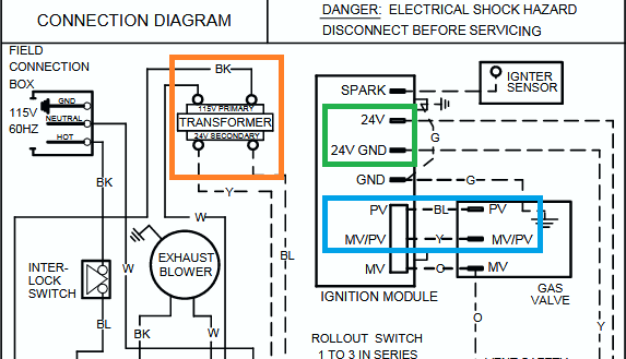

    This wiring diagram may help if you have a multi-meter.
    https://www.shareddocs.com/hvac/docs/1011/Public/01/40101260301_ICP_6818.pdf
    Some troubleshooting information here, Honeywell S8600 Intermittent Pilot Module .
    https://customer.resideo.com/resources/Techlit/TechLitDocuments/69-0000s/69-0463.pdf

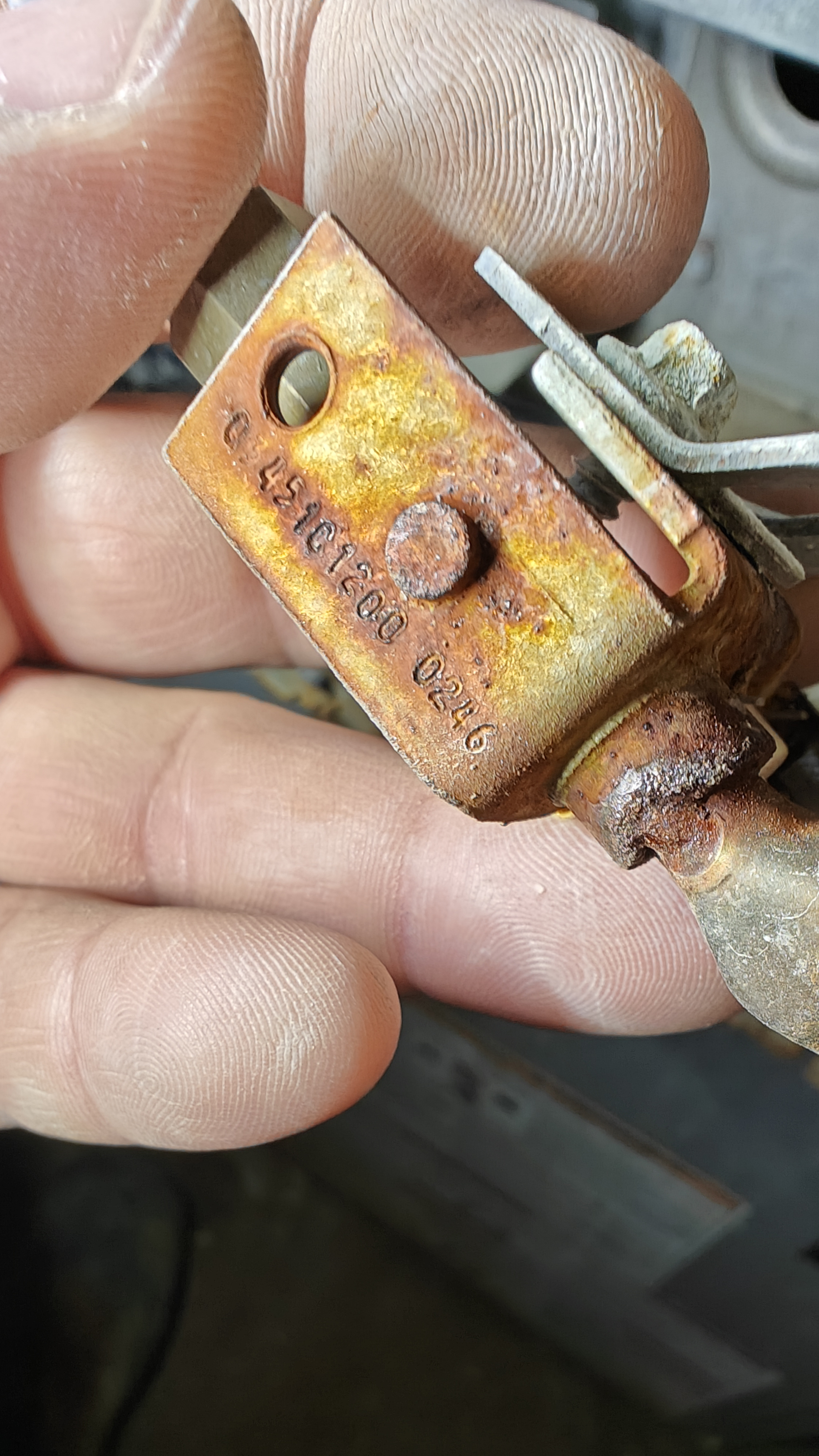

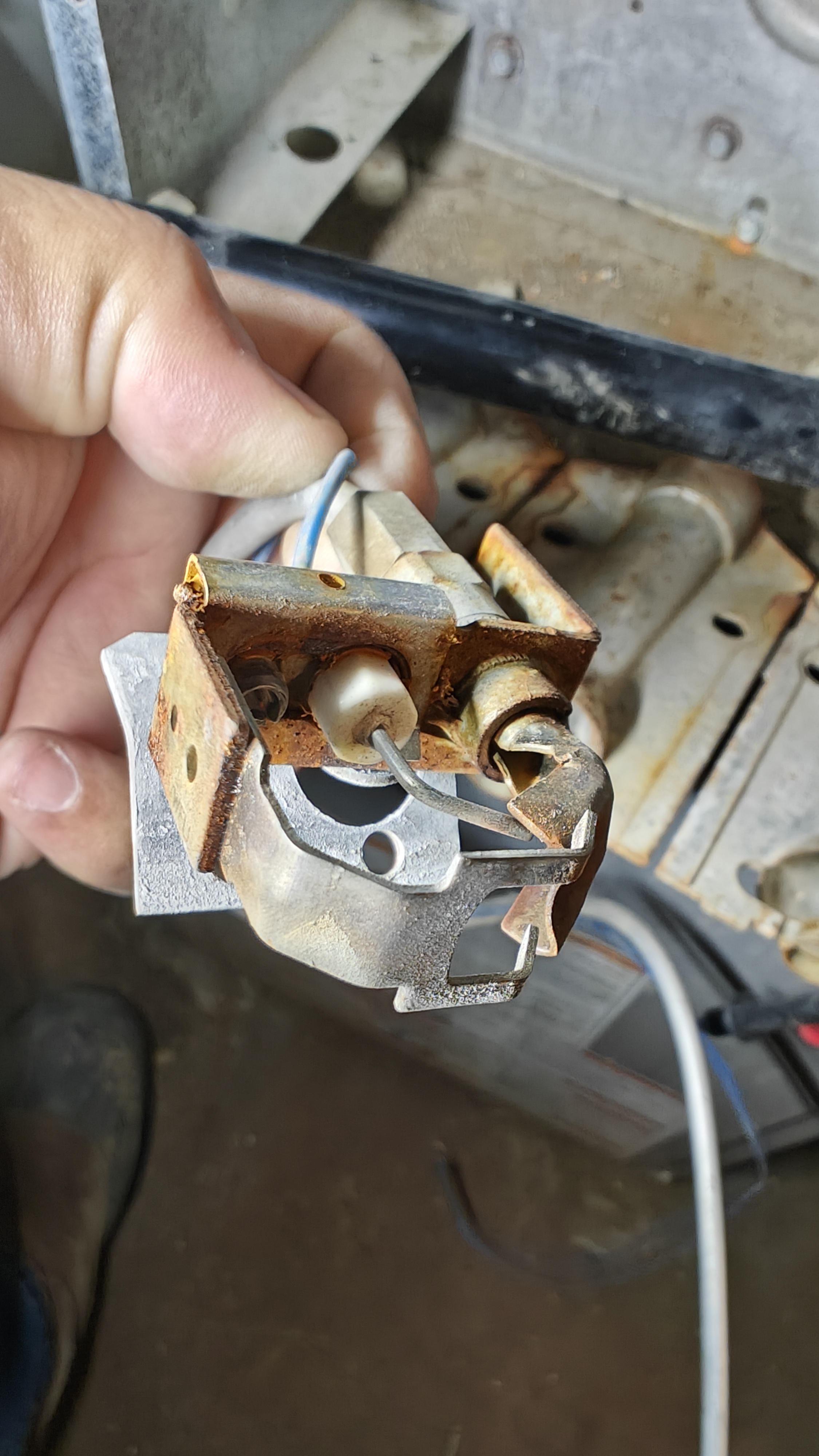

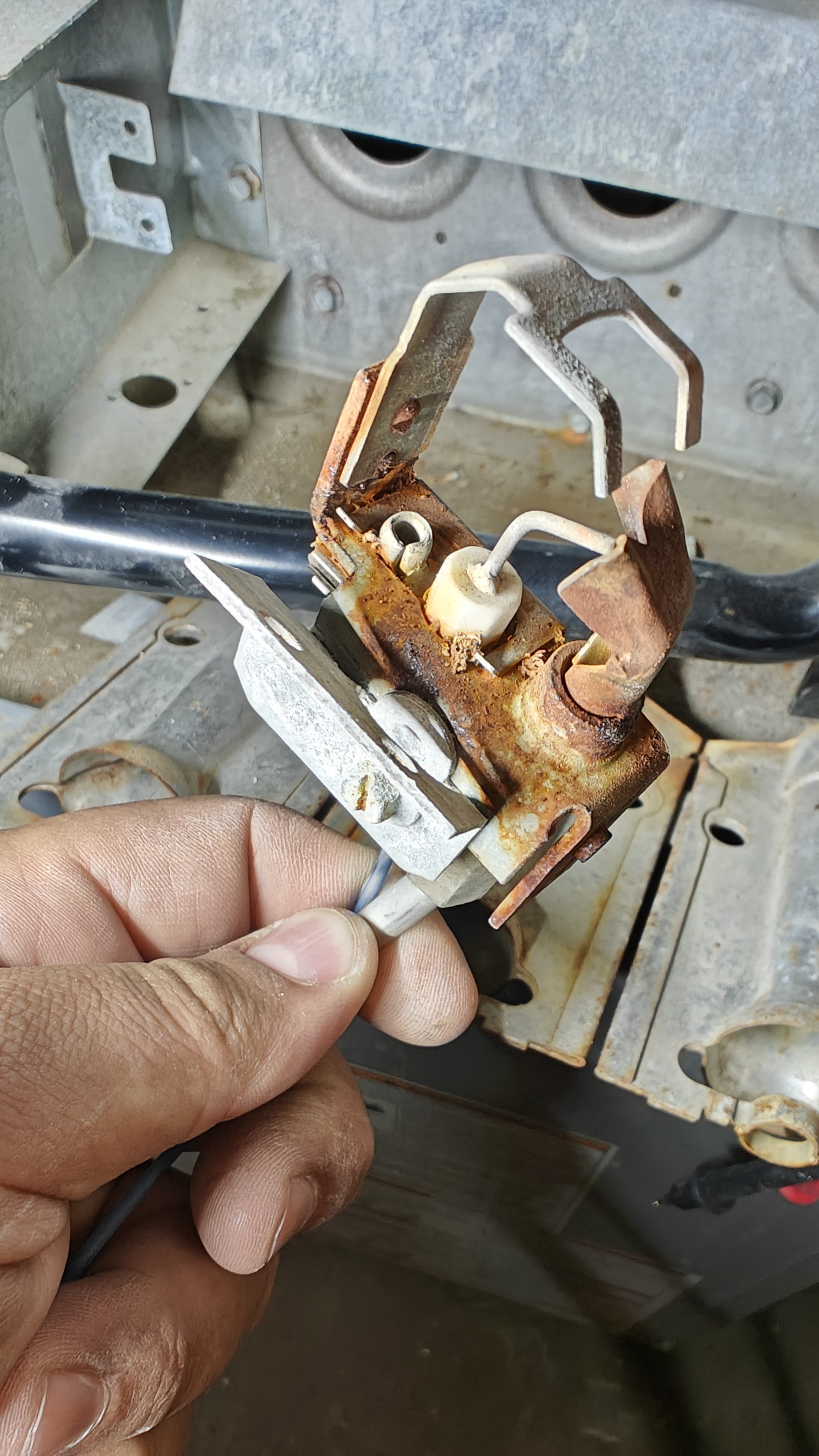

  • brandonf
    brandonf Posts: 229
    Don't know if this is bad but it looks old enough to replace. Lol

    the pilot is not lighting and you don't smell gas? either you have no gas to the appliance, the valve is bad, or the pilot orifice is plugged if there is no gas smell or sound.
  • Has that pilot burner ever been under water?
    That would mean the main burners were under water too and possibly the gas control valve

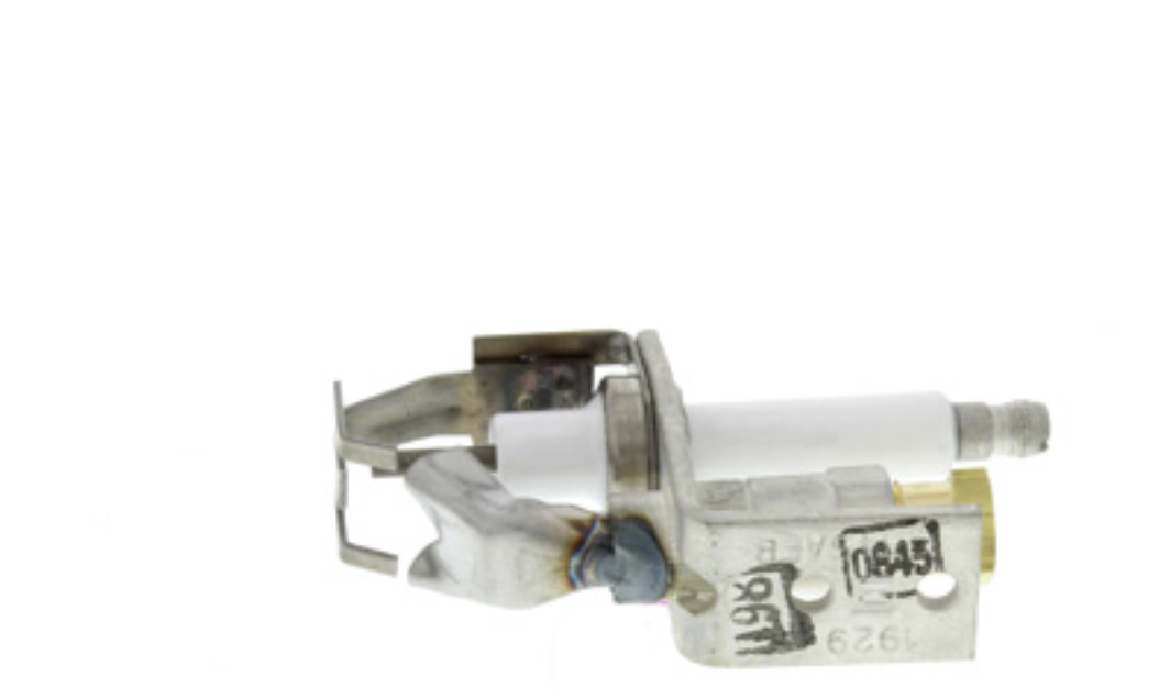

  • this looks like something that will work
    You may also need a new spark cable since the blue one may not be the type that will disconnect from the old and connect to the new
    Here is the part: Honeywell/Resideo Q345A
    Here is the replacement cable 25" Ignition cable
    Is there a gap between the probe and the shell of the pilot burner?

    That is not the reading you want. At the circuit board with a call for heat , measure across C and W. It should be 24-28 volts. Also measure across R and W. It should be 0 volts. Anything other than 0 is a problem.
    109A_5 Posts: 4,761
    39-40 volts seems oddly high. Does your meter work correctly ?
    During a thermostat call for heat there there should be a nominal 24 VAC across C and W and C to R (Red box), if not verify the 120 and 24 VAC at the transformer (Orange box). In normal operation with normal voltages the control board applies 24 VAC to the S8600 Intermittent Pilot Module at the 24V & 24V GND terminals (Green box) which seems like that was happening since you were hearing spark. During the spark the S8600 Intermittent Pilot Module applies 24VAC to the PV & MV/PV terminals of the gas valve (Blue box) the pilot should then light. After the pilot is active for the trial time the S8600 Intermittent Pilot Module applies 24 VAC to the MV & MV/PV terminals to open the main gas valve. That pilot assembly looks excessively crusty, may work OK if cleaned up. Would not surprise me if the pilot orifice is corroded closed or blocked.
