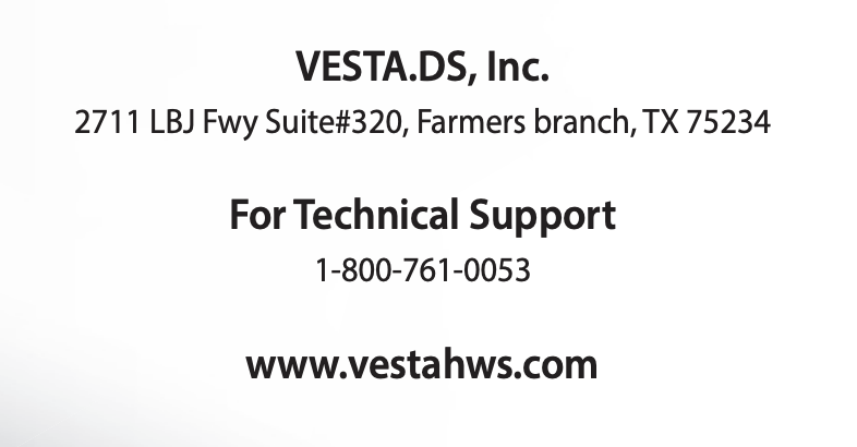

    Most of the temperature sensors will use a thermister that changes resistance based on the temperature. I would try to
    1. Contact Tech support at VESTA in Texas Screenshot 2025-09-24 at 7.28.08 PM.png
    2. If that does not work for you, then try a generic tthermistor like this one:
    https://www.supplyhouse.com/Siemens-QAC2030-Outdoor-Temperature-Sensor-NTC-10K-Ohm-Type-2

    I just called vesta tech support and the guy told me they have them in stock and can ship them out overnight shipping so you might try calling them again! They also told me you could use a 3rd party one for what its worth i didnt ask for that part number i just told them I was trying to help someone locate a sensor for a VRC combi
    1-800-761-0053
