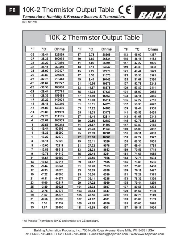

    Pictures like this give me the feeling they are the same part.

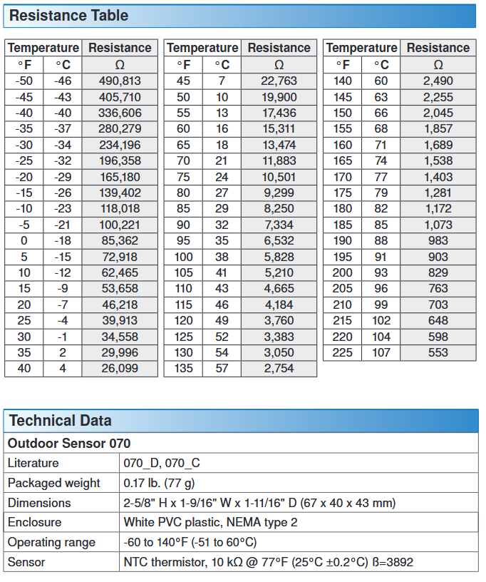

    I suspect it (the Tekmar 070) is very similar to the original unit that @EdTheHeaterMan suggested. The thermistors themselves come is various shapes and sizes (the outer housing of the actual thermistor its self). For outdoor reset functionality the thermistor has to be outside and out of the elements so the thermistor is put in a weather resistant plastic housing for protection.
    A 10K (10,000) Ohm thermistor can have different curves as the temperature changes. Which is where the resistance is at a specific temperature. The 10 K reference resistance is only one point on the curve and it is usually at 25 degree Celsius or 77 degrees Fahrenheit. I believe the Beta = 3892 (Tekmar) or the Type-2 (Siemens QAC2030) defines which graph shows the temperature plot and maybe other characteristics of the thermistor. I suspect they are very similar.
    Tekmar 070
    " Beta = 3892 is the B-constant of an NTC thermistor. (NTC = Negative Temperature Coefficient) "
    " A thermistor "Type-2" is a classification for a thermistor, often with a 10K resistance at 25°C, that has a specific non-linear resistance-temperature curve, designed for use in particular building automation systems and other applications where its unique curve provides accurate temperature readings within its defined operating range. "
    So what I get out of this is, "Type-2" is a term used building automation systems industry.
    Beta or B-constant is more within the thermistor manufacturing industry.
    It would not surprise me that in the -10 degrees Fahrenheit to 68 degrees Fahrenheit range the resistance of these two units would track very close to each other.

    109A_5 Posts: 4,779
    Look like they track pretty close for the practical useful range of outdoor temperatures.
    Tekmar 70
