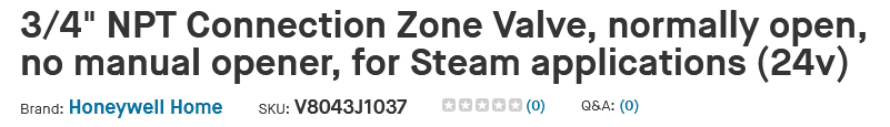

Please recommend what type of valve to use. I was thinking of running a 24v normally open steam solenoid valve which when energized will close the valve and shut off the heat.
Thanks.
    109A_5 Member Posts: 3,954
    Probably something like this.
    https://www.supplyhouse.com/Honeywell-Home-V8043J1037-3-4-NPT-Connection-Zone-Valve-normally-open-no-manual-opener-for-Steam-applications-24v

    Also with 24 VAC valve operators some folks may complain about the humming or any noise they make.
    And since the valve you specified is normally open you would have to use the AC (cooling) functionality of a thermostat to control it. Or add a relay.
