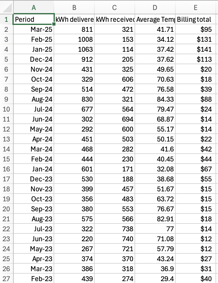

    Here is what 6200W did for my place.

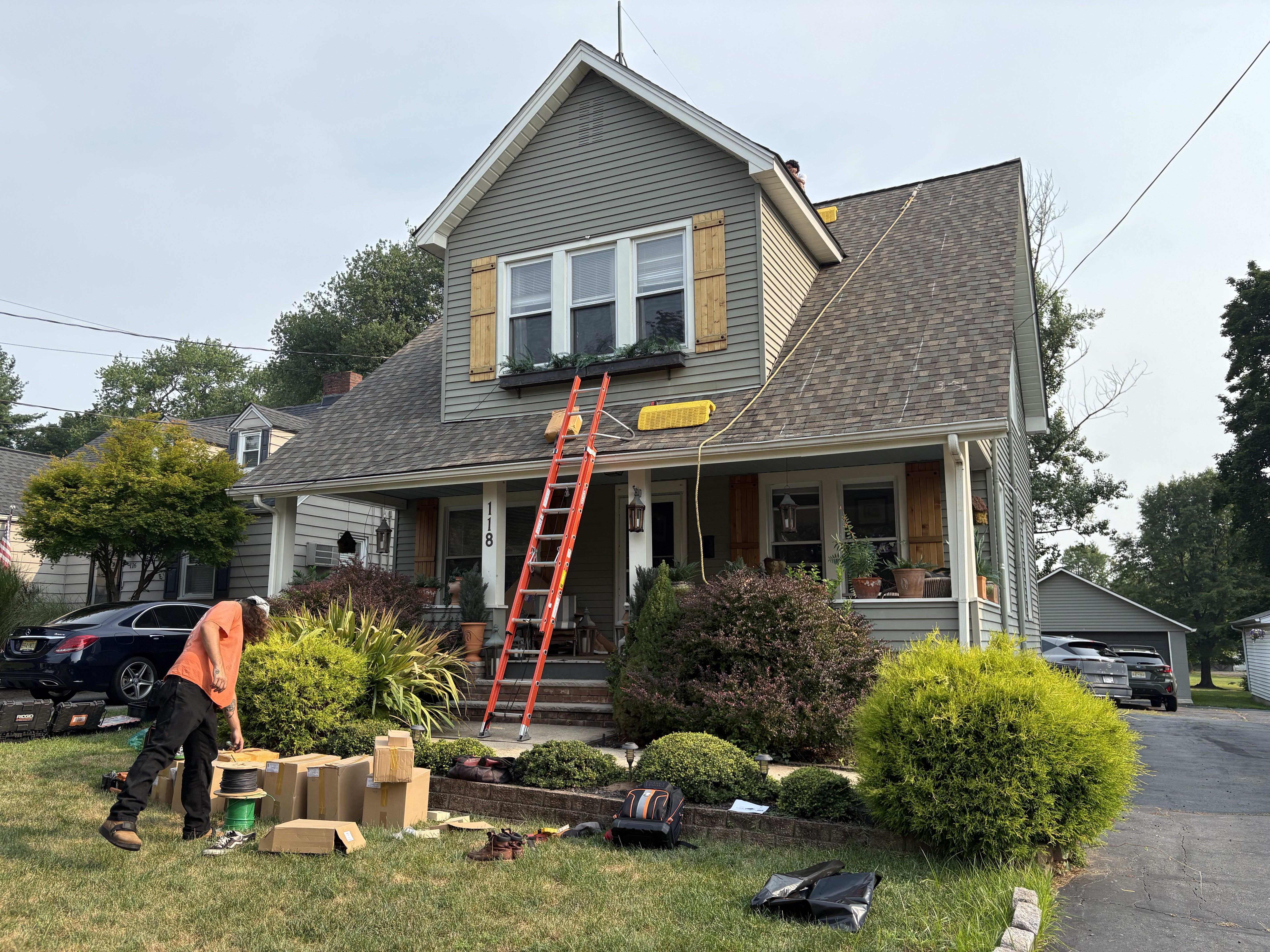

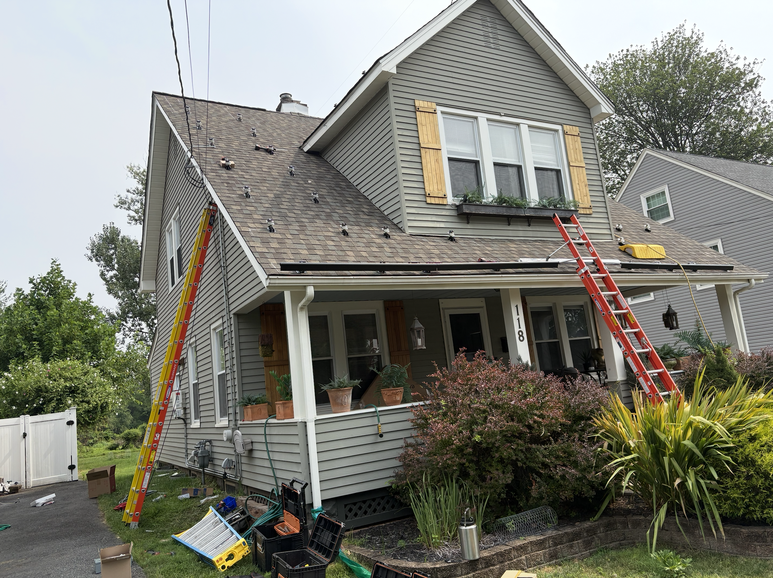

    they got here at 7am. They first had to verify some roof measurements and layout.
    then I helped them locate the first rafter (from the attic) because the “hit the roof with a mallet” method wasn’t working very well because my decking is solid 1915 pine tongue and groove.
    They expect to be done with the installation today
    ethicalpaul Member Posts: 7,786
    10:30am progress

    Pretty house, like your flower boxes. Keeping the upper level window boxes water have proven to be a challenge for us. 😉
    ethicalpaulChrisJAlan (California Radiant) Forbes
    I ran an irrigation line up there which worked pretty well, but even with it, the plants up there get absolutely blasted by the sun all afternoon, so what's up there now is fake plants!

    If it's anything like my house, finding the first rafter is almost irrelevant.
    You'd need to measure every one of them inside, make a drawing and use that because there's nothing consistent. For example, my floor joists, some are 23" OC, some are 24, some are 25, 26 etc. They're all over. Kinda, "hurry up good enough" style.
    I guess the actual distance was far less important before plywood and drywall.
    PC7060ethicalpaulDCContrarian
    yes mine vary between 20” and 22” on center. But the racks can span several rafters so we don’t have to locate each one
    hot_rod Member Posts: 25,416
    sounds like you may need some seismic restraints back there?
    If there is access to the underside of the roof, we found it easier to miss the rafter and block across two of them and anchor to the block. Finding dead center of a rafter from above is not so easy as you may have discovered.
    This was for thermal collectors, fewer mounts required.
    ethicalpaulAlan (California Radiant) Forbes
    mattmia2 Member Posts: 13,676
    Is that thing that looks like roof jacks and planks actually the bottom rail?
    I think it is.

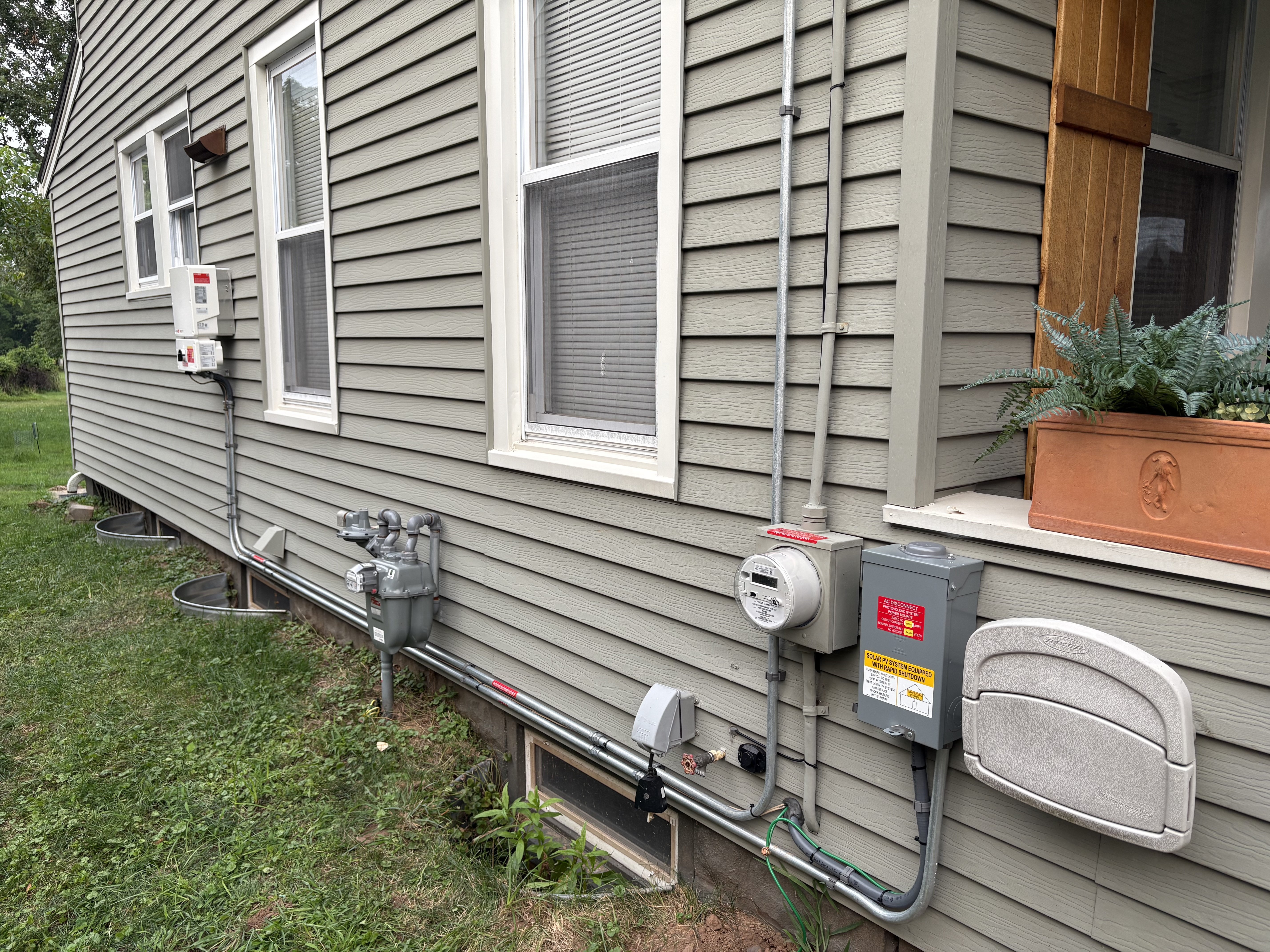

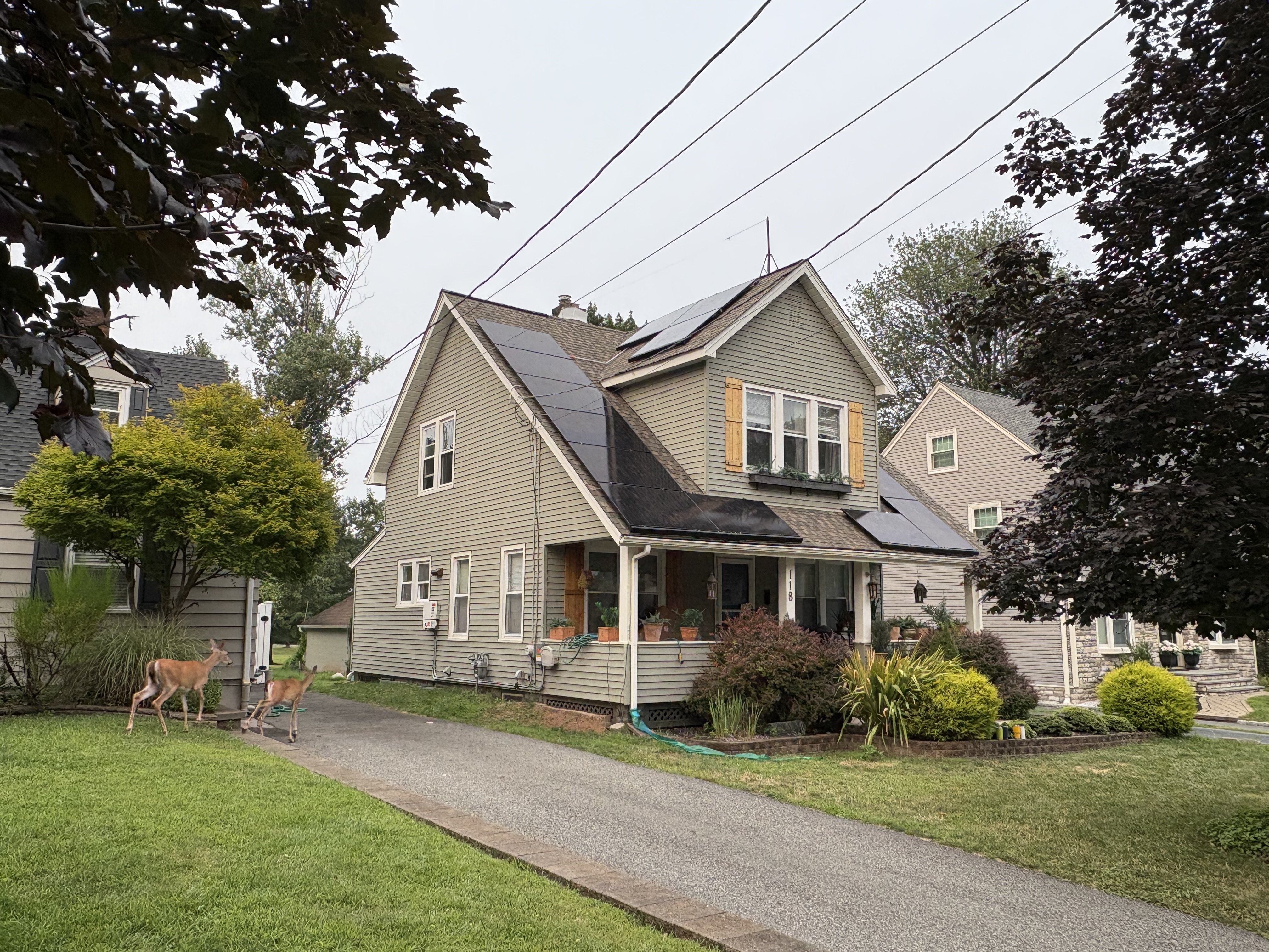

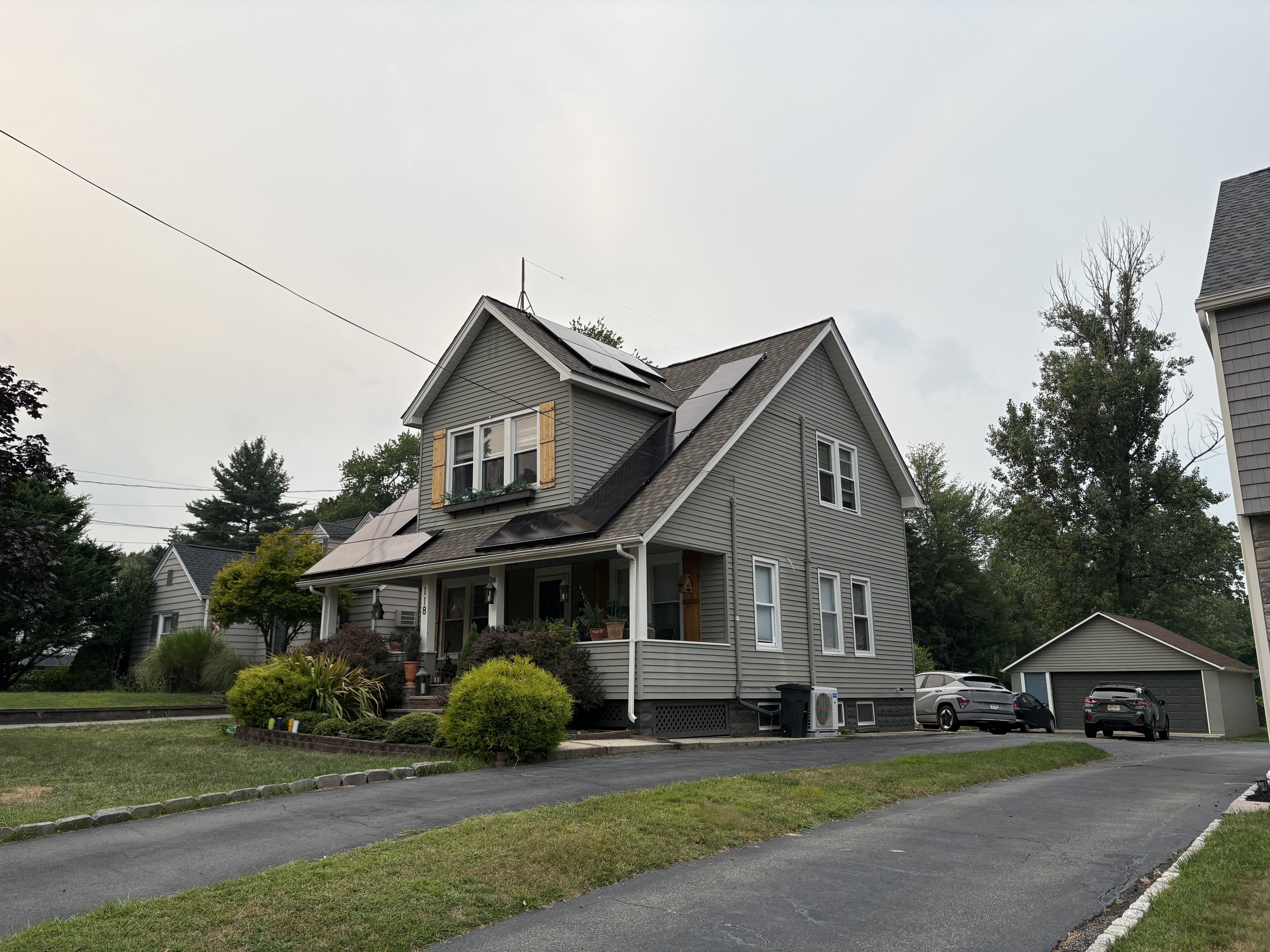

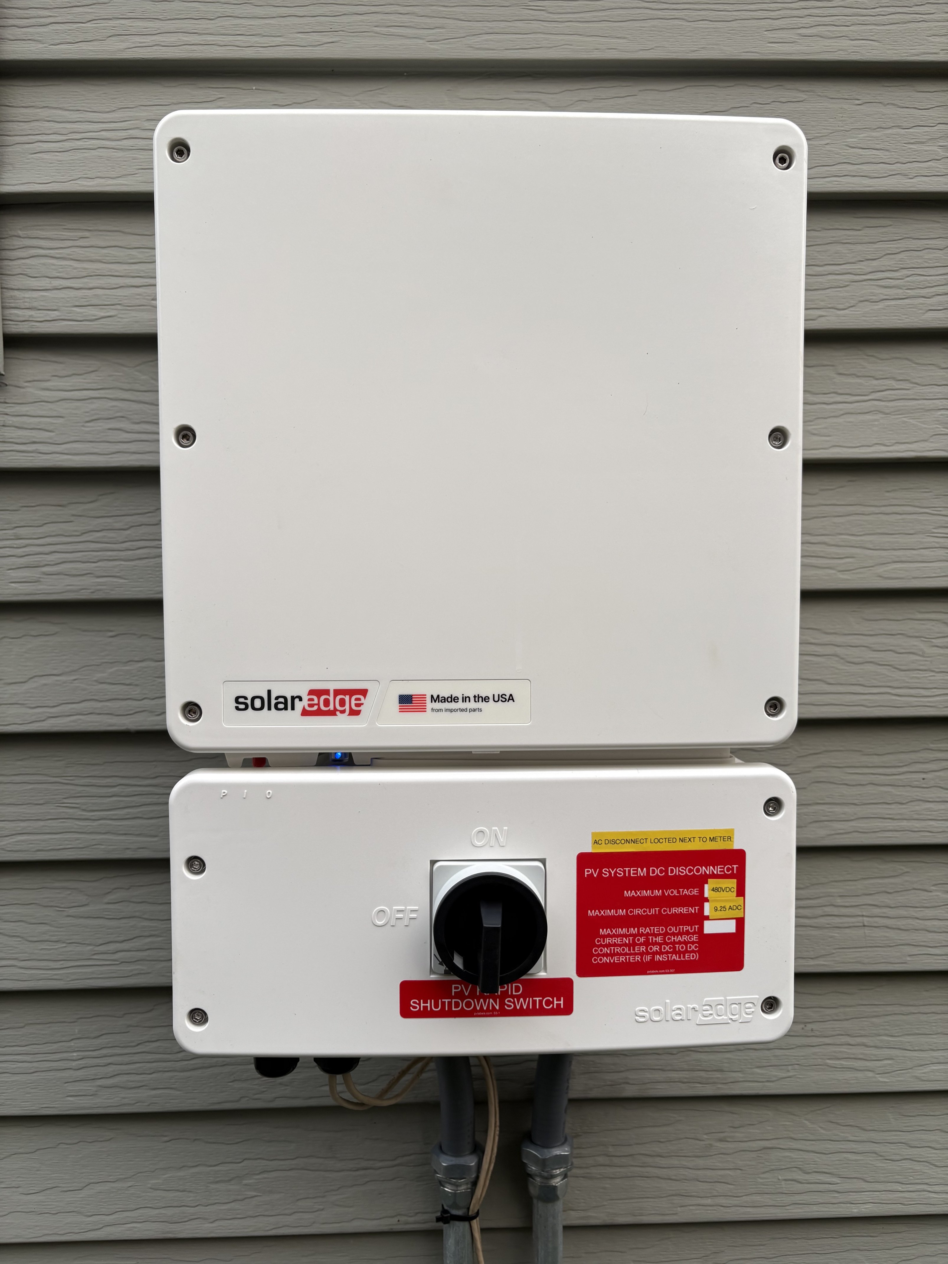

    that’s it! All installed in one day, pretty good! It won’t start operating until it clears inspections. And since my boiler, water heater, and panel upgrade, all performed by me passed, I have a feeling this professional job is gonna be fine.
    without talking prices, this is about the same as a high quality steam boiler install in NJ

    you have a venison problem
    those are some funny looking dogs
    edited August 6
    is that some sort of uhf or microwave antenna on the tripod near the gable?

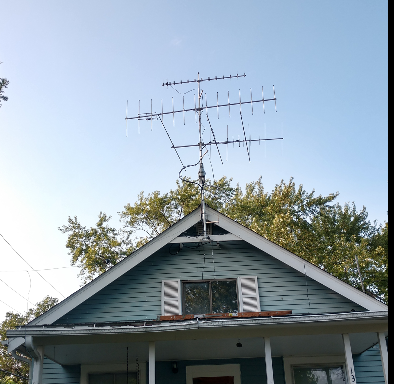

    guess we don’t live in HOAs 😂
    mattmia2OffGridICFCLamb
  • ChrisJ
    ChrisJ Member Posts: 16,871
    If I was in charge of an HOA and someone wanted an armature radio antenna I'd require a decent tower and a reasonably sized yagi. None of this cheesy roof tripod stuff. 😉
    DCContrarianethicalpaulPC7060
    luckily you’re not I guess because that tripod is holding up a wire antenna not a yagi
