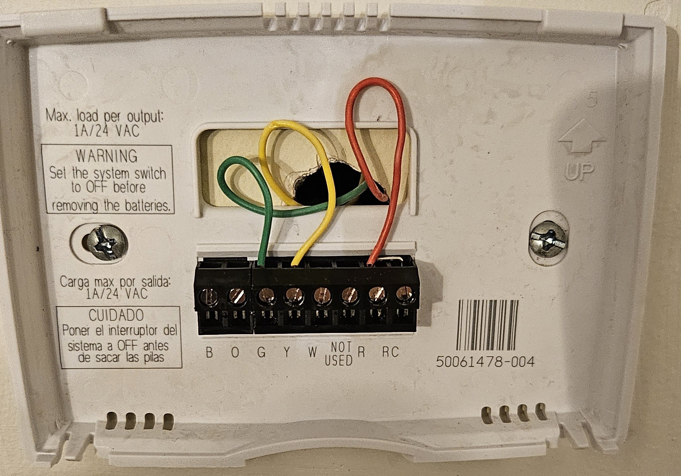

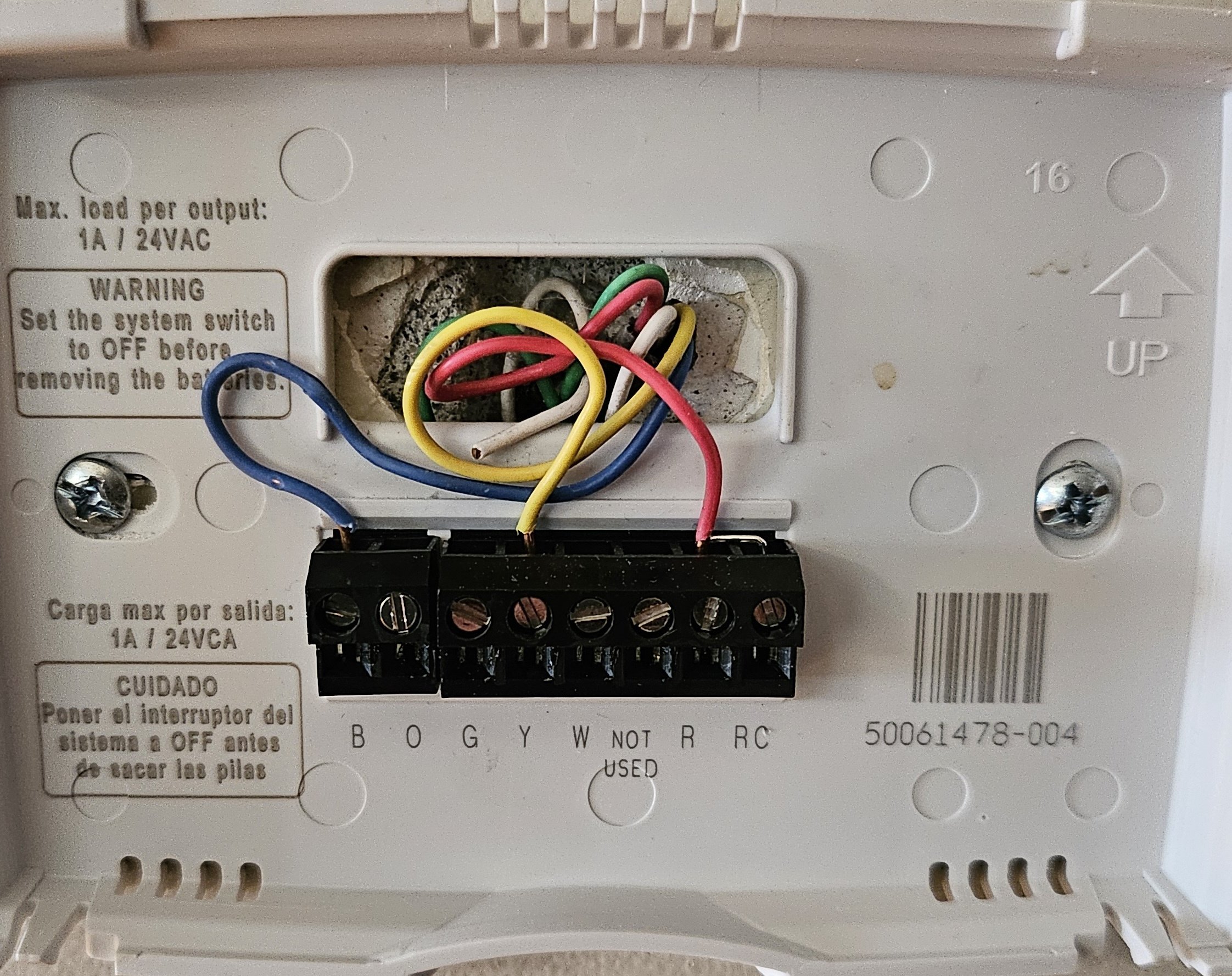

First time trying to switch on the cooling in my house since we move in. The house contains 2 thermostats controlling two outdoor HVAC Units for different rooms. (Heating for the house is using boiler)
Thermostat A works fine to turn on the cooling (when cooling on is set, outdoor unit starts fine), but the Thermostat B doesn't seem to do anything (outdoor unit won't turn on).
I check the wiring found those two are using completely different wiring.
Thermostat A (working) is using 3 wires G Y R
Thermostat B (not working) is using 3 wires B Y R
Anyone know based on the wiring, is Thermostat B wired for cooling or not? Thank you

    HVACNUT Member Posts: 7,305
    Thermostat B serves a heat pump. It does air conditioning, and heat (AC in reverse). Indoor blower motor (fan) is on but the outdoor unit isn't? It could be any number of things. Low refrigerant pressure. High refrigerant pressure. Contactor. Capacitor. Relay. Defrost board. Compressor. Where are you located? It needs an HVAC tech who knows heat pumps.

    You need to look at the other end of the B tstat cable at the air handler.
    If that blue is connected to the common, it could be a problem.
