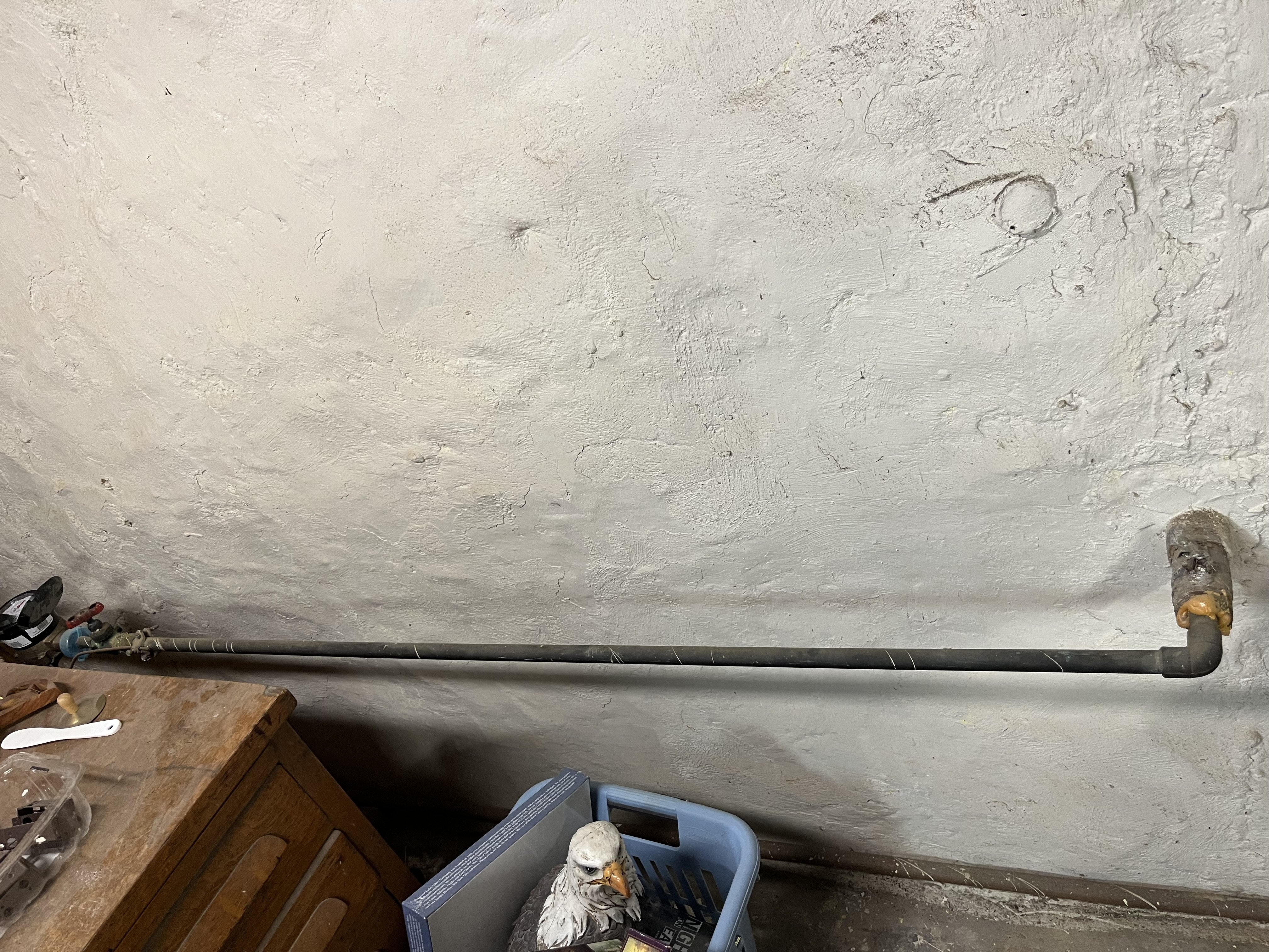

    here are shots of the line coming into the house. Looks to my untrained eye like a couple of stop valves and the meter. Is there a prv there?
    @jamiehall
    He was looking for a different sound between the front half (water filled) and back half (air filled) of the tank and didn’t hear one. Based on no air coming from the shraeder when i bled it, it makes sense its 100% water filled.

    pecmsg Member Posts: 6,136
    that just means it lost the air. Now if you got water out of the valve then it was water logged.
    shut the main valves
    Open faucets
    Drop the pressure to zero
    Pump the tank up to 90
  • trivetman
    trivetman Member Posts: 230
    thanks all. This all makes sense to me. Ill look into getting a regulator on the house. Weve been having a leaky washer and I didn’t think until now the high pressure might be why
