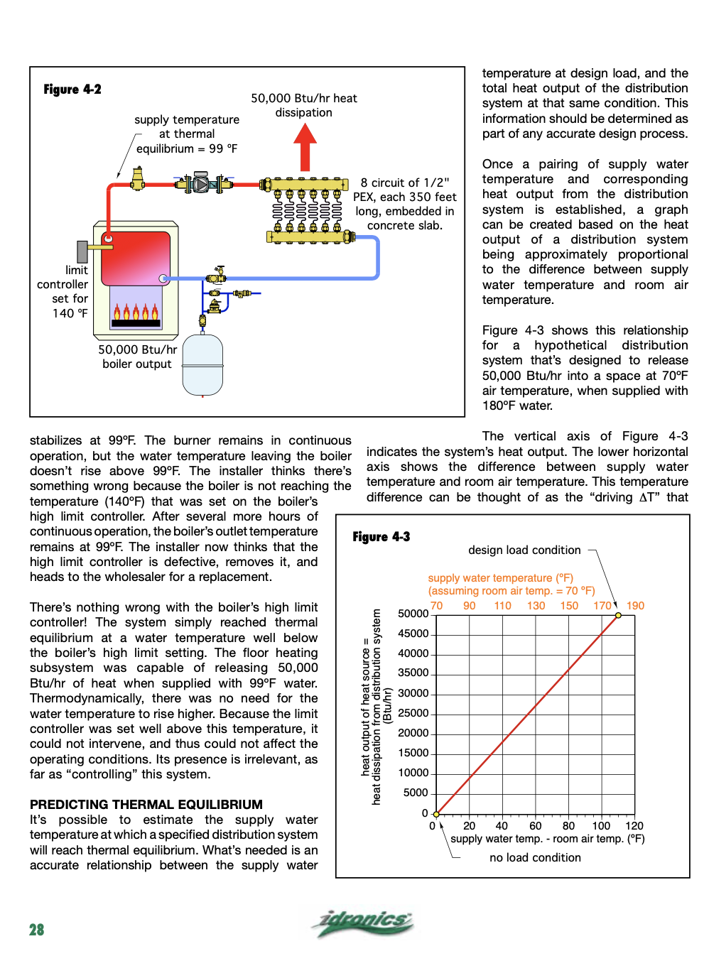

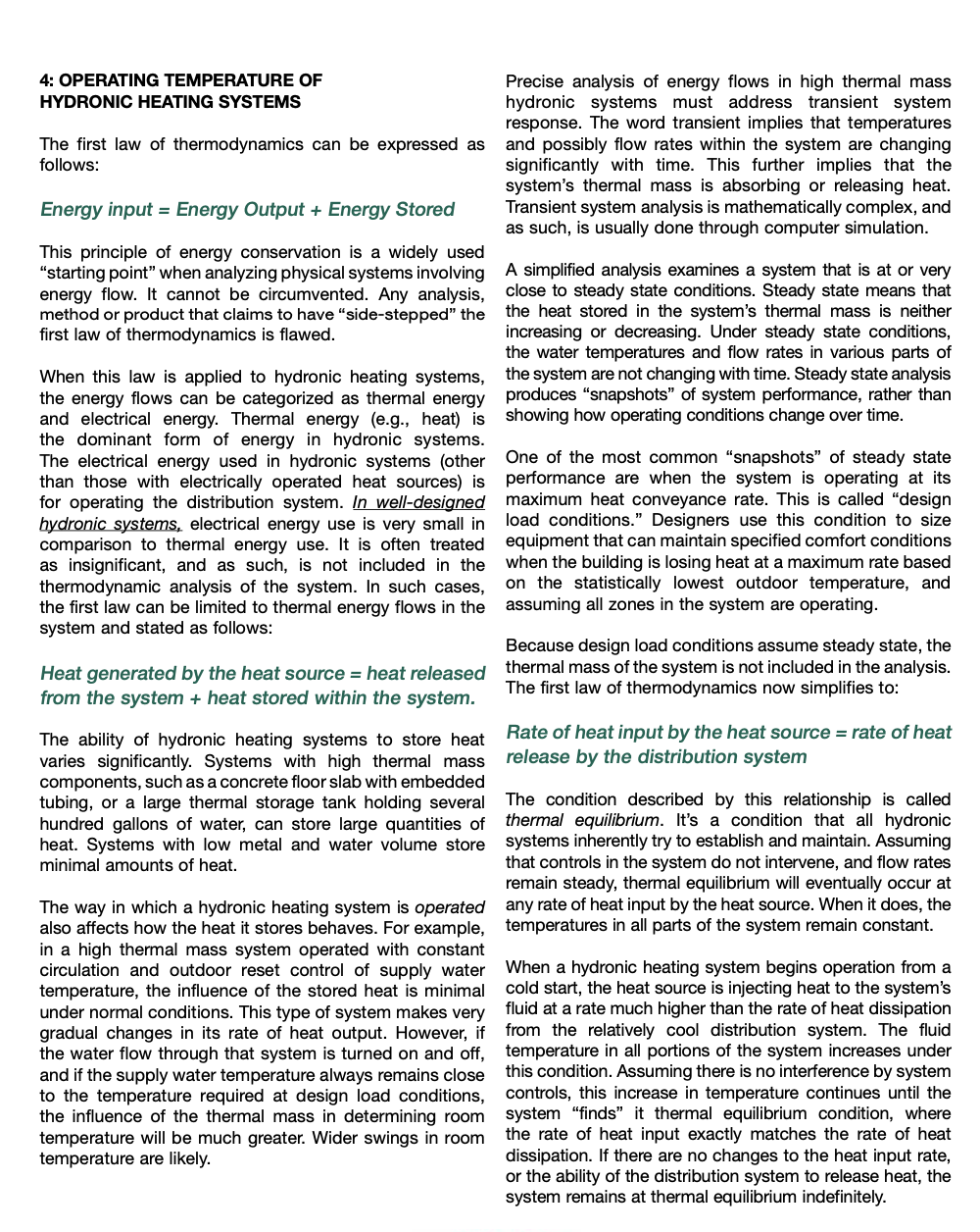

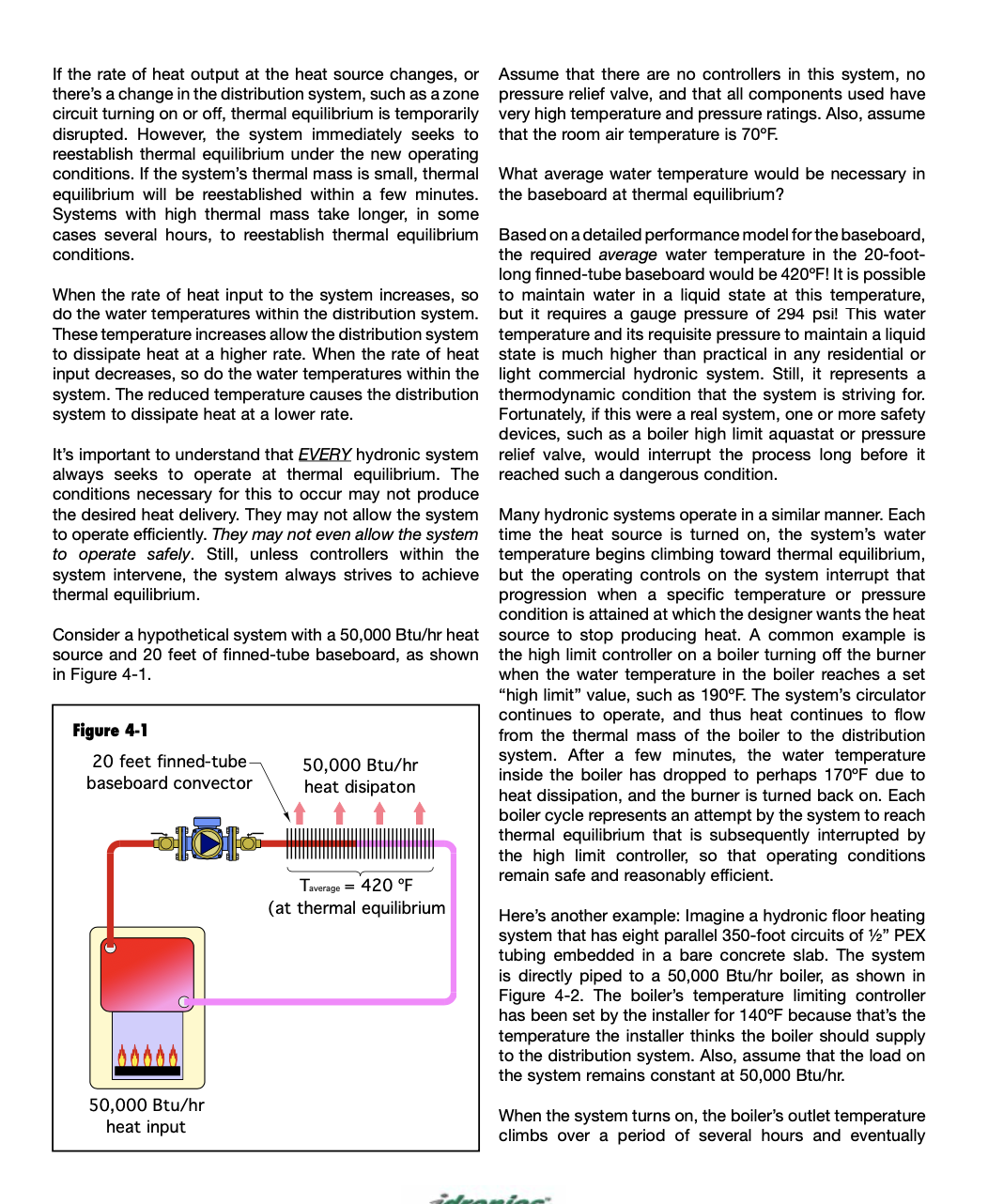

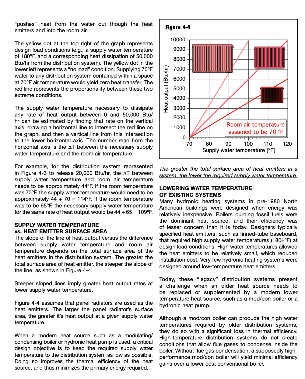

    hot_rod Member Posts: 28,010
    The heat emitters are dictiting the operating condition of the boiler. So at 160 thermal equilibrium
    point the radiators are outputting the boilers maximum. Now that could be your piping is as much radiator output as the radiators themself.
    Idronics 15 talks about equilibrium and how to predict it.

  • jesmed1
    jesmed1 Member Posts: 1,487
    edited March 2025
    @hot_rod Thanks for that. Interesting that the text in your final screen shot talks about the mismatch between "legacy" (pre-1980) systems that were designed for high water temps, so aren't a good match for mod-cons.
