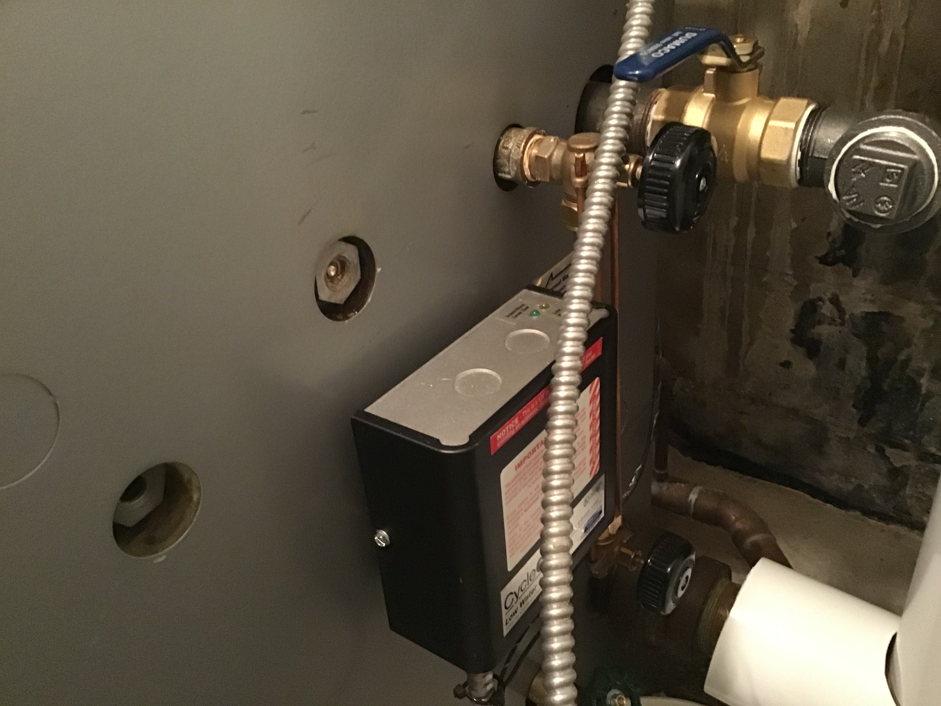

    The reading on the pressure gauge in this picture
    is from when I took these pictures about 2 months ago. Now it goes up to 6psi.
    AFA the pigtail, is it common that the output end is hot enough so I can barely hold my finger on it, yet the end at the pressure troll is lukewarm.

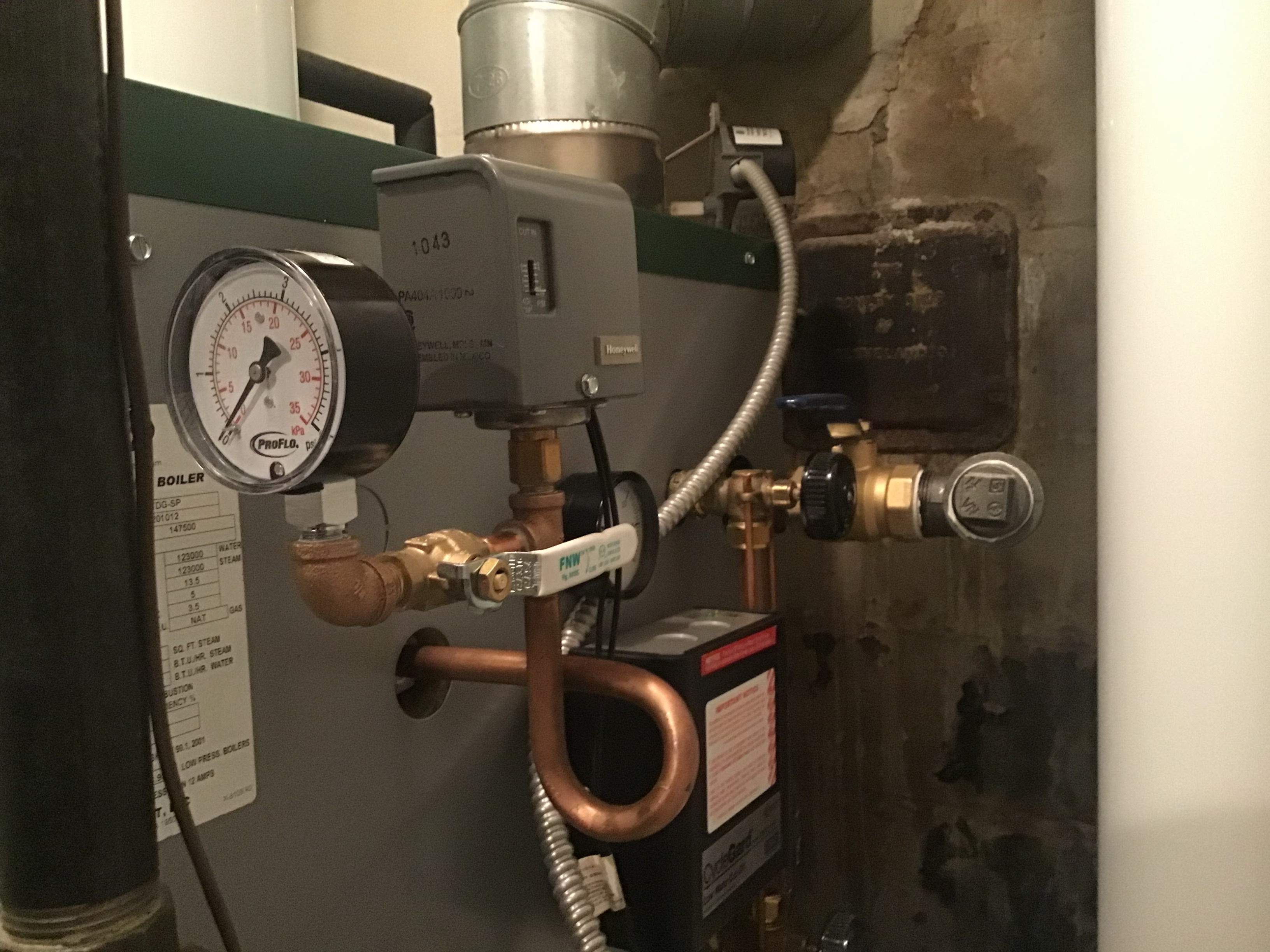

    So with the warmer weather and some time earlier this week, I finally got around to taking on my stubborn pressuretrol and pigtail fittings apart. I first removed the pressuretrol, and noted that it was actually pretty clean at its inlet port. Likely due to……..my pigtail being completely clogged.
    I wanted to use the original pigtail as it was brass and had a slightly longer stub pipe than any others I could find, which allows unscrewing of the pressuretrol without removing the pigtail. I was able to clean it out completely using a stranded cable run through it with my drill. Upon reassembly, at the same time fitted a 0-5 psi gauge with a shut off ball valve just before the gauge.

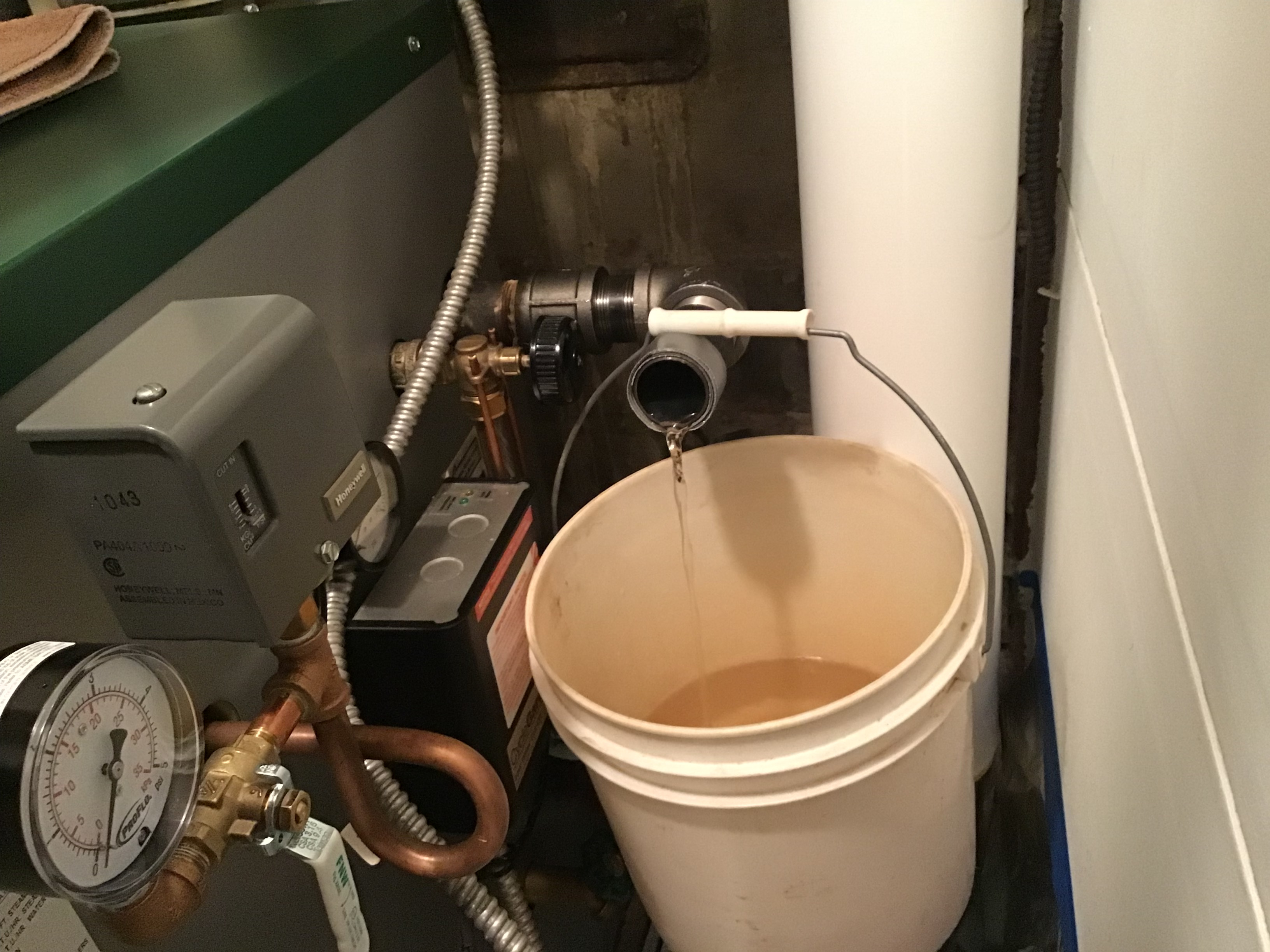

    So this is what I have set up to skim the surface……..will this be acceptable, or should I repipe it so it comes up at a slight angle.
  • geemalar
    geemalar Member Posts: 46
    I get what you mean about piping it so when it drains out the skim port the water level is halfway up the drain pipe……..is that setup substantially better. I would have to run out and get some more adapters.
    ethicalpaul Member Posts: 7,788
    edited May 9
    I was meaning to run the second nipple horizontally, not downward. And don't put a reducer in the skim pipes.
    You might be kind of tight on clearance there, but on mine I ran it to the right as seen facing the gauge glass. It doesn't have to be a long pipe. You could hang the bucket off the pipe or kind of set it on that return pipe.
    It's good to be able to see the water as it exits the pipe so you can have a better idea of the flow rate and perhaps see if any gunk is exiting. I don't like it when there's a downward pipe to the bucket.
    But if all that is too much trouble, what you have there is a lot better than nothing

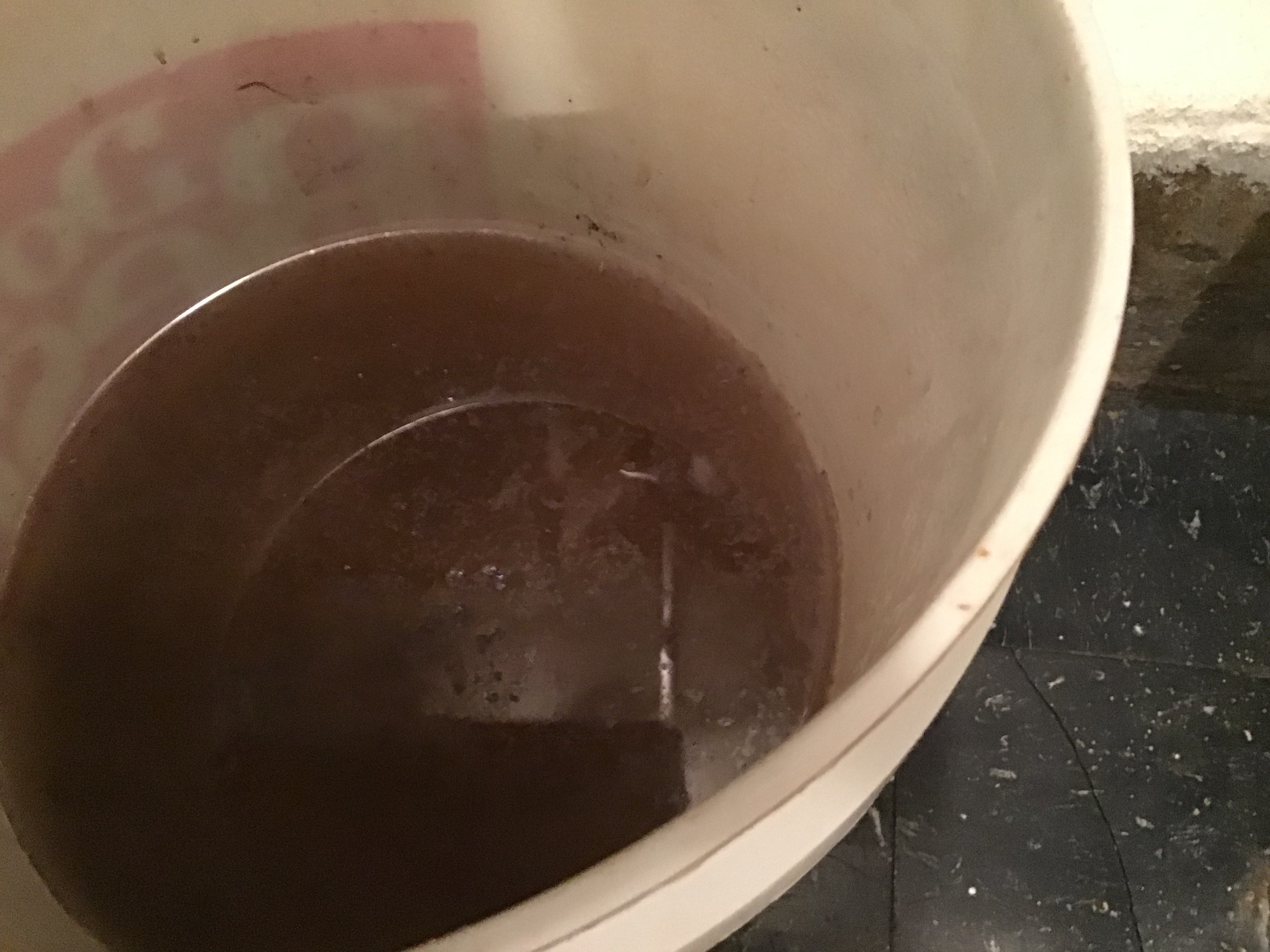

    Ok, I understand now…….let me go out and get a few fittings. Here’s the first bucket of residue…..I can see a decent amount of oily substance on top, the water in the picture looks dirtier than it is. The bottom of the pail has some sediment which makes the water look really dirty.

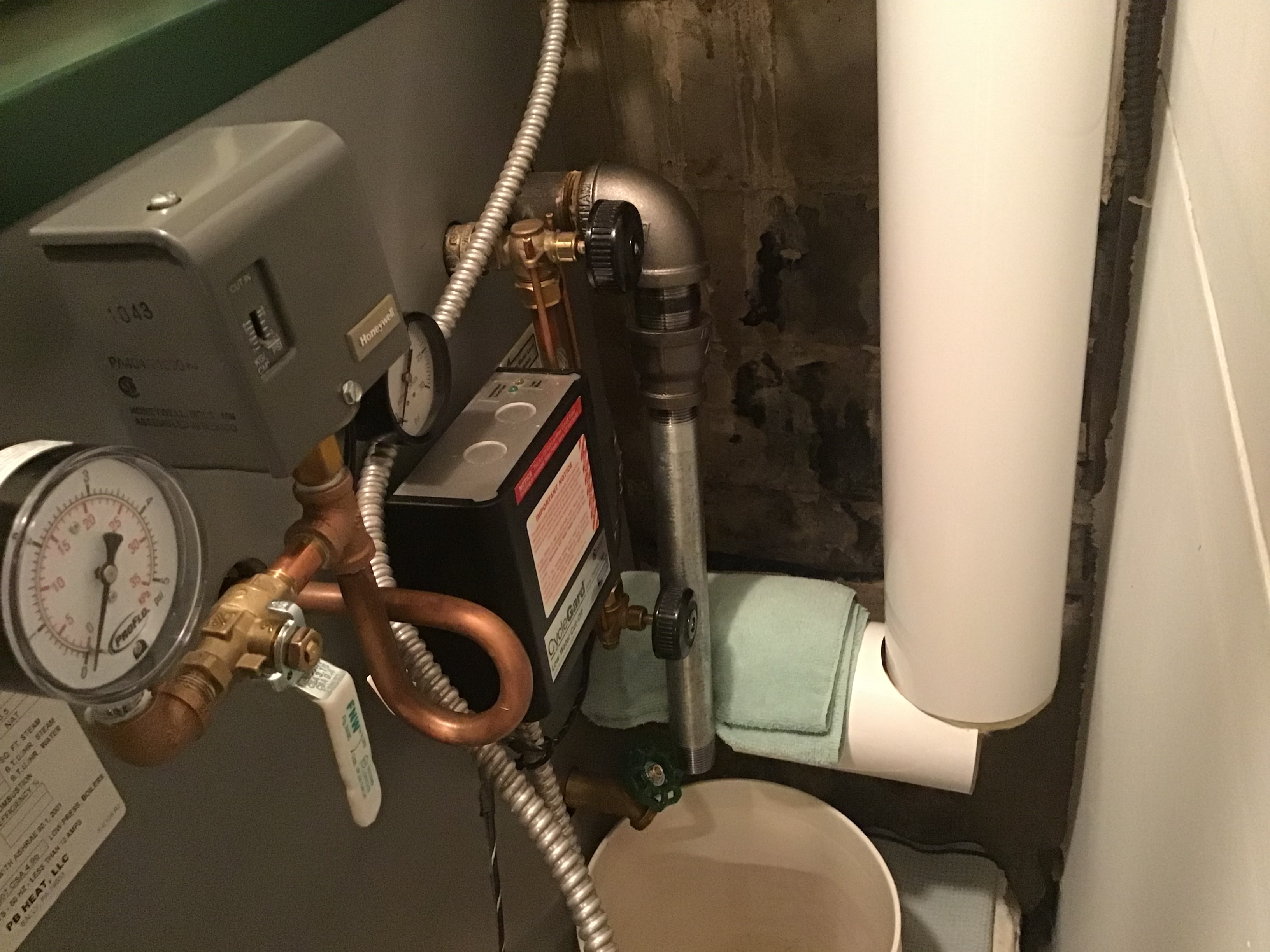

    I think this is what you meant…..

    How long do you skim for, until the water coming out no longer has residue?
    And should I just cap the stub pipe again, or put in a ball valve with appropriate fittings so it’s always set up to skim when required.
    pecmsg Member Posts: 6,357
    I prefer a full ball valve but that’s up to you.
    skim until clear. Check again after a few days of operating.
    edited May 9
    Yeah I agree with @pecmsg, I really like the ball valve on mine so I can add distilled water manually and any additives I feel like such as "8-way" to increase the pH to dramatically reduce the corrosion and the need to drain off "mud". Once your water is really clean, the need to skim is gone, but I still keep my skim hardware attached for those reasons.
    Your setup there looks great, you did perfect, and good job getting some gunk out. Even though your boiler is 8 years old, in my mind, if there is oily residue in the gauge glass, then skimming is called for.
    I tend to just skim until it's running out clean or like say 5-10 gallons or so. Then you can try it again after some days of operation like pecmsg said, because more stuff can break loose over time.

    I saw a lot of what appeared to be oily residue when I first started skimming, now the water draining out just has an ever so slight brown tint to it. That appears just to be light sediment. I’ll do a gallon or two more, and then set the water to the correct level.

    So my next questions……
    1) Is this setup acceptable? I only ask as I ran the boiler to where heat was coming out of my radiators, and I could not get the 0-5 psi gauge to read anything. My 0-30 gauge was reading 6 psi, but that gauge had been stuck at 6 psi for the longest time and I’m fairly confident it needs to be replaced. I kept tapping on it this winter and it finally dropped to zero, and it always goes up to 6 psi when I run the boiler. Pigtail is completely clean, and I cleaned the boiler port as I ran a 8 inch long pipe cleaning wire brush into it to make sure the port is clear. Pigtail gets hot fun until it starts to curve up, then it is only warm from that point onward.
    I know I have to change the 0-30 gauge, but I’m waiting until the middle of summer in case I run into any issues.
    I know the 0-5 psi gauge works, as I blew into it lightly to see if it would read before I installed it, and it did. Also, when I screwed it onto the stub pipe, it read about 1/2 psi as the ball valve was closed when I screwed it on. Once I opened the ball valve, it dropped to zero.
    No water level bounce in the sight glass, no spitting at any radiator valves……..everything seems to be working as intended.
    One other question……so when I screwed in the pigtail, I was able to get it to the point where it sits now. Trying to screw it one more turn was not possible unless I really forced it, which I was hesitant. So I left it where it is, which is somewhat tight, but not bottomed out as I would like. Doesn’t appear to leak anything from the base, so I left it where it is. Easy enough for me to tackle later on if there is any signs of a leak, but that does not appear to be an issue on the first run of the boiler.

    Trying to look at the positive, it’s May and I have a few months to get this accomplished.
    Jamie Hall Member Posts: 26,236
    First, on the low pressure — you don't need much to get heat to everything, and in fact you don't want much. A few ounces at most is quite sufficient for most residential systems. So the fact that you don't see much on the low pressure gauge isn't a problem.
    Your pigtail is fine. That NPT thread, which is tapered, so you don't have to screw it all the way in. At the pressures you are likely to run, hand tight is going to be ample.
    You can replace the 0 to 30 gauge if you like. It's probably busted — most of them are — and it's there as much to keep the insurance people and building inspectors happy as anything else. Not to worry about it.
    Sounds to me as though everything is good…
