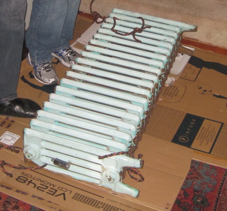

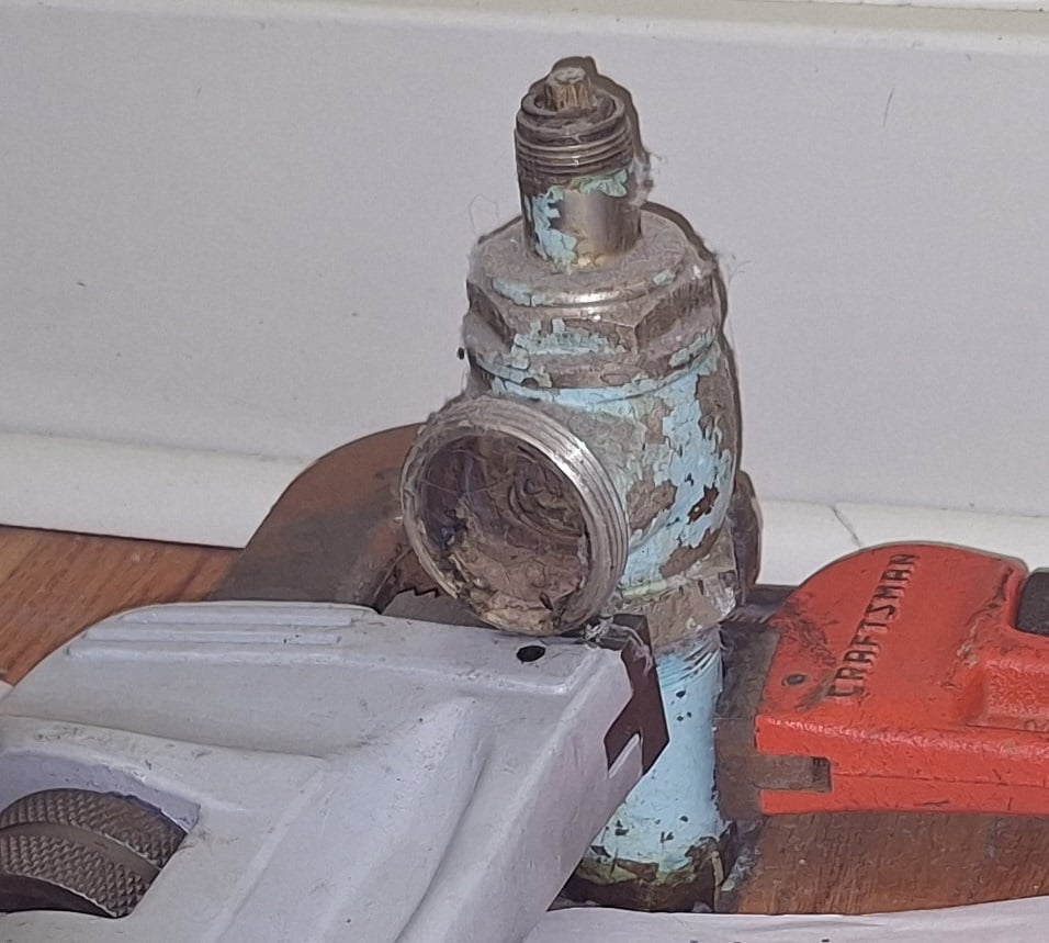

    It's been over 90 degrees in mid-Michigan, three days running. Not my kind of weather.
    Of course, heating season might begin in six weeks, and will definitely be here by the end of October. So a young man's fancy turns to steam heating. One of the things left undone last season was to address a leaking angle valve in my office upstairs.
    Which came off with the proper motivation:

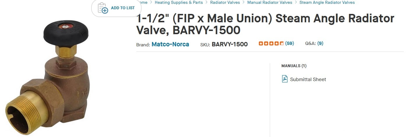

    I want to replace, obviously. Are these a good idea? I want something that lasts, US-made preferred.
    Secondly, it would be awfully good to have a SMALL radiator in my many-windowed, well-insulated, 8 x 15 squ foot office. I've had no problem without any heating at all by leaving the door open, but a little extra would be nice on single-digit days.
    Do I just buy a new radiator, or is there a reasonable chance I can get this puppy down to four or five segments? It's an "American Radiator CORTO Patented 1921." I don't see any tie rods, which makes me leery of opening a can of worms.. but it'd be neat to re-use what I have.
    Took four of us to move it to the garage in 2013.
    The past is never dead.
    cheers -matt
    mattmia2 Member Posts: 15,634
    i'd look for a used radiator, although you can buy one new from castrads or us radiator. depends where you want to end up on the time vs paying less equation. that isn't anything special and splitting it will likely require a lathe to put it back together.
    dabrakeman

    Ya that makes sense, thanks. FB marketplace has some decent-looking supply, and it's not a hurry-up item.
    The important thing is to fix the "leak" — it really only sputtered a bit on very cold days when a little pressure made it to the end of that line, but I want to have that done. It'll look better, too.
    Just have to figure out which shutoff valve to get.
    Maybe someone else will answer about the valves. I know tunstall makes valves.
    109A_5 Member Posts: 3,468
    If 1-1/2" is the correct size and Supplyhouse is your vendor of choice you have 3 choices. The internet says;
    Bluefin - China
    Matco-Norca - Globally sourced products
    Legend Valve products - are manufactured in Auburn Hills, Michigan
    They may all work fine.
    Did any of that junk in the old valve fall into the pipe ? If so maybe it can be vacuumed out.
    EBEBRATT-Ed Member Posts: 19,605
    Keep in mind the new valve may be fine but have different dimensions
  • BobC
    BobC Member Posts: 5,539
    Many of the ne valves are shorter. If you don't currently have at least an inch of pull up over the exiasting valve the new valve will be 1/2" or more too short and that is a liyy;e tough because then the valve may end up 1/2" too tall and you will need to shim the radiator up to make it fit.
    Bob

    Always have the option of skipping the valve. 99 percent of valves, in non apartment building settings, are never used.
    Its been decades, I don't touch my valves, no need to.
    Not sure where @BobC was going with that post. If the valve was 1/2" shorter and there is no pipe to pull up from the floor the radiator would sit 1/2" too high.
