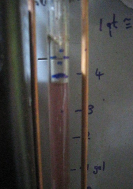

    After another 10 or so days had passed, the boiler was surging again, with ~2.5 gallons of water going skyward. Friday night I tested a hypothesis of mine — more like a suspicion — and found it confirmed: most of the effect of skimming occurs early. I filled half a Homer bucket with overflow, dumped another half bucket out the drain and out the [recently installed] drain valve of the wet return, and ran the boiler again.
    Sure enough, the water level in the glass bounced up and down less than before — maybe 1/2" total movement — and the average drop in the water line was a little over a gallon late in the cycle. I don't think it's ever been less.
    What this says about skimming is that there's no point in dragging it out for hours, and that adding detergent won't help. It's the oil slowly leeching out of the piping that's making the boiler surge, and that'll stop when it's all washed out. Probably three Christmases from now is what it feels like. It's an easy process, and it's slowly getting better.

    I skimmed, again. For the 12th time. The pattern is clear: after skimming off half a 5-gallon bucket of water, and draining as much from the bottom to get the water line back to normal, there is no surging for a few days. After a week, instead of dropping a gallon-and-a-quart, which is about the minimum water "loss", the water level goes down by over two gallons, indicating some more oil has found its way to the boiler. And I skim again. At the present rate, I'll be rid of the oil around Memorial Day, and I can only hope it'll be the 2025 one.

    Quick update: following Paul's advice, I kept an eye on the waterline
    » So I suggested he try [to] let the boiler do its thing for like 5 days, then go to 1 before it has a chance to surge
    Today happened to be day 5, but what convinced me to skim was that the receding water went from the minimal inch to around 1.5 inches.
    One item of interest is that I cracked the skim port with the boiler running and an indicated pressure 15 inches of water. There was quite a bit of dirty water coming out as airborne droplets. So yes, definitely surging.
    » When a skim shows no sheen, you should be done
    The first couple quarts of skimmed water showed a clear sheen, and the next gallon did not.
    Finally, I don't buy the danger of cracking the boiler with cold water.
    The water is room temperature and the cast iron is at 220 F. I don't think it cares. Does anyone have anecdotal evidence of this ever happening?
    Thus ended skimming #13.
    cheers -m

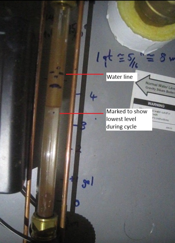

    Mid-Michigan has another five to six weeks of heating season left, and I figured it's time to bring the water to the proper condition for the summer break.
    Step 1 — I skimmed again, for the 18th time per my sharpie marks on the side of the boiler. Top-notch record keeping. The boiler wasn't surging per se, but the water line was still receding more a little too much for my taste, maybe a couple gallons, maybe 2.5 gallons… a gallon being about 1.25 inches in my site glass.
    There was STILL some muck on top of the water, but it only covered maybe a quarter of the surface, with gaps everywhere. This leads me to believe that the oil is effectively gone. Took long enough.
    This time I skimmed using a bucket, a siphon hose, and pre-boiled hot water, so as not to introduce oxygenated water and also keep the water hot while skimming. A noble effort, to be sure, that turned into a waste of time in the end.
    Here's an image showing how far the water retreated less than 24 hours after skimming. This is still just water, with no chemicals introduced. The gallon scale is from the first time I filled the boiler; the spacing is uneven but it's good enough to get an idea what's going on.
    That's been the standard; the water line retreates about 1.5 gallons worth, or 1-3/4 inches on the glass.

    The Peerless 63-03 officially holds 9.3 gallons, plus near-boiler piping. I put in 8 oz. of Rectorseal 8way to start. The effect was spectacular. The water turned rusty and dirty, and after steaming for a while, started surging, and the water line retreated almost to the bottom of the sight glass.
    There were no other problems, radiators got hot, no banging, no nothing, but the water jumping around was pretty spectacular. I figured it was knocking loose all sorts of nastiness and let it do its thing for a couple of days.
    Then I restored the water supply plumbing, drained the boiler and piping, refilled with fresh cold tap water and added ~ 6-7 ounces of 8way.
    In a pleasant surprise, the surging went away and the water line retreated the least I've seen so far. Towards the end of the call-for-heat, this is what it looked like — let's see if I can link to a video here. Sorry for the 90-degree rotation; I haven't figured out how to fix that. The starting water line was as before.
    I haven't measured the pH yet. I'll be shooting for about 10, to stop corrosion.
    Will I have to exchange the water again? It's been a couple days, and the surging has not started up again. I'd prefer to get a gallon of water out now and then to remove the gunk, hoping that eventually it'll come out clear. In that mode I'll fill with boiled water and add 8way as needed to adjust pH.
