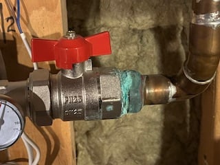

    I have similar stuff building up where I connected copper pipe to my stainless manifold 6 years ago.
    So it is not galvanic corrosion? Should I do something about it?
    hot_rod Member Posts: 27,052
    It looks like that threaded connection had a small seep for a period of time. Perhaps sealed itself, if it stays dry?
    Often times the seep reappears when the system cools down over the summer, the contraction of the various metals.
    Also a lot of the imported manifolds have a thread NPTF that differs a slight amount from the tapered NPT threads used in the U.S.
    The DN 25, a metric sizing term, (diameter nominal) and short socket length, can be the giveaway.
    So that threaded connection can be more challenging to seal. It is usually best to do a connection like that with a Loctite type sealant, basically gluing the two parts together.
    You could wire brush it, but the leak may reappear if you do.
  • sibir
    sibir Member Posts: 4
    Thanks. It seems dry, but I will keep an eye on it.
