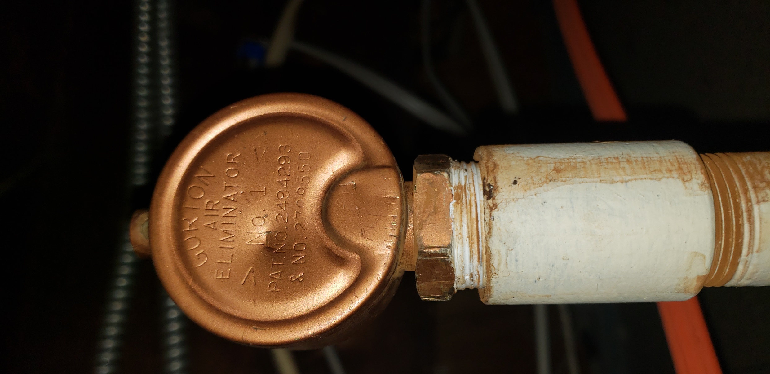

    5.Show us pictures of the main vents you have.
    They are both "No. 35 Vent-Rite". First two pics are the same vent, on the "front" main. The third shows the vent on the "back" main, hidden in the shadows in the top-left of the picture. But it's got the same "No. 35" label.
    IMG_20230325_131809475.jpg IMG_20230325_131817238.jpg IMG_20230325_131852877_HDR.jpg

    The venting of the mains is insufficient. A single Vent-rite #35 isn't much better than a radiator vent, much less the capacity needed for steam mains.
    The pressuretrol is set too high. The MAIN on the right should be lowered by the screw on the top of the pressuretrol case to 1.5 PSI and the DIFF on the left should be raised to 1 with its own screw on the top.
    That Hartford Loop looks funky too me. I agree with Jamie that it probably isn't the at the correct critical dimension unless your measurement confirms otherwise.

    Agreed. That main should have a Gorton #2 vent. If the other main is of similar diameter and length, it should have the same.
    You want the steam to fill the mains complete and quickly first, then when they close, the steam will rise into all the radiators at the same time.

    I concur with the others about main venting. It should take 5 minutes or less to go from header hot to the entire main hot. That slow delay shows a lack of main venting and can lead to some weird imbalance issues because the radiator vents are trying to compensate for main venting.
    The boiler piping looks good except where the mains are tied together. That will make balancing the system difficult and it's not really proper. Mains should be tied into the header individually.
