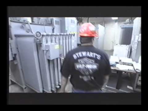

    Sad story of what can happen when a 600 volt VOM meets 4000 volts.
    https://www.youtube.com/watch?v=hfnEuRA7-vo
