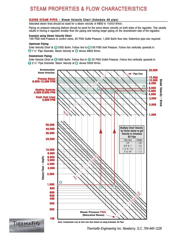

    maybe i've got the wrong table. i'm getting like 96 ft/s at about 386 lbs per hour (i.e. 93,000 btu net/240) and 1 psi in 2 1/2 inch pipe which is on high side but still fits in desired range for heating systems (and 2" does show over the green range although not precipitously which is why I reckon the setup with the burnham fired at 1.05 through single 2" riser still worked OK.)

    I'd refer you here:
    https://www.heatinghelp.com/systems-help-center/category/steam-heating/steam-velocity/
    I have my own spreadsheet and usually use specific volume associated with 1psig rather than 0psig but however you decide to calculate you should get numbers close to these.

    hmmm. thanks for pointer to those deadmen tables by Ted Parreco (look like pdfs from maybe an excel built calculator where you could input different pressures) and the TSV calculator give identical results so I think I was maybe misreading the table I grabbed.
    so while 1 psi might be normal running I think 0 is the startup steamup conditions so maybe that is why those tables use 0. so if you don't want water at startup then the 0 design and as low as possible velocity (is it dan's venerable 15 fps??) maybe calls for less extensive near boiler piping to mitigate wet steam.
    Using the existing 2" riser, the table for 108 output on the williamson GSA-125 shows 34.5 fps which is outside the williamson recommendation (although they greenlight 33.9 fps on GSA 175 with a single 2.5 inch riser. The new GSA125 specs actually reduce the output to 103 bringing my velocity down to 32.9 fps if i kept existing riser so maybe within manufacturers spec although they don't give the nominal limit that informs the colors in the table so i'm guessing it is kind of under 34 fps. so maybe an updated table would greenlight a 2 inch riser). All that said going to 3" (which I think is the tapping size on the GSA125?) would get me below Dan's deadmen's magic 15 fps target at 0 psi. The manufacturers seem comfortable with the idea that the near boiler piping will wring out the steam since they allow for exit velocities in the 20s and even 30s but I really like the idea of keeping it relatively dry to start.

    I have questioned myself the relationship between boiler size and the acceptability allowances in the manufacturers minimum piping specs where it is generally quite clear that most manufacturers allow higher velocities in the larger boilers than in the smaller ones. Maybe this is due to water more easily separating out in larger pipe diameters, or, it is just a matter of practicality minimizing the large piping that might be necessary with the higher btu boilers to achieve the lower targets. Maybe others have more insight on this. In general though most agree that if you meet the minimum standards set by the manufacturer you should be "OK".
    You say you have an existing 2" riser?? I guess I am confused then from the picture that seems to show a reducer elbow right now at the top of the riser suggesting either the riser is larger or the header smaller. Please clarify.
    A 3" riser with 2" header would give riser velocity of about 16ft/s and header velocity of 34ft/s. Header velocity same as GSA-175 acceptability but I can't say that would be OK for a 2" pipe vs a 2.5". I'd still recommend meeting the manufacturer velocities but if you have currently a 2.5" or 3" riser going into a 2" header with the larger boiler and "don't have a water carryover problem" then logic would say with same piping and a smaller boiler you also shouldn't have a water carryover problem…
