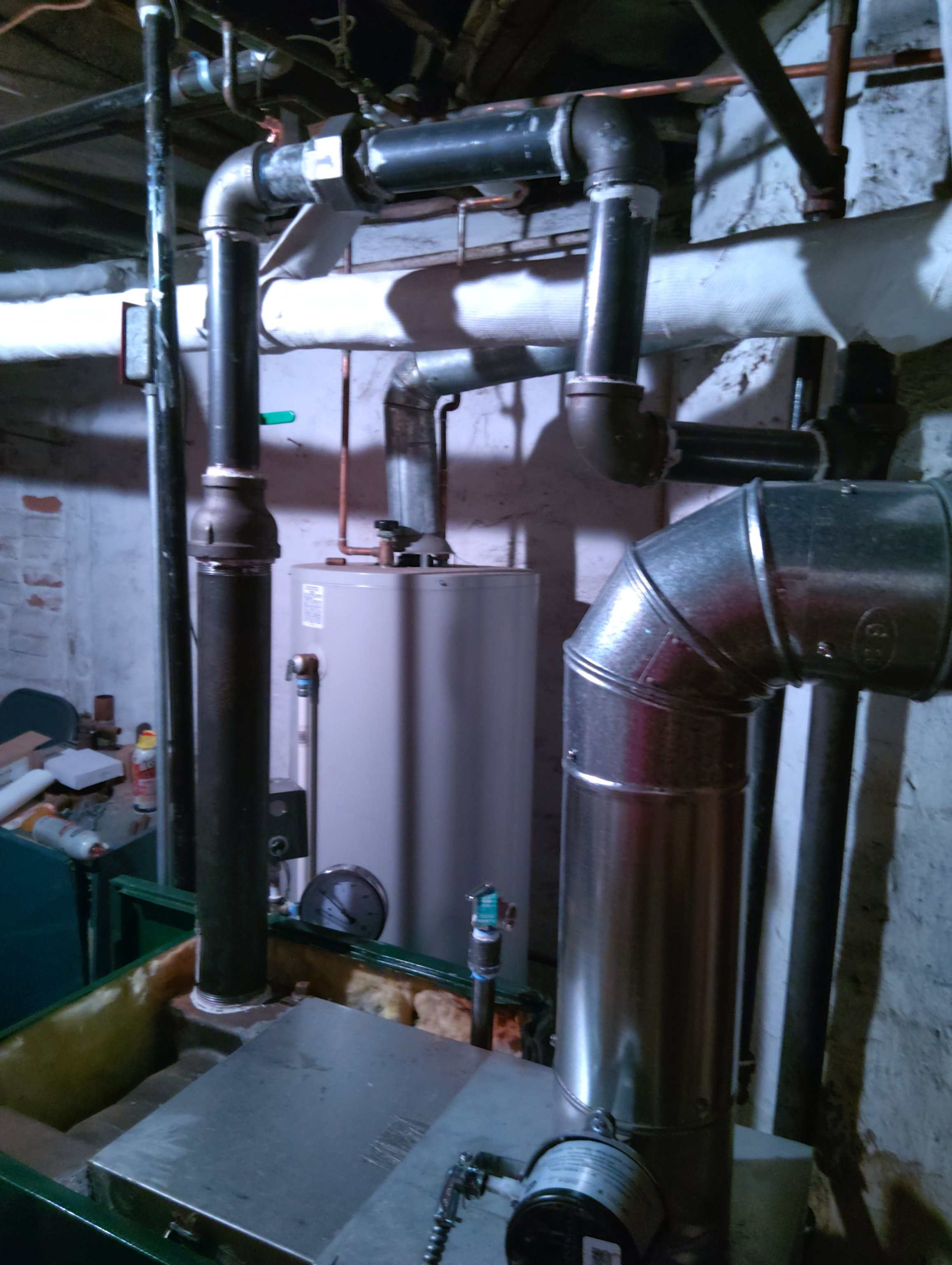

I'm finally going to get my very old weil mclain replaced, after limping through winter with boiler plug fluid.
Anyhow, my plumber said this is entirely up to me, but he recommends a Williamson vs a Weil McLain branded boiler, as they are identical (or near it) and a matter of branding. I've looked at old posts, but they were exactly that (old), so I thought I'd ask for current affairs: are they the same thing?
Also- I have a 1 pipe steam system, and am assuming all the plumping away from the boiler will remain untouched, but the boiler and near boiler plumbing of course changing over with the new unit. I do trust my plumber, but other than the unit itself, what should I be asking for or making sure he does?
Old boiler I'm told is way oversize at 184,000BTU. He calculated EDR to land between 125-150, so we are downsizing in any case

so, an image of the current setup if helpful:0 -

You say you have an existing 2" riser?? I guess I am confused then from the picture that seems to show a reducer elbow right now at the top of the riser suggesting either the riser is larger or the header smaller. Please clarify.
A 3" riser with 2" header would give riser velocity of about 16ft/s and header velocity of 34ft/s. Header velocity same as GSA-175 acceptability but I can't say that would be OK for a 2" pipe vs a 2.5". I'd still recommend meeting the manufacturer velocities but if you have currently a 2.5" or 3" riser going into a 2" header with the larger boiler and "don't have a water carryover problem" then logic would say with same piping and a smaller boiler you also shouldn't have a water carryover problem…

@dabrakeman sorry, i posted a sample pic of a double header . . . eer riser . . . williamson that i think you mistook for the job i'm working on. I didn't have an pictures but when I was over there today building a derrick in the stairs to hoist the new one in and the old one out i grabbed a couple snaps and took a longer look. i'm going to definitely do a 3x24 inch riser to a drop header. its just a question of where i downsize. it's big money to stay in 3" and this setup worked fine. If I'm doing the 3" at the boiler exit, I'm thinkin i'm likely to just hit a reducing el top of the riser and build the drop header of 2" cause I can thread it or use nipples i normally stock.
and you notice in the back shot there is drop to the harford loop which isn't even all of a couple feet long. unless the weight of the water in that 'trap' is some utility for stable operation, why would there be a drop loop, why not just a return without a trap is high in the boiler water line so it wouldn't drain the boiler if it failed.0
