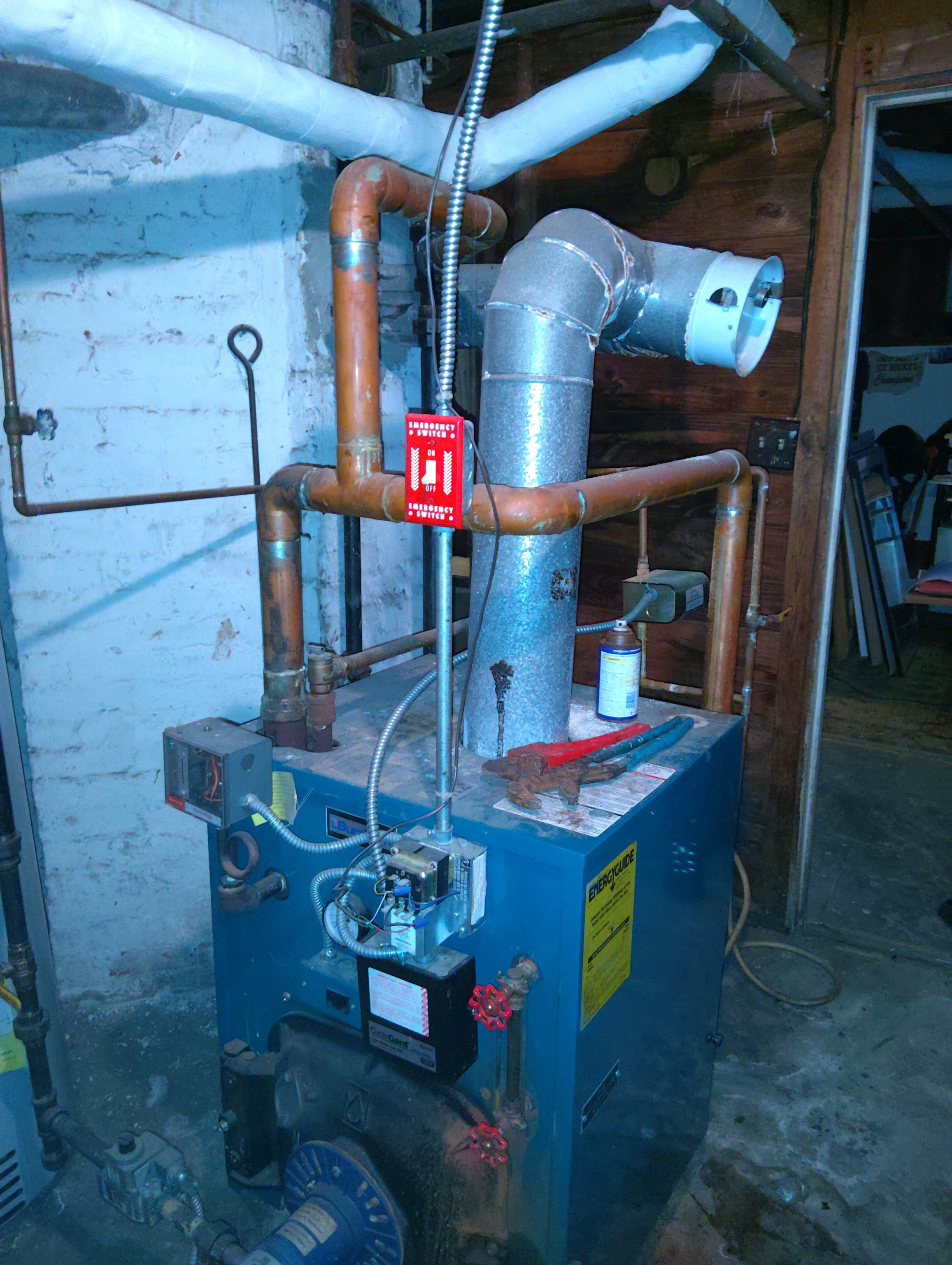

    so, an image of the current setup if helpful:

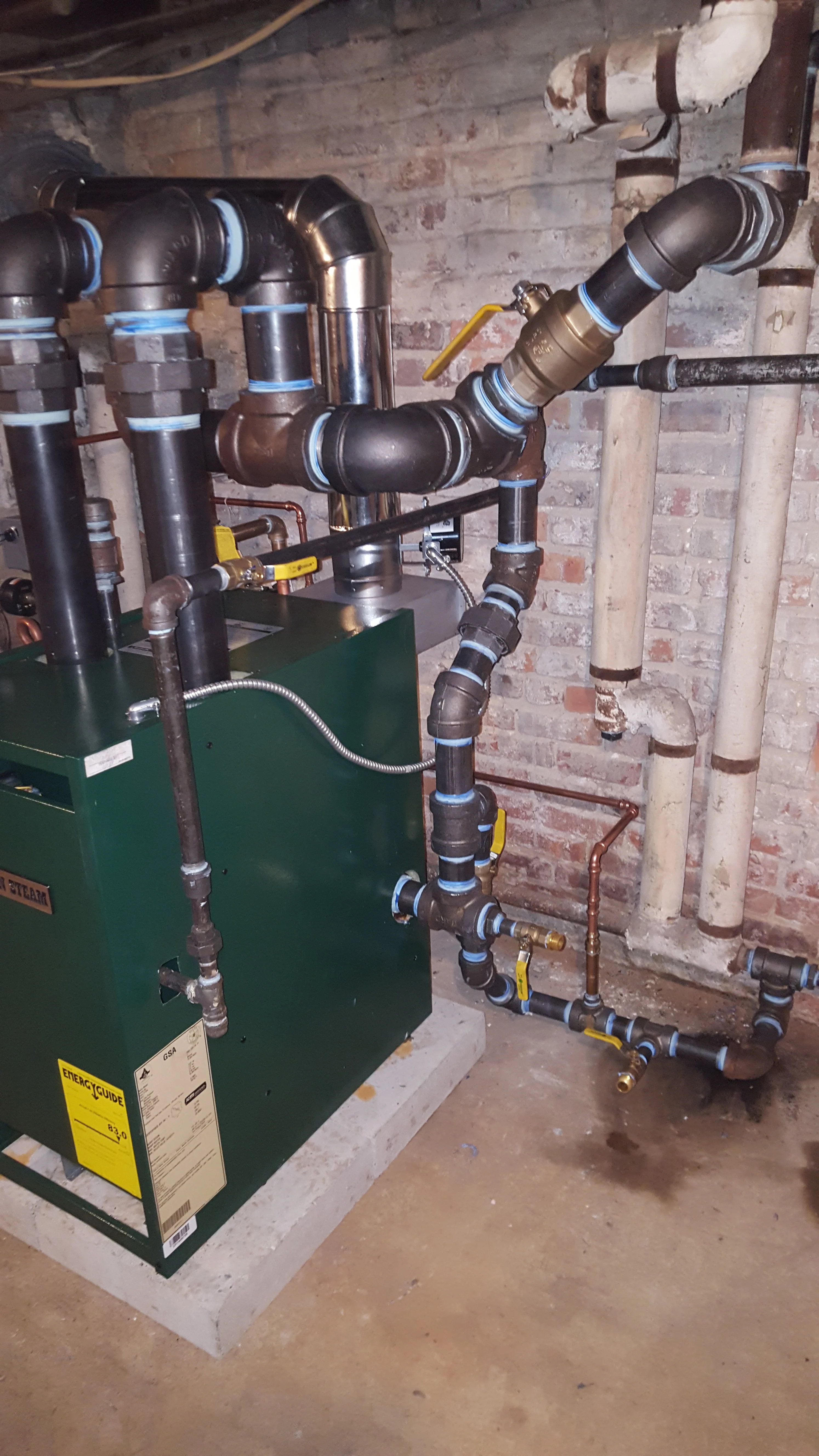

    didn't look at manufacture date but my distributor is offering me a williamson that does not have the 2nd steam tapping. I see many threads with only a single riser but that doesn't mean there is or is not a second tapping, just that it is not used if it exists. i also saw some kvetching about getting the plug out lately although no problem there since this one doesn't have a tapping !
    have also seen some nice twin riser headers on williamsons that obviously have the 2nd tapping.
    e.g. heres a pic from this williamson thread
    given the number I have seen with a single riser I can only assume that the chamber is not incapable of doing a halfway decent job of steaming through a single riser but i've got a couple daze before i pull the trigger and wanted to hear anyone's experience or theory on this. also notice plenty not using drop header, as you'd expect. all the more important if single outlet could lead to more surging (that's an instinct on my part, not yet scientifically establish til you guys all give me enough anecdotes to count as statistics :- ).
    thanks, brian

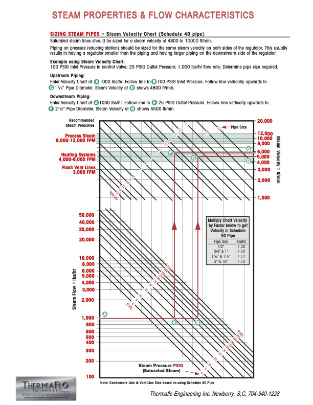

    maybe i've got the wrong table. i'm getting like 96 ft/s at about 386 lbs per hour (i.e. 93,000 btu net/240) and 1 psi in 2 1/2 inch pipe which is on high side but still fits in desired range for heating systems (and 2" does show over the green range although not precipitously which is why I reckon the setup with the burnham fired at 1.05 through single 2" riser still worked OK.)
  • dabrakeman
    dabrakeman Member Posts: 1,022
    I'd refer you here:
    https://www.heatinghelp.com/systems-help-center/category/steam-heating/steam-velocity/
    I have my own spreadsheet and usually use specific volume associated with 1psig rather than 0psig but however you decide to calculate you should get numbers close to these.

    hmmm. thanks for pointer to those deadmen tables by Ted Parreco (look like pdfs from maybe an excel built calculator where you could input different pressures) and the TSV calculator give identical results so I think I was maybe misreading the table I grabbed.
    so while 1 psi might be normal running I think 0 is the startup steamup conditions so maybe that is why those tables use 0. so if you don't want water at startup then the 0 design and as low as possible velocity (is it dan's venerable 15 fps??) maybe calls for less extensive near boiler piping to mitigate wet steam.

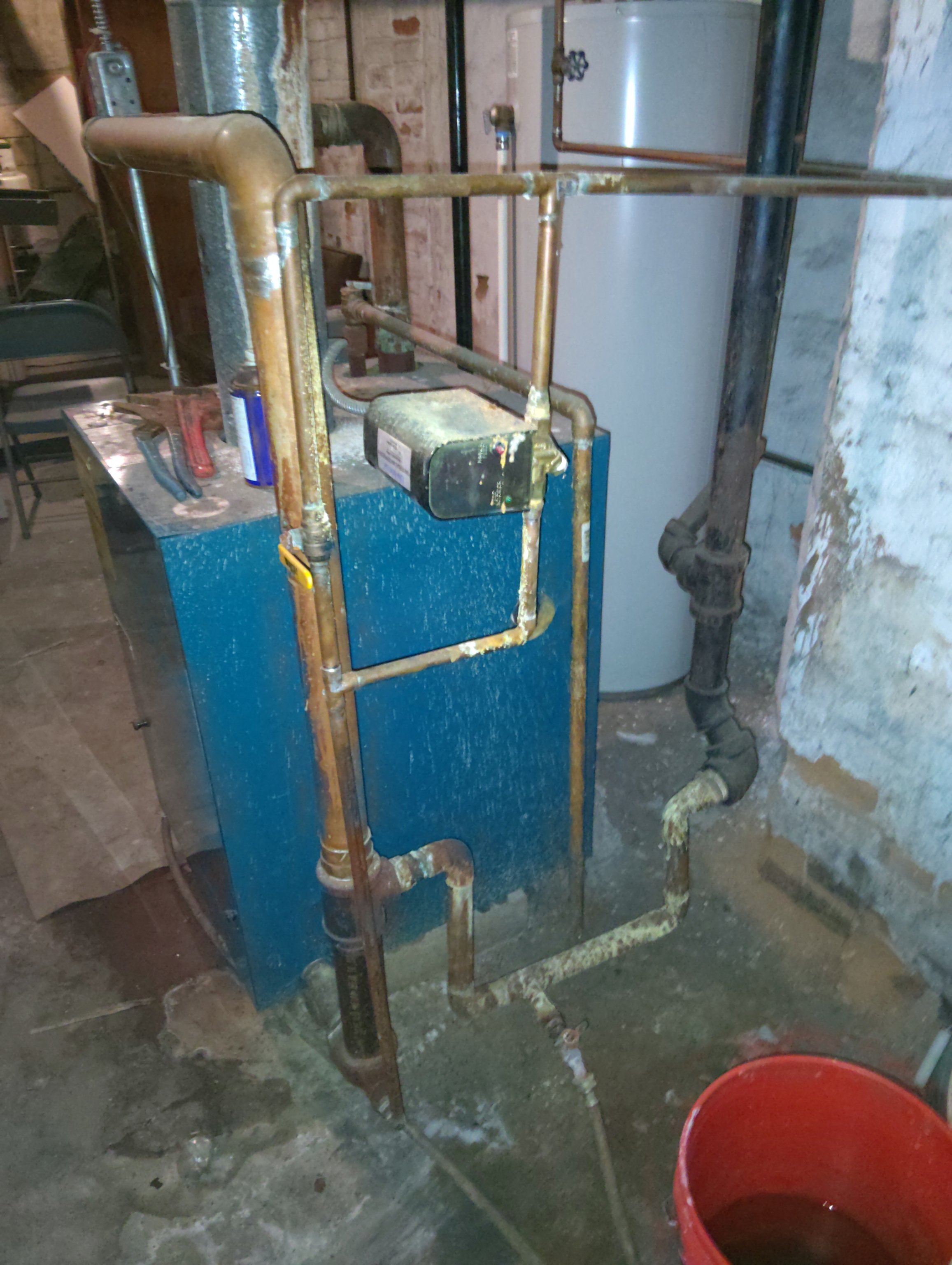

    Using the existing 2" riser, the table for 108 output on the williamson GSA-125 shows 34.5 fps which is outside the williamson recommendation (although they greenlight 33.9 fps on GSA 175 with a single 2.5 inch riser. The new GSA125 specs actually reduce the output to 103 bringing my velocity down to 32.9 fps if i kept existing riser so maybe within manufacturers spec although they don't give the nominal limit that informs the colors in the table so i'm guessing it is kind of under 34 fps. so maybe an updated table would greenlight a 2 inch riser). All that said going to 3" (which I think is the tapping size on the GSA125?) would get me below Dan's deadmen's magic 15 fps target at 0 psi. The manufacturers seem comfortable with the idea that the near boiler piping will wring out the steam since they allow for exit velocities in the 20s and even 30s but I really like the idea of keeping it relatively dry to start.
    Coming out of this burnham with a 2" single riser this system did not carry a lot of water and it does not have a drop header but it is easy enough and not too expensive with a single riser to provide some large near boiler piping.

    You say you have an existing 2" riser?? I guess I am confused then from the picture that seems to show a reducer elbow right now at the top of the riser suggesting either the riser is larger or the header smaller. Please clarify.
    A 3" riser with 2" header would give riser velocity of about 16ft/s and header velocity of 34ft/s. Header velocity same as GSA-175 acceptability but I can't say that would be OK for a 2" pipe vs a 2.5". I'd still recommend meeting the manufacturer velocities but if you have currently a 2.5" or 3" riser going into a 2" header with the larger boiler and "don't have a water carryover problem" then logic would say with same piping and a smaller boiler you also shouldn't have a water carryover problem…

    @dabrakeman sorry, i posted a sample pic of a double header . . . eer riser . . . williamson that i think you mistook for the job i'm working on. I didn't have an pictures but when I was over there today building a derrick in the stairs to hoist the new one in and the old one out i grabbed a couple snaps and took a longer look. i'm going to definitely do a 3x24 inch riser to a drop header. its just a question of where i downsize. it's big money to stay in 3" and this setup worked fine. If I'm doing the 3" at the boiler exit, I'm thinkin i'm likely to just hit a reducing el top of the riser and build the drop header of 2" cause I can thread it or use nipples i normally stock.
    and you notice in the back shot there is drop to the harford loop which isn't even all of a couple feet long. unless the weight of the water in that 'trap' is some utility for stable operation, why would there be a drop loop, why not just a return without a trap is high in the boiler water line so it wouldn't drain the boiler if it failed.
