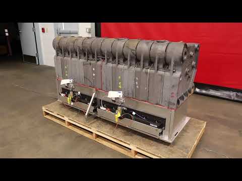

    I noticed the block sits on a sheet metal base assembly.  This is different than Megasteam and Peerless 63 where the iron castings stand on the floor.
    https://youtu.be/5YHx-8M9wY4
    Steamhead Member Posts: 18,193
    This is typical dry-base atmospheric boiler construction. Despite the refractory in the base, these boilers lose considerable heat from their bases. This is one reason they're not as efficient as wet-base boilers like the MegaSteam, where the cast-iron and the boiler water go all the way under the flame.
    The Peerless 63 incorporates the support structure into the end sections, but is still a dry-base boiler.
    Atmospheric burners also have very poor control over combustion air, often running with 35-50% excess air as opposed to 20% or so on a power gas burner. This excess air just blows more heat up the chimney.
    It is true that atmospheric boilers have gotten more efficient over the last couple decades, but they still cannot match power-burner gas boilers.
