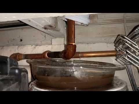

    Two other tidbits of information I forgot to disclose...
    Once I heard the water hammer, I removed one of the furnace air vents and waited about 30 seconds as air blew out. Later that day I noticed about 3-4 cups of water discharged from the water release valve shown in the picture above.
    Today I opened the new water valve I installed near the floor and 4 gallons of water drained out thinking I was going to cut the pipe and lower it. Once I realized it didn't need to pitch, I filled the boiler to the point the sight glass was about 3/4 full. I turned up the thermostat and within 5-10 minutes the hammering came back and water started coming out the release valve. Any idea why water is pushing up that high? Sight glass is still at 3/4 full.
    Here a small video clip:
    https://youtu.be/iz5et2-ZQHM
  • ChrisJ
    ChrisJ Member Posts: 15,708
    You need to skim water / oil off the top of the water, not drain from the bottom.
    Single pipe quasi-vapor system. Typical operating pressure 0.14 - 0.43 oz. EcoSteam ES-20 Advanced Control for Residential Steam boilers. Rectorseal Steamaster water treatment
