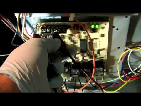

    ethicalpaul Member Posts: 8,141
    A funny case of similar problem: https://www.youtube.com/watch?v=SCuBpEWNXec
    Intplm. Member Posts: 2,826
    That sounds like a pretty big short. Not wired correctly. What is the plan now ?
