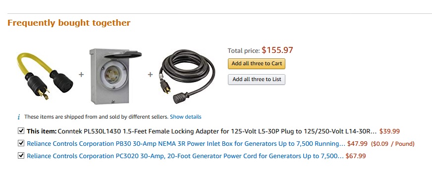

    I'm having a manual external transfer switch Installed to code and the inlet connection redone that's out In the old wood shed. Only going to have essentials. Well pump, on demand water heater, smoke detectors, fridge and freezer, boiler and some recepticals in living for lights and to run pellet stove. I have lamps and other stuff if I need light In other rooms.

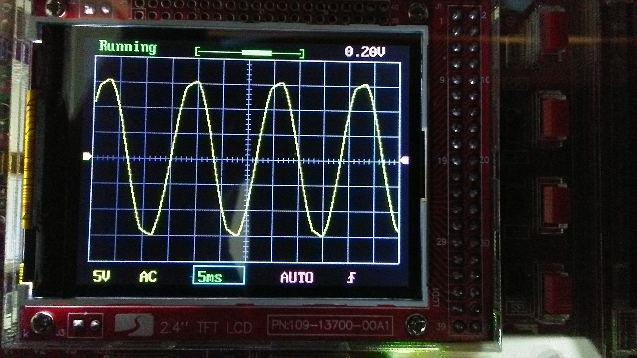

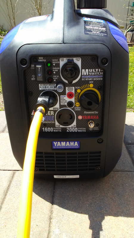

    I picked up an inverter style generator for basic needs (heat/lights) for my mod-con boiler. Got it from Costco... it uses a real Yamaha engine, purrs like a kitten and literally sips gas.
    I ran it under load and put an oscilloscope on it's output before running my mod-con with it's ECM pump off of it. Really nice waveform, boiler and ECM pump were happy with it's power.
    Only thing is- the small inverter generators are 120v vs. 240v so you need an adapter cable to use a standard 240v 30amp generator inlet to your panel. The adapter cable is about $40 on Amazon.
    https://www.costco.com/A-IPower-1600W-Running--2000W-Peak-Yamaha-Powered-Gas-Inverter-Generator.product.100343958.html

    That waveform on the Yamaha is a bit trashy near peak of the sine wave. That will result in a bit of THD . Waveforms on the Onans look cleaner.

    I'm having a manual transfer switch being installed in my carport as my utility closet doesn't allow enough room after new boiler install. Only going to have them run the essentials to the transfer switch panel. (Boiler, well pump, smoke detectors, utility closet which is where my tankless on demand is plugged into, fridge and freezer and living room outlets to power pellet stove if needed).
    Granted I wont be running all that at the same time. Most power draw would be from well pump and fridge and freezer. Just what I need in a pinch if power goes out.
    With the transfer switch I installed and genset hooked into house electrical system it should ground it without needing a grounding rod.

    I guess it depends on a combination of the boiler, it's pumps and the quality of the generator waveform.
    Old atmospheric boiler with 007 pumps will run on garbage waveform, low voltage and even off 60Hz sync. Mod-Con and ECM pumps are much more fussy.
    I ran my Grundfos Alpha on a APC Back Office UPS as a trial... it was literally singing! I disconnected it immediately. I put that UPS on my scope... look at the garbage waveform from a $100 UPS...
    I didn't have the nerve to actually fire up the mod-con on that UPS.
    I then ran it off my CyberPower CP1500PFCLCD PFC Sinewave UPS with a waveform that is almost identical to my inverter generator:
    The ECM pump ran perfectly quiet with that power source as it does with the inverter generator. I fired up the mod-con while on that UPS and the inverter generator.. ran flawlessly on both.
    I wouldn't run a mod-con and ECM pumps off just any old generator without checking it's waveform and listening to the ECM pump while actually running.

    $4k for that Honda EU 7000 is nuts.
    Thinking outside the box....
    Get a 1600watt inverter gen like the Yamaha from Costco for $500... just use that for the boiler and some lights if needed.
    Get a regular 5,500 watt Generac from HD for $700 for the rest of the house.
    $1,200 investment vs. $4,000 investment :)

    The little Honda 2000 or 3000 isn't a bad price and nothing but good reviews on them. I do like the fuel Injection on the 7000 though. But carb maintenance isn't an issue. I use ethanol free premium and don't let gas sit too long. Thanks for the tip. May just grab a smaller Inverter to power the boiler.
    Only issue is that those smaller inverter gens don't have the 240v twist lock outlet. Just the 120
  • NY_Rob
    NY_Rob Member Posts: 1,370
    ^ Costco doesn't stock that generator... it ships to you for $9.99 via UPS. Mine took one week to arrive.
    240VAC is just the differential between two 120v legs running opposite phase. You can get an adapter cable on Amazon (https://www.amazon.com/dp/B0050PQ0UO/ref=psdc_6396124011_t3_B01MYCFX91) that provides 120VAC to both legs of your breaker panel from a 120VAC generator.
    Only thing you can not run is true 240VAC appliances like A/C's, cloths dryers, etc. Basically, you initially turn off all your breakers, then turn on only the required breakers (lights, boiler, etc).

    Awesome. I was looking for those but couldn't find the right one.
    I'm not having my dryer or central air untit run the the transfer box.
    Now with this adapter would I have to have the contractor wire the transfer switch different or could I just plug and play then just flip on my boiler breaker?

    I believe no generators output anything even remotely close to a square wave, they are all a basic sine wave. It's inverters (cheap ones) that output ~ square waves, think inverters for car tailgating or computer UPS. Cheaper gens might have little distortion on them as in above pics, or spikes (not present on above pics).
    Gens have limited power output ( 2, 4, 7, 10, 20 ....) kw, compared to ~ infinite power capability of the power company. So if you drop heavy loads on gen ( like start a large motor) voltage may sag. But that's only if you don't properly size gen to motor starting loads (surge). Example of a sag problem is if start an air handler or A/C compressor and voltage drops so much that relay contactors chatter. Read motor's LRA (locked rotor amps) for a hint at gen kw size you need.
    I'm not 100% familiar with electronics in furnaces, but I'm guessing they wouldn't like sever under voltages like this either. If they used a micro-processor it might lock up, likely need to kill power to let it re-boot
    In general I wouldn't want to feed semi -square waves in above pics to most electronic loads unless they used a switching power supply ( computers have them). Switching power supplies can run off most any garbage waveform since they 1-st rectify everything to feed a capacitor (makes it smooth DC), then transistors sip power off that clean cap voltage to switch a transformer at high frequency, output is then rectified back to clean DC for circuit loads.
    NY_Rob .....Not surprising motors and transformers sing on that semi-square wave pulse, I've had same happen with instrument motors I've designed. Put a FFT frequency meter on it you'll see that in addition to the primary 60 hz fundamental, there will be significant energy present at many of the higher frequency harmonics (120hz, 180, 240, 300, 360....) . When motors/transformers sing what you are hearing is those higher frequencys exciting mechanical resonances inside them. Supposedly harmonics only make motors run hotter (iron losses in motor magnetics), they do no real work. However I believe transformers respond by also having bit higher output voltage, along with outputting those harmonics. However properly designed power supplies for the electronics should filter that out. Just depends how well they designed it.
    No, just wire the standard inlet box as usual- if you get a 240VAC generator down the line... just plug it in to the inlet box. If you want to use the small inverter generator- plug the adapter cable into the generator- then plug the other end in to your regular 4-prong generator cable that's plugged into the inlet box.
    Just make sure you turn off all the breakers (most importantly the 240VAC breakers) before throwing the transfer switch to power your panel from the 120VAC generator.
    The full solution that would let you use a 120VAC or 240VAC generator is shown at the bottom of the Amazon page below the adapter cable...

    I got my self a Yamaha ef2400, I picked it over the smaller popular hondas, one because as well as the Yamaha ef2000 they come with a fuel gauge (important to know when to refuel), two because you can shut the fuel off and let the gas burn in the carburetor (this is a common problem with generators that won't start after sitting for months) and last unlike Honda, Yamaha has OHV engine which translates to a longer life
    Only the Honda eu7000 has an OHV engine and is Fuel Injection which solves known carburetor issues (I believe it has a GX390 engine)
