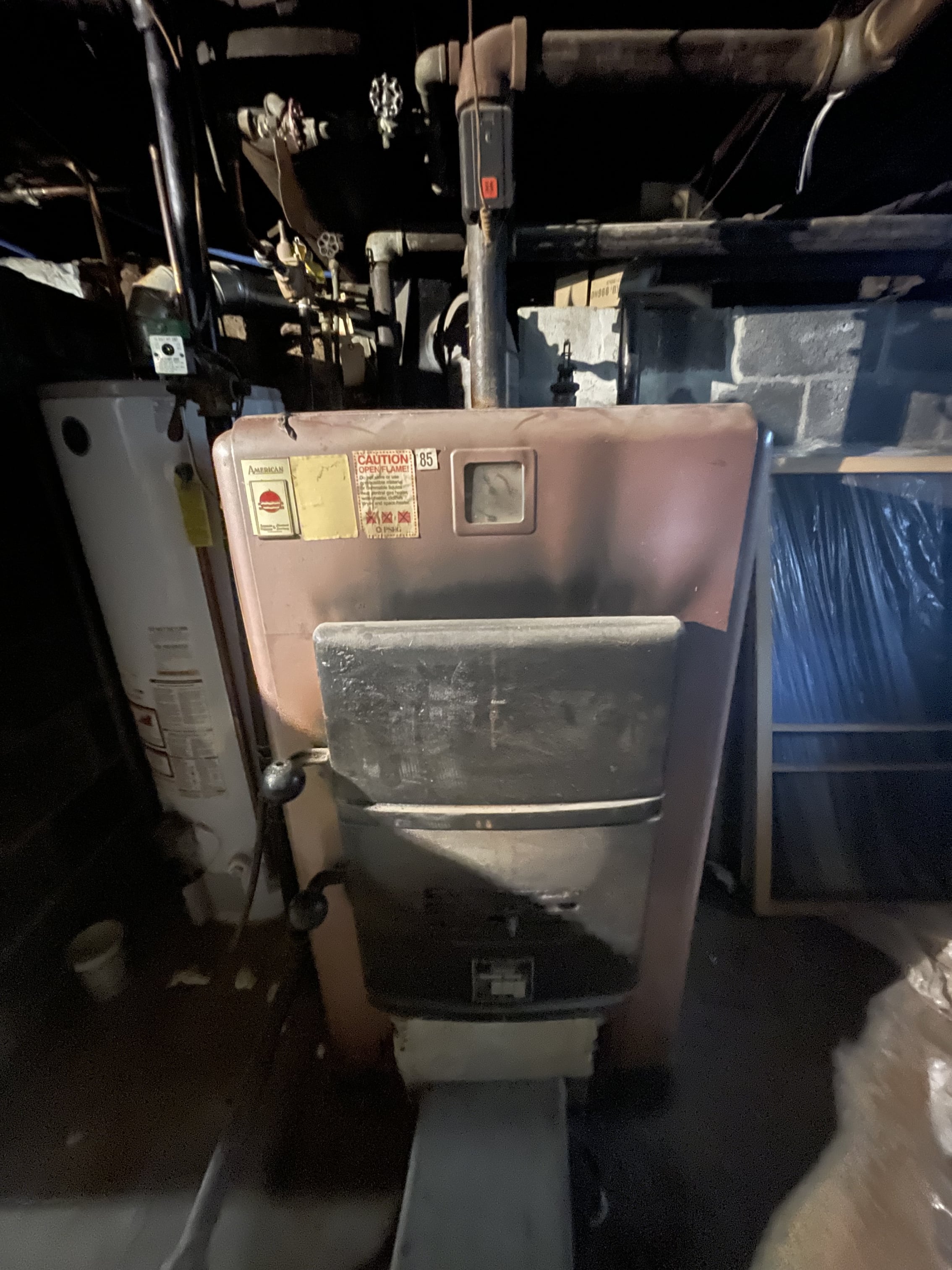

Purchased an old house with an old boiler. Doing some research found similarities to the American Standard Severn Series 1954. Gas fed hot water system. Boiler needs to be serviced but not sure where to start. Boiler is located in the cellar, 1st floor which has the tstat has decent heat, but hot water is not making up to the second floor. Mainly radiators but do have baseboard on portion of 1st floor. Any advice out there?

    Good old boiler.
    1st step is to check the water pressure in the boiler. You should have about 15 psi when the boiler is cold. When the water is heated it may gain pressure to the low 20s but should not be over 25 psi.
    The gauge on you boiler may be faulty. Best bet is to get a 0-30 psi gauge at a big box or hardware store. You can install it on a drain valve (flush some water out of the drain valve first) and use this to check against the boiler gauge. Once you know the pressure is ok bleed the radiators on the 2d floor to see if they are air bound.
    You could have a water feeder or expansion tank issue. Report back what you find.

    That boiler may be old enough to have a manual water feed valve rather than the automatic pressure reducing type feeder that became standard in the 1950s. I had the same model in my house, installed in 1947.
    Is there a cylindrical steel expansion tank in the ceiling over the boiler?

    It's hard to tell but the pressure gauge looks bottomed out. There is a feed valve and backflow preventer both could be blocked up. Or the gate valve could be closed

    Your gauge shows 8 psig of water pressure, not enough to completely fill second floor radiators. The red pointer should have been set at installation to the normal cold fill pressure for your system. This suggests that your pressure reducing (automatic feed) valve is not working, or that a manual valve upstream from it is closed. There is no point in bleeding the upper floor radiators until fresh water can enter the system again.
    Your expansion tank is a compression type and needs periodic draining to restore the air cushion. Can you post some photos of the pipe connection between that tank and the boiler?

    You appear to have a gravity hot water system with a steel compression tank to maintain balance and flow in the system as I see no circulators or wiring for them. I always liked how these systems worked.
    Steel compression tanks are not ment to be drained and refilled periodically as it allows oxygen back into the closed system.
    A steel compression tank has either a drain-o-tank valve or an airtrol valve or both.
    You have a single Honeywell clamp on aquastat that is set at 170 degrees for the high limit to get the water moving by using the thermostat in your home to activate the boilers burner to heat the water.

    yes! I keep saying it’s gravity fed and get looks like I’m crazy. What do I do to get water circulating throughout the system??
    you increase the pressure and bleed the upper radiators. 8 psig can push the water up at most 18 ft.
    the compression tank looks fine although the air management devices are more for pumped systems and rely on the flow from the pump to pull the air bubbles with the water to some extent. pressure and temp changes will move air to some extent but it works better with a circulator.
    that being said, there is no reason not to keep it as a gravity system as long as you are using that boiler.
    if the prv and valve are hopelessly corroded up you can fill it using a hose connected to one of the drains.

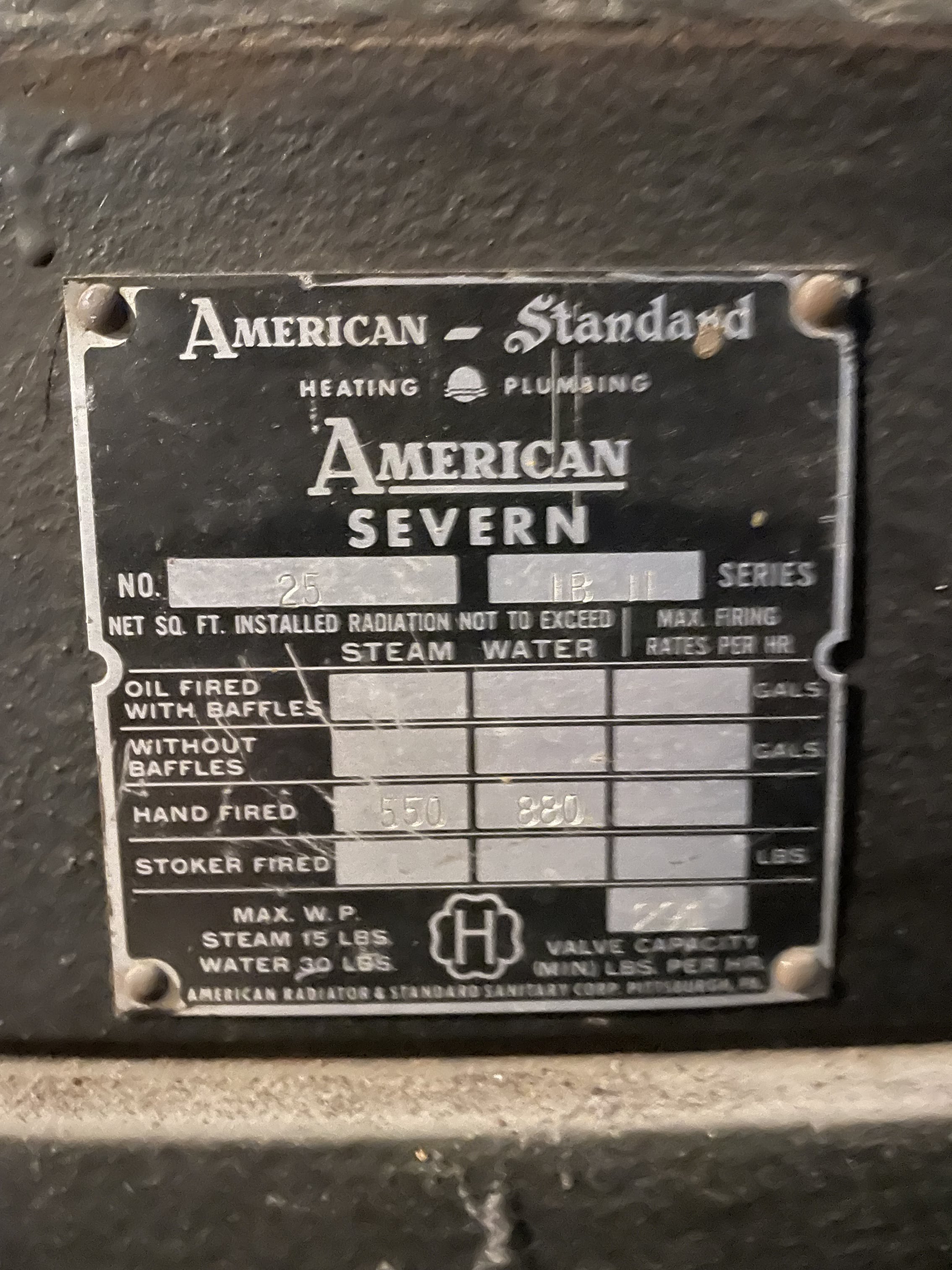

    Wow! Interesting old boiler. The plate says “hand fired,” so it started life burning coal and was converted to gas at some point. That’s useful to know for a few reasons.
