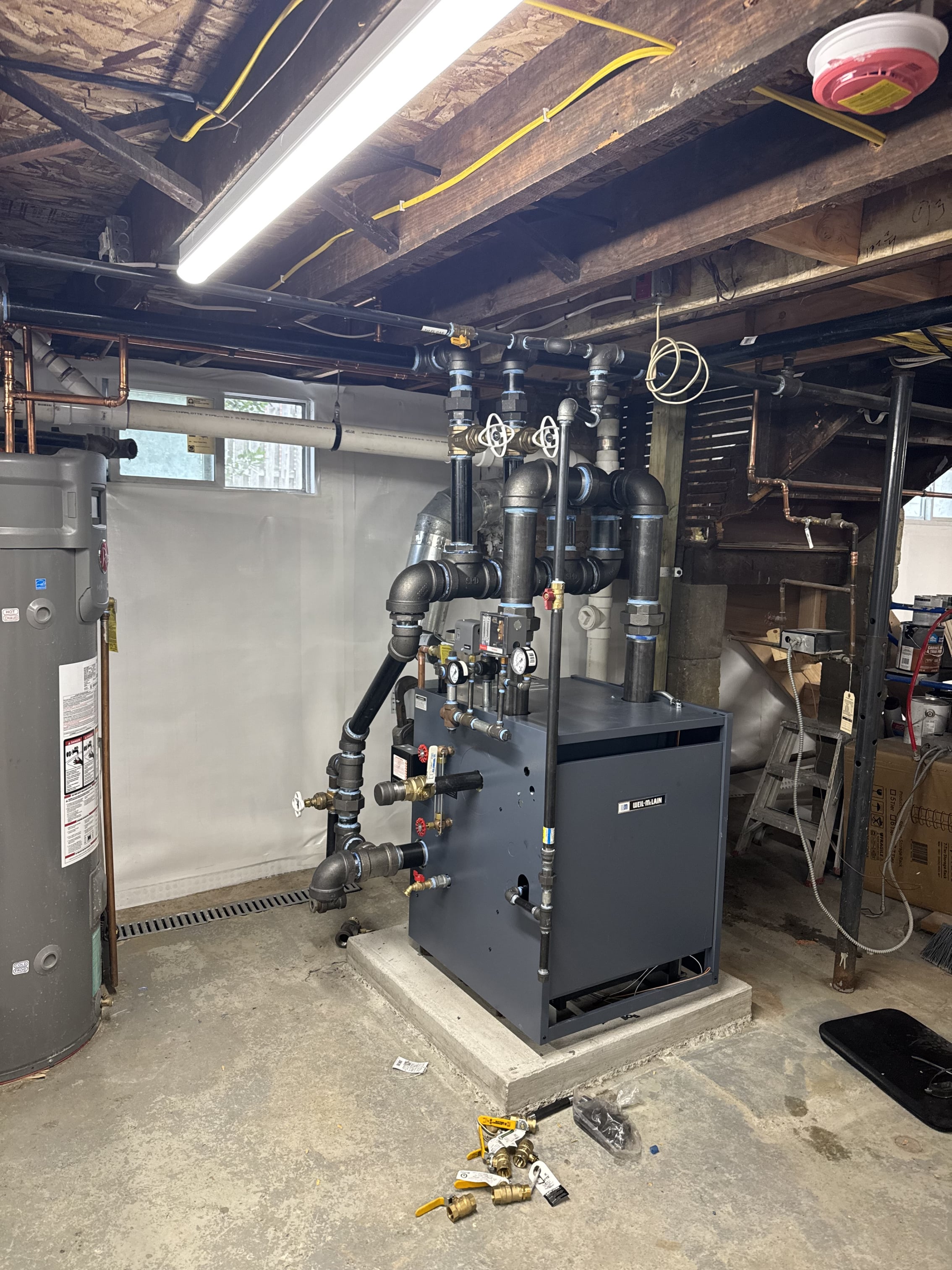

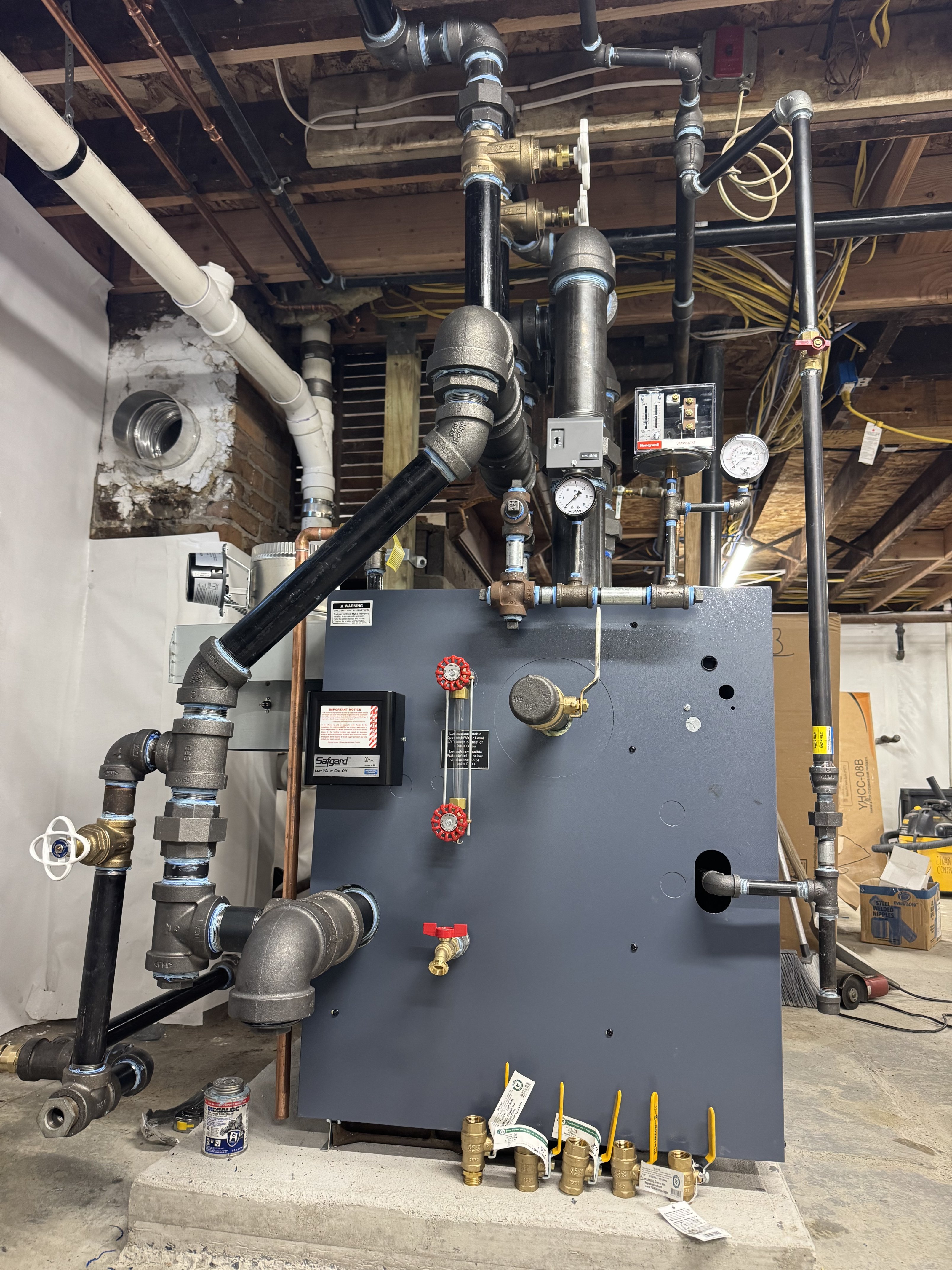

EG50 install cust knew exactly what he wanted. Rerunning the left steam main in 2” (it’s 1-1/4”) as it was an add on at some point in the last century, uneven heating wrong pipe sizing m, poor pitching, water hammer etc. it handles 5 extra radiators. This is also getting a two stage gas valve with a vaporstat set to 8oz. We’re getting there. I’m by myself.

Good to hear from you, Dave. Was that housekeeping pad there already or did you pour it? I'm trying to get my guys into the idea of pouring new pads for our installs.

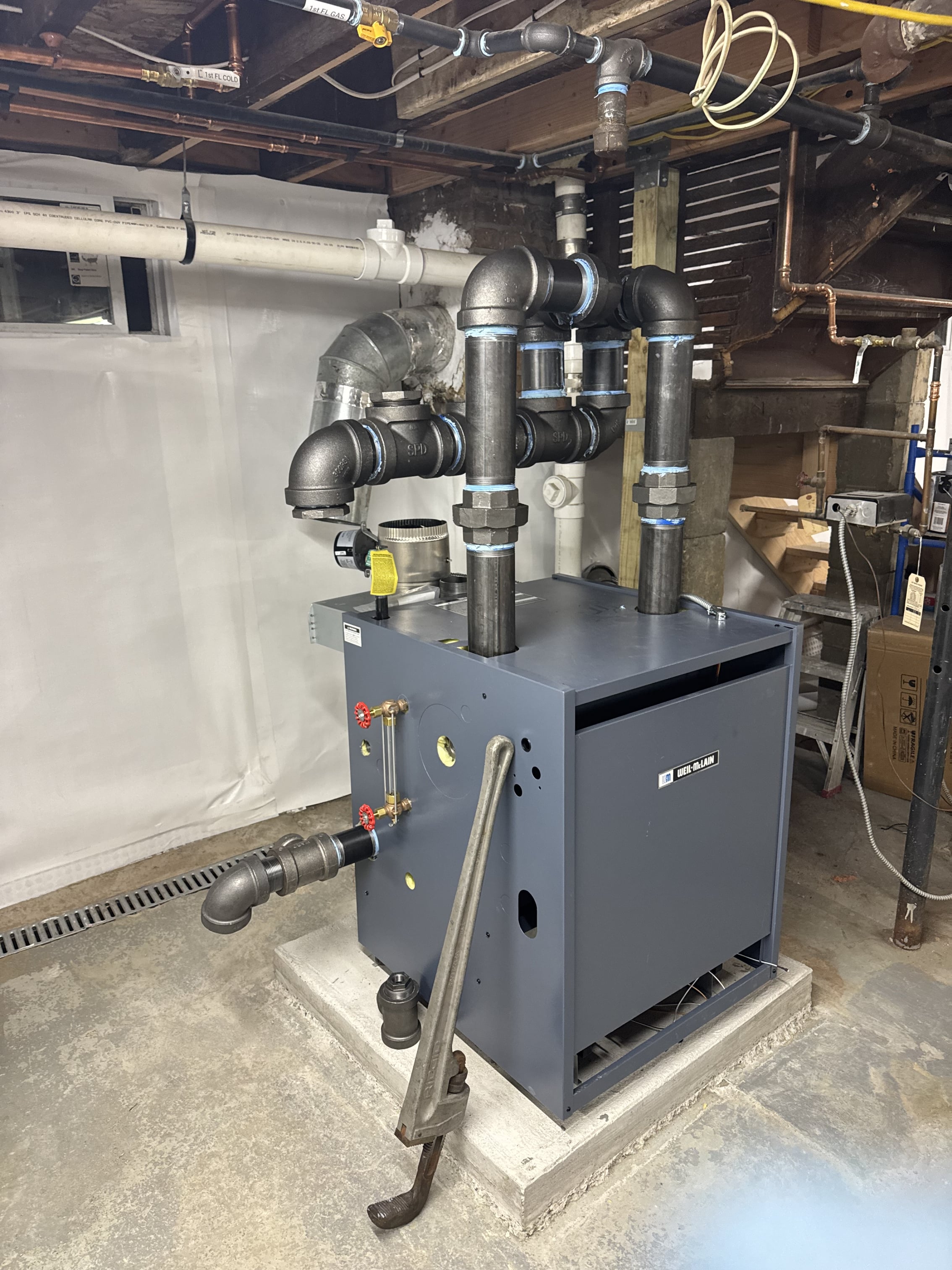

And…. She’s a runner

Still some work to get done. Got to reconnect two radiators and finish piping the other steam main and connect the other 4 radiators. Till then most of the house has heat.

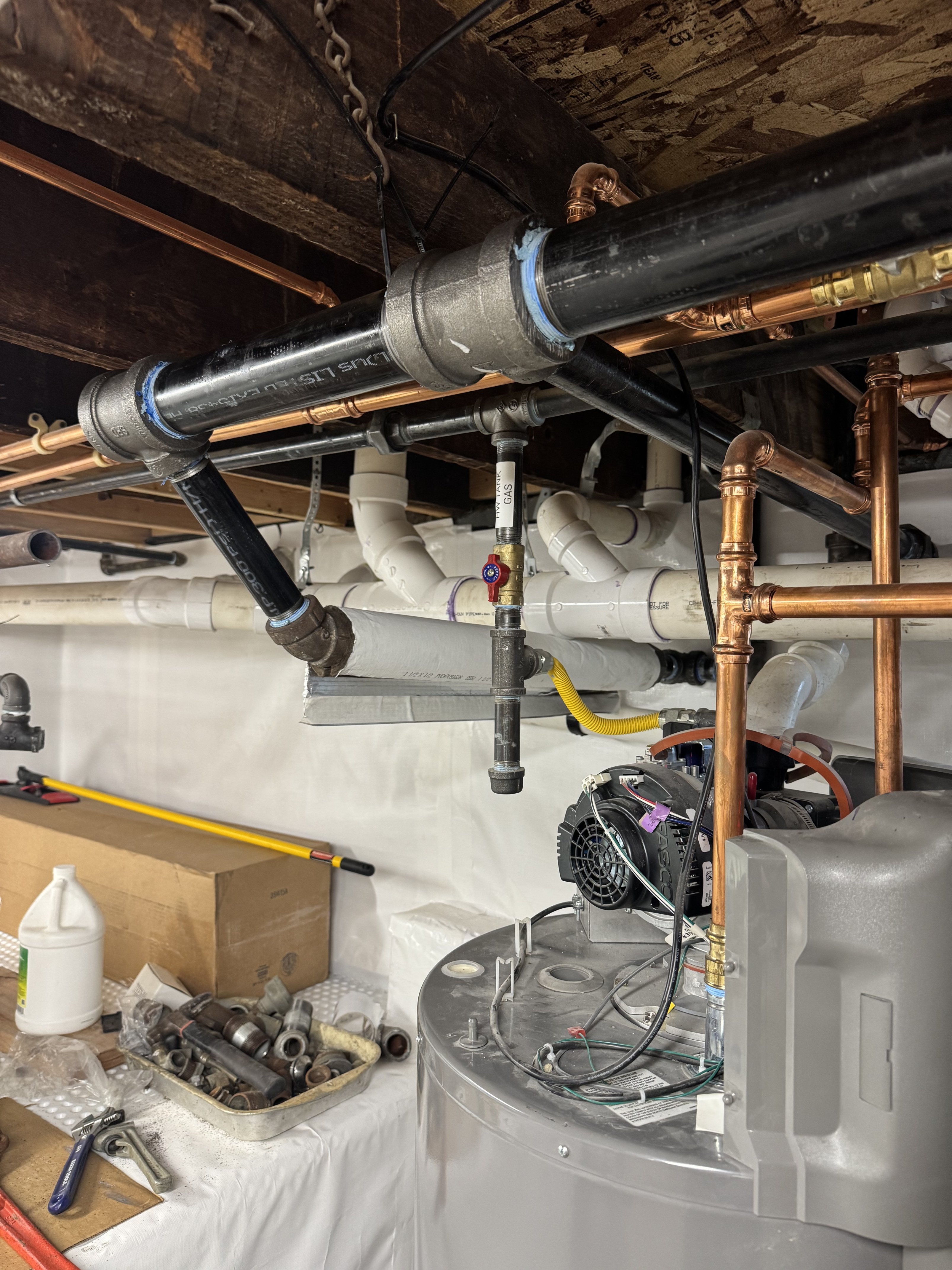

Where I am we are not supposed to come off the bottom of a gas line. Don't know if it is a MA. thing or not. They used to be strict with tees on all drops but they claim the "NEW" gas doesn't have any moisture in it so they don't enforce things like they used to. But the drip leg is there so who cares? Some codes have old leftover things from the old days,
