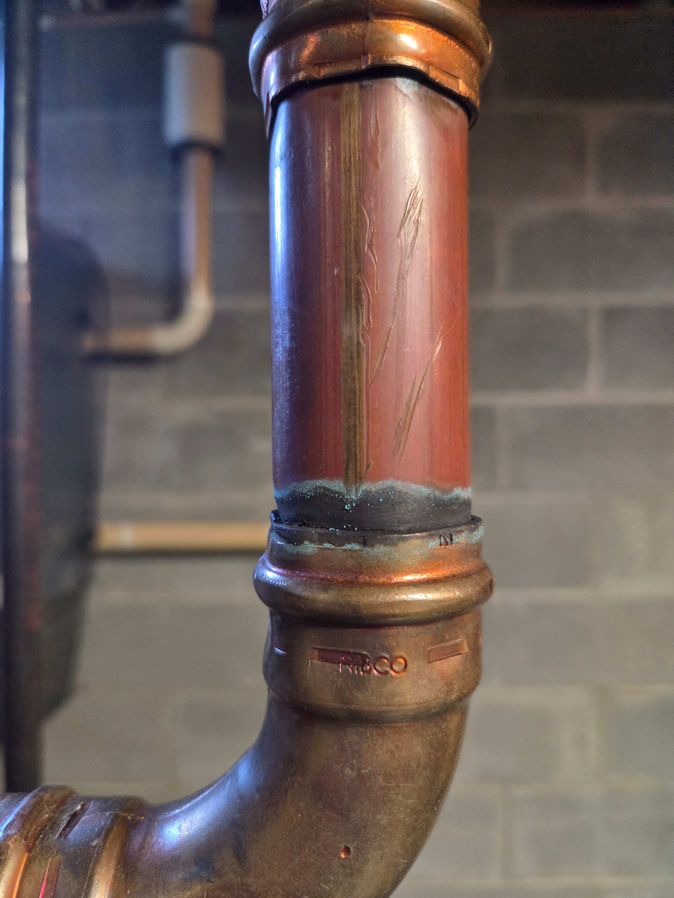

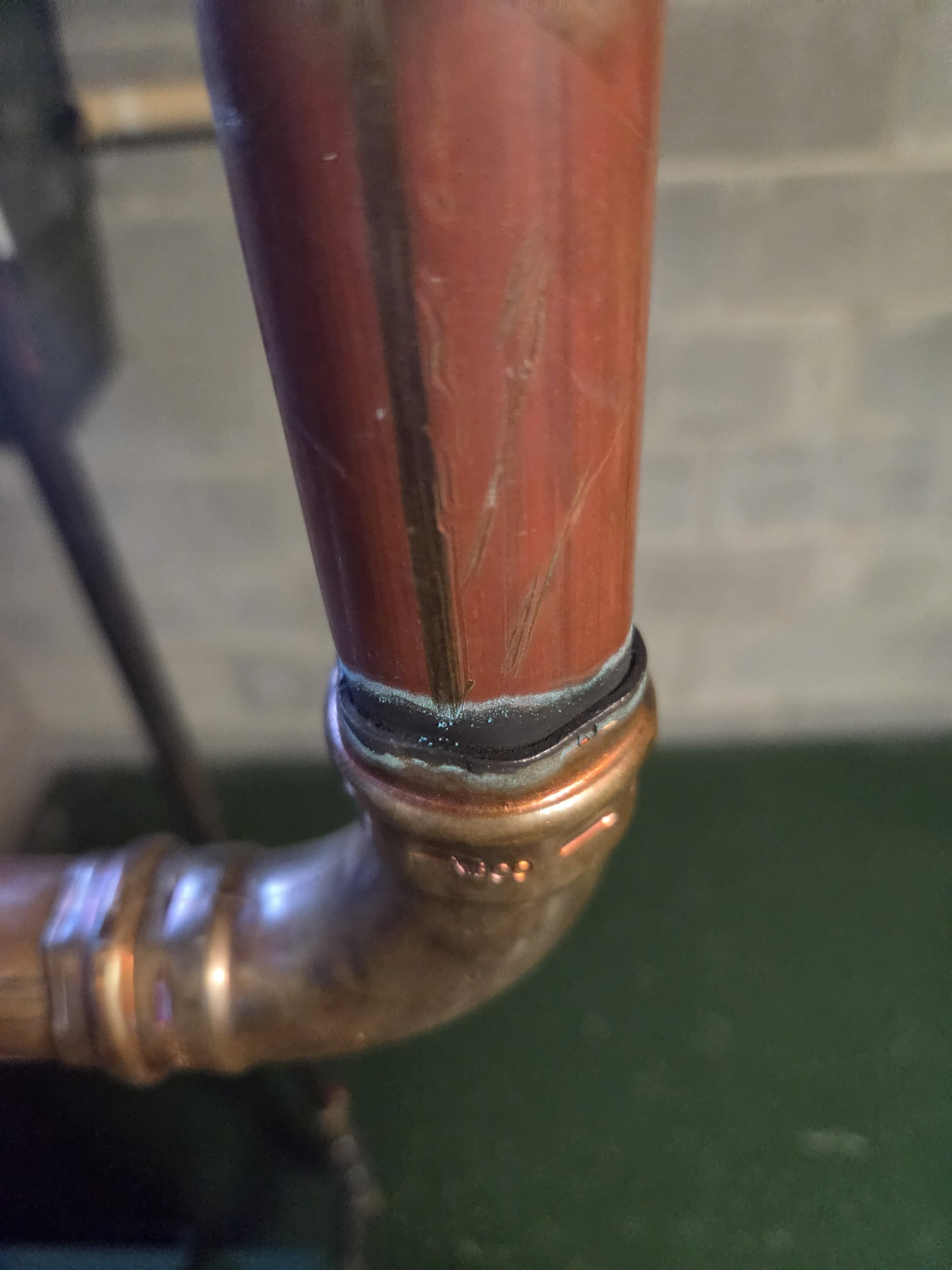

Good morning all,
This fitting is on my heating system. Thoughts….leaking? I have boiler service scheduled for thursday.

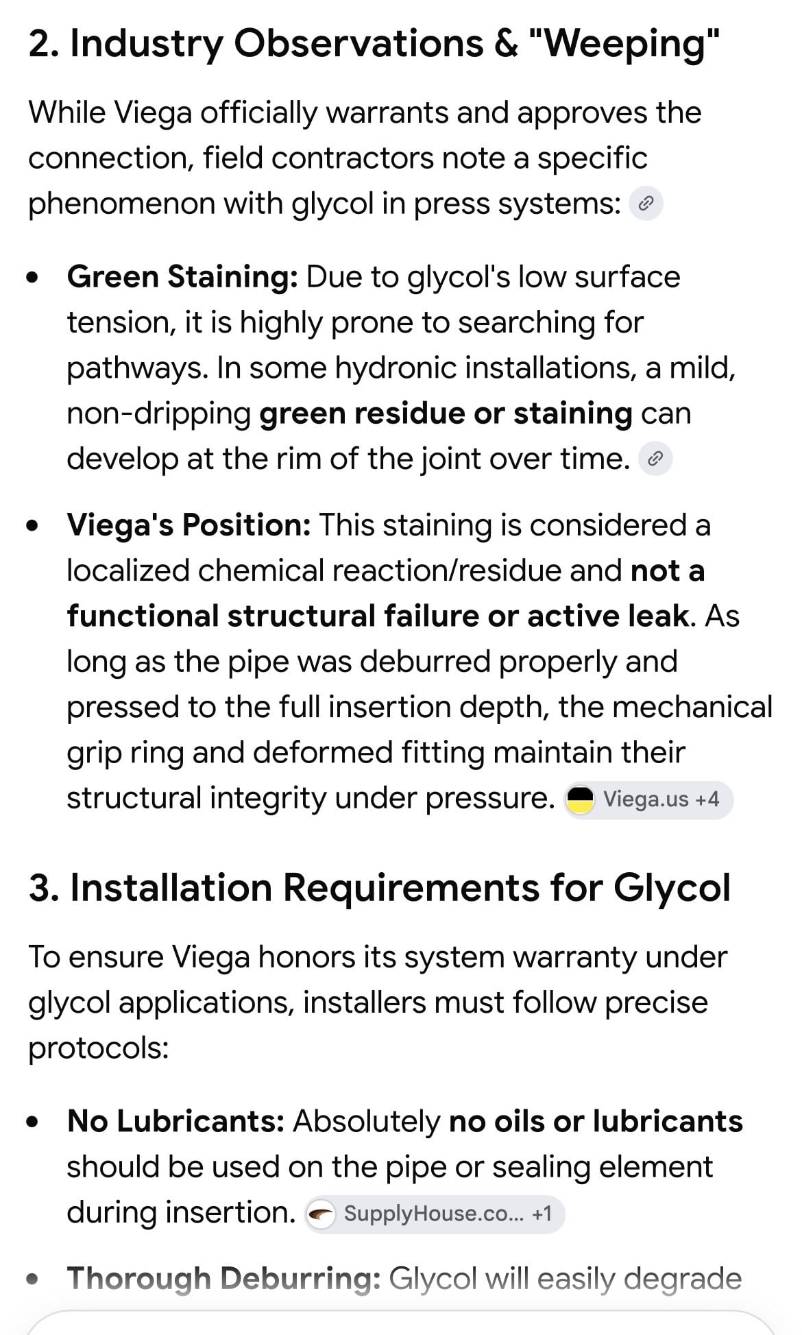

    it could be lack of proper prep on the tube, or the tool out of calibration
    Even with a proper press, they sometimes develop micro leaks. Glycol seems to be more prone to that green fuzzing
    An opinion from one manufacturer on glycol systems

    I don’t see the dimples on the fitting to show that it was pressed properly.
    might be able to clean it up and re-press it but it’ll probably have to be cut out

    @HydronicMike , no glycol in the heating system.
    @pecmsg , the dimples are there, just hard to see due to the black staining. To me, they look the same as the dimples on the fitting above it.
    This was installed about 6 years ago and I do not recall ever seeing the green residue. I recall black staining on the pipe but not on the fitting itself….I always though the black was from a sharpie.

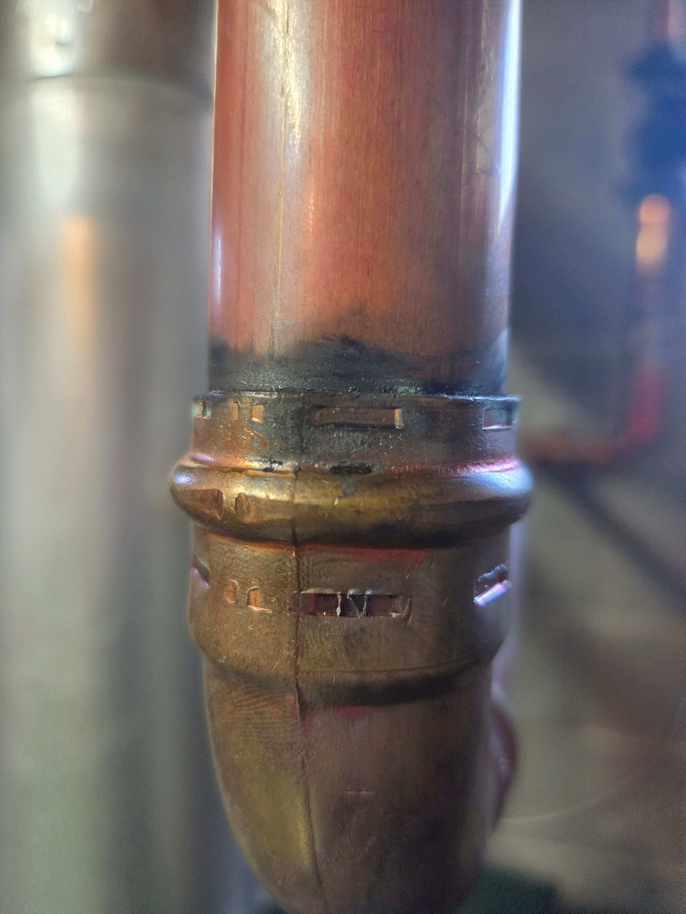

    All…I wiped away some of the residue from one side of the fitting. This should give you all a better vantage point. Thank you all, FloMo
    EBEBRATT-Ed Posts: 21,063
    Either way it is a very small leak. Not an emergency but if the system is drained for any other reason, it should be fixed
