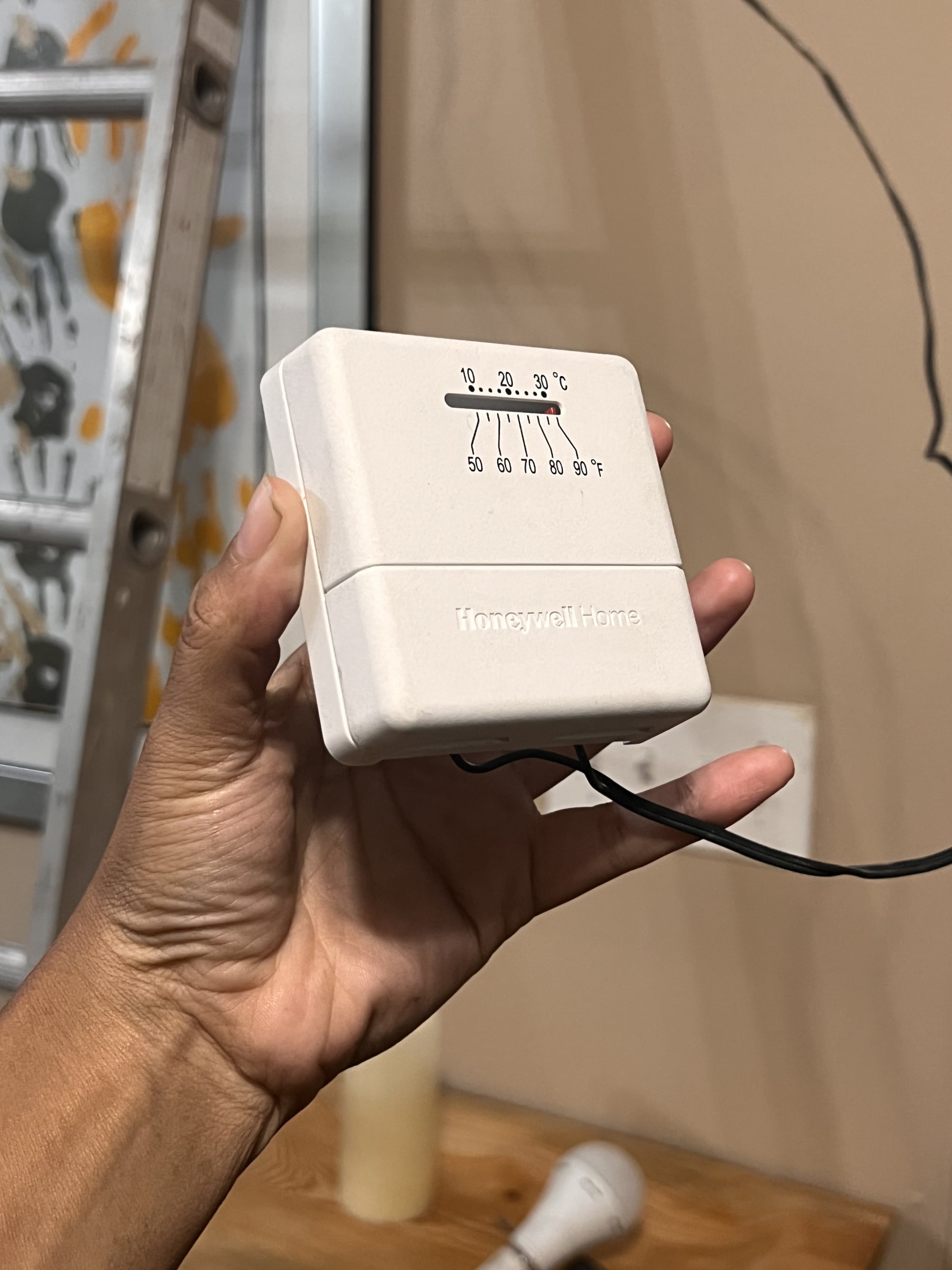

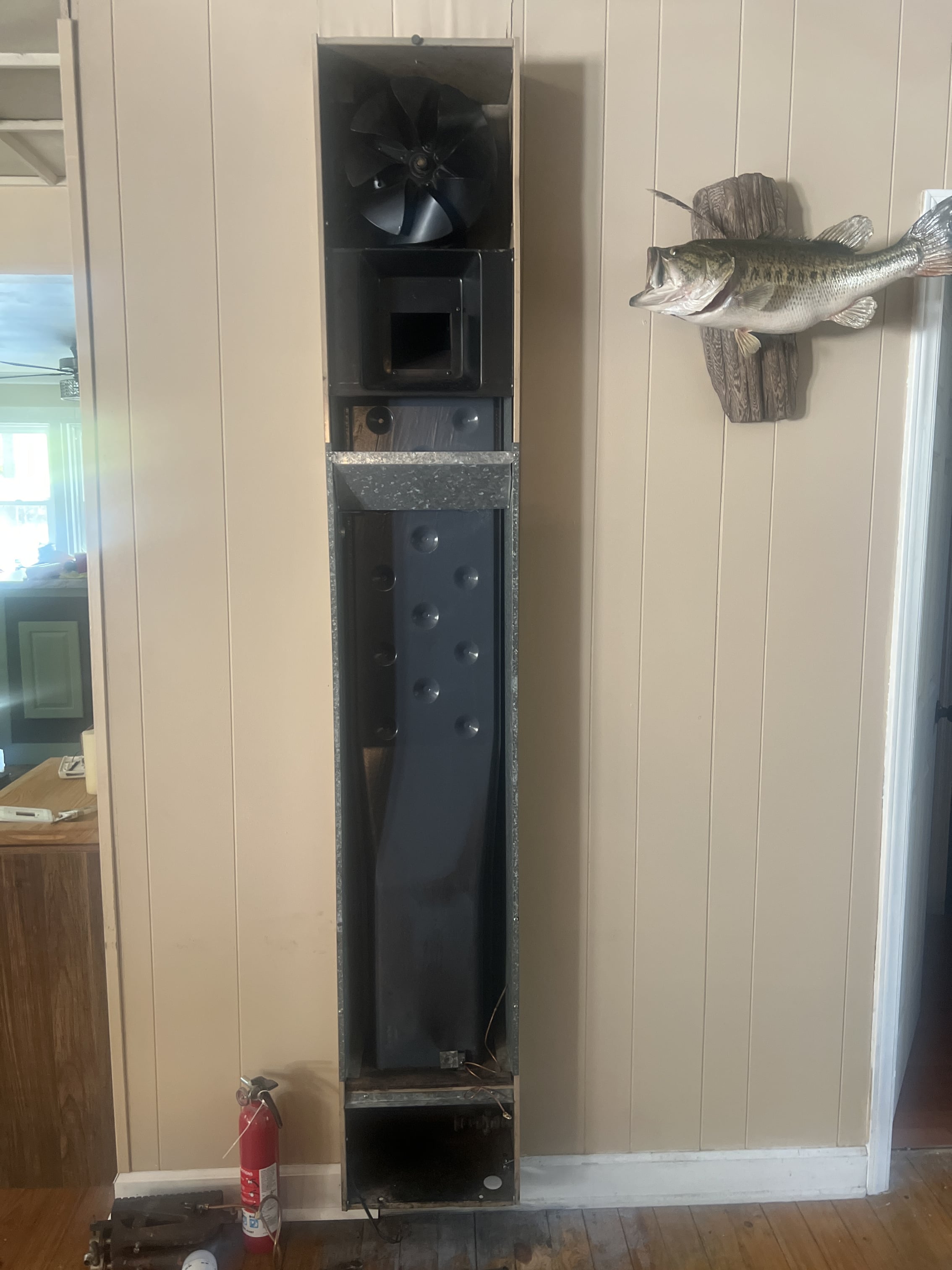

We believe we have a 1980s Williams propane wall heater. Three years ago we bought the house and turn it on for the first time.It worked fine but we haven’t use it since. Now we want to operate it. When pushing the pilot button to ignite it. It will light but won’t stay lit unless we hold the pilot button. As soon as the button is released to flame goes out. We changed the thermocouple and checked all lines for leaks. (Disregard the putty on the lines, leak has been fixed since that picture.)Also I should mention, due to the age of the house when we first bought it we had to fully update the electrical work. So there is a new Honeywell heat only CT30 thermostat. When we change the temperature on the thermostat the gas valve response to the correct heat. I really want to get this to work without buy a complete new unit.

    It looks like a millivolt gas valve. After lighting the pilot, the pilot button typically needs to be held in for at least 30 seconds to allow the thermocouple to generate enough voltage to energize the safety magnet in the gas valve. Once energized, the magnet holds the pilot valve open and allows the pilot to remain lit.
    If you’ve already replaced the thermocouple and the pilot still won’t stay lit, there may be an issue with the gas valve itself, which would likely require replacement.
    Changing the thermostat shouldn’t have any effect on the pilot-lighting or pilot-safety circuit.

    That black two conductor wire going up the cabinet side goes to a switch on the door front and that cuts the power to the gas valve from the thermostat when the door is off?
    "When we change the temperature on the thermostat the gas valve response to the correct heat. " What does that mean?
  • yes the two black wires goes to thermostat. When thermostat is in the off position it shut off power, so it doesn’t call for any heat. But as far the doors being off, it doesn’t stop the heater from functioning.
    “The thermostat and the gas valve responding to the temperature” for an example of if I switch the thermostat to 90• the gas valve gets very warm. If I switch it to 70• it cools down but is still warm. If I switch it to 50• or off, the gas valve gets cold.
    Also there is not switch on the door just the metal grates.

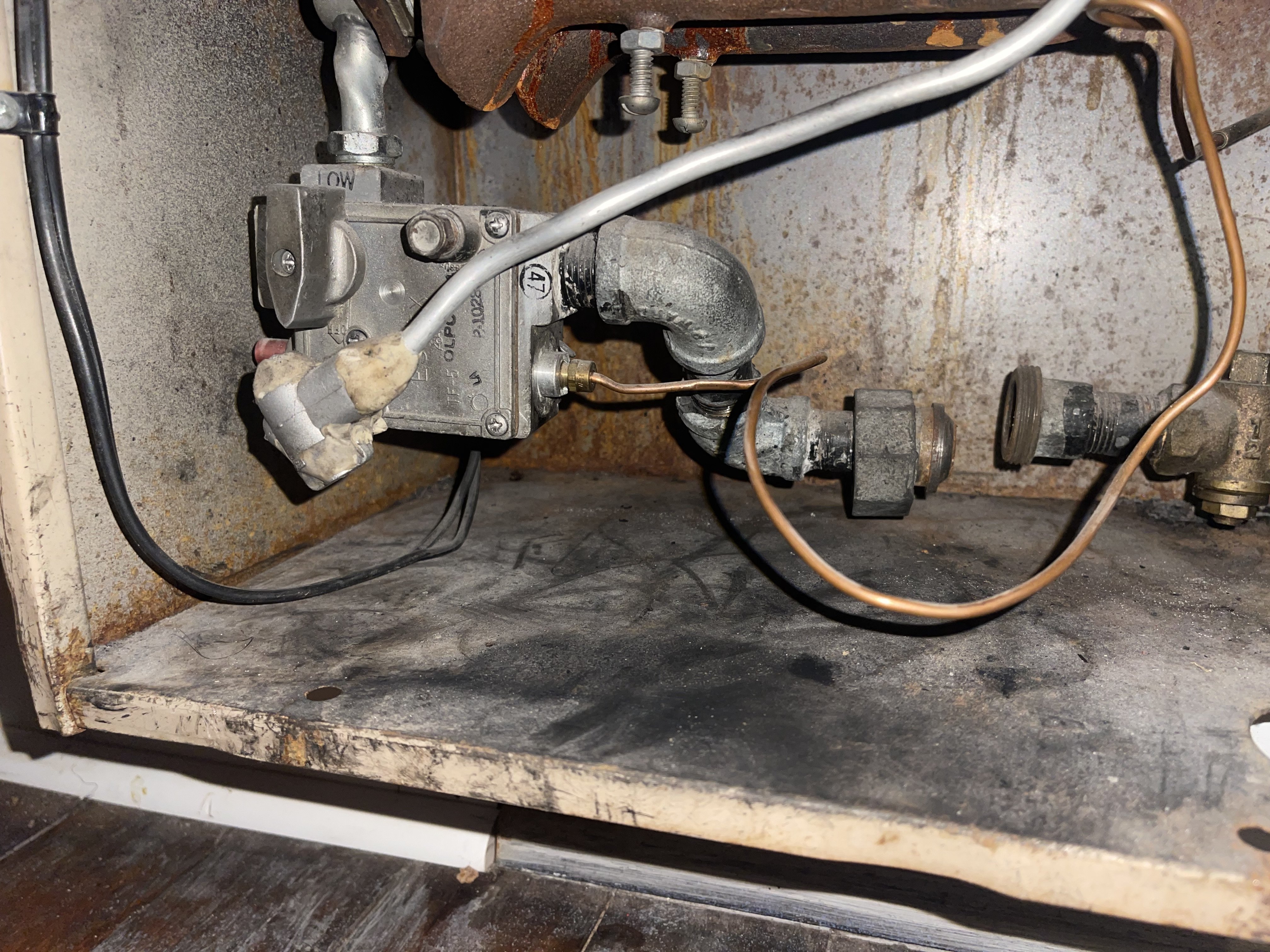

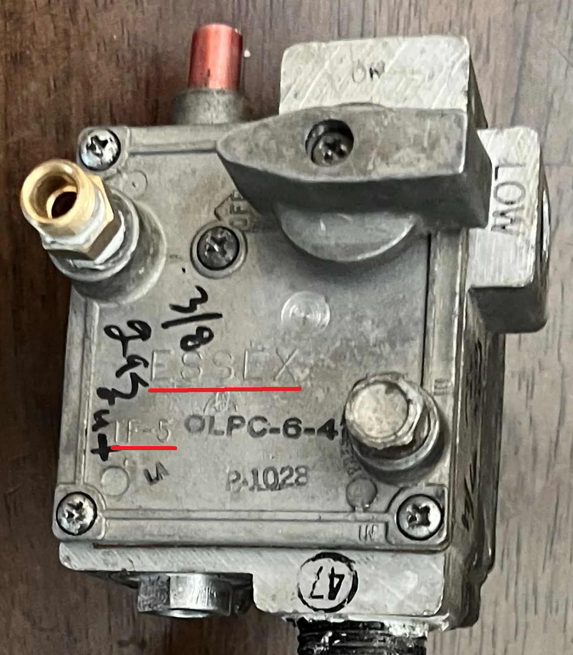

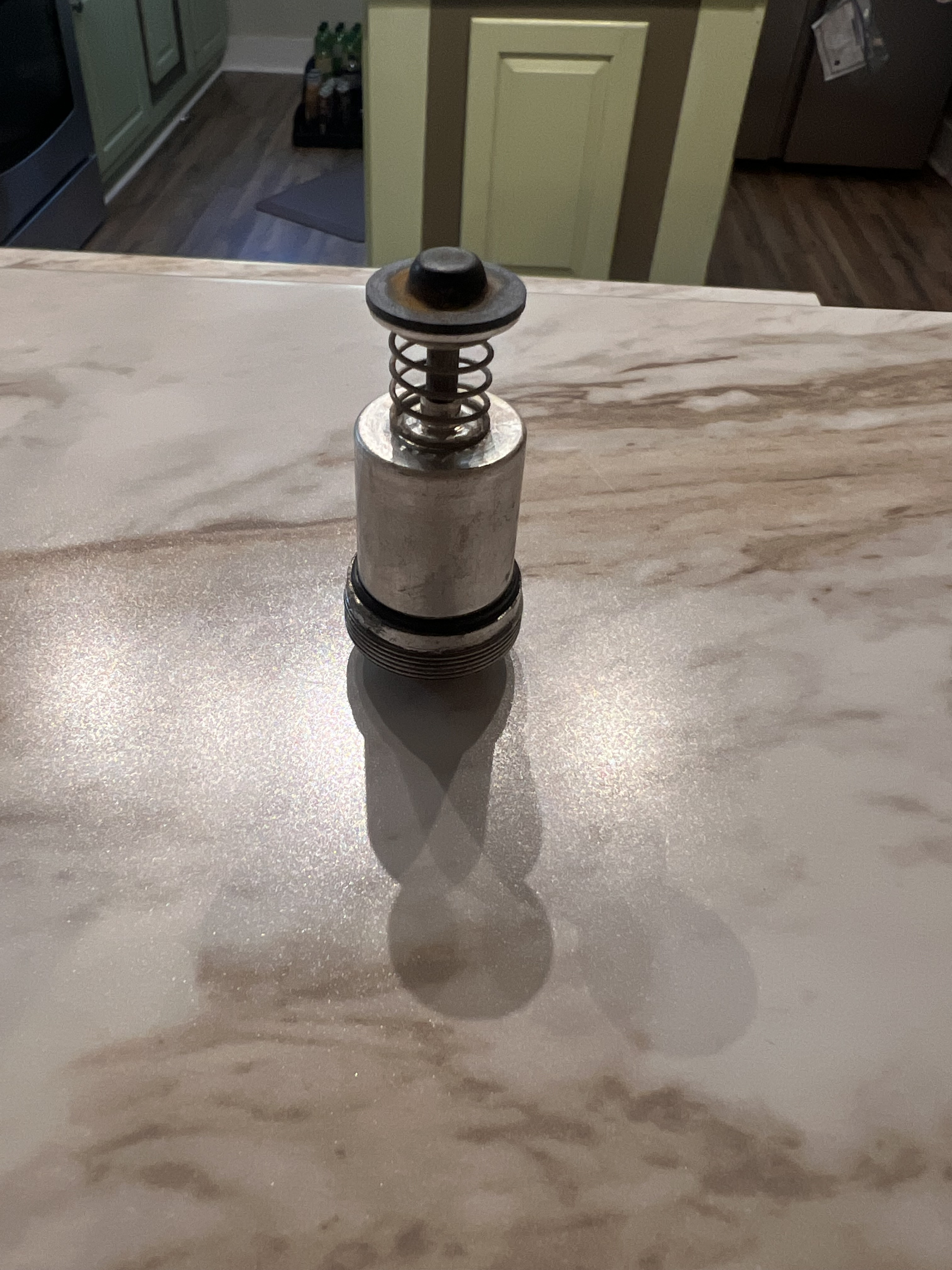

    So you think this needs to be replaced?(picture below)
    109A_5 Posts: 4,759
    Hmmm… I thought Millivolt systems had wires from the Power Pile / Thermopile unit, that looks like a thermocouple system to me. Is (was) the tip of the thermocouple sufficiently in the plot flame ? It may have just needed a thermpcouple. It looks like you have gone way too far too fast.

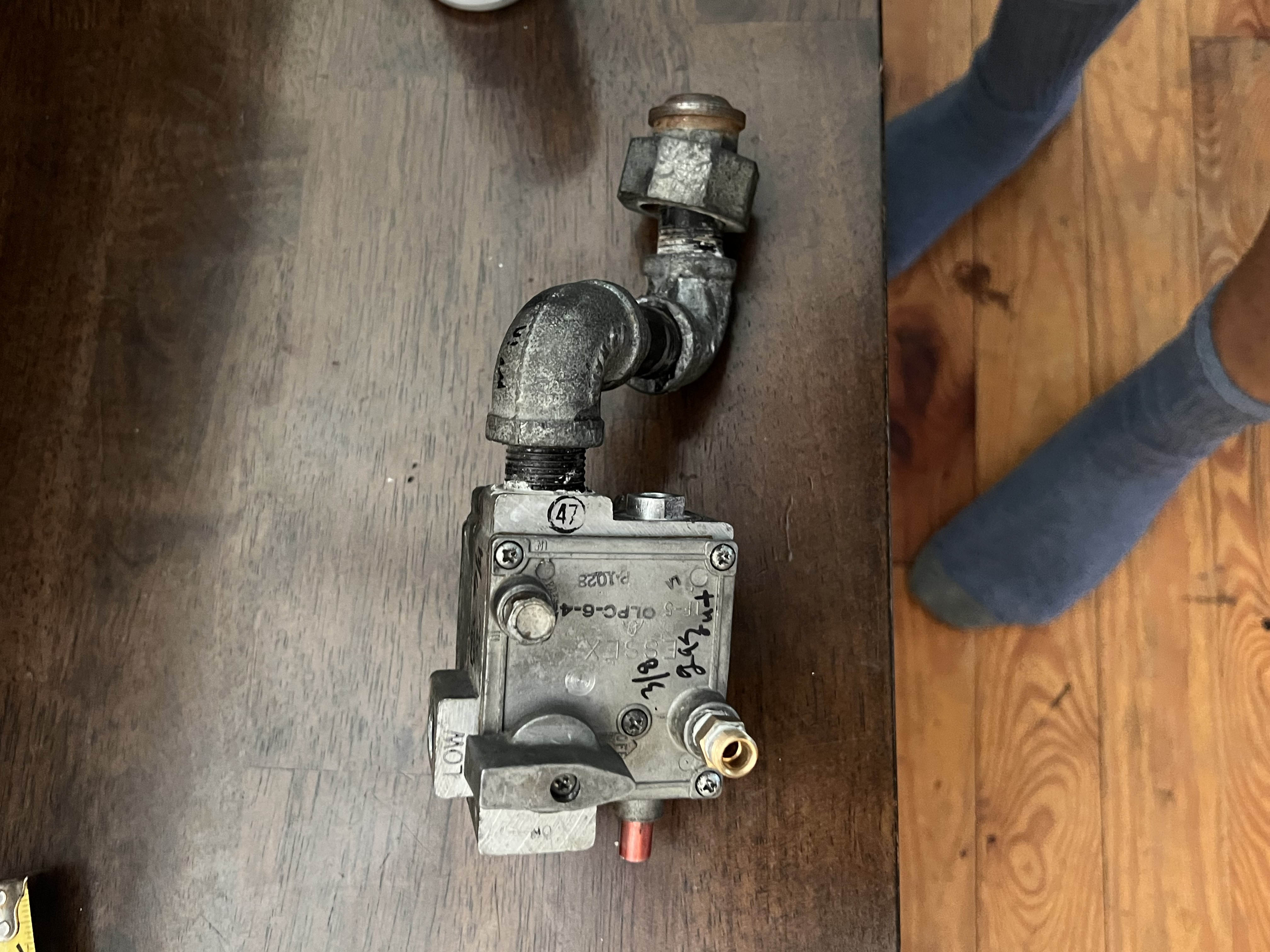

    Wow you took the Gas valve apart, the real question here now is how many folks heads just exploded !!!
    Anyway If the gas valve is actually defective the whole gas valve gets replaced, you can't get repair parts for them.
    BTW the fire extinguisher IMO is too close to the work area situation. If something bad happened that you actually needed the fire extinguisher and you backed away from the fire by reaction you may not be able to get to the fire extinguisher.
    What was going on here? Was something leaking ?

    stated in the original post. Yes the part with the putty on it was leaking but has been replaced. That picture was taken 3 yrs ago when we bought the house. There are no leaks in the system now.
    Ok so even though we replace the thermal couple last Sunday. You think we should replace it again?
    109A_5 Posts: 4,759

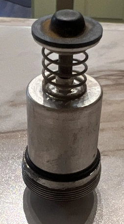

    No guarantee the replacement thermocouple was actually good, the quality of replacement parts in this country are at an all time low, its a race to the bottom.
    I suppose since it looks like you have the pilot valve solenoid removed from the gas valve assembly you could test the solenoid and the thermocouple as an assembly. With the thermocouple attached to the solenoid assembly, heat the thermocouple tip up with a propane torch or some like flame and see it the solenoid holds the valve in the open position when pushed into the coil body, like pushing the Red button. When letting it cool down after the test don't let the spring launch the parts across the room (never to be seen again) if they are not captive.

    Now that you have taken that valve apart, I would not use it. This is the closest thing I can find for a replacement valve. Robertshaw 720-007

    the gas valve should be replaced now that it has been disassembled
    can you show us the label on the gas valve? it looks like it is millivolt but the valve wouldn't get hot as a result of a call for heat unless it is a 24vac system with a transformer somewhere. did it work after the electrician touched it?

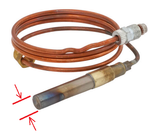

    Apparently back in the day the Essex TF-5 or TF-555 can be outfitted either with a Thermocouple or Thermo-Pile system.
    Nola803

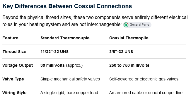

    that is only 1/32" difference in diameter and the same pitch. a thermocouple would thread in to a connector for a thermopile although it might strip if you tighten it enough.

    A thermocouple produces a millivolt DC output. A healthy standing-pilot thermocouple will typically produce somewhere around 25–35 mV open circuit, while a thermopile/ Powerpile produces substantially more as I previously stated —commonly around 500–750 mV. No disagreement there??

    Check the diameter of the old part, if the diameter is obviously larger than your replacement it is a Power Pile / Thermopile unit.

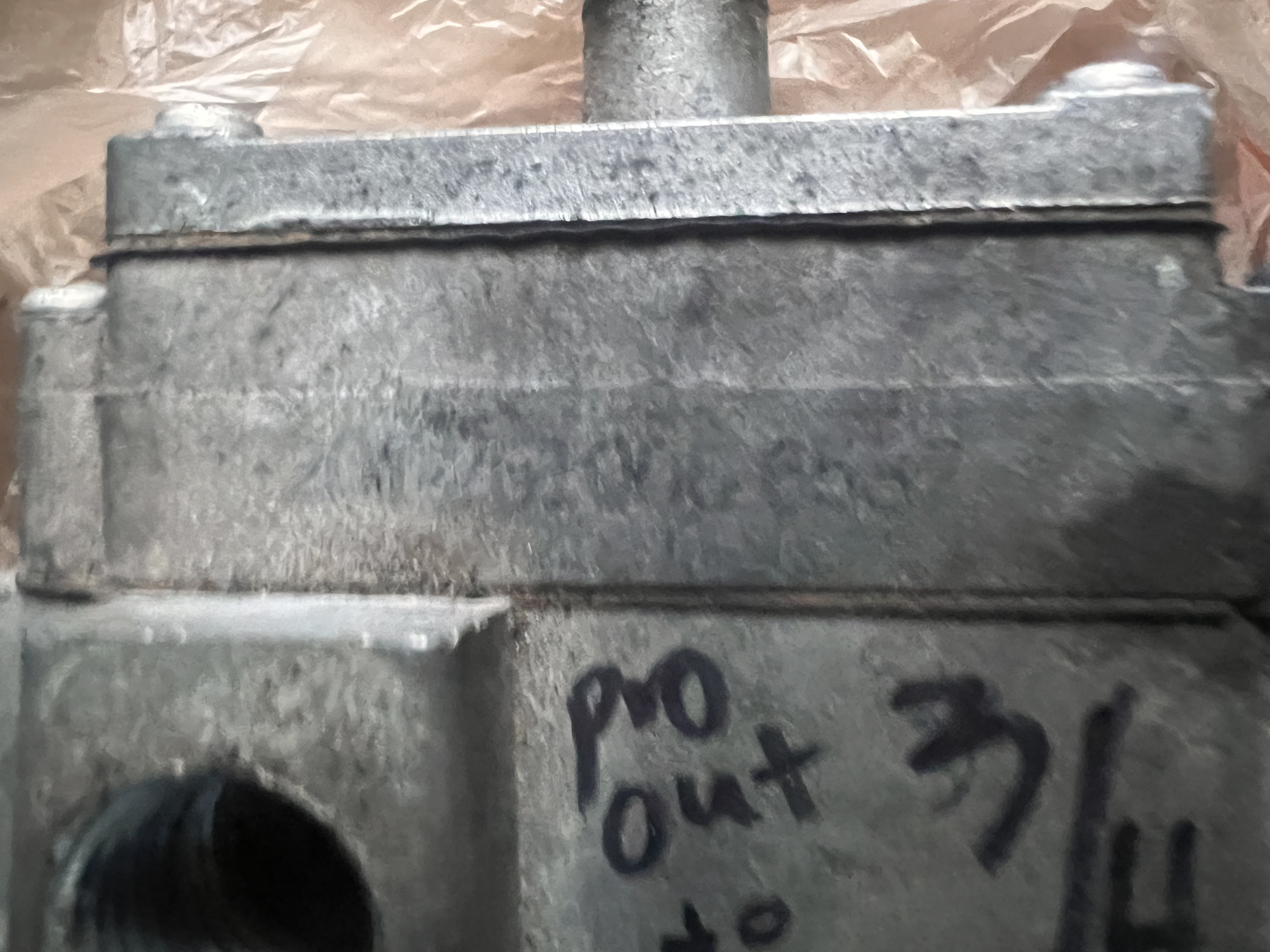

    also, what is a recommended replacement gas valve? Unfortunately there are no tags or stickers to identify the part ,this is the most information I have from the part (see picture below)

    EdTheHeaterMan Posts: 12,946
    edited October 1

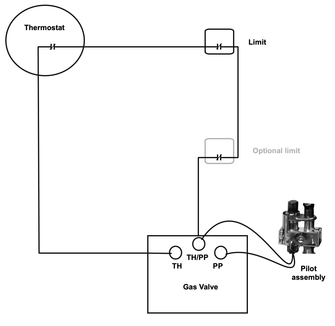

    I have not seen any photo if a 24V. transformer. if there is in fact a 24V. transformer and it was connected to the millivolt thermostat terminals, then that valve is toast. That little solenopid coil that works on millivolts got a real charge out of the redesign. If your electrician did you this favor, thene he owes you a new gas valve. You need a new valve.
    This is a chart of different Millivolt Pilot Generators that are available for that valve. Uni-Line Powerpile. The most common one is the two wire connection model but your valve may have needed the coaxial cable design.
    Now that you have destroyed the gas valve, you might as well put it back to a millivolt design so it will work during a power failure as it was originally designed.
    This is the gas valve you should purchase: Robertshaw 700-501 along with this Pilot Generator that matches the Robertshaw valve. During a power outage the burners will still operate but the fan at the top will not operate. That fan needs power top operate. The Gas valve has multi function acapability. it comes with 1/2" x 3/8" bushings and it can be used as a strait thru or an 90° orientation. Perfect for your application.
    Here is a simple wiring diagram to follow when connecting the wires from the thermostat to the gas valve.
    Just a side remark. There is another difference between a thermopile and a thermocouple, and it's not trivial. While both will produce an open circuit voltage which is, incidentally, proportional to the temperature, the POWER they can produce is radically different. A thermocouple will produce, at most a few milliamps — sufficient to operate certain sensitive relays, but that's it. A thermopile can produce several hundred milliamps or more, which is sufficient to operate a solenoid.
