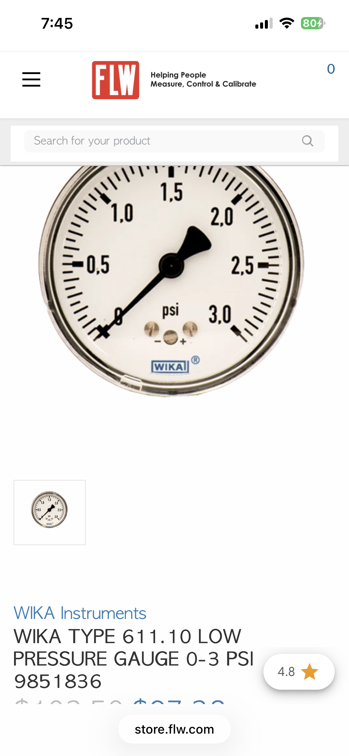

What the specifications for the correct gauge? I found a Sensor and Control (YE-6FDL04.0/3#) however in the specifications i says medium temp max is 140 degrees…and ambient temp from -4 to 140 degrees. I assume these specifications are not going to be sufficient.
Any suggestions a reliable mfg?

  • I am trying to get a 0-3psi gauge for my Peerless steam boiler.
    So far I have found 0-3psi with specification of 140 degree Fahrenheit max and a 0-3psi with specification to handle steam but it has a 2” stem.
    I am going to start with a 90 degree pig tail then a tee so I can have both the 0-3psi and the 0-30psi.

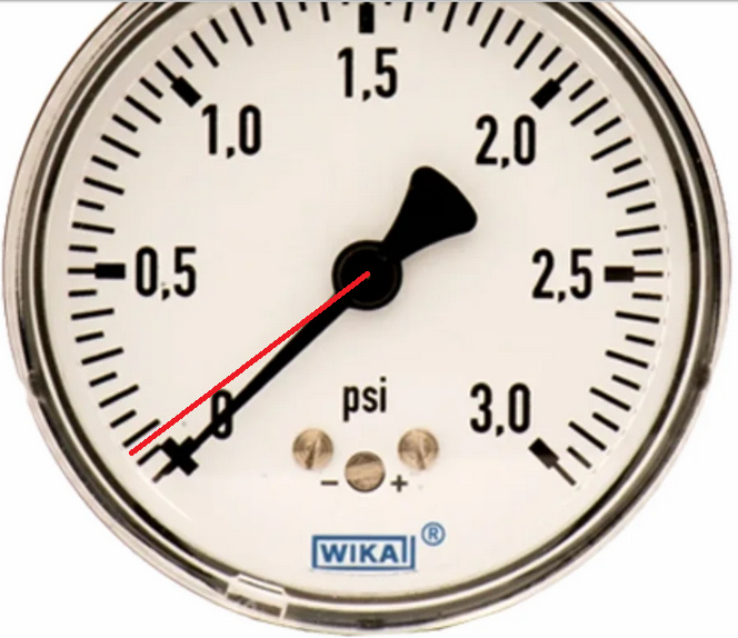

    Depending on what you want or expect to see with your low pressure gauge, you may want to know the actual boiler's / system's operating pressure. My system never goes over 2 Inches of water column so with a 0-3 PSI gauge it would never go past the red line I added to the gauge image.
