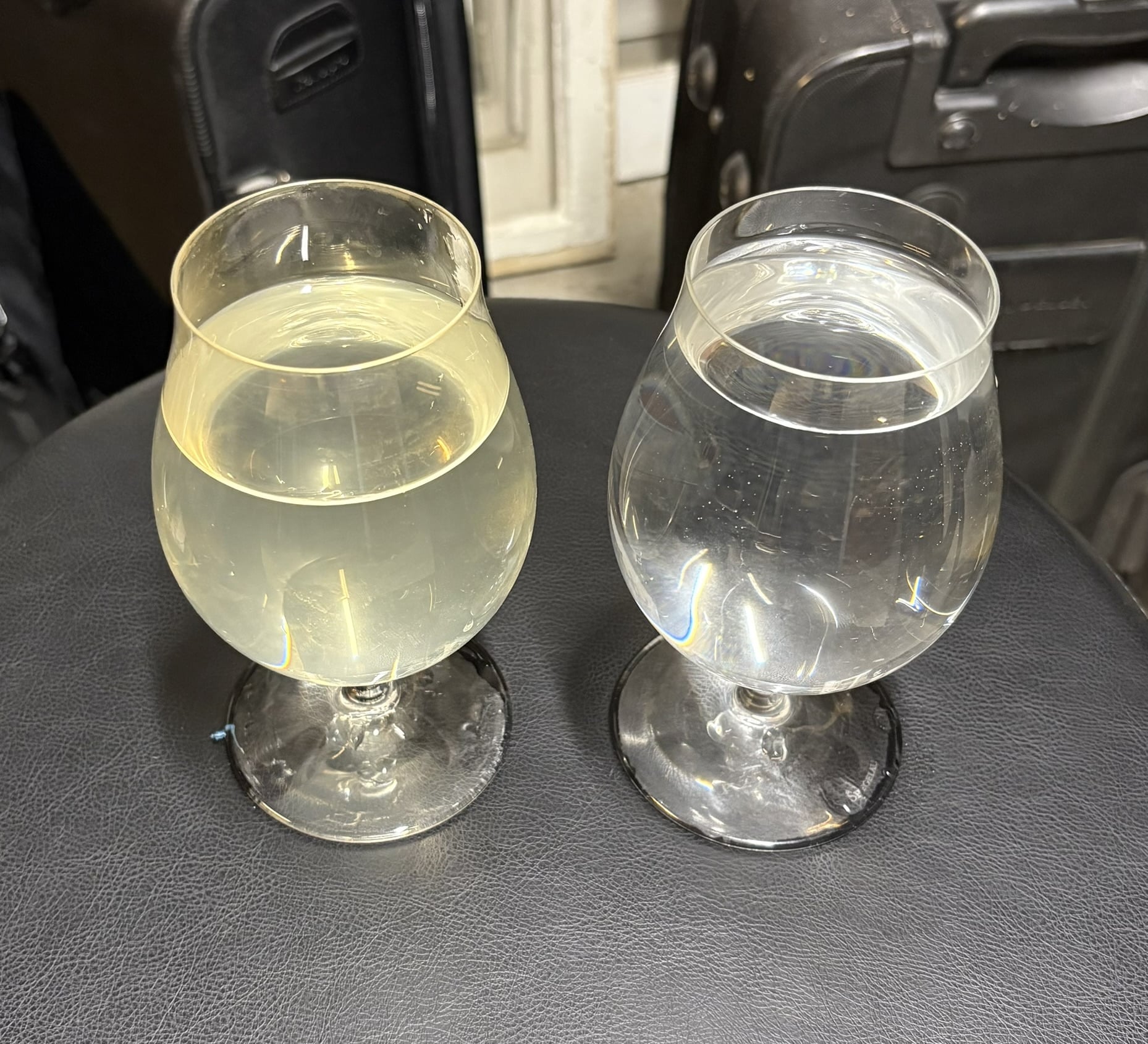

How many gallons of skimming
I have a Peerless 63-05-SPRK-SP for a two pipe system.
I skimmed some where between 25-30 gallons. At the end the water coming out was a shade of yellow. I filled two glasses, one with tap water the other with the water from the boiler. I am a first time skimmer. Would we call this sufficiently skimmed? See photo below.
Thank you.
    The question isn't the shade of the water — it's whether there is any trace of oil on the top. Hard to see in the photo…

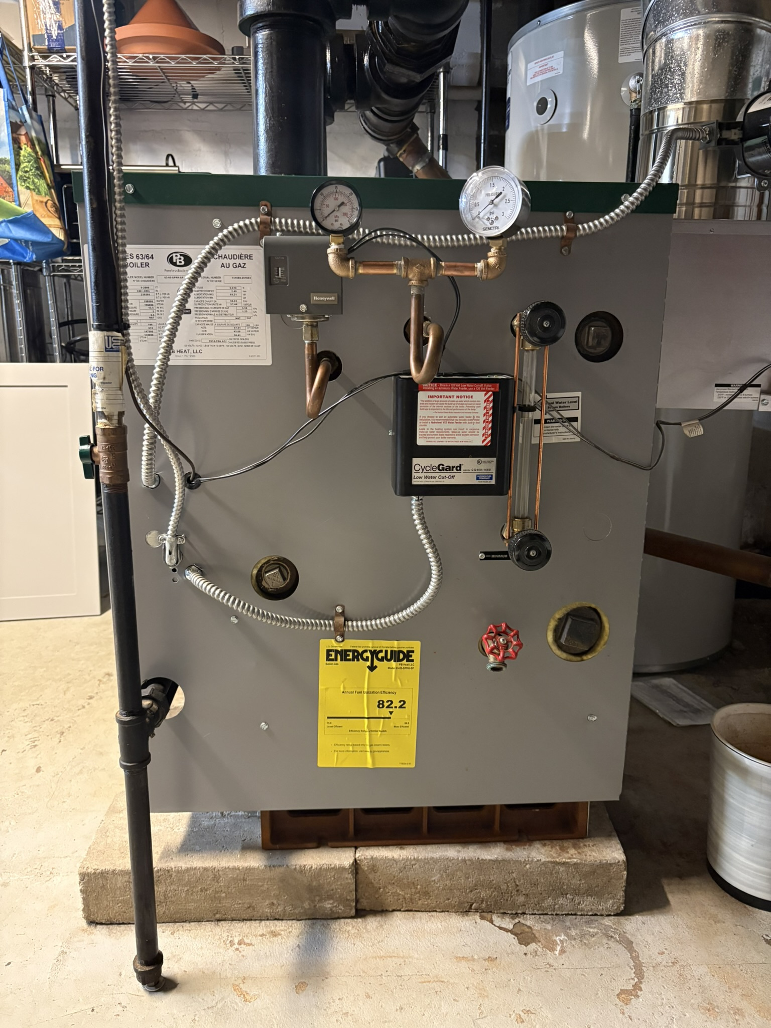

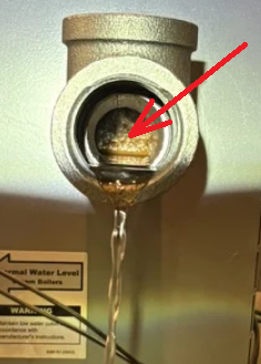

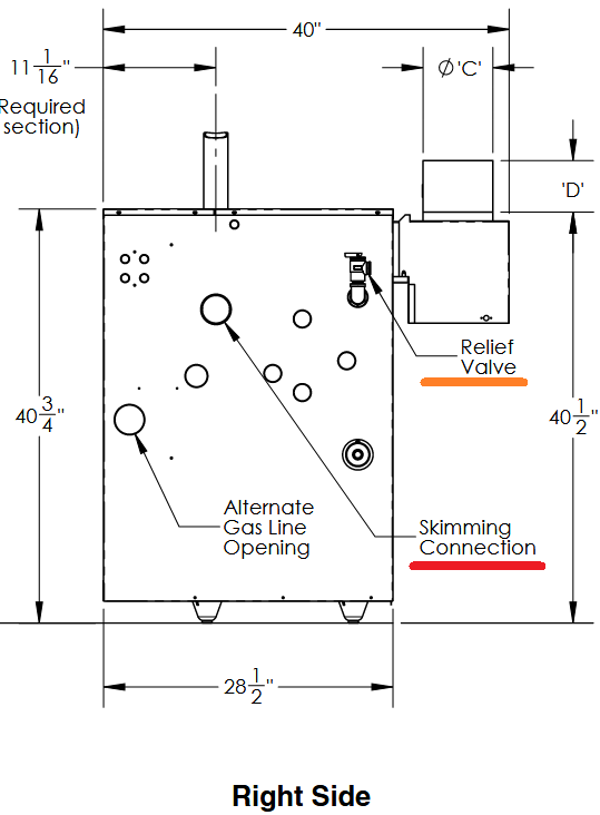

    Skimming is happening from here.

    looks like a nice skimmed water sample to me. How's the boiler running/ What does the sight glass look like?
  • neilc
    neilc Posts: 3,213
    what fitting are we looking into there? that's not a check in there, is it? it would be holding back the surface oil if is, what's in that port?

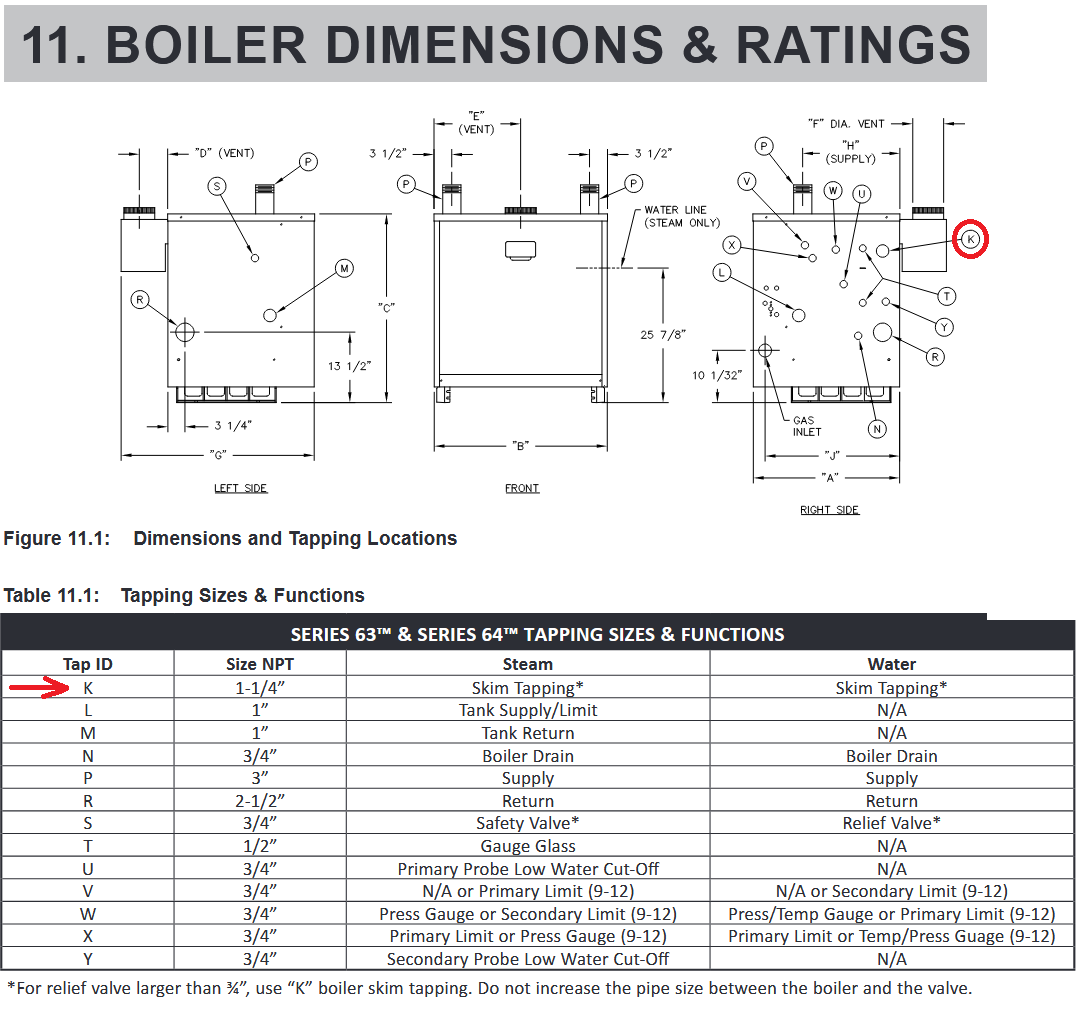

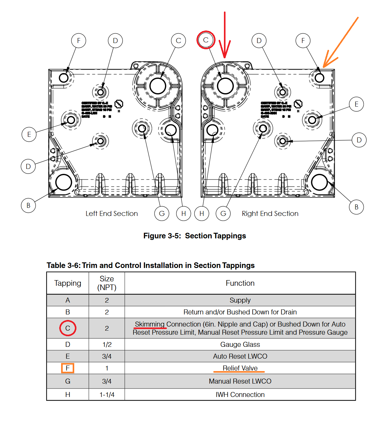

    Hey @neilc I think you are on to something. It looks like @simon_skove is skimming with the relief valve tapping. There may be an obstruction inside that tapping restricting the oil flow (from other parts of the boiler) to exit out that tapping.
    Maybe @ethicalpaul has an opinion, I believe his boiler is similar but smaller. I suspect @ethicalpaul's and @simon_skove's relief valve is on the Left side.

    109A_5 Posts: 4,759
    edited September 28
    Even the Series 63 manuals don't agree, nice.
    109A_5 Posts: 4,759
    Kind of makes me wonder if whatever the arrow is pointing to is blocking the exiting of the oil.
    ethicalpaul Posts: 9,075
    I don’t recognize the tap layout in the diagram you posted first. Mine matches the second diagram (and seemingly the OP’s photo) where the skim tapping is K (just to the right of the gauge glass). My relief valve is on the side without the controls on it.

  • dabrakeman
    dabrakeman Posts: 1,036
    Almost looks like a chunk of styrofoam lodged in there…

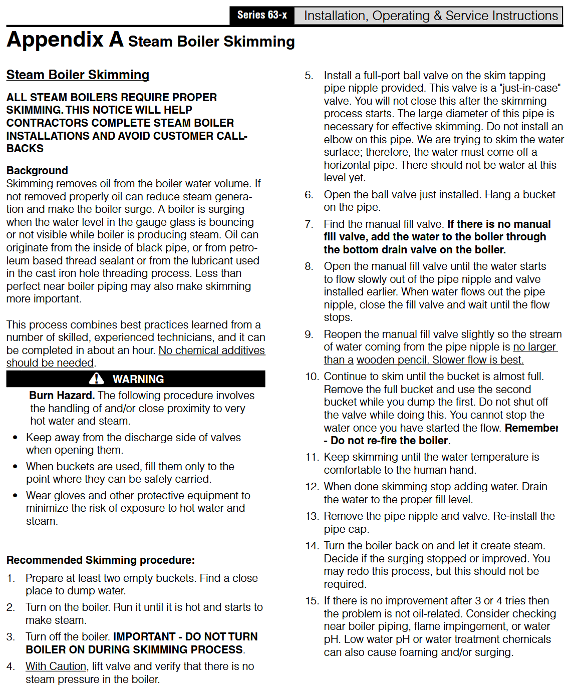

    Could someone explain to me why the directions state to fire the boiler to the point where it "start(s) making steam" which could be interpreted as "boiling" then shutoff and skim? When I skimmed mine I heated it short of making steam and then waited about 10 minutes or so before starting to skim and the water cleaned up with only a couple gallons of skimming. Never had to skim again. Intuitively the oil would want to rise to the top with time anyway. The less time immediately after a boil I would think the less of the oil has made it to the top. Just my opinion.
    I'm not sure what you're saying but I think they say that because when it starts to steam you know the water is as hot as it's going to get. Otherwise they have to try to guess how long to tell people to fire and they have to trust that people will know when the water is hot enough.
    Also a little boiling might serve to break up the oil a little bit so it's not all stuck together and stuck to the sides.

    I could agree with that, except that during skimming, after you do a small amount of boiling, you are going to be adding gallons of water and raising the water level several inches
    109A_5 Posts: 4,759
    Well maybe it is just me. But bringing the boiler to 211 degrees then adding a bunch of cold water, to raise the water level to the skim tapping, (may be the way the instructions state), but that seems counter productive also.
    I'd fill the boiler to the skim tapping then raise the water temperature to 211 degrees.

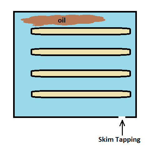

    the cold water comes into the bottom. The oil is on the top. The oil rises slowly and smoothly up to the skim tapping and is carried out. Skimming!
    Intplm.
    109A_5 Posts: 4,759
    To me the hotter the oil the better it will follow the water flow, diluting 211 degree water with cold water its not going to stay at 211 degrees very long.
    You could skim with a stone cold boiler but how well will it work?
    I said it before but you might have missed it. The cold water enters the boiler at the bottom and the hot water and hot oil remain at the top. It works.

    you can do it how you like but the way it’s described in the manuals works quite well. The TSP/washing powder helps a lot too as Ed said

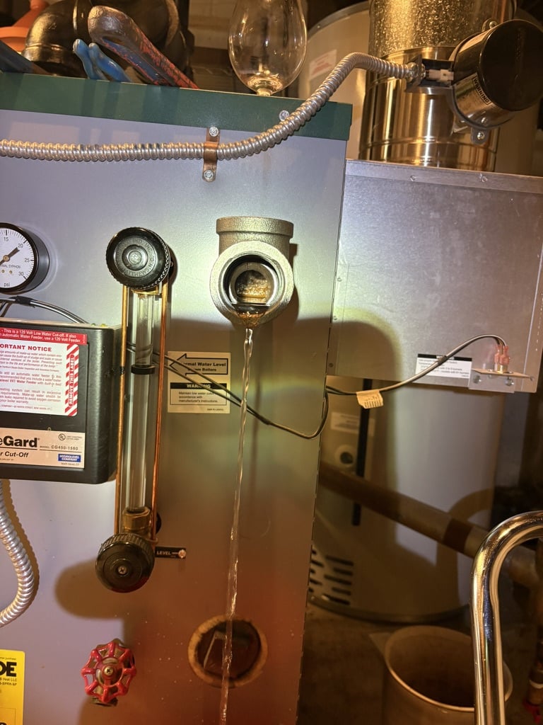

  • the skimming is happening at the skim port above the site glass on the same side of the boiler with the site glass. That you are seeing in the inside of the boiler.
    109A_5 Posts: 4,759
    @simon_skove " That you are seeing in the inside of the boiler. "
    Well, if it is the back side of that end section that may make the path more difficult for oil elsewhere in the boiler to get to the skim taping to exit.
    With some boilers when you look into the Skim tapping you can see all the way to the far side inner wall of the boiler, no inner obstructions. IMO this makes for more efficient path for the oil to exit.

  • neilc
    neilc Posts: 3,213
    post a picture of that whole side of the boiler, maybe we'll see something better,

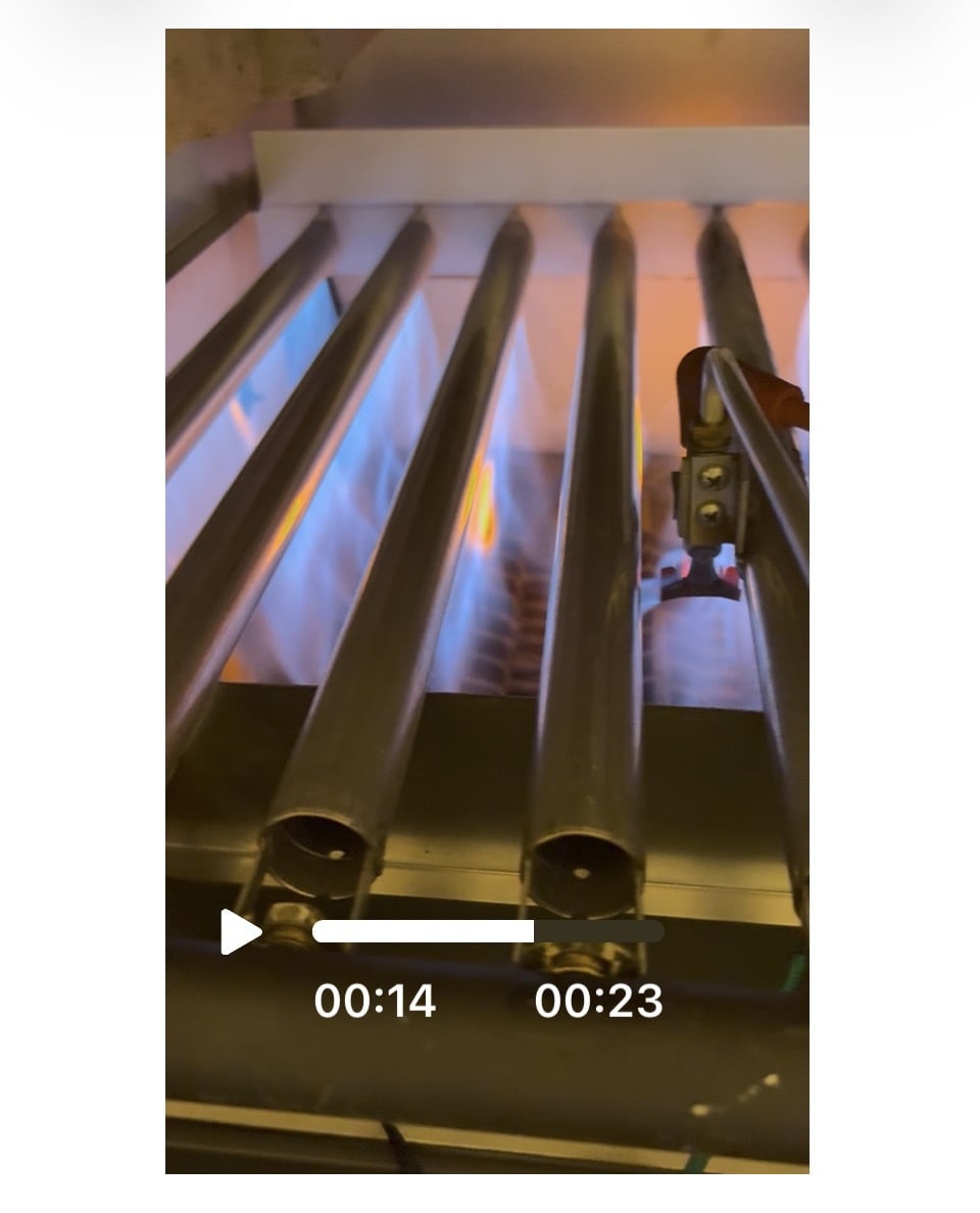

    The picture above shows the most of the burner tubes and the height of the flame and the occaisional red tips.
    The picture below shows the finish product. The skimming port, to the right of the sight glass is plugged back up.

  • neilc
    neilc Posts: 3,213
    it's like this boiler doesn't lend itself to being skimmed, easily, that seems to be the called for port, yet only opens to only the first water jacket, there's no spot there for a domestic coil(?) which would extend thru all jackets, and , , , IDK, what are we missing?

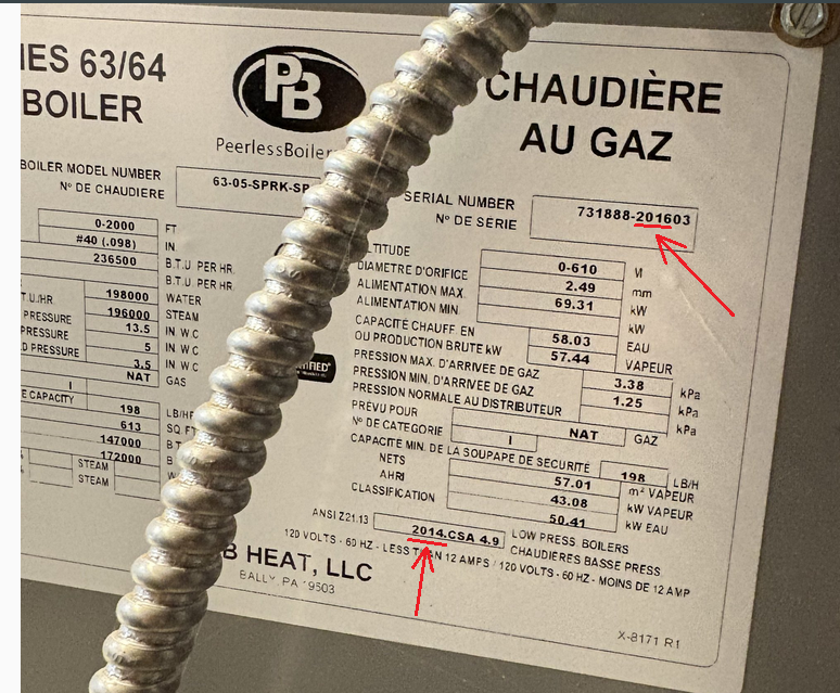

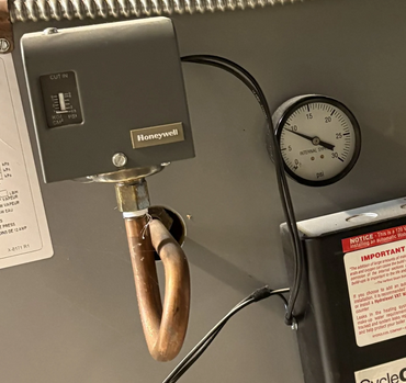

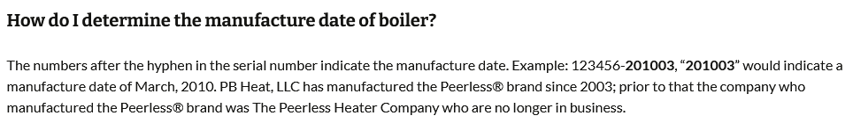

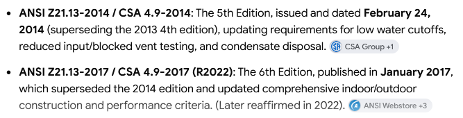

    Here is why I am curious about its age. @simon_skove stated the excessive pressure issue (almost a year ago) was a plugged pressuretrol pigtail, it looks brass to me, even if the original was black pipe, how fast should a pigtail plug up on a new boiler ?
    November 2025 " Given that everything looks pretty shiny new, I'm going to guess a new boiler? "
    Then looking at what looks like date information on the rating plate. I'm thinking the boiler is over 10 years old, maybe it sat in a warehouse until November 2025, and the pigtail plugged up in a day.
    So I am wondering if it was ever properly skimmed after the install, whenever that was.
    That's good detective work on the serial number, but it just looks too new to have been in a basement too long I think.
    I will say that if it wasn't skimmed on install, then even a brass pigtail will get gunked up very fast
  • The boiler is a 02/2017 install.
    Apparently never skimmed. Then 8 or 9 radiators disconnected and reconnected for finished floor replacement….one radiator move in the kitchen with new piping that was cut and treaded….so until 2025 AFTER all that….there was never any skimming. But at of summer 2026, throughly skimmed…very throughly.
    109A_5 Posts: 4,759
    Well it may not have been originally skimmed or was inadequacy skimmed at that time. The renovation with new piping may have added additional oil to the system.
    You have skimmed it recently, I'd see how it performs, you may be done, it may need more skimming, all depends on how it preforms.
