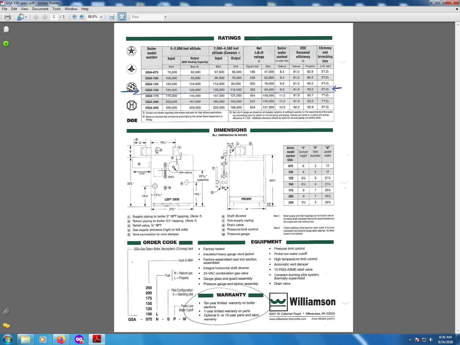

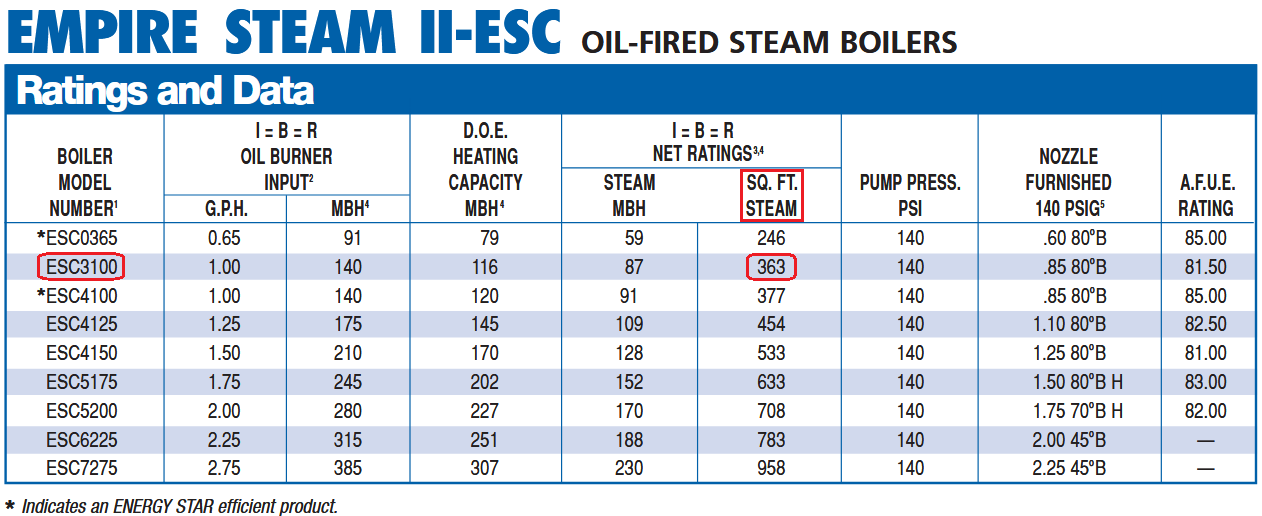

The contractor is replacing my oil fired Dunkirk ESC3100 steam boiler with a natural gas fired Williamson/Weil McClain steam boiler. The Dunkirk has an output of 116,000 BTU/HR, the Williamson/Weil McClain has an output of 125,000 BTU/HR. From the Replacement Boiler Sizing Chart calculation, the total square feet of radiation is calculated at 208.3 with 7 radiators. The total BTU/HR load is 49,992 Is the Williamson/Weil McClain adequate? The house is 1,240 square feet of living space.
The Williamson/Weil McClain manual shows 1 supply riser at 2 1/2 inch to a 2 1/2 inch header. The Dunkirk has 2 supply risers at 2 1/2 inch to a 2 1/2 inch header. I also want to go with a 3 inch drop header, now. Would this be better than the standard 2 1/2 inch header?

    what is the edr of the boiler? sounds like the boiler is oversized by like 150% if your edr to btu/hr conversion is correct.
    mattmia2 Posts: 18,188
    the boiler should be about 55,000 btu/hr output or the closest next size up. the output of the boiler matching the amount of steam the system can consume is as important as the near boiler piping. as long as the piping meets the minimum specs in the manual it shouldn't be a problem in a boiler that small.

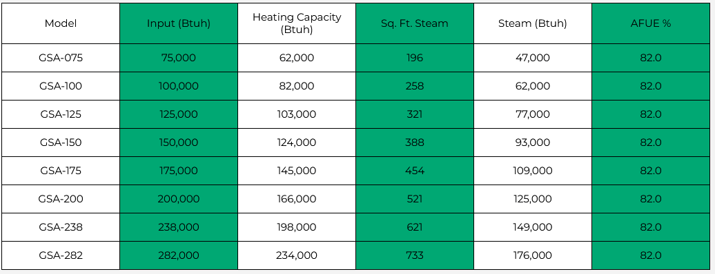

    The GSA-150 is much larger than you need. Assuming that your radiator calculations are correct. Get the 75 if possible. Lots of places don't carry the 75. You can also get the 100 and you'll be fine. Pure waste to get the 150.
    ethicalpaulmattmia2
    EBEBRATT-Ed Posts: 21,120
    I would use the GSA-100. Your radiation is 208 square feet. The gsa 100 is rated for 258 square feet. Forget about BTUs etc. The only number you have to look at is the square foot or EDR rating which is the same thing. Your contractor is way off base. The smaller boiler will cost less $$$ and require less piping.
    Forget the drop header with such a small boiler it is a big waste of $$$. Insist he follows the MFG instructions in the manual for the piping and pipe sizing and skimming. That's what matters. With a contractor so far off on the sizing I would look for someone else if he doesn't cooperate.

    The Dunkirk steam supply is probably horizontal the Williamson is probably vertical. With the horizontal supply type the extra pipe capacity helps. You probably don't need the drop header unless the distance between the boiler and the main pipe is limited. The drop header may provide better steam and water droplets separation but it may be overkill. If you just want it, it probably won't hurt anything except your wallet.

    Either boiler you mention is wildly oversized for your application, assuming your EDR figure for the radiators is anything like right. I'd go with the Williamson or WM. I'd agree with @109A_5 — the GSA-075 is the correct size, though the GSA-100 will work OK.
    ethicalpaul Posts: 9,021
    edited September 24
    Very respectfully to my good friend @EBEBRATT-Ed why would the recommended boiler be 25% larger than the radiation EDR when we know that boiler's rating already includes a 33% extra factor in it?
    Myself, I wouldn't allow anything other than the 75
    In fact, my EDR is almost identical to yours. I chose Peerless and their smallest one is slightly oversized for me, but it's fine. You will never be chilly with a 75 unless you choose to be, it will make plenty of steam for your system.

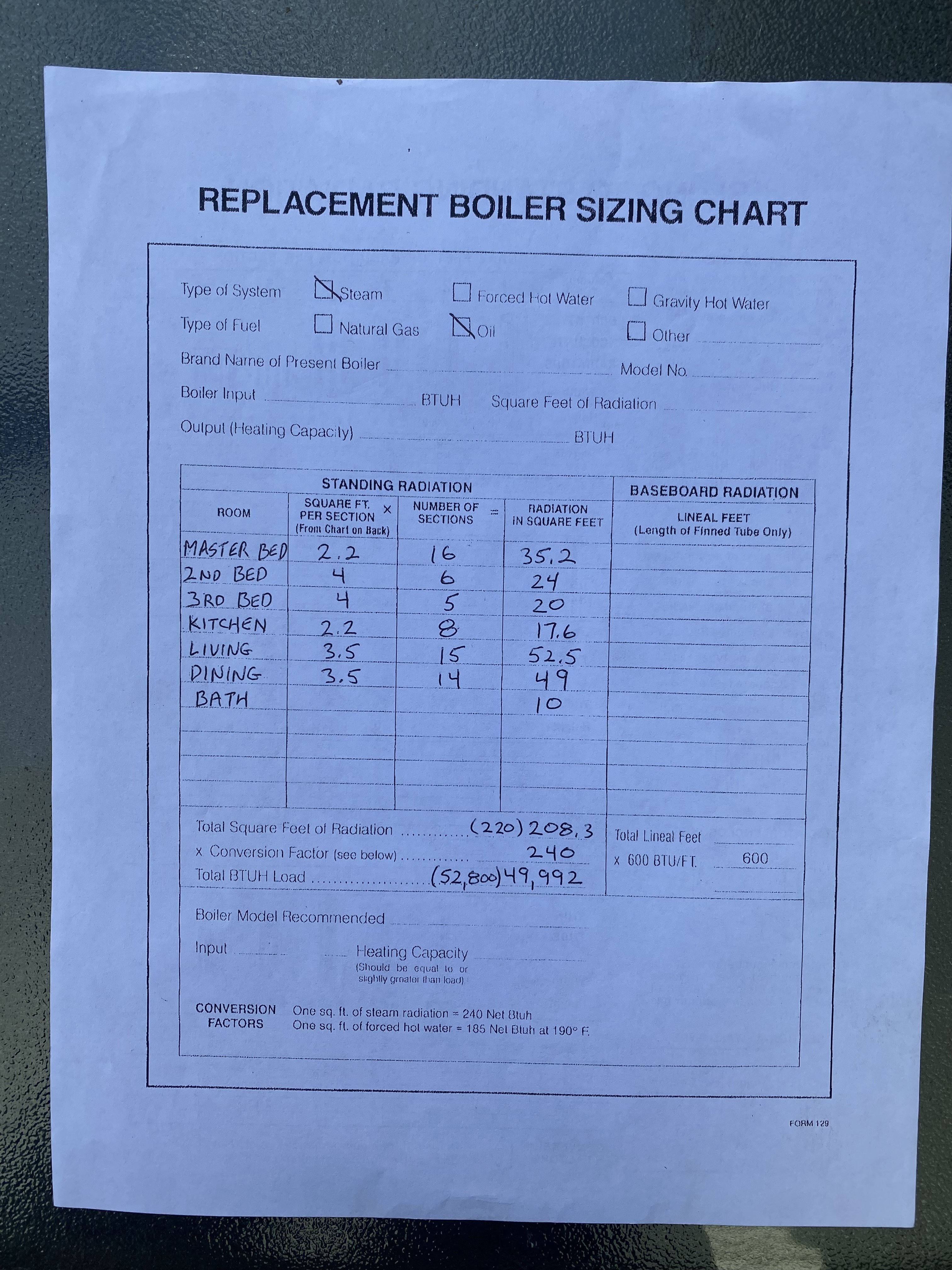

  • The contractor swapped out the boilers this morning. The replacement is the GSA-100.
    That's weird, they give a "steam btu" that has 30% subtracted from it for a pickup factor. the actual pickup in a small residential system is more like 10%.
  • The Replacement Boiler Sizing Chart was done when the original boiler, a refrigerator-size boiler converted from coal to oil, was replaced with the Dunkirk ESC3100 16 years ago.
  • The contractor swapped out the boilers this morning. The replacement is the GSA-100. The Replacement Boiler Sizing Chart was done when the original boiler, a refrigerator-size boiler converted from coal to oil, was replaced with the Dunkirk ESC3100 16 years ago.
  • The contractor swapped out the boilers this morning. The replacement is the GSA-100. The Dunkirk ESC3100 performed fine for me (even though now I see it was oversized) for 16 years until it blew a hole at the top of the rear section. So, for the replacement, I reluctantly went with natural gas. I prefer oil, but with the per gallon price approaching $6, $6,000 to fill my 1,000 gallon tank is too much. I don't think we'll be seeing oil less than $2.80 per gallon anymore.
  • The contractor swapped out the boilers this morning. The replacement is the GSA-100. The Replacement Boiler Sizing Chart was filled out 16 years ago when the original boiler, a refrigerator-size boiler converted from coal to oil, was replaced with the Dunkirk ESC3100

  • Well, the Replacement Boiler Sizing Chart would be the same. The radiators, their number, dimensions and locations, remain the same. I just presented him with the calculations I had on file. Nothing changed. It's like, 'Do you have to survey a property every time it's sold?

  • Based on the formulas in the chart and following the directions, the EDR of 208.3 was the calculated result. The result would be the same as nothing has changed since the first time.
  • Around here, they do too. I never understood why a property has to be surveyed every time it's sold if the dimensions don't change. I can understand if it was added to with a neighboring property or a part of it was sold off.
    The Replacement Boiler Sizing Chart calculations are correct based on the data input. I had the Dunkirk installed before I found out about this site, I didn't know it was oversized. It performed as intended up until it needed to be replaced.
