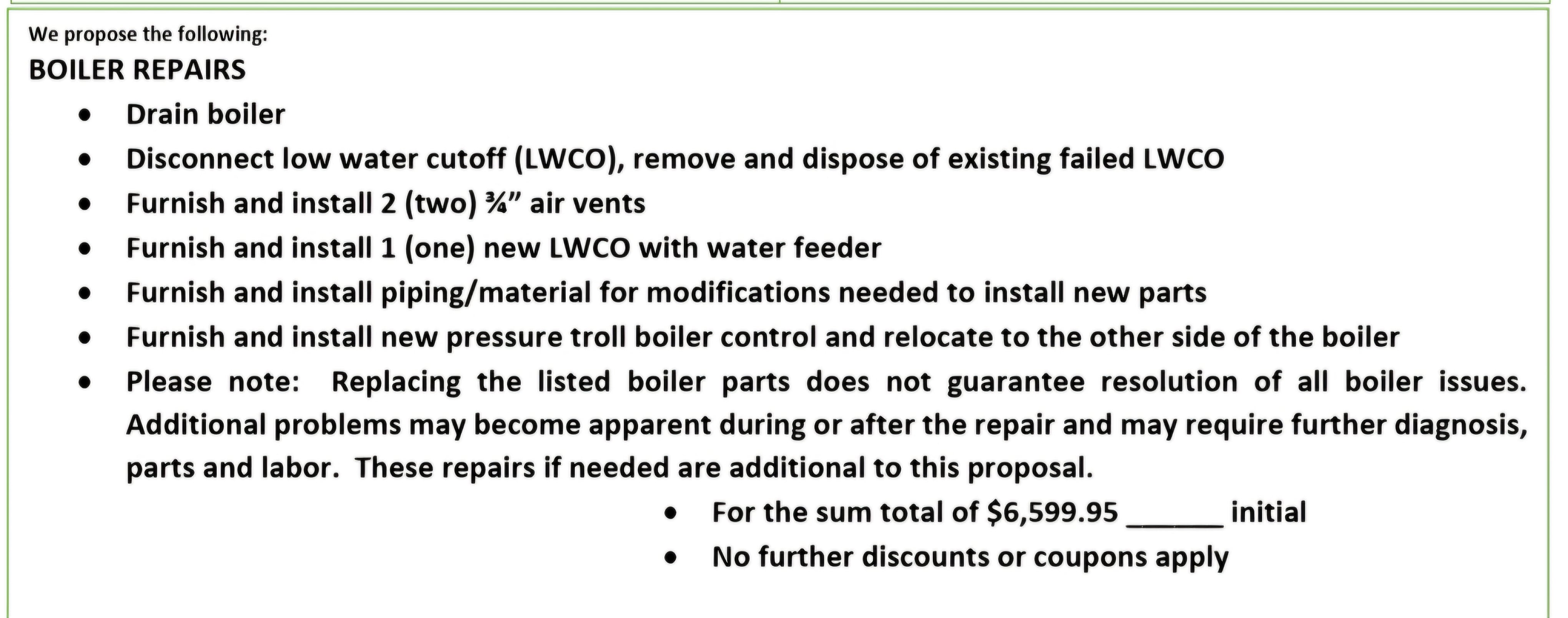

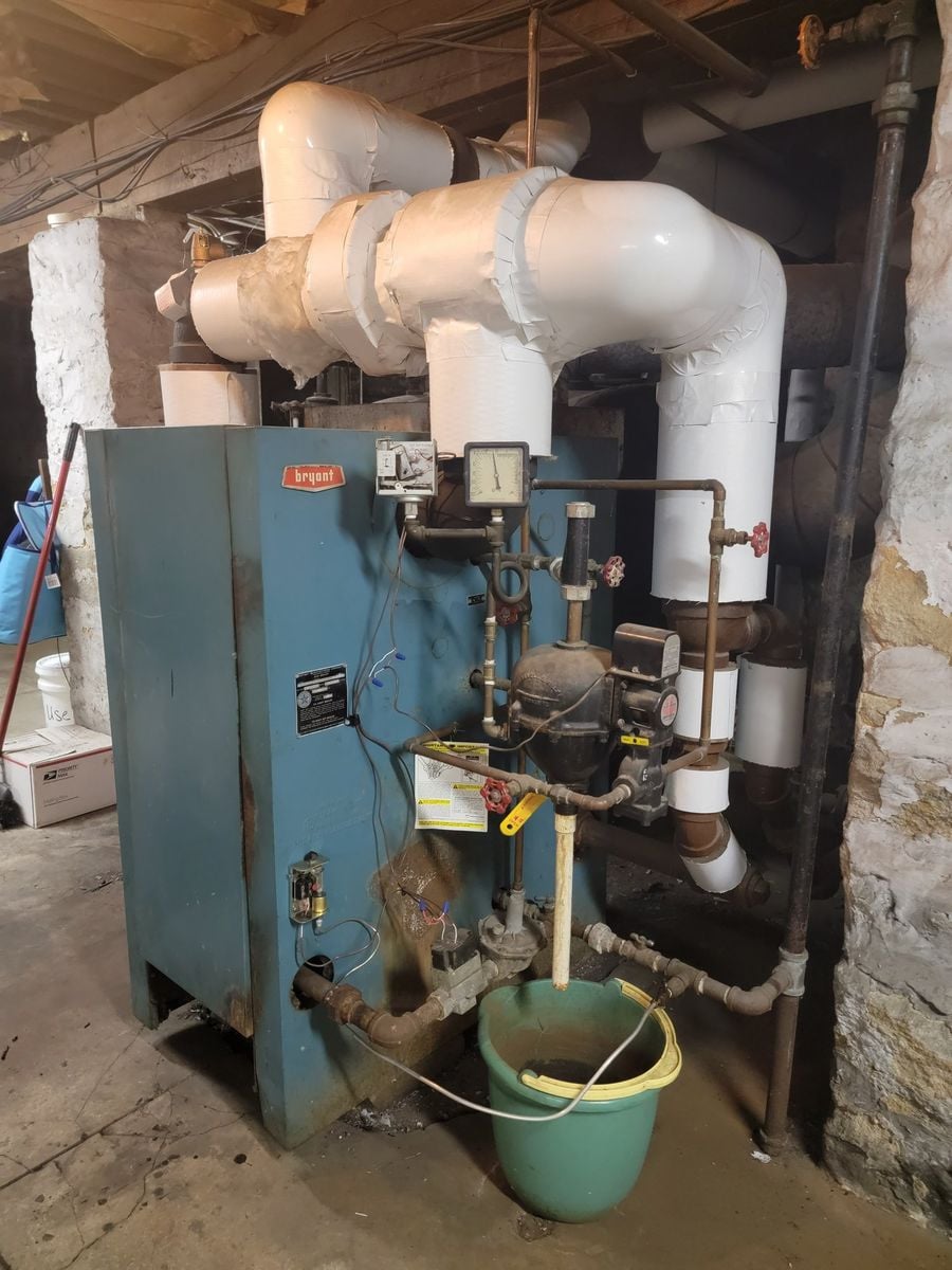

Hello, I'm in need of some expertise. We have an old steam boiler, probably 1950/1960's and our LWCO has been failing, with it flooding twice last winter. Ive had a difficult time finding anyone even willing to work on it and was finally able to have a company from about 90 miles away give us an estimate. Does this sound reasonable or totally off base? Two of the main vents are leaking as well. Also attached is a pic of our boiler. What is the reason to want to relocate the presuretrol? I will obviously ask them too but wanted another take on it. Thanks so much!!!

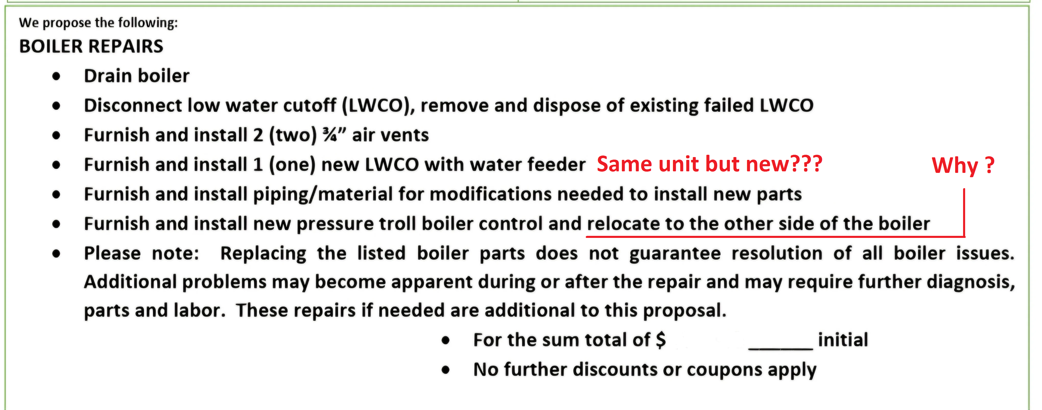

    For that money I'd learn to do the work myself. How many days do they anticipate it will take ? I'd probably get other bids.
    One option is to change to a more modern electronic probe type LWCO and water feeder, way less expensive for the parts. The Cast Iron stuff is expensive.
    Whats wrong with the Pressuretrol location, is the Pressuretrol defective also ? If it is not defective and the cover is just missing I'd buy a cheap used one just for the cover. Touching other stuff on the other side of the boiler may just open up a can of worms, I'd avoid that.

    if the problem is that the lwco is sticking it can be rebuilt. it should be disassembled and cleaned every year or 2.
    what type of vents should be called out. those will have to be dealt with regardless of of the boiler is replaced.
    is the boiler being over fed because of issues with the lwco or because the water is leaving the boiler because of system issues.
    i wouldn't expect them to assume all liability for the system if they touch it but i would expect them to troubleshoot to determine if the issue is the lwco or an issue causing the water to exit the boiler during a heating cycle.
    if you're going to replace the pressuretrol you should replace it with a vaporstat.

    I'd get a Hydrolevel 711C manifold with quick-hookup fittings and put a Safguard 400 in it, and mount a VXT-24 nearby:
    https://hydrolevel.com/manifold-fittings/
    This would eliminate a lot of moving parts.

    Basically, it's a way to switch from a float-type mechanical unit (McDonnell & Miller #47-2) to an electronic probe-type (Hydrolevel Safguard 400) which is more reliable. The manifold attaches to the sight glass the same as the 47-2, and the probe control mounts on the manifold.
    The VXT is a water feeder, which gets its signal from the 400.
    You do need to blow down the manifold, but the lack of moving parts is a big advantage.
