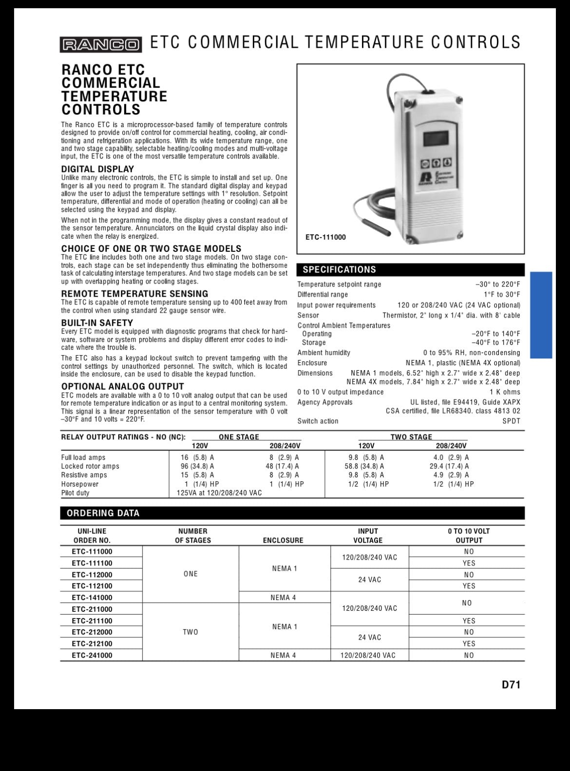

    Sadly the Ranco unit above does not specify the electrical characteristics of the sensor it uses.
    " accepts a 10 k sensor (supply air) " Using an existing sensor may have unexpected results.

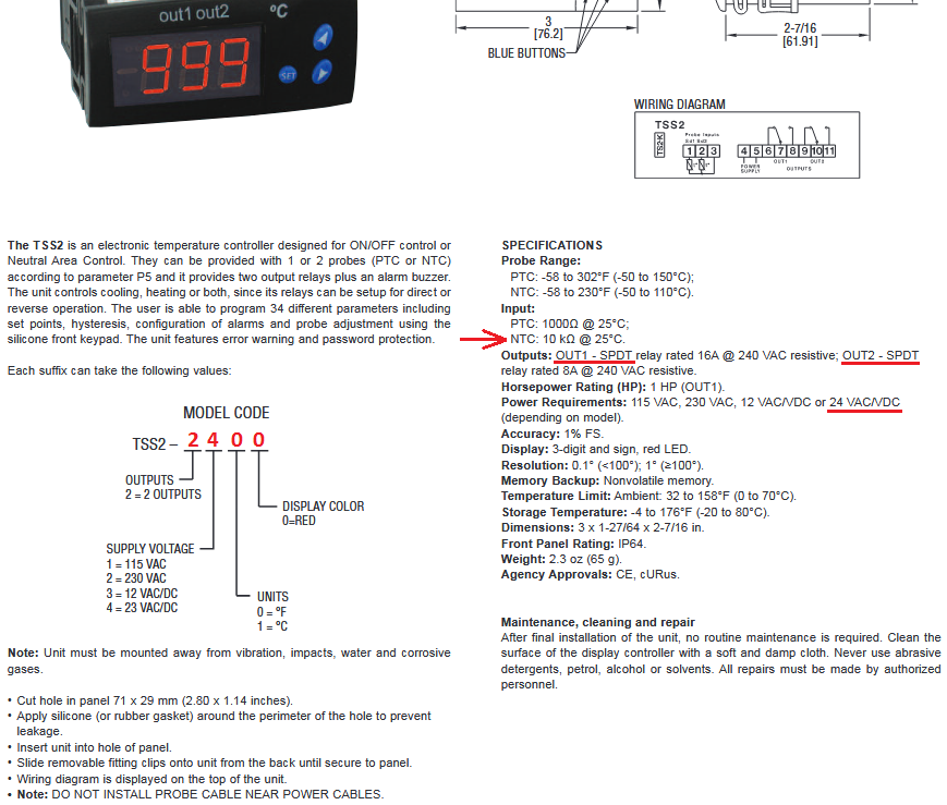

    I think the TSS2-2400 checks all your boxes, you will have to program it .
    TSS2-2400
    Dual stage temperature switch, °F, 24 VAC/DC.
    Dwyer-Omega
    LOVE CONTROLS DIVISION
    www.love-controls.com
    DWYER INSTRUMENTS INC.
    https://assets.dwyeromega.com/manuals-do/TSS2_Instruction_Manual.pdf

    I've used the ETC/Ranco models in the past, simple and reliable. The sensor can be extended if necessary, just place it somewhere in the discharge air stream. If the two sensors are both 10K, even if they're different types you should be able to adjust the setpoint to account for it, They diverge pretty quickly temperature descending, but not temperature ascending:
