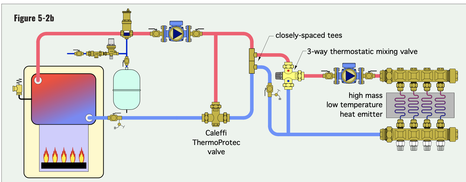

It depends on where isolation valves are located. A valve at each side of a circulator may not isolate the boiler for draining or replacement.
I like a full port Webstone purge ball valve at the boiler return. Then with pump isolation on the boiler supply side you have isolation.
Here is a nice purge detail both boiler side and distribution side. As well as pump isolation
