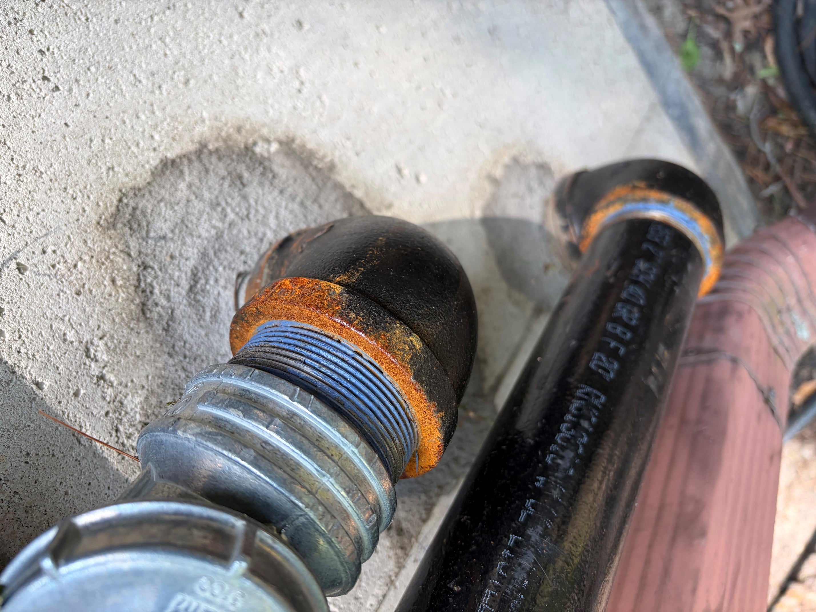

Hi all, the attached image shows some rust on the piping to my recently-installed oil tank.
Assuming that the rust won't limit itself to being only a thin coating on the surface and needs to be addressed, what should I have the installer do?
Would a light sanding followed by silicone or paint take care of it?
Thanks for your help
    Jamie Hall Member Posts: 27,799
    That rust is surface. After a few decades it might eat a little into the fittings… after a century or so they might leak.
    If you object to the look of it, get a small wire brush and brush it. Then spray on a coat of Rust-O-leum rusty metal primer, then a coat of whatever colour you fancy.

    pecmsg Member Posts: 7,537
    that’s steel. It rusts! Sand it, paint it black and no more rest
    You could ask the installers for Stainless Steel fittings and pipe.

    Robert O'Brien Member Posts: 3,608
    Are those cast fittings?
    Steamhead Member Posts: 18,879
    Look like malleable to me…………….

    No one is piping oil tanks in stainless steel that I ever seen.
