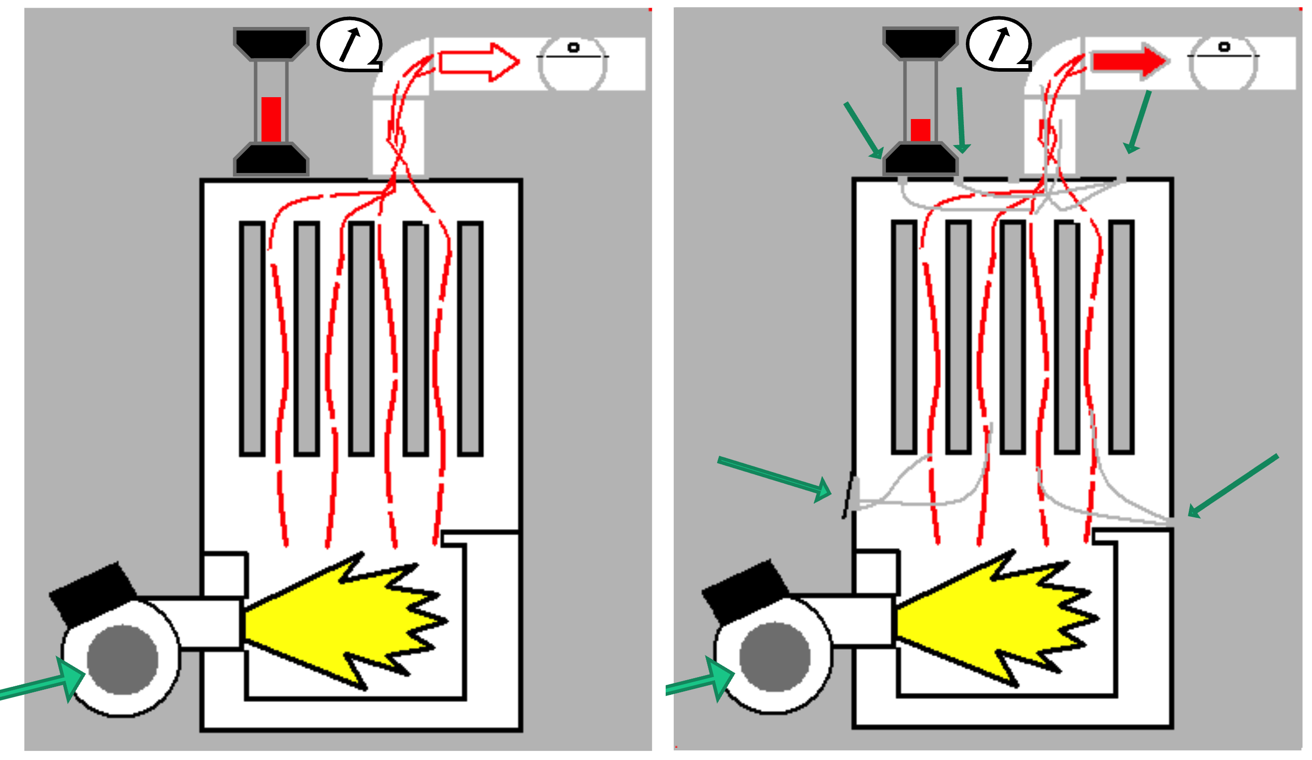

    When I worked for the family business in the 1980s, we were replacing ten or more oil burners each week. The federal government subsidized many of these jobs for low-income homeowners.
    We often retrofitted old “snowman” boilers, Arcoliner boilers, Holland furnaces, and even boilers originally designed for coal that had been sold as oil-fired units in the 1940s and 50s. Some were equipped with Arcoflame burners using the old piggyback-style burner motor and fuel pump.
    Many of these boilers had air leaks between the sections. To receive payment under the government program, we had to achieve at least 80% combustion efficiency using a Bacharach wet-kit combustion kit. We developed a procedure that helped us obtain an accurate measurement.
    First, we would:
    1. Thoroughly clean the heat exchanger and remove as much soot as possible.
    2. Install a new combustion chamber.
    3. Remove the boiler jacket and seal the seams between the sections with furnace cement.
    4. Install new insulation and replace the jacket.
    5. Seal the boiler doors to eliminate air leakage. We would place a 1/4- to 3/8-inch bead of furnace cement around each door and carefully close it, allowing the cement to form a gasket-like seal.
    6. Install a new vent connector and barometric draft regulator.
    Even after completing all this careful sealing, some air leakage could still remain. A combustion-efficiency calculation assumes that all combustion air enters through the burner and that only this air is included in the flue-gas sample taken at the vent connector as shown on the left. If we had too many leaks as shown on the right the flue gas measurement was incorrect and much lower carbon-dioxide percentage.
    Because that was not always possible to get an air-leak free boiler, we used a temporary testing method to determine the actual flame efficiency without dilution air from the remaining section leaks. For the test only, we operated the burner with slight positive pressure in the combustion chamber. If the boiler still had leaks, the airflow would then move outward through them instead of being drawn inward and diluting the flue-gas sample.
    We accomplished this by temporarily removing the barometric draft regulator or propping it open and/or partially restricting the chimney connector. Once we obtained approximately +0.01 inches water column over-fire pressure, we performed the combustion test and recorded the actual carbon dioxide or oxygen reading and the stack temperature.
    Immediately after completing the test, we restored the vent connector to its normal, unrestricted operating condition and returned the barometric draft regulator to proper operation. The final operating draft would normally be approximately –0.01 to –0.02 inches water column over the fire.
    This procedure gave us a more accurate measurement of the burner’s actual flame combustion efficiency. Any air entering through small remaining leaks during normal negative-draft operation would lower the measured combustion-efficiency result, but it would not significantly change the flame inside the combustion chamber. The heat produced by that flame would still be absorbed by the boiler, with only a relatively small efficiency loss resulting from the remaining air leakage.
    Government inspectors simply needed to witness an actual combustion test showing an efficiency reading of 80% or higher on the instruments and calculator before signing off on the job. Once the test was completed and the system was restored to its normal operating condition, we made sure the equipment would operate safely. Our own service technician would then sign off on the job. With both signatures in place, the U.S. Treasury checks would start rolling in.
    The bottom line was that we took a system operating at 60% combustion efficiency or less, equipped with an old, wasteful burner, and made it burn less fuel while still providing all the comfort the homeowner needed. The work cost less than half as much as installing a new gas boiler and often produced similar fuel savings. At the same time, we were able to keep a fuel-oil customer from converting to gas heat.
    I hope this information helps you in determining the result of your work. Your combustion numbers don't need to be as high as you think to get the lowest fuel usage
