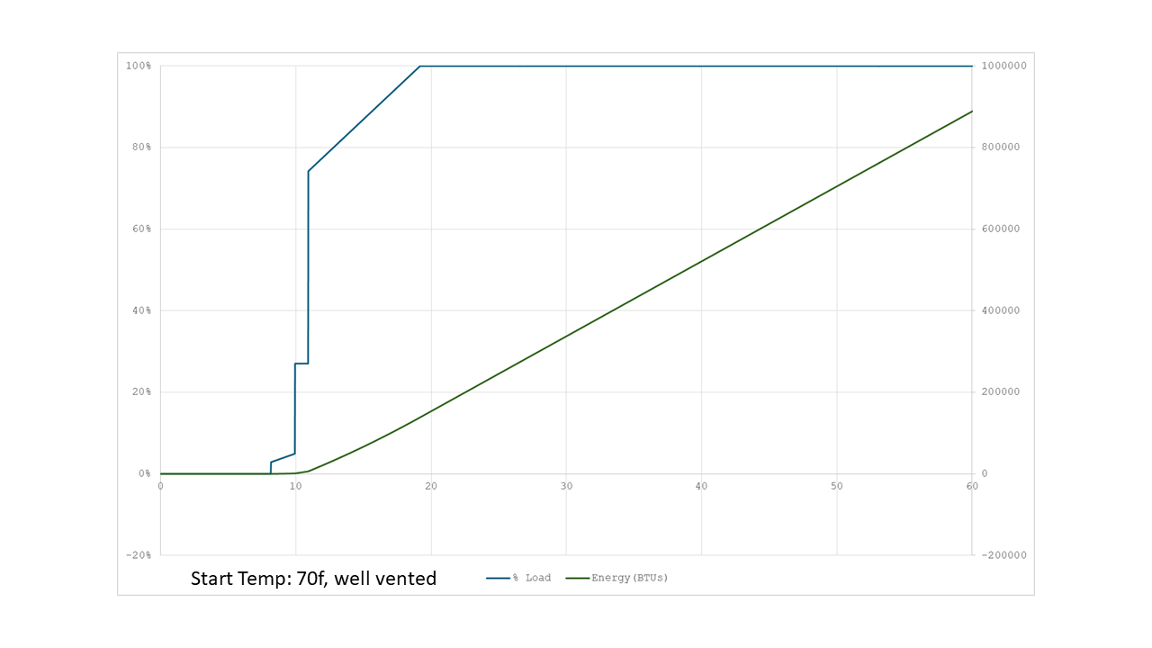

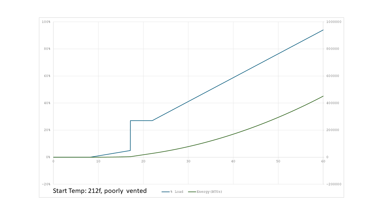

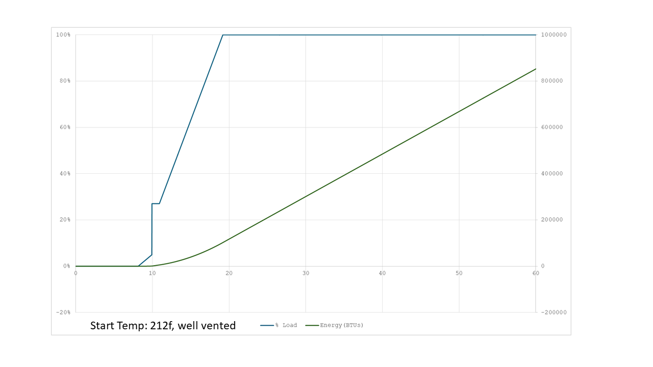

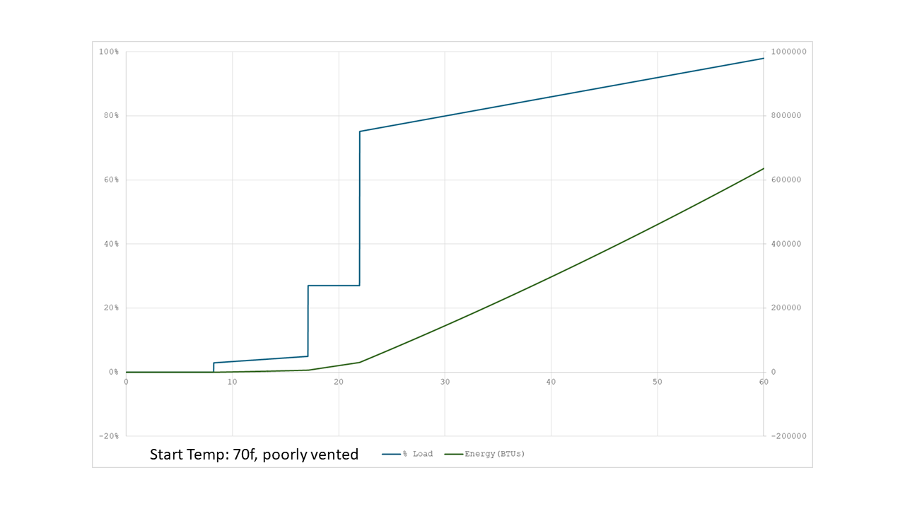

    Been doing more work. The system I'm modeling is a 4 floor building built in the early 1900s which has the original Kewanee, but currently runs on an LGB-12. It currently has a single Gorton 2 main vent. The return has a 1 inch nipple for venting. Based on the vent tables 5 Gorton 2's max out a 1inch vent capacity. This simple analysis looks at 2 variables: venting - using 1 vent(current setup) vs 5 vents; and startup temperature - one at 70F, one at 212F.
    In this analysis the boiler is running the entire time simulated(60 minutes). The %load(% radiation the system is absorbing and radiating based on its total EDR) and the total summed Btu(the radiated heat that is being output to the building and the heat required to warm the cast iron and steel). So the higher the BTU ratings during this hour analysis is generally better, as more heat is being transferred, minus the warming heat.
    Now, I always new that venting helps with heating, but I didn't realize how much. There is a near 50% decrease in first-hour radiation output if the system is poorly vented. Although this exact analysis is limited to this particular system.
    Edit: I found an error with the supply line radiation plot, but it doesn't affect the findings. The step is smoothed to slopes though.

    mattmia2 Posts: 18,254
    are you accounting for the mass and specific heat of the piping?

    Great analysis. I have always found this to be true as well. It is best practice to just get out of The Steam's Way! Mad Dog

    @mattmia2 yep, you can see the beginning of each graph is flat and that is the time it takes the boiler to heat up the water and the cast iron which is specific to each different boiler model. And then it takes into account the steel for all of the piping and then the cast iron for the radiators.
