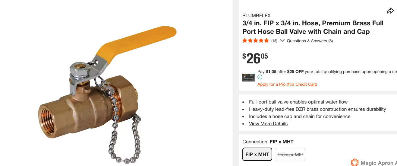

    hot_rod Posts: 28,699
    Here is an option. It's nice to have the cap. A 3" brass nipple also.

    @jgg765
    ^^^^^^^^^^^^^^^^^^^^^^^^^^^^^^^^^^^^^ THIS ^^^^^^^^^^^^^^^^^^^^^^^^^^^^^^^^^
    And you will still need a brass nipple.

    I know it is a little more work but if you buy the ball valve, nipple, hose adapter and a hose cap its a lot cheaper than buying a hose end ball valve
    Intplm.
    and that was all that was available locally, but i really do like the apollo ones with the hose thread and cap all in one assembly. I even used one for a washer hose the last time I had to rework one of those.

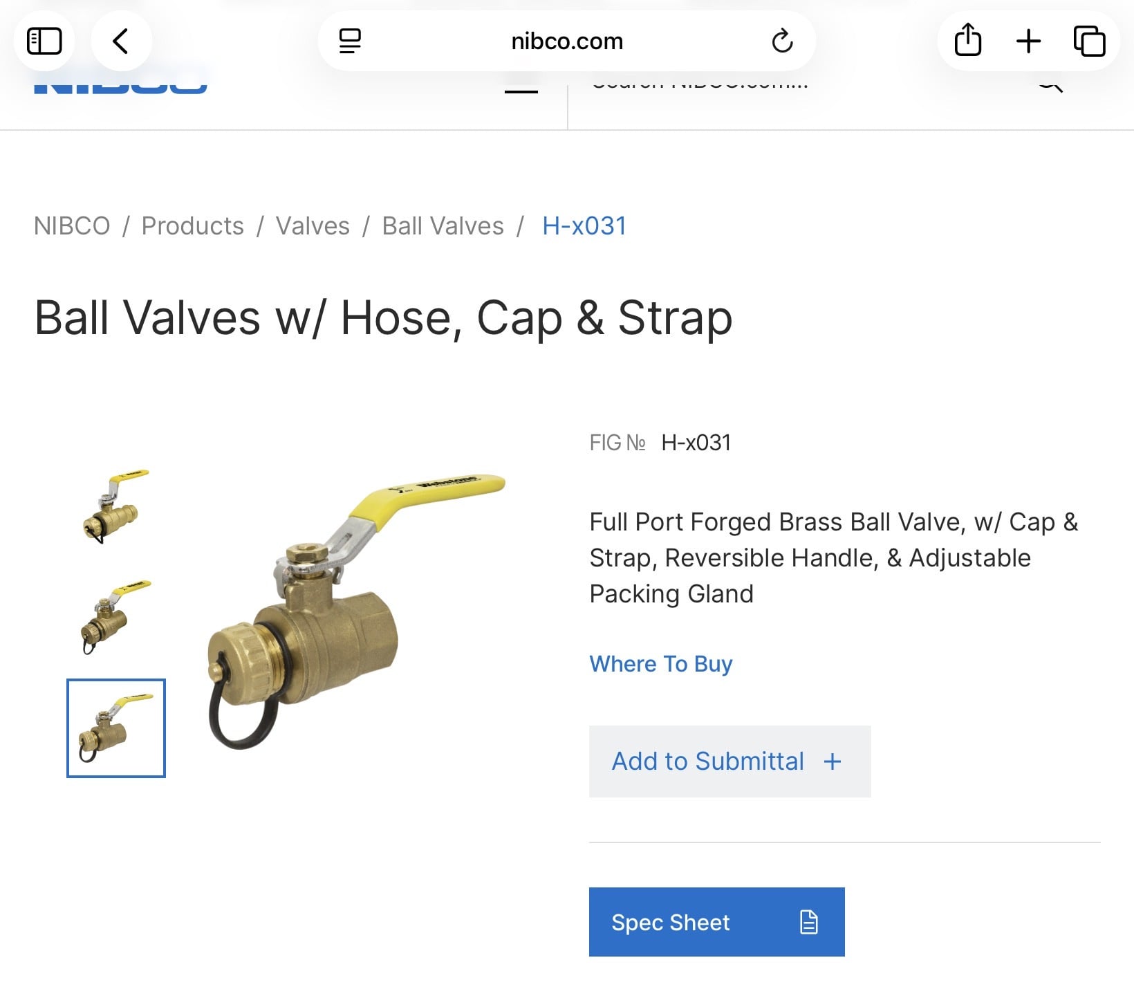

    since you are going to the trouble to add a user friendly valve, I would not buy an economy valve
    A brand name full port with stem packing is what you want
    But regardless of the valve , it needs to be used a few times a year at least to prevent sticking.

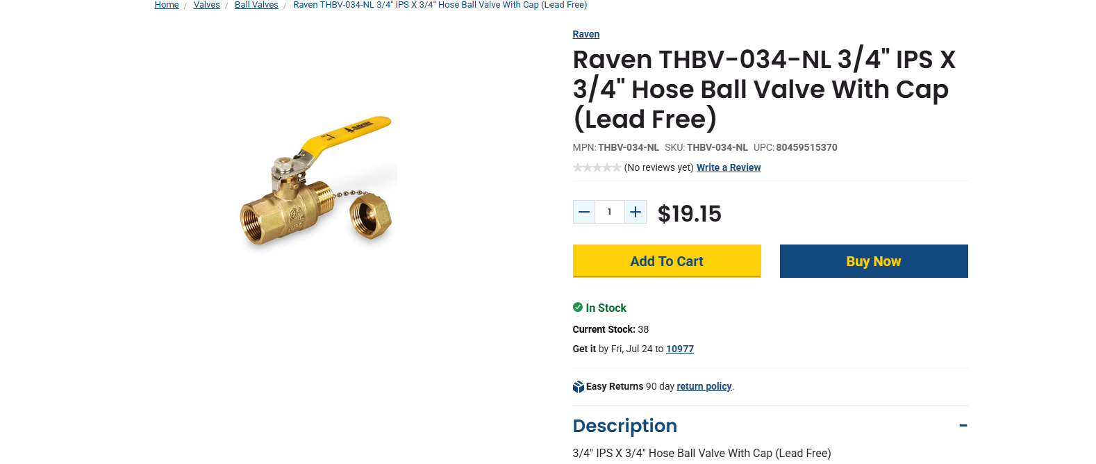

    here is the Webstone/ Nibco number. Iwould guess Amazon, Supplyhouse.com, Grainger, etc could ship one. The earlier one was a Home Depot part.

    jumper Posts: 2,625
    Cap is more than nice. Even the best valve might not close completely.
