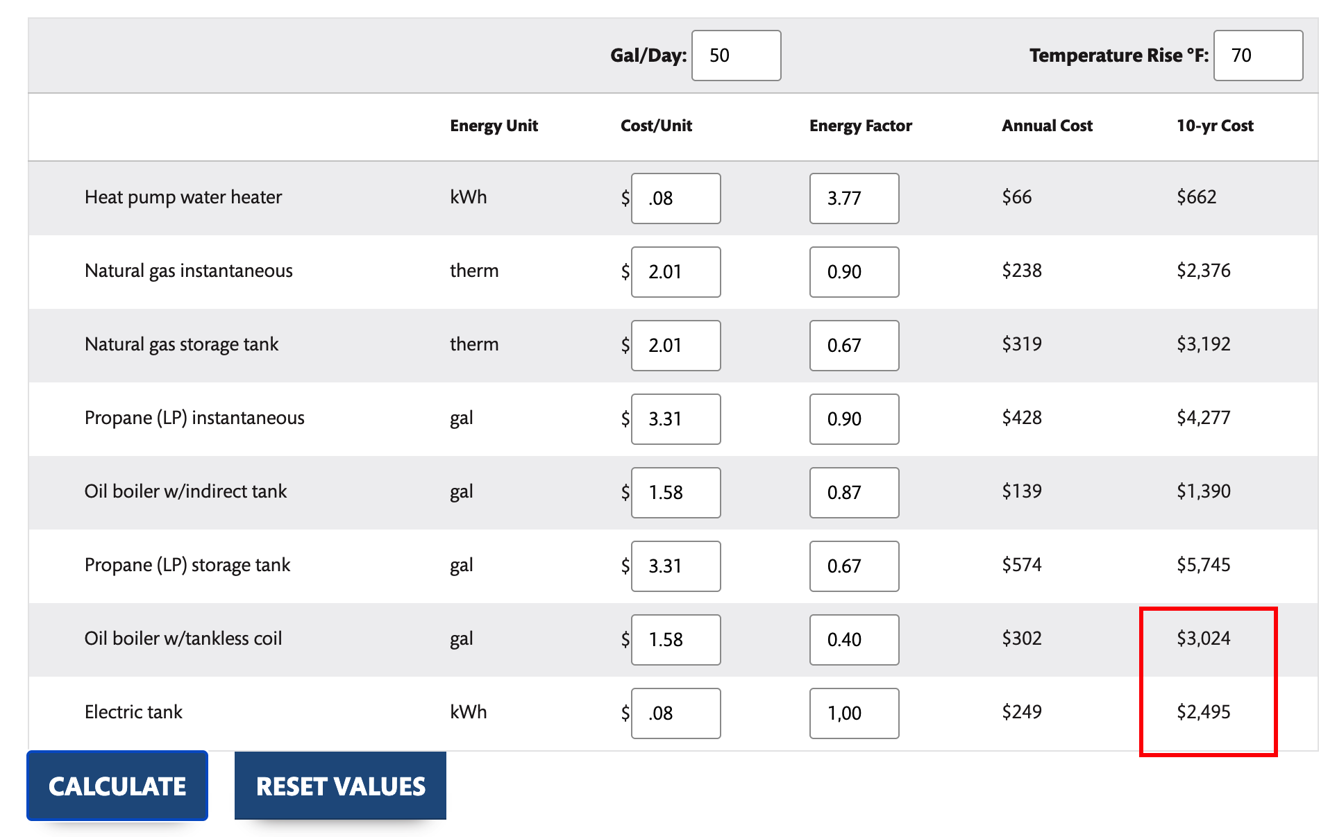

    I can understand @ethicalpaul ’s position. A lot of people had that same experience in the years around the turn of the century, when electricity was relatively inexpensive and oil prices were going through one of their periodic spikes. In many cases, a tankless coil on an inefficient oil-fired boiler was an expensive way to make domestic hot water. That was especially true when the coil was limed up with calcium deposits and could no longer deliver enough hot water for a decent shower. The plumber would come in, install a 40-gallon electric water heater, and voilà—more hot water and, quite often, a lower operating cost.
    In those situations, the old oil boiler might have had an effective water-heating efficiency, or energy factor, of only about 0.40. With electricity at roughly 8 cents per kWh, the electric water heater could easily win the operating-cost comparison.
    Inefficient Oil Boiler energy factor = 0.40 Electric is about 8 cnets for a kWh
    The important point, however, is that the oil-fired boilers Paul formed that opinion around are, for the most part, no longer representative of what is commonly installed or operating today. A modern oil-fired boiler with a tankless coil—such as a Weil-McLain, Peerless, or Burnham—can typically operate in the range of 80% to 85% combustion efficiency when properly set up. If we then account for additional standby and off-cycle chimney losses, the effective water-heating efficiency may still end up somewhere around 0.70. At that level, depending on current oil and electric rates, the tankless coil can be competitive with—or even less expensive to operate than—an electric water heater.

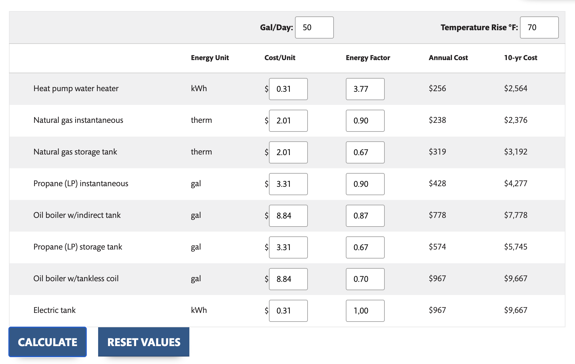

    Current Day Oil Prices and Electric Cost comparison
    That is the part of the discussion I believe Paul either does not see, or chooses not to accept. His conclusion is based on a real experience, but it is not universally applicable. As long as he continues to evaluate the subject through the lens of a heat pump water heater in his own basement, he is unlikely to be persuaded that his solution is not the right one for everyone. Oil would need to cost almost $9.00 per gallon to make Paul's argument valid when looking at a $0.31 kWh price for electricity.

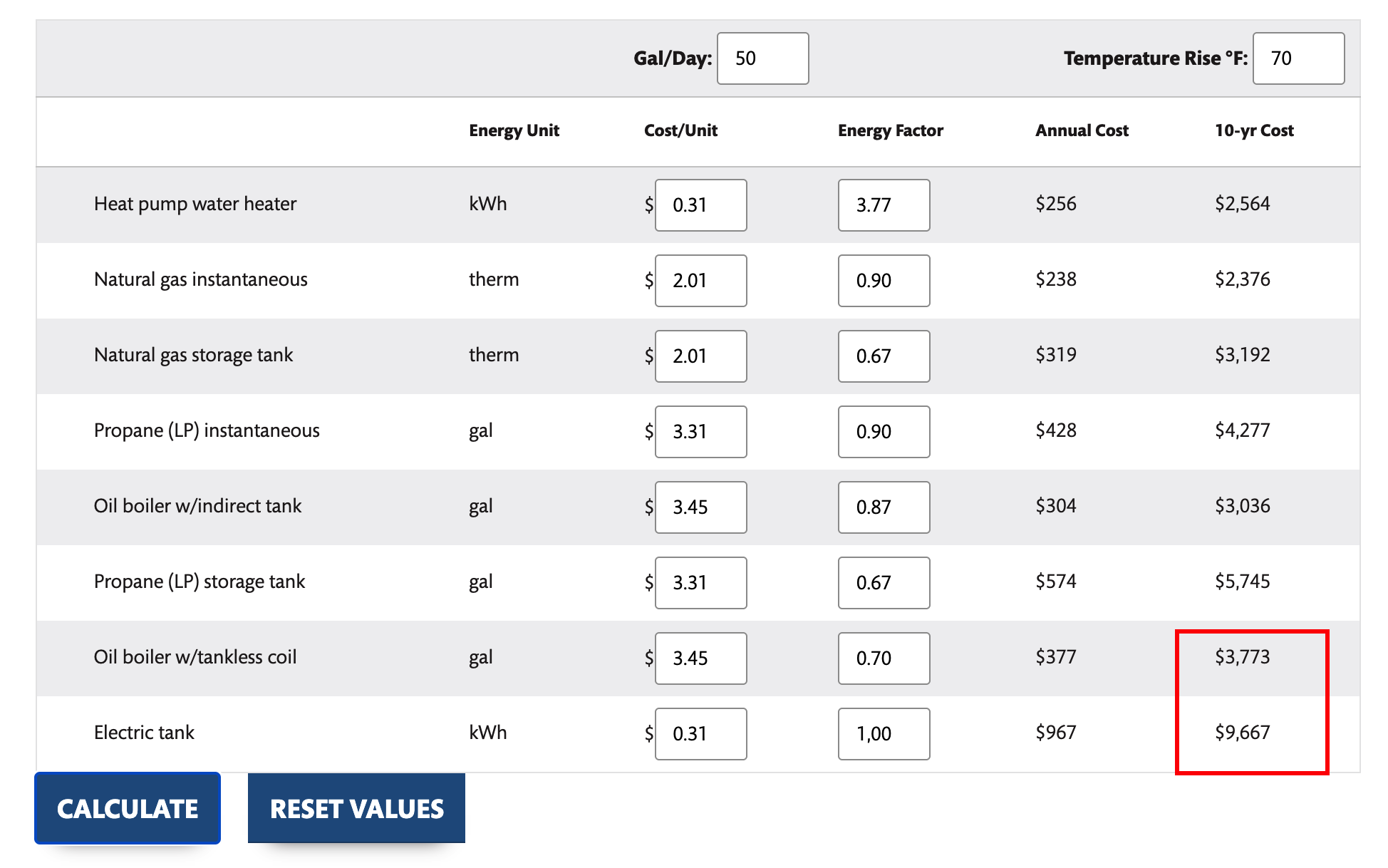

    As long as Paul continues to promote the “tankless coil elimination” theory as a blanket rule, I believe some of his otherwise valuable information—particularly on steam—will continue to be undermined by that overly broad and, in many cases, erroneous position on domestic hot water production.

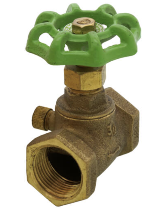

    EdTheHeaterMan Posts: 12,946
    As I recall the Watts 70A was a tempering valve (a mixing valve of sorts) that could fail HOT. The more betterer way is to use the ASSE 1017 strandard mixing valve that will fail COLD (not hot) and is much more betterer than the older design. In many cases the code requires that you use a point of use mixing valve ASSE 1016 which is even betterer and might even be the bestest mixing valve.
    In any case the valve that looks like this is not to be considered a good mixing valve.
