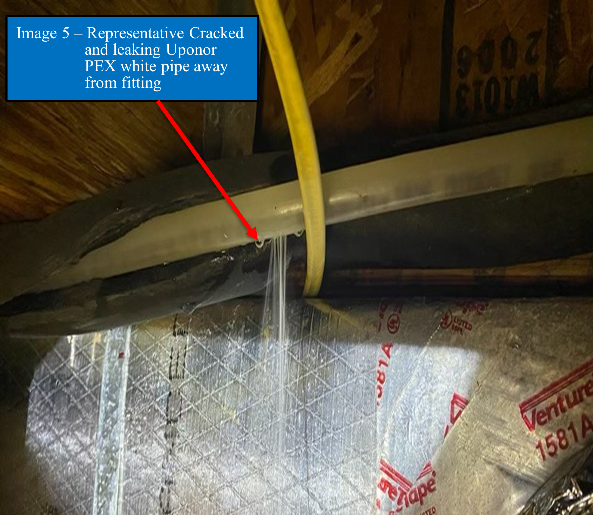

    I've been following this a while - there seems to be two pockets of failed Uponor PEX, one around the greater Atlanta area and the other in California, and most of these are only a few years installed, but it covers maybe 10 years that I can see.
    Uponor never explained what happened, if they even know what happened, or if they fixed the problem assuming they know what went wrong, but it's bad enough where I stopped using it. It's the silence from Uponor that scares me.

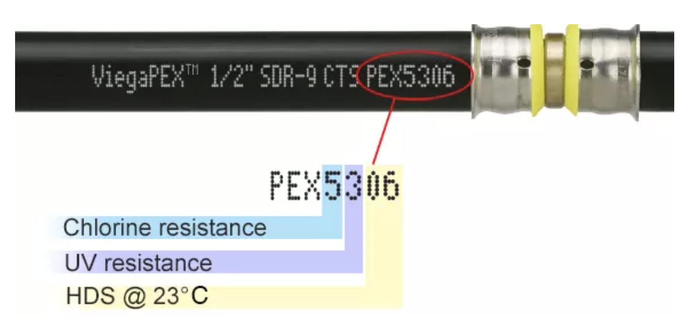

    hot_rod Posts: 28,699
    I think the most current failure issues were a specific brand of potable water pex in the blue or red color, only. Sounds like failures start 4- 5 years after the installation.
  • MaxMercy
    MaxMercy Posts: 632
    I've seen the same type of failures in the white Uponor pipe as well. I think the colored pipe got the bad press because it's simply installed far more than the white pipe is. The red gets the worse press of all because whatever it is that aggravates Uponor pipe to premature death, heat just adds to it, and if the red pipe is also used in recirculation setups, it's now seeing another factor (total water moving through pipe) that will cause premature wear and tear. When the red pipe starts failing in year 6 (for instance), you can expect the blue to fail in year 10.

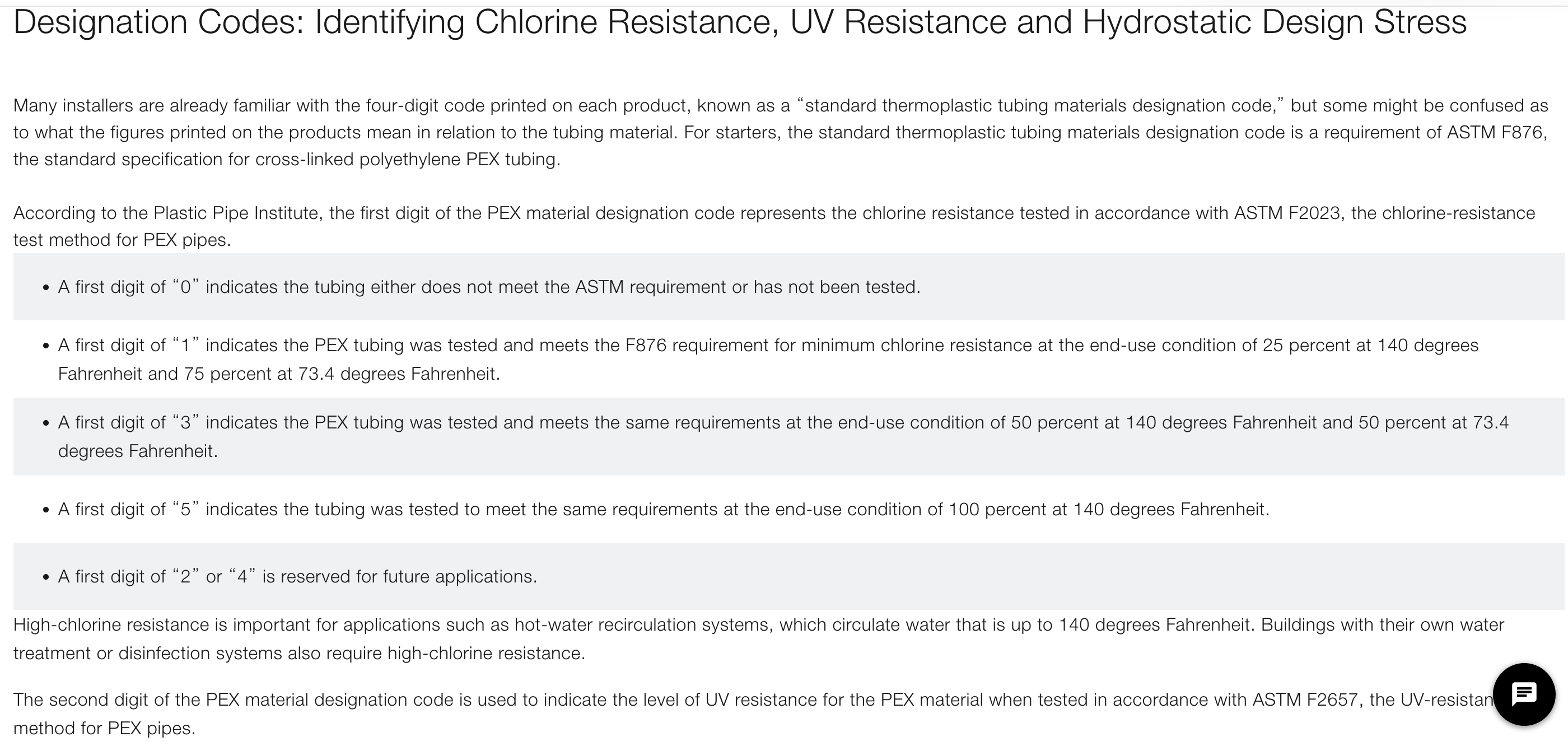

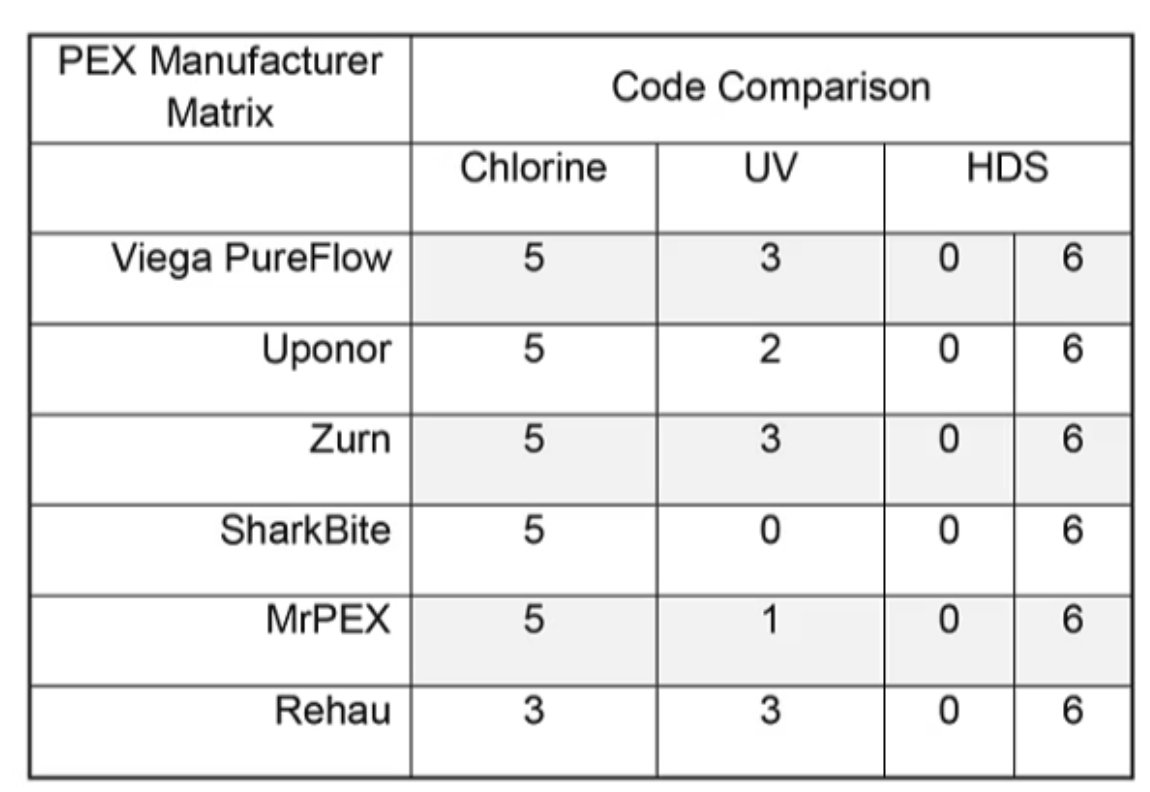

    There was some concern as to how the various manufacturers were getting the "5" code on their tube.
    Rehau played it safe with a "3" listing.
    It seems it takes a few years of that high chlorine, high temperature (140F) recirculation for failures to show up.
    I don't know if that test standard ASTM F2023 is for extended periods? Is it an actual extend duration test or just some number crunching?
    From Viegas website:
    Screenshot 2026-07-18 at 9.00.18 AM.png Screenshot 2026-07-18 at 9.01.17 AM.png Screenshot 2026-07-18 at 9.02.04 AM.png

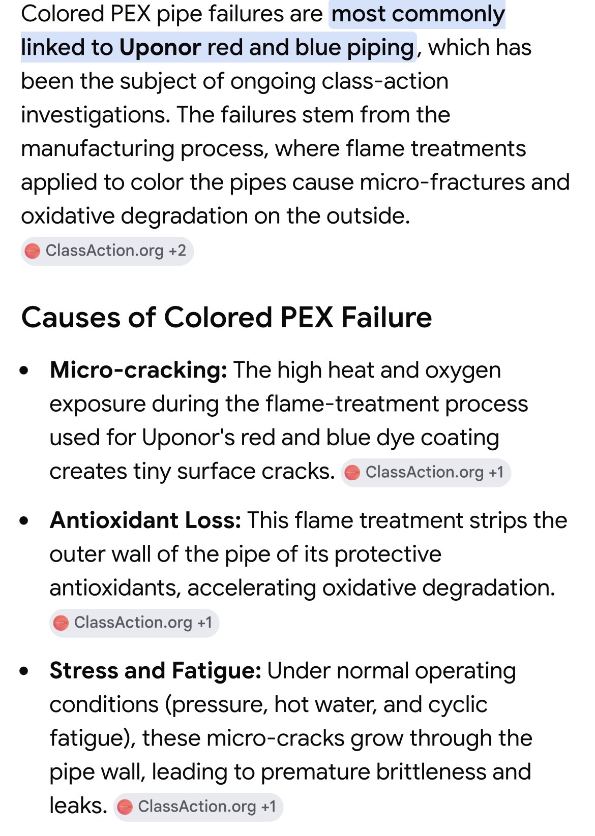

    The white is probably a color that is added to the tube like red or blue. I wonder why the red and blue are the colors that are the most common failures.
    If it was the color adding process that is causing the failure? According to the lawsuits.

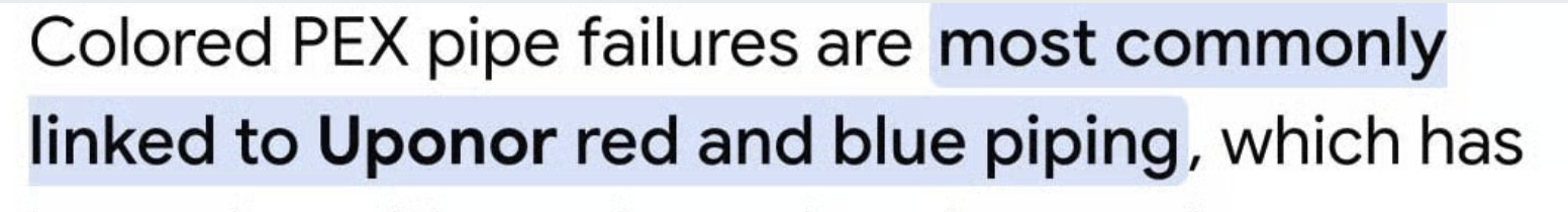

    ethicalpaul Posts: 9,075
    Now I don't know how accurate the author of this sentence was, but your highlighting missed the beginning of the sentence which indicated that of the colored pex failures, it is the Uponor red and blue that are most commonly linked. Whether it's correct or not I don't know, but the sentence isn't saying that most pipe failures are colored pipe.

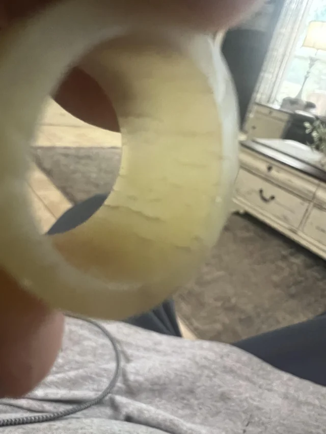

    Could be a regional thing. Most installations I've seen around here are the red/blue. Personally, I never used the color pipes because to me, it looks cheap and unprofessional. One can argue that any plastic is cheap and unprofessional, but that's a different discussion.
    In any case, the expansion rings are made of the same material as the pipe itself, these are not colored red or blue, and they show the same yellowing and cracking as the colored pipe.
