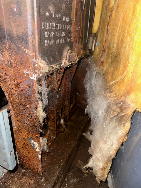

16 year old Weil-Mclain EGH-95. 400k BTU, likely oversized for my 650 EDR single pipe home.
I've documented various repairs I made to corroded pipes that have gotten me thorough some bonus winters, but the constant makeup water refills are getting worst, 1-2 gallons per day escaping as steam through the vent. When filled above water line the water trickles out, which confirms the leak.
I am highly skilled at home renovation and plumbing/electrical, but one thing I cannot physically do is install a new boiler entirely my self. Was hoping to get a few more years out of this while I save for the inevitable. I've seen pictures of boilers that look much worse than mine, but it seems irresponsible to rely on this unit for another season with what I know.
Previous homeowners installed the unit but did zero maintenance. Also it is direct venting which probably should be going through my historic chimney if physics allow for it.
First contractor had no regard to my sizing concern. Second contractor refused to price out a proposal until I had my chimney checked for ventilation capability.
What I am looking for is:
  1. Realistically how much life is left (I know the answer but am in denial stage)
  2. Direct vent debacle: Is this a must to get rid of? my current system is not designed for a power blower but they used it anyway.
  3. Cant can be done to prevent further corrosion. I have a water softener, if I bypass my municipal water is very hard. Seems bad either way.
Thanks!

    Jamie Hall Member Posts: 27,583
    Well… on further life, anything you can get out of it is a bonus. It's done. Sorry about that…
    I'm not quite sure how anyone is getting reliable combustion with a blower, but I suppose it can be done setting various dampers correctly. It would be better with natural draught, but…
    We never quote price on The Wall. There are various reasons for that — all good. Sorry about that, too!
    Now on the corrosion, since you won't want that to happen on the replacement boiler. Two things. First, check all over the entire system for anywhere that you are losing steam or water. A new boiler shouldn't use more than a gallon or two a month — if that. Makeup water is always a problem. HOWEVER. You mention a water softener. I do hope that you aren't using softened water. That really is lethal for a boiler. The municipal water may be hard — but if you keep the makeup water down, blowing the boiler down once a year or so will control the scale. You can further help with keeping the pH in the slightly basic range — that helps. But softened water? No. No Way.

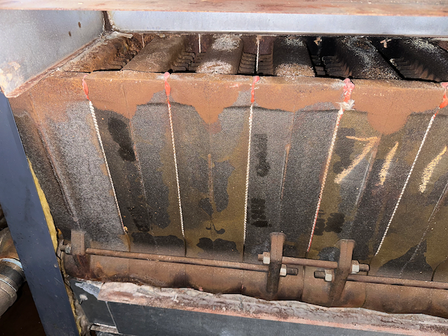

    if the leak is between sections rather than within a section you could potentially disassemble it and reseal it. people have had some success screwing and epoxying a plate over some leaks depending on where they are.

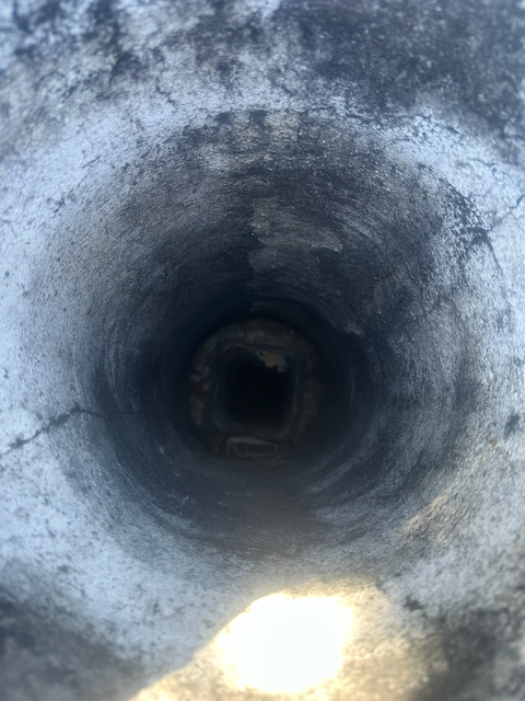

    Have a chimney contractor coming soon but I am not sure I have a full 8' of continuous diameter, might be closer to 7'. The picture was taken from the roof looking down. The round section is 11" wide then it narrows to a square possibly clay lined section that may or may not span the entire length.

    I also was able to measure the chimney flue diameter to be 7-1/4", which means a 6" liner is the most I would be able to install.
    It looks like only option would be to continue venting to outside. If my output was a little less 6" vent might have been possible. That said, I still cannot figure out why the last people went with a 400k unit. It barely fits on the pre-existing slab, the previous system might have actually been right-sized.

    Wow that boiler seems to be in rough shape.When you do get a new one, I would try finding the leak or the new one will suffer the same fate. I don't know and companies on that end of the state. Good luck
    Ray Wohlfarth
    Boiler Lessons
  • parity_check21
    parity_check21 Member Posts: 36
    The leak is in the actual Boilier above the water line, I'm hoping once it is replaced the water loss will be minimal.

    Leaking the rotted boiler could be a symptom rather than the actual leak. When a boiler takes on too much MU water it rots. Could be leaks elsewhere. If they are steam leaks you may not see them.

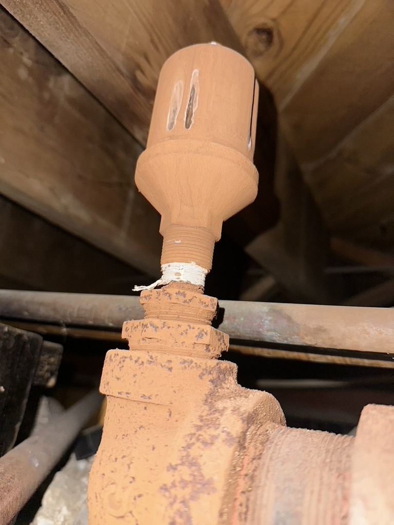

    Something going on here in one of the air vents in the basement loop. I've caught it releasing steam when the system runs for a prolonged time. it's usually only when my wife overrides my presets and drives the temperature up 4-5 degrees at once. Not sure if the vent is bad or if it's indicative of a larger problem.

    that vent may be shot, or wrong, somewhere on that body is the model #, what is it?
    then the boiler, what pressure are you running at? how clean is the pigtail? and what's the sight glass look like? post a picture showing each, then 1 or 2 more distant shots of the boiler, floor to ceiling, so we see all the pipes also, get 2 different angles,

    with the creative piping of the boiler it could be burping a slug of water out of the boiler and out that vent or it could be bad or it could be bad from the slug of water. if the main vents look like that I would replace them with properly sized vents with the new boiler to protect the new boiler.
    EBEBRATT-Ed Member Posts: 20,482
    That looks like a Hoffman vent.
    Looks rusty like it has been leaking a while but maybe it is just the picture.
    Steamhead Member Posts: 18,714
    Hoffman #75 most likely, and yes, it's shot. @parity_check21 , that's at least part of your problem. Measure your steam mains' length and diameter, and we can tell you what to replace it with.

    It was determined that my chimney is not sufficient to atmospherically vent any moderately sized boiler. It also looks like manufactures do not make boilers designed for a powered vent setup once you get above like 120k btu. Any suggestions for my 660 EDR system?

    How tall is the existing chimney and what is the max size liner that can be installed in it? Those two factors determine the btus you can fire.
  • parity_check21
    The height is fine, 30'. Problem is the diameter is 7-1/4". We didn't scope but Chimney guy said it would be difficult to get a 6" liner through due to potential flue turns and mortar protrusion. The manuals seem to want 7" chimney vent anyway.
