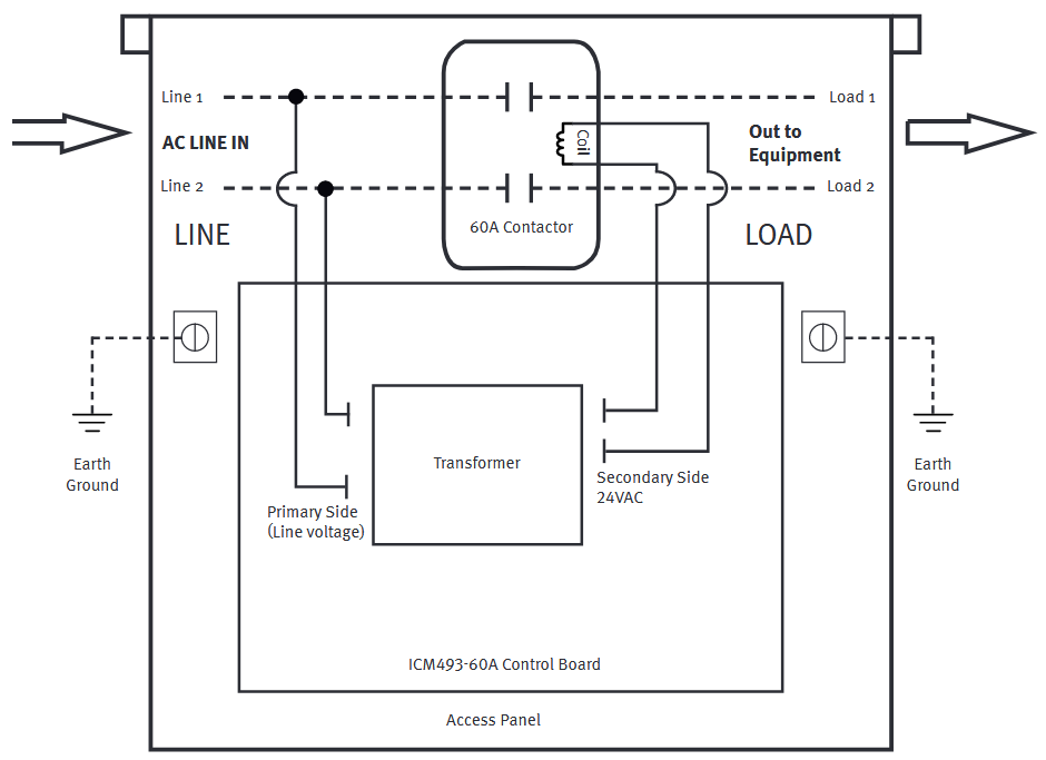

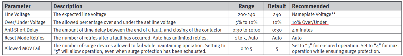

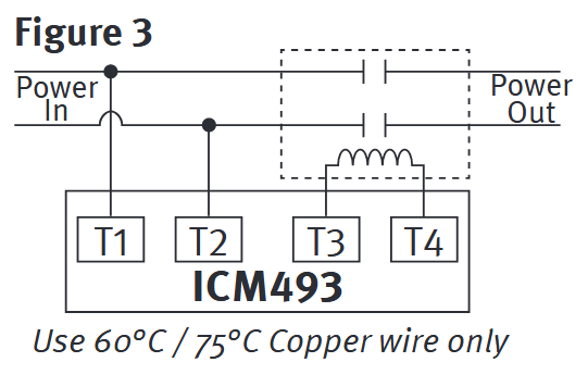

    Since you went to the time and expense of installing the ICM493 what did it report during the power anomalies that upset your Spacepack ? Was the ICM493 set up for the most sensitive activation ? Like 5% with a minute or two of interruption.

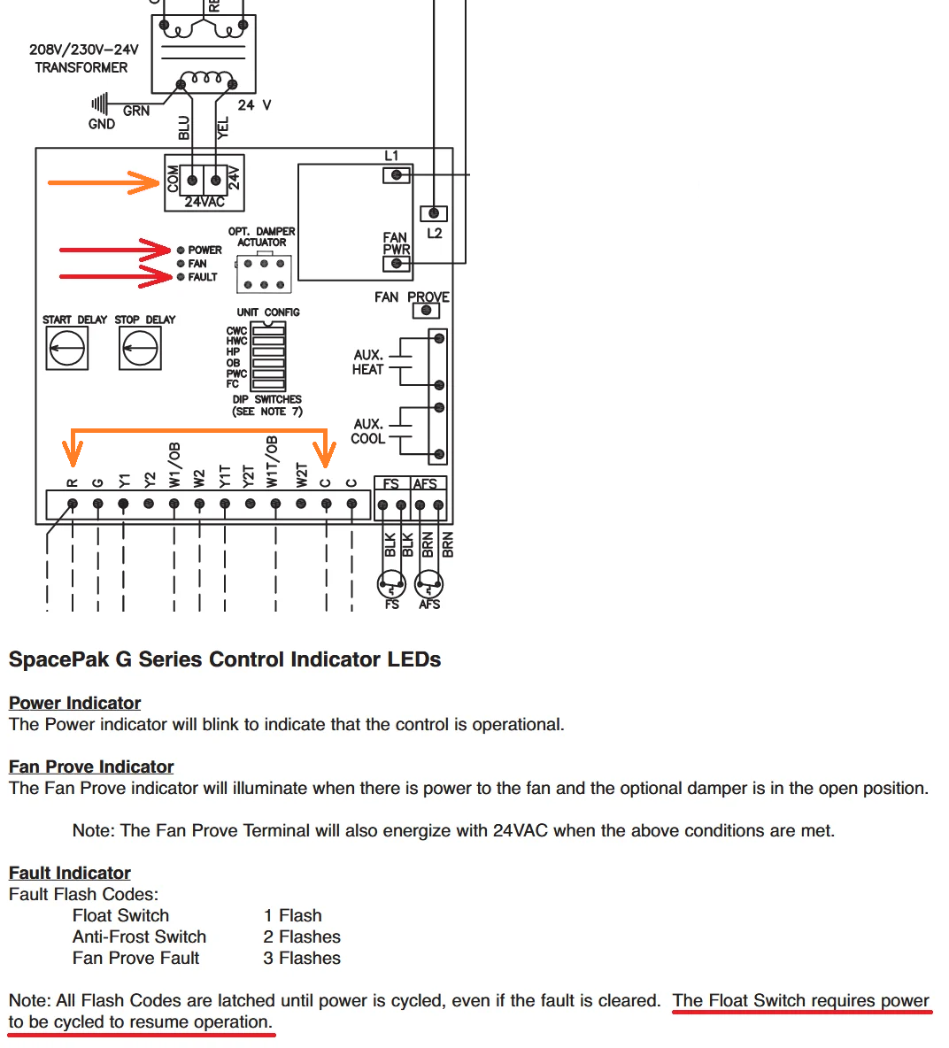

    109A_5 Posts: 4,617
    Understanding what state the unit is in after it gets glitched is key to resolving the issue. Is there 24 VAC at the 230V-24V transformer, is there 24 VAC between R and C ? Any Fault flash codes active ?
    You could bring the 24V and COM to a place easier to measure, however you still need to see if there are any Fault Flash Codes. It is interesting the Thermostat goes dead.
    109A_5 Posts: 4,617

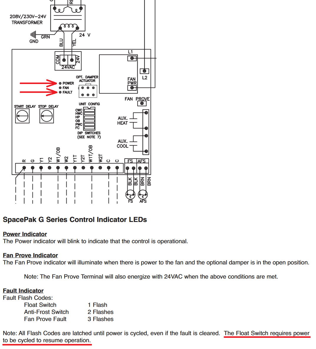

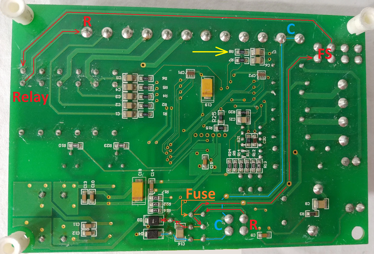

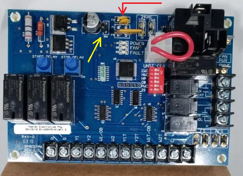

    Looking at the control board there appears to be three self-resetting fuses (Red arrow) and an MOV (Yellow arrow). If your AC power anomalies that upset the board are actually mild over-voltage events the circuitry on the control board may clamp the rising Voltage causing the self-resetting fuses to trip. Typically to reset a self-resetting fuse you have to remove the power source or the load, so the device can cool down.
    I would also make sure the 208 / 230 to 24 VAC power transformer is using the correct primary side tap. If it is erroneously tapped at 208 the voltage to the control board maybe prematurely high to start with.

    109A_5 Posts: 4,617
    If one of the self-resetting fuses trips causing the control portion of the system and the thermostat to appear dead I would suspect you would find 24 VAC where the power enters the control board an a very low but maybe not zero voltage between R and C.
    109A_5 Posts: 4,617
    There are 8 relays on the control board, presently I'm not convinced any of them would interrupt the 24 VAC to the thermostat, but maybe ?

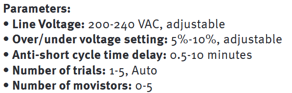

    FYI, The ICM493 is set at 5% and has reported absolutely nothing after any of these events! But the events exist. Sometimes the oven clocks need to be reset, often I can hear my 120 volt UPS's cycle on/of, lights dim or blink… Not all of these crash my air handler, just often enough to drive me crazy (or leave me with a very hot house if I"m returning from work).

    109A_5 Posts: 4,617

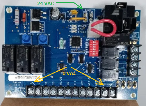

    The apparent absence of 24 VAC (R to C on the control board) should be verified, since maybe the power anomaly is actually just messing with the thermostat only. Dead thermostat, nothing works. Not sure if you ruled this out yet, I did not re-read the whole thread.
    I hate to add another Band-Aid type resolution to the situation, but I will. Since you stated the thermostat goes dead when the issue happens, if the 24 VAC (R to C on the control board) is truly absent, that absence of 24 VAC (R to C on the control board) could trigger a timer that would interrupt the power to the ICM493's contractor (T3 or T4) for a specific delay time, effectively resetting the Spacpak unit. So far I have not found a suitable inexpensive timer. The timer would be powered by the 24 VAC at T3, T4.
    109A_5 Posts: 4,617
    There are many timer types or modes. Basically the timer type needed would be similar to a 'Watchdog Timer'. However a Watchdog Timer's typically use a cyclic trigger refresh to avoid changing to the reset state. And in this case they don't seem to have a provision to end the reset state.
    So presently, as far as using a timer type device, is the use of an inexpensive PLC programed to do the job.
    The 24 VAC is monitored at the control board R and C. If 24 VAC goes away the PLC shuts off the ICM493's contractor for a short time (one method) or maybe just interrupt the 24 VAC to the control board. After a short delay the power interruption is restored. Operation should be back to normal.

    109A_5 Posts: 4,617

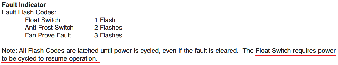

    If the Float Switch simply interrupted the 24 VAC to the entire board, two things, there would be no Fault Flash error code, since the board would be dead, and why would you need to cycle the 240 VAC to reset that fault.
    I believe once the Float Switch is tripped (and even if then corrected), that trip event is captured by the control board's logic and locks out operation, so the unit now requires attention to restore operation, the only way to restore operation is to cycle the 240 VAC, which clears the logical fault state if it no longer exists.
    And as I said before;
    You would have to experiment. I found no mention in the documentation (and I may have
    missed it) that claimed the thermostat would go dead if the Float
    Switch was tripped.
    The documentation could be wrong or simply left out some interesting details.
    109A_5 Posts: 4,617

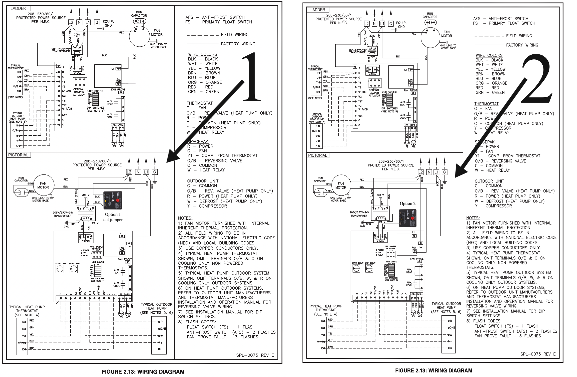

    @Jon_23, Looking at the bottom side of the control board. For the R terminal of the transformer to get to the R terminal for the thermostat it does go through the Float Switch and a relay. Apparently when the control board acts up the utility's power quality issues are causing very short (probably fractions of a second long) gaps (or dropouts) in the power and this trips the Float Switch lockout. This theory could be proven if the 1 flash Fault Flash Code is present.
    To me this is one of the perfect storm type situations, the unfortunate power quality issues and possible poor embedded software issues in the control board. IMO there is no need to capture a Float Switch fault event in a fraction of a second time period. With the electronics that detects the Float Switch fault, I see no intentional detection delay, so any real detection delay would be in the software. So replacing the control board without any software improvements would probably not help any.
    The manual probably does not mention the thermostat going dead, since not all thermostats have a display or any indication of a power loss.
    IMO to correct this issue the proper way is to get the utility to repair their power quality issue or fix the control board's embedded software (that may never happen). The other way (a Band-Aid repair) is a method to detect the lack of power to the thermostat and cycle the power to the control board, initiating a normal power up.
    Sadly setting up a means to cycle the power to the control board (like a custom timer system) may cause some odd behavior like the added timer system constantly cycling power to the control board if there is actually a situation that is actively tripping the Float Switch.

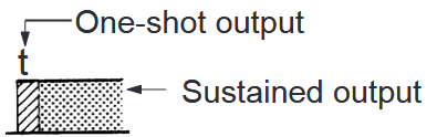

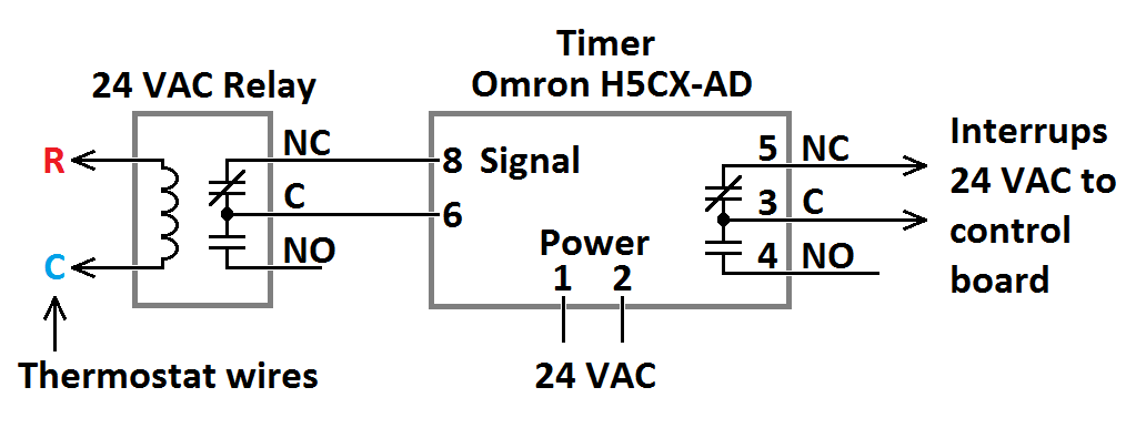

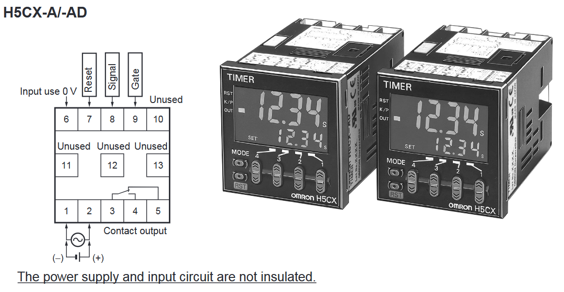

    @Jon_23, I believe I have found a suitable inexpensive timer. The Omron H5CX-AD which was here under my nose all along (Omron H5CX-AD-G). It checks all the boxes for me.
    24 VAC power.
    Trigger signal input via dry contacts (from a relay).
    Isolated relay output (to briefly interrupt 24 VAC power to the control Board).
    An appropriate timer mode.
    Inexpensive when strategically procured.

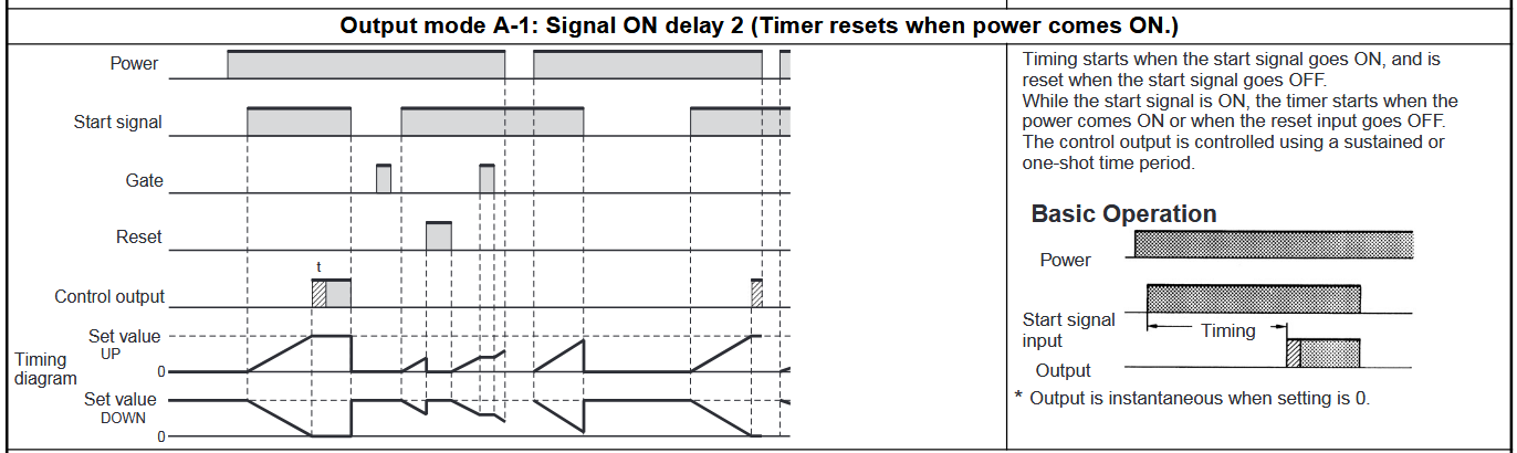

    Understanding the 10 timer modes and their options is always interesting. It appears Mode A-1 with the output time interval set for a One-Shot time period would do what is needed to automatically reset the Control Board after a poor power quality event.
    The way this would work, upon a poor power quality event and the control board cuts off power to the thermostat terminals shutting the AC system down. With a 24 VAC relay coil placed across the R and C terminals of the thermostat wiring, this constantly energizes the relay so its Normally Closed contacts are Open.
    With a poor power quality event the relay's coil wired across the R and C of the thermostat wiring would loose power and the relay's Normally Closed contacts would then Close. This would trigger the timer, the timer would then start an On Delay, say 30 Seconds. When the 30 second delay expires the relay inside the timer changes state interrupting the power to the control board (directly or via the ICM493's contactor control). Also the timer's One-Shot delay is started. When the One-Shot delay expires the relay inside the timer changes state again restoring the power to the control board. Restoring the power to the control board should restore the power to the thermostat circuit and energize the trigger relay, disabling the timer's trigger signal. So the timer system sits and waits for another poor power quality event.
    In practice I would probably have both delays at least about 60 Seconds each to let the refrigerant pressures equalize a bit.
    If there is an actual Float Switch fault, the timer system would keep cycling trying to restore normal operation. However since the Float Switch is open the A/C will never come back on until the Float Switch situation is dealt with.
    The 24 VAC power that powers the timer could be from the Spacepak unit, the ICM493 or its own dedicated transformer. The trigger relay should be as small as conveniently possible, I would not use a Fan Center relay which is huge for this application. There are some reasonably sized and priced relays with sockets on eBay.

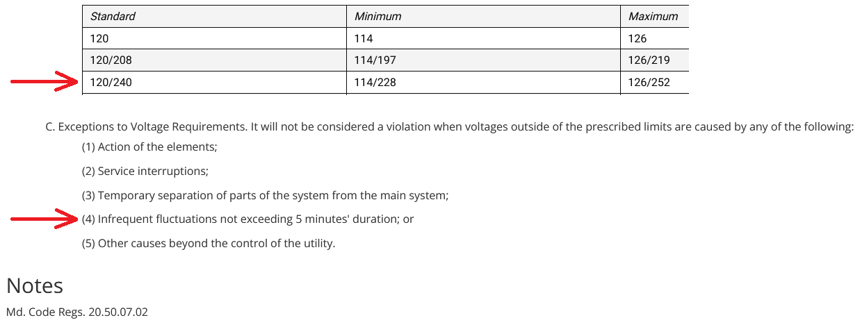

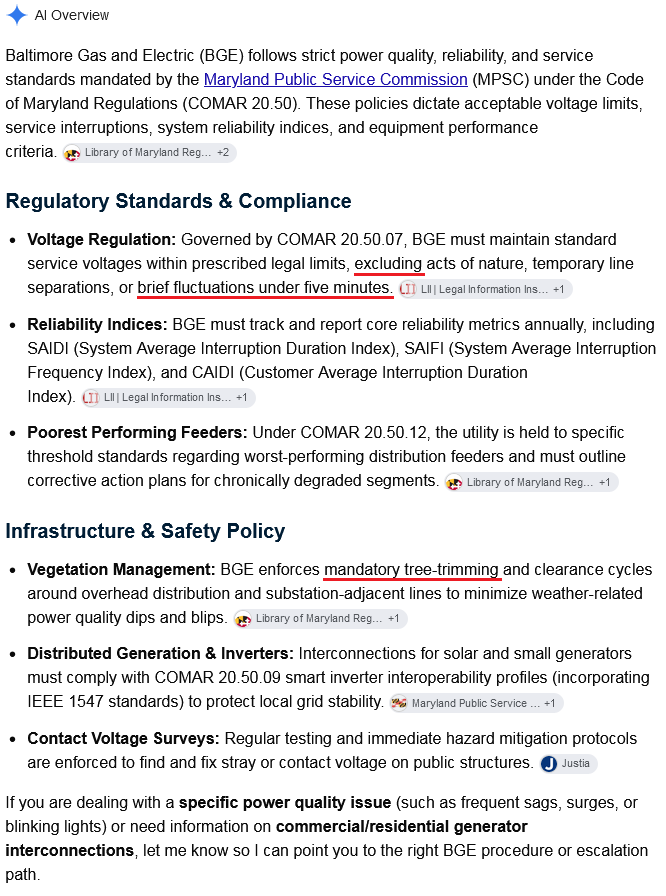

    @Jon_23, As I described your situation may be the perfect storm. So others may not experience what you do as often as you do, so it is not really on their radar. For example I am not far from my substation, my power never glitches, I can't remember the last time I had to reset a clock other than for a DST time change. If your situation happened to me once every 3 years would I be complaining about it ?
    Utility re-closure devices shut the power off as a result of an over-current fault. And it is off for a very noticeable amount of time, not just a glitch. When they re-close you should get a normal equipment restart. I believe you have a loose connection somewhere. The loose connection is agitated by the storm, probably wind related. Just replacing the aerial drop to your home without discovering a real defect is just lame in my opinion. It makes it look like they are being proactive but they really are not. Have they done an Infrared inspection of the entire primary back to the substation ? Also like monitoring the voltage during good weather, lame, monitor the voltage when a known bad storm is coming.
    Without the utility doing a proper investigation to find out who is affected and then carefully inspect the wiring they may never find the issue. Bad weather may eventually rip down the bad section and when it is replaced the problem may be gone, but that is a poor way of repairing power quality issues.
    And yes I understand it may take time for you to capture the next event and document the state your equipment is in when it happens.

    @Jon_23 stated
    " Have a Spacepak ESP-G air handler that works great, except when there
    are brief power glitches (power out for no more than a second or two).
    When this happens, the 24 volts seems to shut down (thermostat goes
    blank) and the only way to get it back is to cycle the 240 volt breaker
    off for a few seconds and then back on. "
    @Jamie Hall & @pecmsg I'm having a hard time dismissing @Jon_23's observations.
    Presently I believe (until proven otherwise) the Float Switch is the microcontroller's detected cause of the lockout. As far as I could find it is the only Fault that causes a lockout that requires the power to be cycled to restore operation. However it appears to be an erroneous lockout in this case. So it appears to me as a poor engineering issue, the microcontroller's capture window to detect Float Switch activity and thus activate a lockout does not have to be in milliseconds.
    Ask the question, if the Float Switch never actually opens, a brief power glitch is doing what ? I can only think of a few things that a power cycle would reliably cure.
    1. An erroneous Float Switch lockout. The microcontroller stays active but sees a brief loss of power at the load side of the Float Switch, causing the lockout.
    2. The microcontroller is glitched. If the microcontroller is being glitched, we are back to poor engineering, no or ineffective Hardware and/or Software watchdog timer.
    3. Float Switch contact bounce. The storm is shaking the house and the Float Switch has noisy switch contacts. However that would be ignoring @Jon_23's observation.
    The data to determine this has not been captured yet. The data would be the Power indicator flashing normally and any flash codes after a storm that causes a lockout.

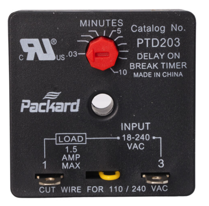

    I can think of a number of possible scenarios where a timing conflict within the control logic could do what I THINK I'm hearing: a situation where some control does NOT reset properly after a cycle or two of power loss, but does reset properly after say 10 to 20 cycles. It would be nice to know what it was.
    But in the meantime either come up with an on delay timer — which has been suggested and would probably work, but is a kludge, or stop blaming the power company or the float switch or warp drive or whatever and figure out the problem instead.

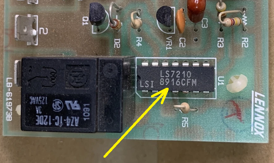

    For what it's worth (nothing!) my money is on a bad solder connection on a capacitor in the board's power supply section…

    1. I believe the Wet Switch is wired between the 24 volt transformer and the control board (as per the instructions) so this could, if flaky, drop the power to the board (and thermostat) requiring a power cycle to reset. If this is the case, the Red LED on the Wet Switch should be on after an 'event.'

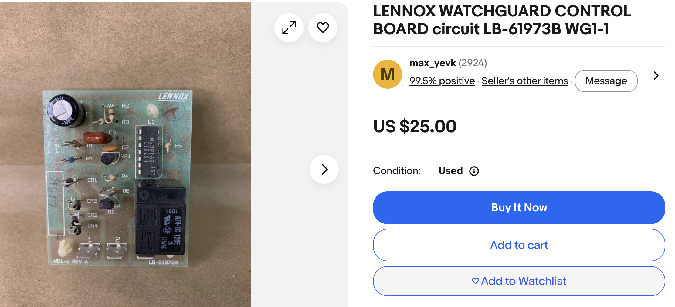

    EdTheHeaterMan Posts: 12,859
    I have been following this since the beginning and still cant believe the problem source has not been discovered. This reminds me of a rather similar situation form my time as a Lennox Dealer.
    In the 1980s, Lennox Industries had a problem with an electronic ignition control on one of their furnace models. The furnace would fail to start after some unknown electrical event. Even though the thermostat was calling for heat and the power to the furnace was on, the burner would not operate.
    Resetting the furnace by cycling the power off and then back on, solved the problem. The furnace would then operate as it should and cycle off by the thermostat, limits and everything else for days or even weeks before the glitch happened again, and you ended up with no heat until someone manually cycled the power.
    Since this was a problem that many furnaces encountered, and the engineers at Lennox Industries could not easily correct it, they came up with a Band-Aid-type fix. They added, at no cost to the consumer, a duty cycle that would break the thermostat circuit every hour if the thermostat had been calling for heat that long. It was called the Watchguard control WC-1
    Since most calls for heat were less than one hour, the consumer never actually knew it was happening because the duty cycle only started after one hour of continuous calling for heat. Although Lennox no longer offers that control, you can find it on sites like eBay that offer New Old Stock. Here is one you can get right now (August 2026): eBay Lennox Watchguard Control WC-1.
    Since it was good enough to solve the Lennox ignition failure problem, I think you can use it to restart your AC whenever it fails. The only difference; I would add is a 5-minute time delay for the compressor contactor, since some air-conditioning units do run nonstop for several hours during extreme weather. You don’t want the short off-and-on interruption of the 24 volts to cause a compressor event as a result of this device.
    pecmsg Posts: 7,613
    when this happens again you have to get in the attic and look for trouble codes and stop guessing
    109A_5 Posts: 4,617
    edited August 19
    @EdTheHeaterMan, as much as I considered a cyclic solution like your Lennox example, I did not like it so I came up with an inexpensive solution that only activates when actually needed.
    Since the control board could be the issue or the WetSwitch and the ICM493 now exists in the basement, I would simply (unless not practical) extent the thermostat circuit's R and C wires to the basement and add the timer circuit I illustrated above to briefly interrupt ICM493's contactor control. Easy, at least for me from here.
    I think @Jamie Hall missed a bit of the posts in the middle of the thread. @Jon_23 amusingly this thread is short compared to some. You seem correct, folks appear to be missing information.
    In a situation like this, my impatience and aggravation may overrule the my strong curiosity's need for data.
    I like evidence based troubleshooting.
    Jamie Hall Posts: 27,907
    edited August 19
    Did Lennox ever get to the root of that problem, @EdTheHeaterMan ? Be interesting to know.
    I must admit that the whole thing sounds to me like a timing error in the control logic, and I'd love to know what it is — and why.
    Detailed recording of the incoming power (preferably oscilloscope with event capture) will almost certainly find odd dropouts. These should not cause a problem to a well-designed circuit operating properly — even if it can be determined that a dropout to less than 98 RMS volts of exactly 3.1415 cycles duration or whatever is correlated with the failure. NOTE: correlated, not causal. While that would be lovely and interesting, it doesn't tell anyone what the problem is.
