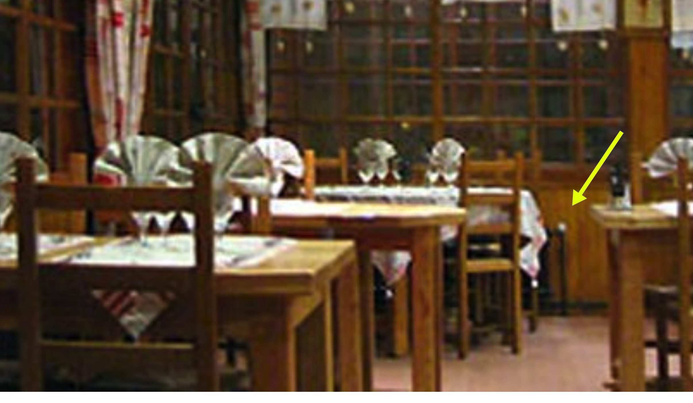

    Looking at this photograph from the website:
    That looks like a TRV on the feed of a cast iron radiator. the hot water is entering the top of the radiator and therefore the return must be on the bottom of the radiator somewhere. If it is steam, then that may not be a TRV but just a white handle on the steam radiator valve and there must be a steam trap on the other side. in either case this is not a "ONE PIPE STEAM" system as we understand it.
